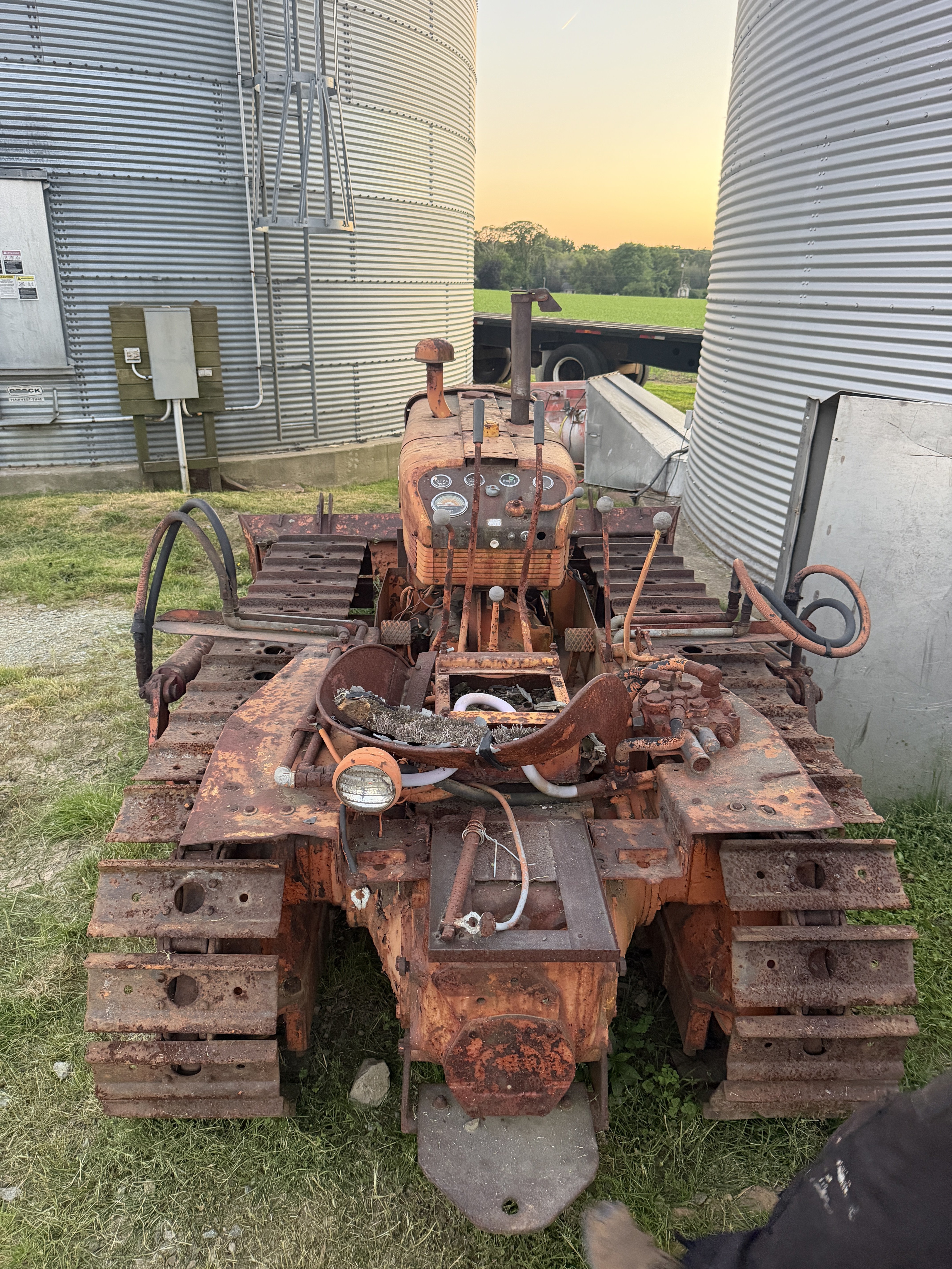

I looked at this yesterday. I need something for a few months to level my sloped yard and create tiers. The yard is mostly shale and not much dirt.
The dozer has sat for two years. being told by trusted person that it worked fine before that.
Hydraulic fluid on dipstick looked clean new and full. Engine oil looked fine too. Rust looks surface only and nothing serious. Tracks look good.
Guy was talking $3,000.
I told him I need it running and everything working and he is getting his nephew mechanic to do that.
Here is the list I made:
Radiator leaking?
4 hyd hoses replaced
Fuel tank and injection pump cleaned
New v belt
Battery
Thanks!

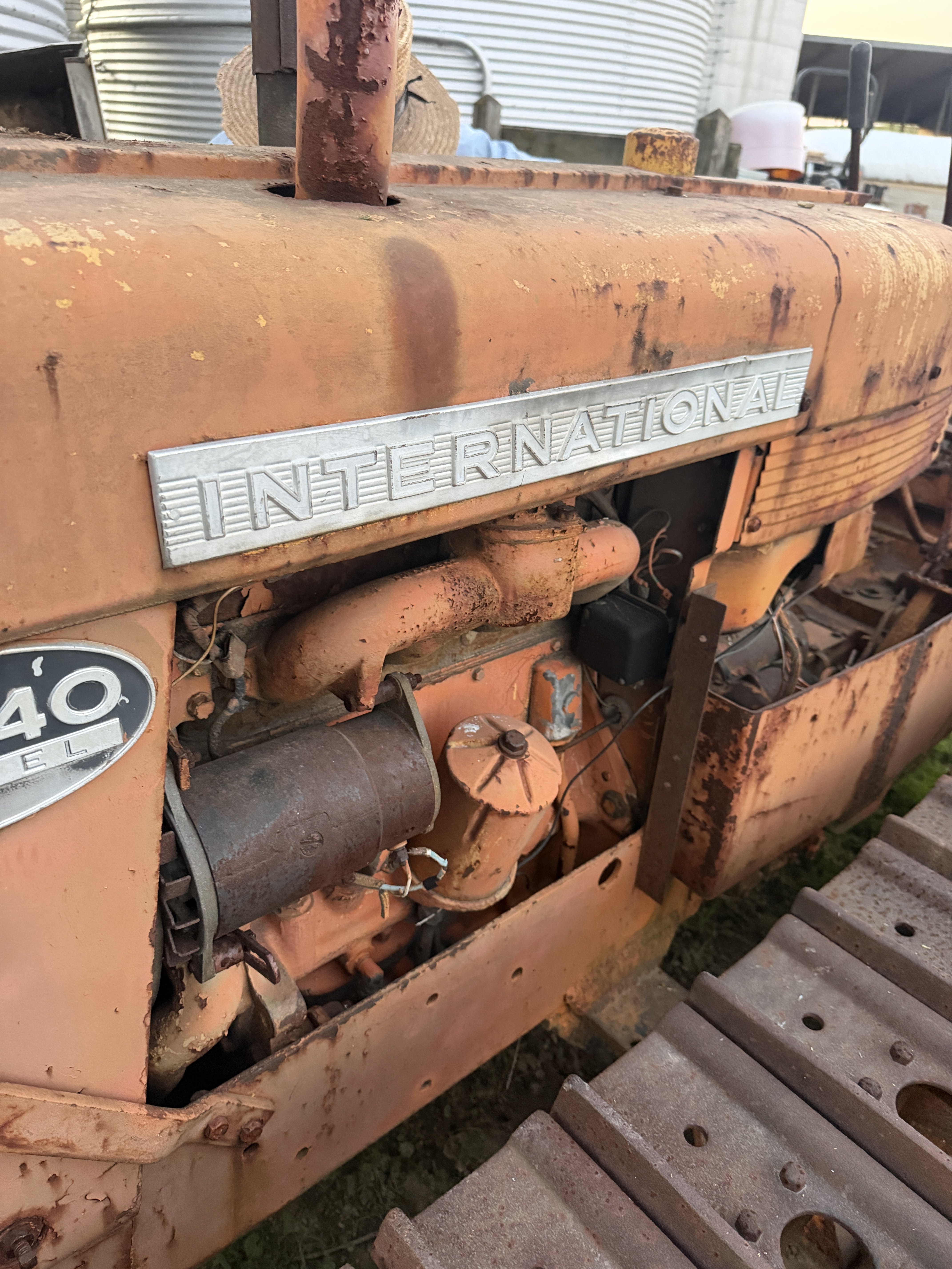

I saw what you wrote, if you mean a trusted person said it operated properly 2 years ago. And maybe he could have told you that I checked the engine and it is still free. Setting outside if every moderate rain event runs lets a 1/4 cup or less into one cylinder it doesn’t take long to lock up an engine.

Your choice, but I like to see old iron come back to life. If he gets it running, might be a good buy but the 166 diesel is very hard to find parts for, especially the fuel system. Hopefully the steering clutches are not froze up from sitting. It does have a good rear light😀😀😀

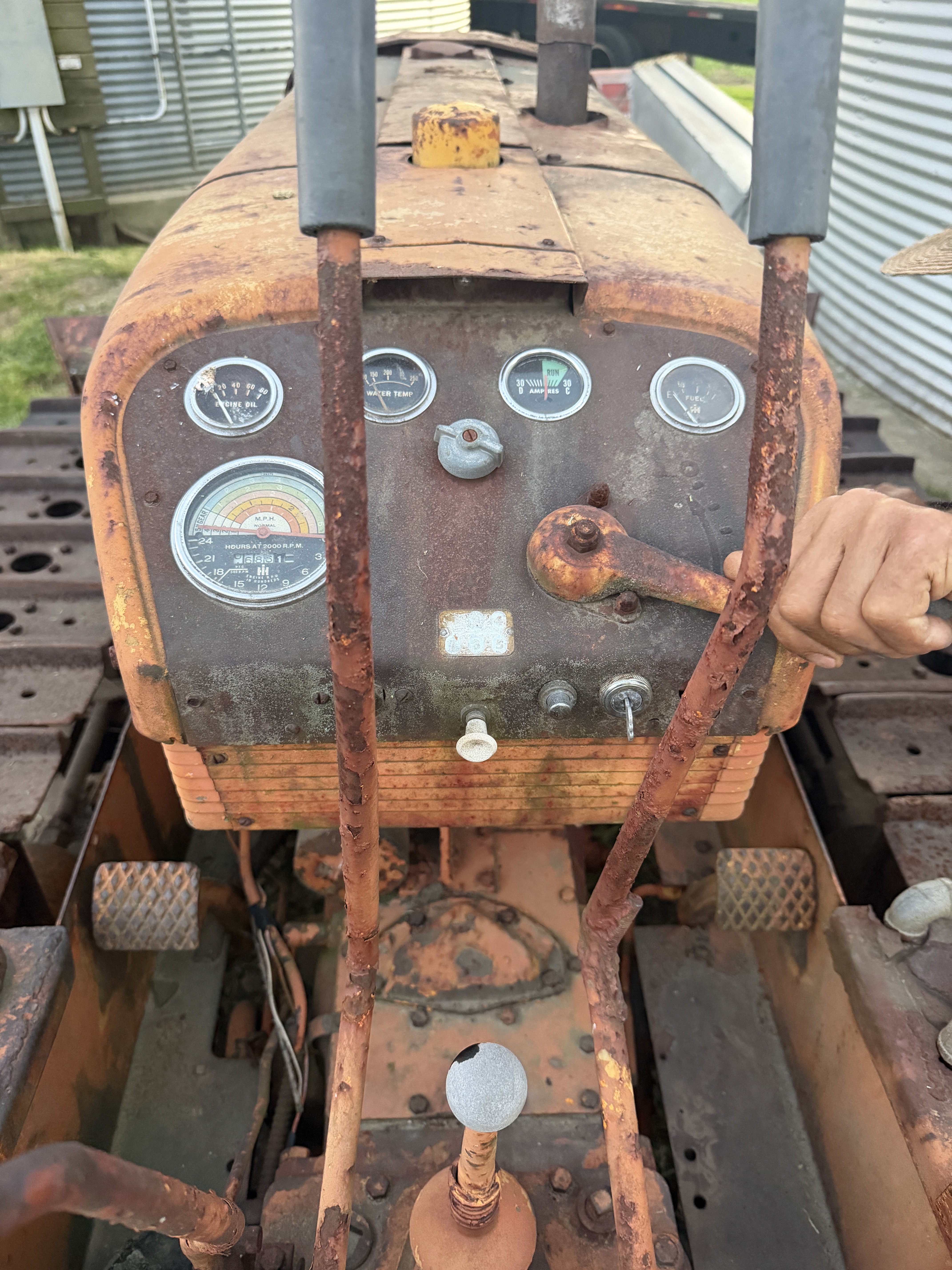

OK yes, that's why I'm asking and took pictures of the major components. Seems to me like the tracks are good and if the hydraulics work and don't leak it would last a while. Are there specifics I can examine before making the decision? What usually breaks and costs a lot of money or can't be fixed? I am decent at mechanics and modifications and could do retrofits.
And it would be fun for me and I'd document it on my youtube channel for others to find and keep these old classics alive if possible.
And even if I could run it for a few months and move some dirt and clean it up and have some fun it seems like that would be worth the 3k right there compared to a rental since we want it hear all the time so that I can just take an hour or 3 hours to do some work when I have time in between other stuff, which is how it is for me.

166 diesel is kind of a rare bird. Not that many produced which makes parts hard to come by.

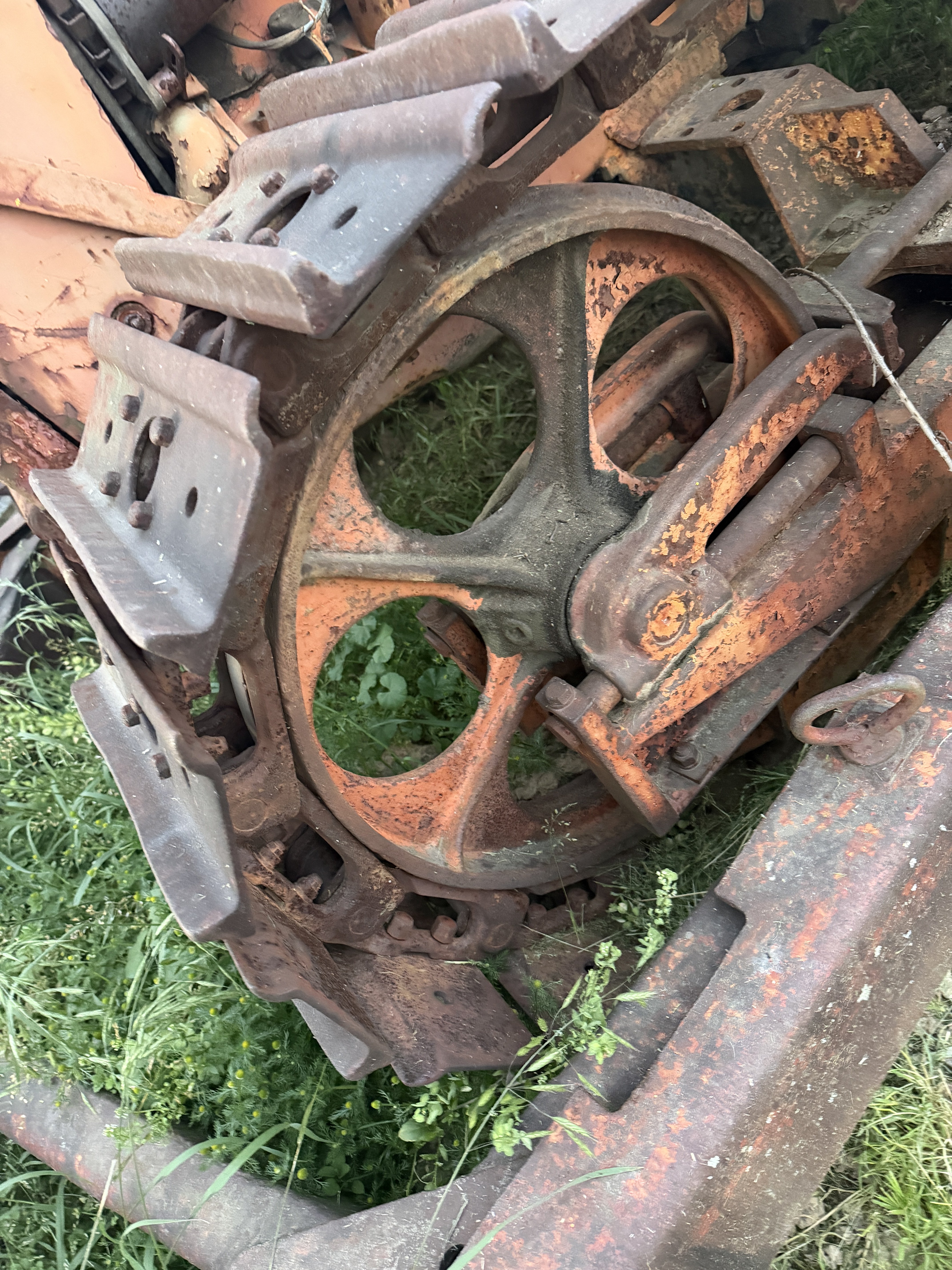

Crawlers can be a Money Pit. Check the Track Pins see how much ware they have. Check rear drive socket is it nice and round or is it Egg shaped
Make sure it runs good, Steering Brakes work good, No noises in Transmission. Around here I wouldn't pay more the $6500 for it if it ALL CHECKS OUT GOOD. It is a 63-65 year old Dozer
