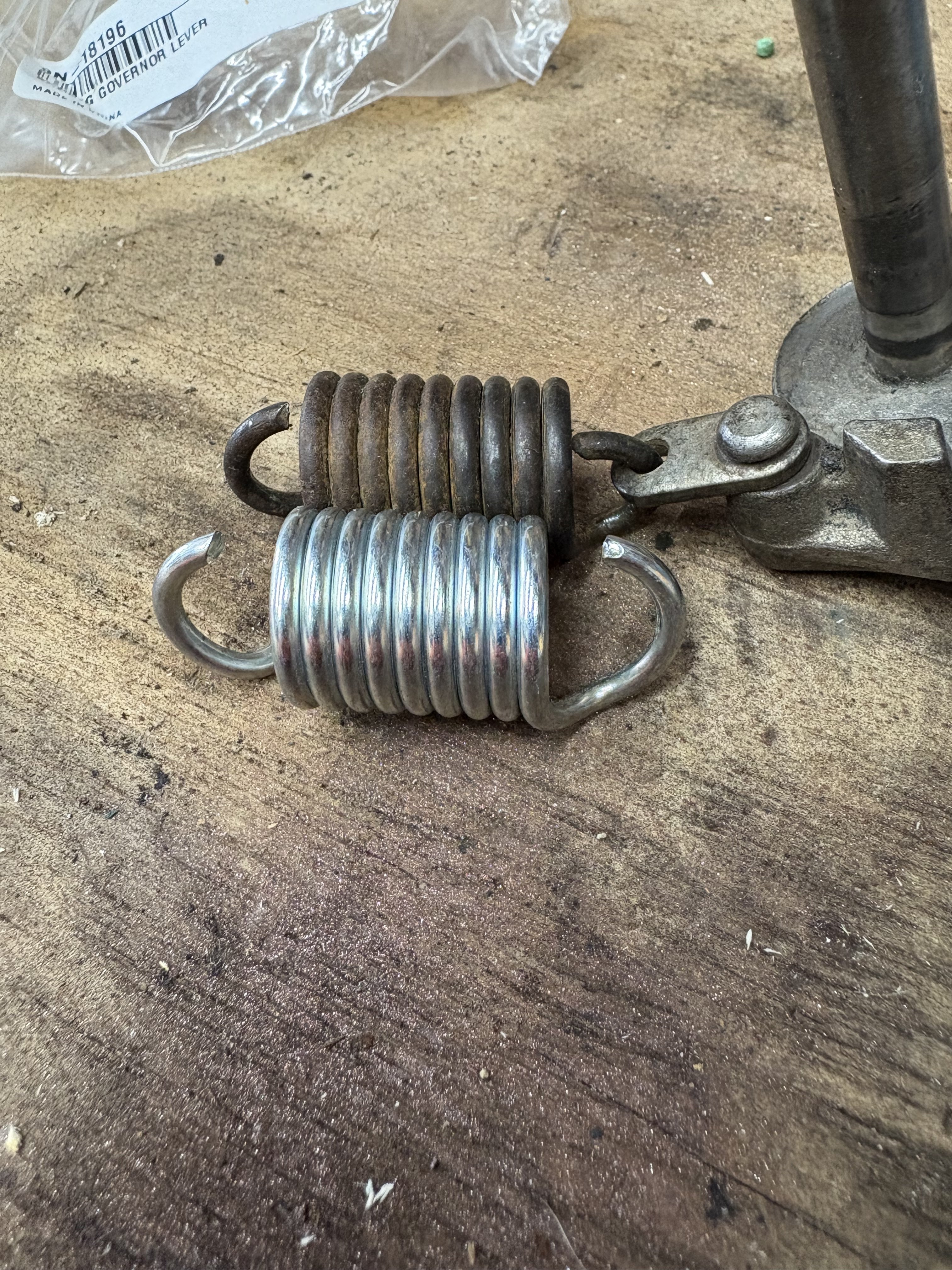

I have a ~1939 9N and pulled the governor because it just wasn't doing its job. The engine would run fine but the bottom 1/3 of the quadrant had no effect on engine speed and if you tried to actually move the tractor the governor wouldn't open up the throttle anymore so it would just bog and die. Everything inside the governor actually looked pretty nice and new, very little wear on the housing, balls all looked nice and round, and so on. The only things that really looked bad were the inside armature, which had a lot of side to side play, and the spring, which was just really dirty and full of crud but very strong.
I plan to make some sort of metal bushing to shore up the armature, and I ordered a replacement spring, but I wanted to check here because I knew "newer isn't always better". The old spring is very tight, and the metal is something super hard; I can't figure out how to get it off the armature without cutting the spring. I did a comparison with the new spring on the bench, and the new spring is more, well, "springy", and it's not as tight (meaning it's a little easier to pull out). Both seem like they would do the job, but I'd like to try to get it right the first time if possible. Any tips or thoughts on the matter?
