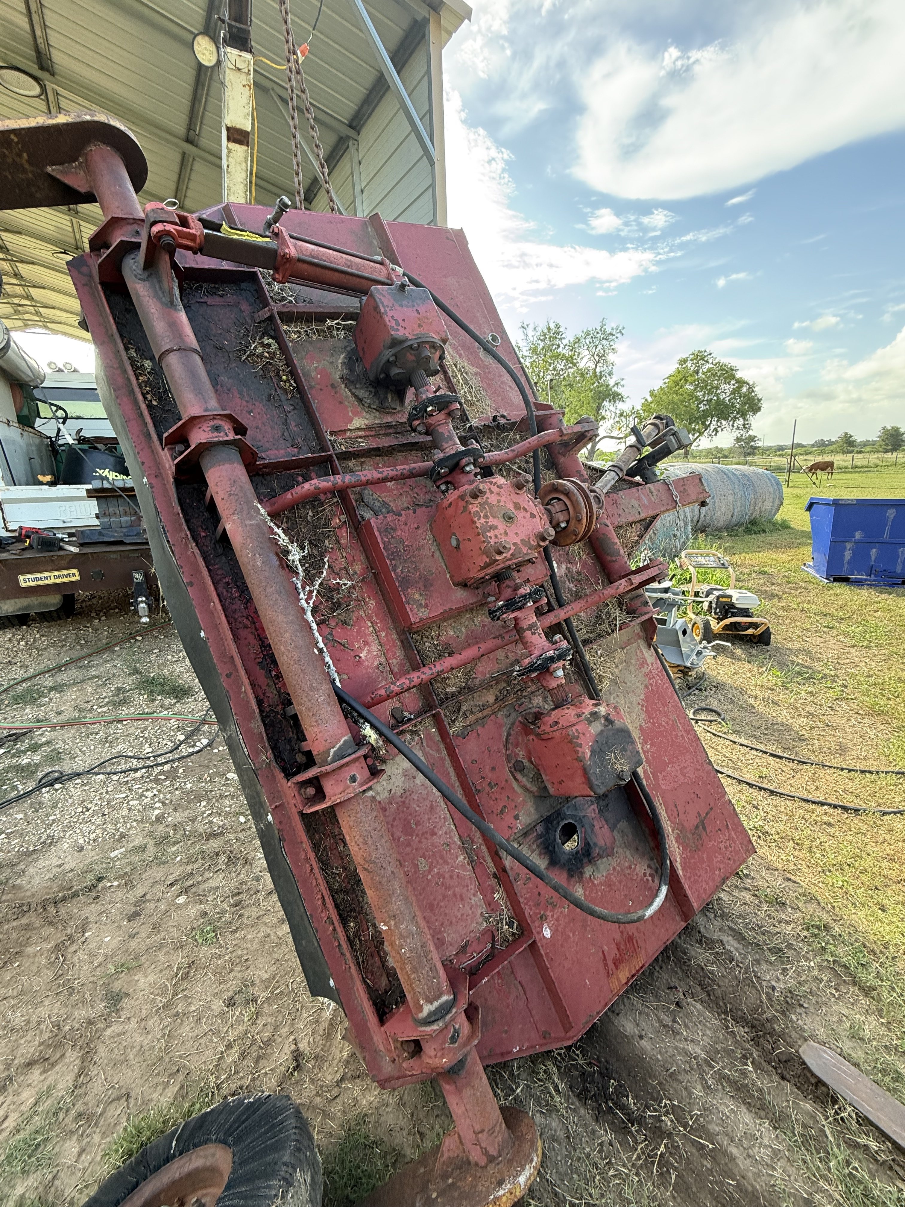

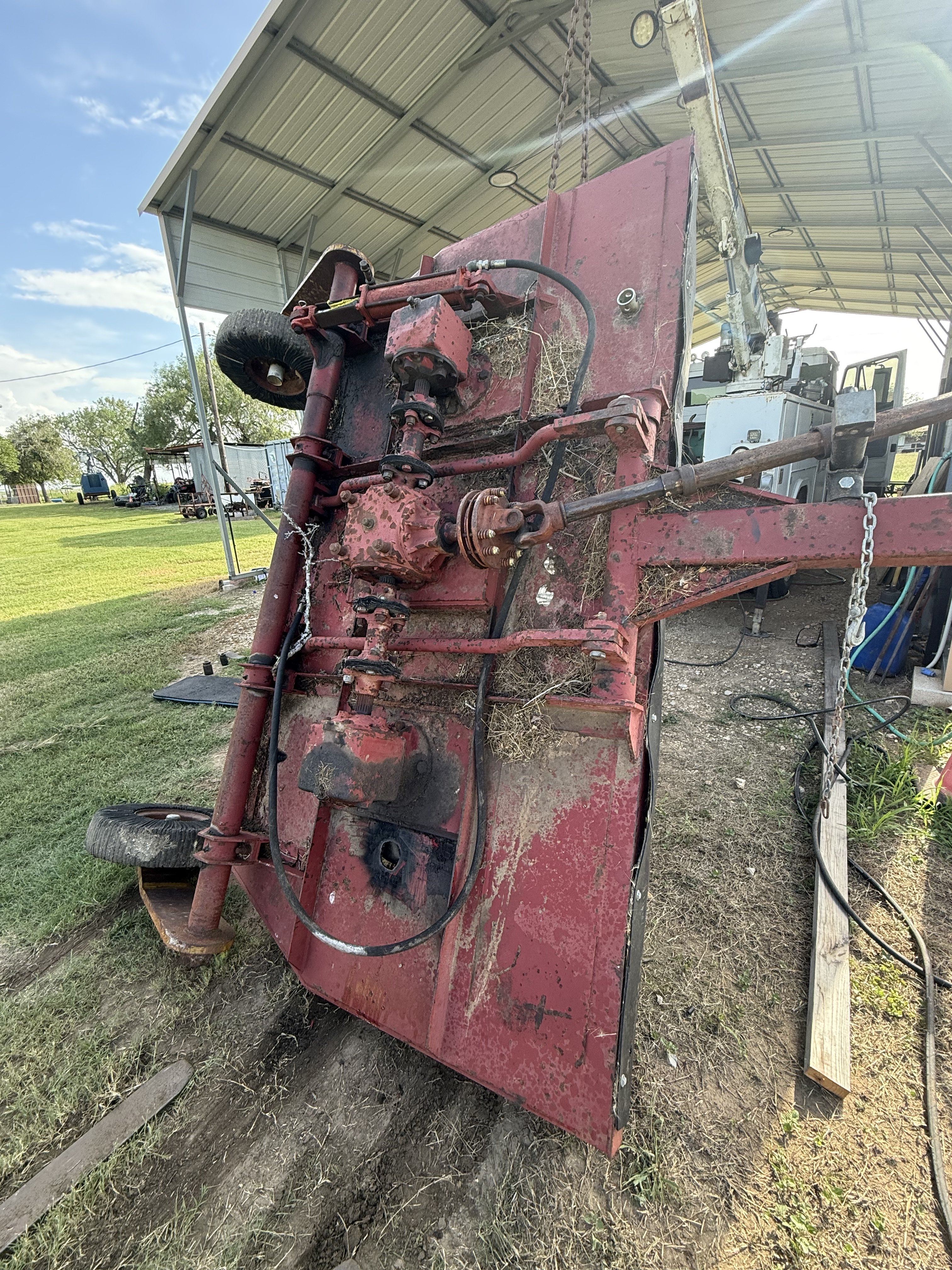

I am looking for help identifying this shredder. I believe it’s 8 ft howse but I can not find anything that looks like it online. I need some blades and some bottom seals for the gear boxes.

If someone doesn't identify it, it it common to make a sketch of the blades and use that to research for blades. Many vendor have drawings of their blades online.
For the seals you will likely need to find the number of the seals, or dimensions of the ones in it, unless positively identified.
The manufacturer before Rhino was Servis and they are hard to find parts for. I have one similar to yours . Find s Rhino dealer and take them our old parts. They should be able to help.
