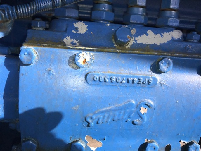

so far, I have been unable to find any inj pump like mine. Simms SPE4A70S380
ANYBODY KNOW WHERE I CAN GET INFORMATION ON IT??
It does not have the lift pump attached to it the lift pump is separate and before the single filter element

That looks a slightly odd pump on a Super, from your picture it could be an early one or one from a truck, however, if it pumps diesel .....
White/grey smoke means fuel is getting to the cylinders, I doubt the diaphragm is going to give you a problem as when they fail, the engine tend to run rough or rev too fast.
Have you had the pump off? Have you checked the timing and the drive coupling to the pump? Timing will only go out if the coupling fails or the bolts holding the drive gear in the timing cover break.
In the centre of the pivot on the stop control is an excess fuel button, have you pushed that in and tried to start?
If you have a good flow of fuel to the pump and little coming from the injector pipes it is possible your pump rack that meters the fuel, is stuck. Remove the bolts around the plate on the side of the pump and work the rack with a screw driver, it should move with a bit of spring pressure then spring back. A good squirt of easing oil or Automatic Transmission Fluid in there will be good. The plate looks as if it has been off in the past as it is upside down. I use about a pint of ATF per 15 gallons in my diesel a few times a year to help with pump lubrication.
Failing all this, try some starting fluid in the air intake but do not use too much. Another way is to remove the air cleaner pipe at the manifold and hold a burning rag over it as you try to start, do not let the rag get drawn into the engine though. You could also use a gas torch or blow lamp.

That injection pump requires oil in the bottom end, where the camshaft rotates (@ 1/2 engine speed) to lift the plungers to pressurize the fuel.
It also requires oil splashed up into the front of the pump where the governor is so that the governor can move the rack which controls metering.
A Minimec pump is "sump lubricated". That is to say a specific amount of lube oil is poured into the pump for lubrication of the cam/gov. The lower portion of the pump "cam chamber" is serpate from the upper part of the fuel where the plungers are charged, "fuel galley".
While this is not a Minimec pump I'm pretty sure it's sump lubricated.
From the pic here I can see what looks like an oil line that is used for oil overflow should the pump be overfilled or if the pumping plungers begin to leak fuel into the cam chamber.
I've never seen nor heard of a Simms injection pump on a Ford tractor that WAS NOT sump lubricated!
Almost all the Ford Simms pumps we see here have failed because the pump's oil was never changed or topped off. Most tractor owners never knew their pump required that kind of maintenence.
Take the side cover off and make sure the plunger lift up and down as the engine is cranked over. If the pump is bad shape the plunger may all be stuck at the top of their travel and are not pumping.
Also see you can make the rack move be moving the throttle and shut-off levers. If the rack or plunger are stuck theres your problem.

Looks a little dry in there so splash plenty of ATF around. I worked in a Ford approved diesel shop as part of my apprenticeship on those pumps. The only time oil is put in the cambox is when it is put in storage or in a situation like you have. Once you get her running any oil will dilute with diesel and will drain out through the pigtail tube so diesel will find its own level in the lower part of the pump.
Very strange that it won't fire on starting fluid, because you have taken the fuel system out of play. What led up to this problem? Majors, if the engine is in decent condition, and in time, with good fuel, will normally fire if you look at them cross-eyed. Has the pump been off? Was it running, and quit? Is this a barn find?
Thank you for the comeback, I don't believe I'm getting the straight story on this tractor. The fuel smells old so I'm going to change that. I did remove the fuel filter bowl dump out the old fuel and replace it with new fuel but I realized that's not enough. The cover for the injection pump was upside down and no gasket. Somebody's curious little fingers have been in there and I don't know what they did. The story goes the injectors were done and the injection pump was done but that could have been about 2 years ago and I don't know for sure if the tractor has moved since then. I'm going to get a new filter and fresh fuel and try again this weekend. I only have 15 more years and then I may be too old and too tired to fuss with this thing, thanks again

I found broken inj pump coupler, slot was beat up and snapped off. I snuggd it down and set pump timing. She's been running good.
