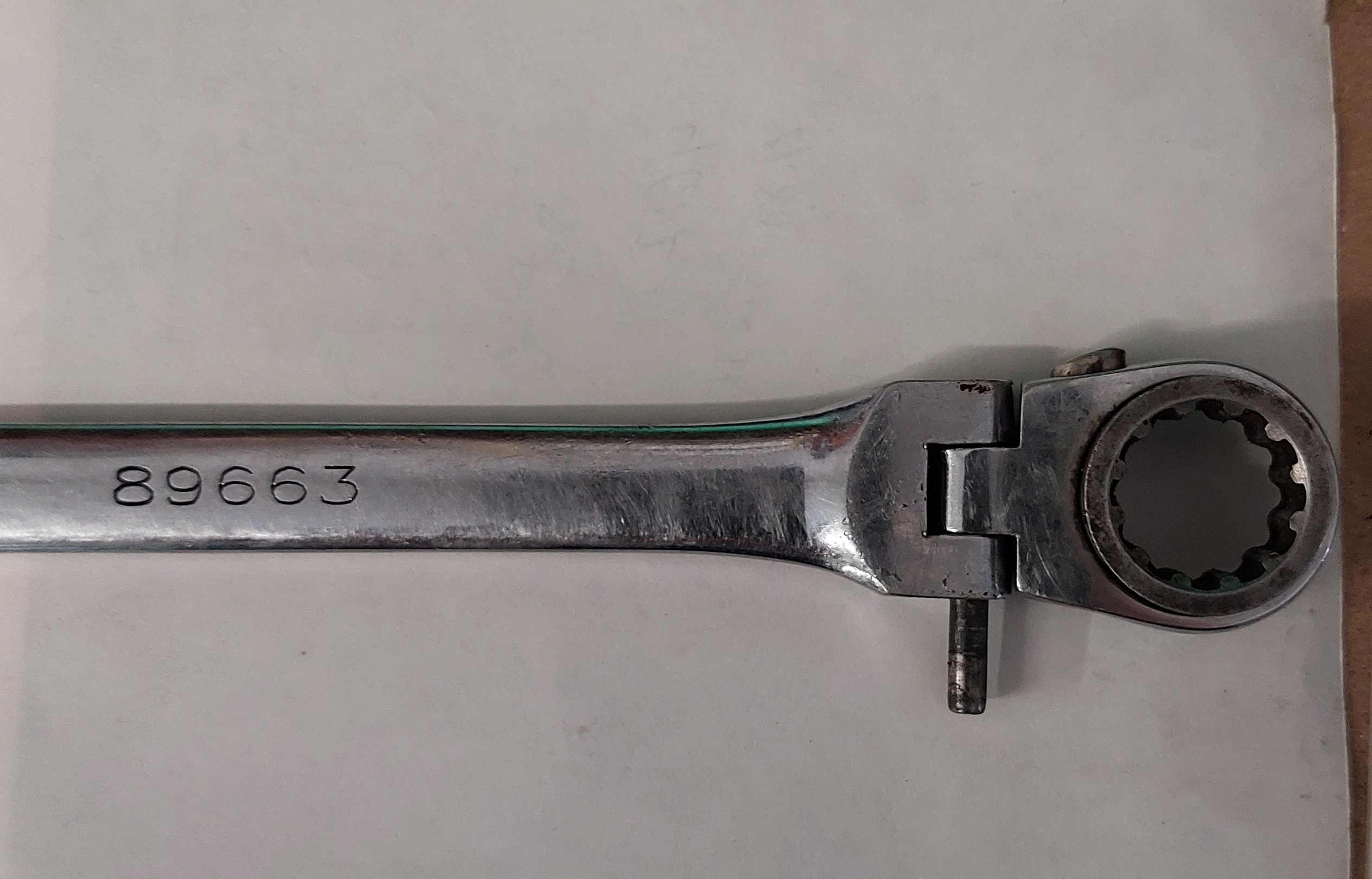

My favorite wrench of all time a 15mm - 13mm combination long flex head deep spline drive the retainer pin on the 15mm side will not stay in place. This wrench has been so handy I try not to abuse it when possible I break the faster free with another tool then use this wrench. I contacted SK the wrench is no longer available they gave me a $56.87 credit to spend in their store. I brought a 1/4" drive ratchet this happens to be my favorite 1/4" drive ratchet. This is the first time I tried to get warranty from SK online. I will try and weld the pin in place.

I have had luck hammering the end of the pin to fatten it then driving it home. A touch of Locktite will also work after it is carb cleaner clean. Jim

mic it to see if a coil pin is available in that size. IF, big if, the handle is soft enough to drill you could enlarge it to take whatever pin size is available. The coil pins are as strong as a solid pin but lock in place like a splhit pin. Cub Cadet used them in a lot of the early IH models. They are available from McMaster-Carr, but you have to buy a box there.
