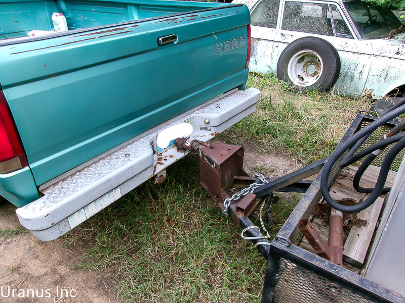

Clutch died on the 1 ton, so gotta haul diesel with the little F-150. It's not set up for towing anything I own. No provision for safety chains, and the light hookup doesn't match anything I own.
And it's not a very robust truck to begin with. The mid 90's light duty Fords weren't really designed to work hard.
(sigh)
Looks like 2 holes there for the chains. Could at least make it look more official pretty easy.

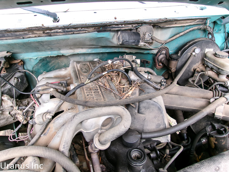

OOOOOMPH!!!!!!!!!!!!!!!!!!!!!!!!!!!
Wait for it...................... IT GETS BETTER.

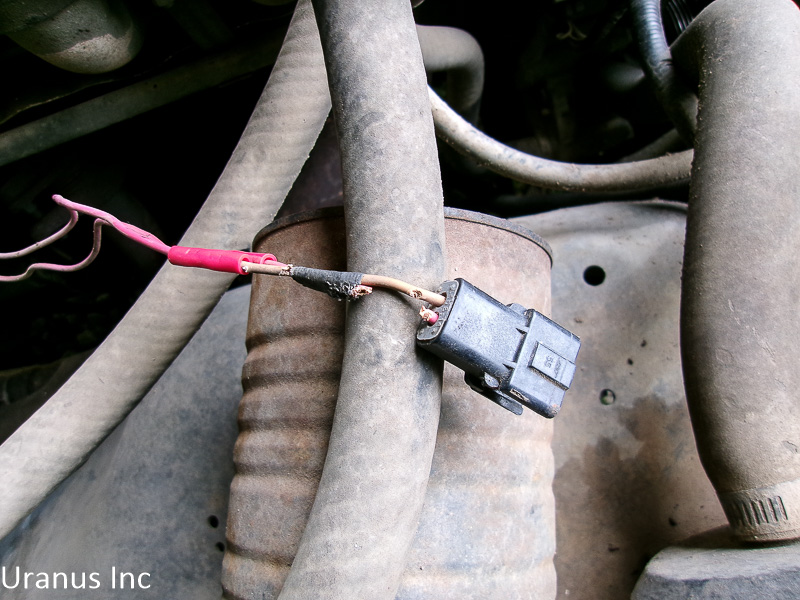

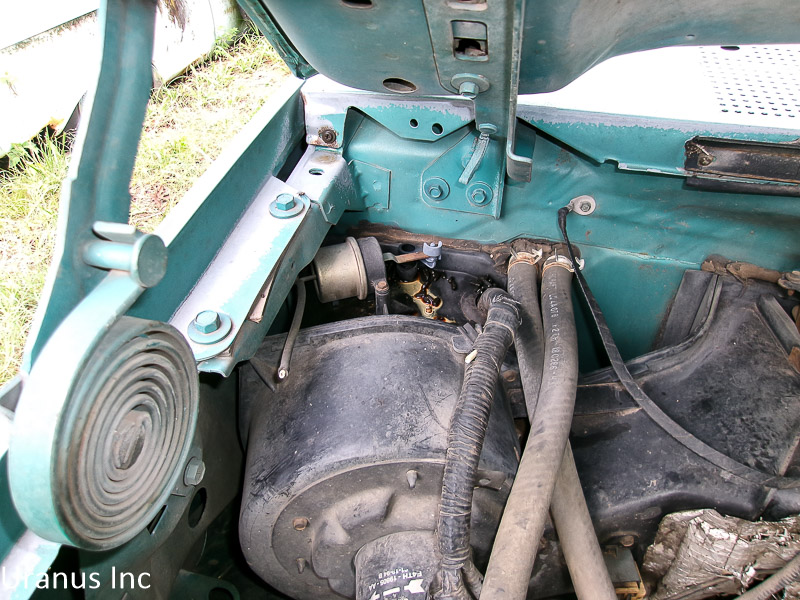

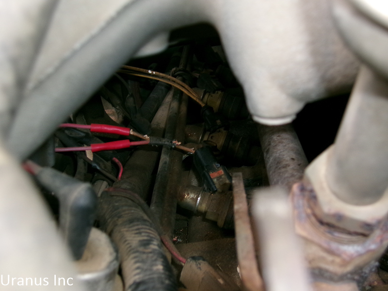

Ate the harness for the fuel injector. And..........ate the vacuum line to the heater control pot.
They NEVER eat the wire midway. IT'S ALWAYS FLUSH WITH THE CONNECTOR

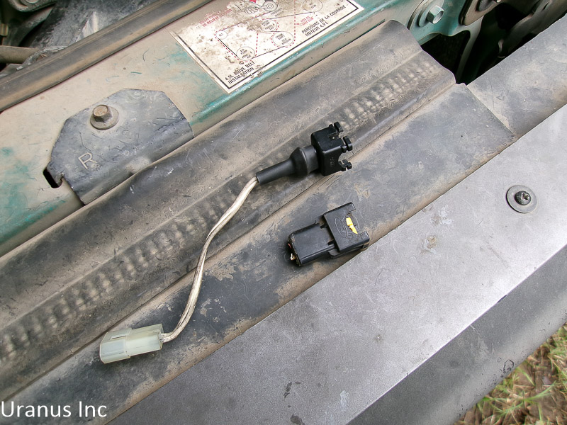

This ain't my first rodeo. I'm ready for the little bastards. I keep a few spares on hand. This is the last one.

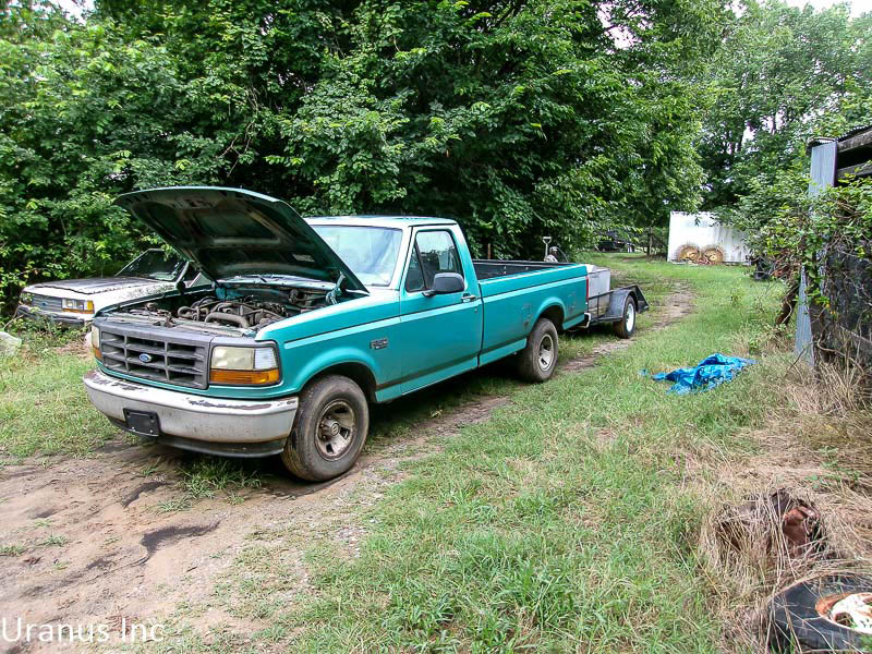

Might just get some fuel in here before Christmas:rolleyes:
ONE DAY AWAY FROM WHERE IT'S USUALLY PARKED, WHERE THE CAT PATROLS...........AND THIS HAPPENS.
They NEVER eat the wire midway. IT'S ALWAYS FLUSH WITH THE CONNECTORView attachment 119793

I understand they eat the insulation because it's made out of soybean oil!
Through the 80's and 90's many of the OEM wiring harnesses were produced in the Ukraine and yes, the insulation is soy oil based which is a very large crop grown there. Rodents, and small animals eat it a lot. Have two vehicles in the shop now doing wiring repairs to citing rodent damage. Both are now mine given the work needed when deemed unworthy of needed expense to repair.
