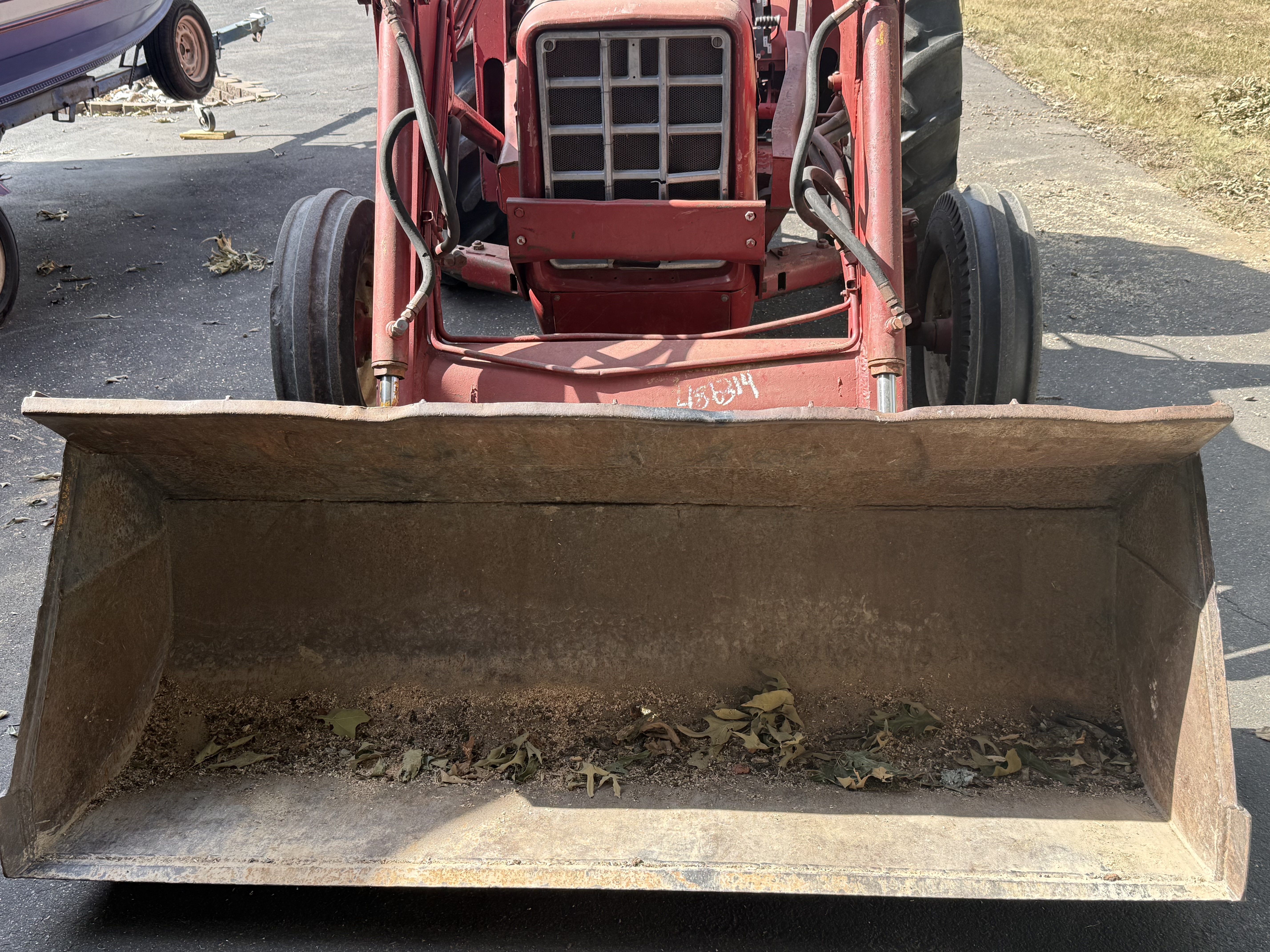

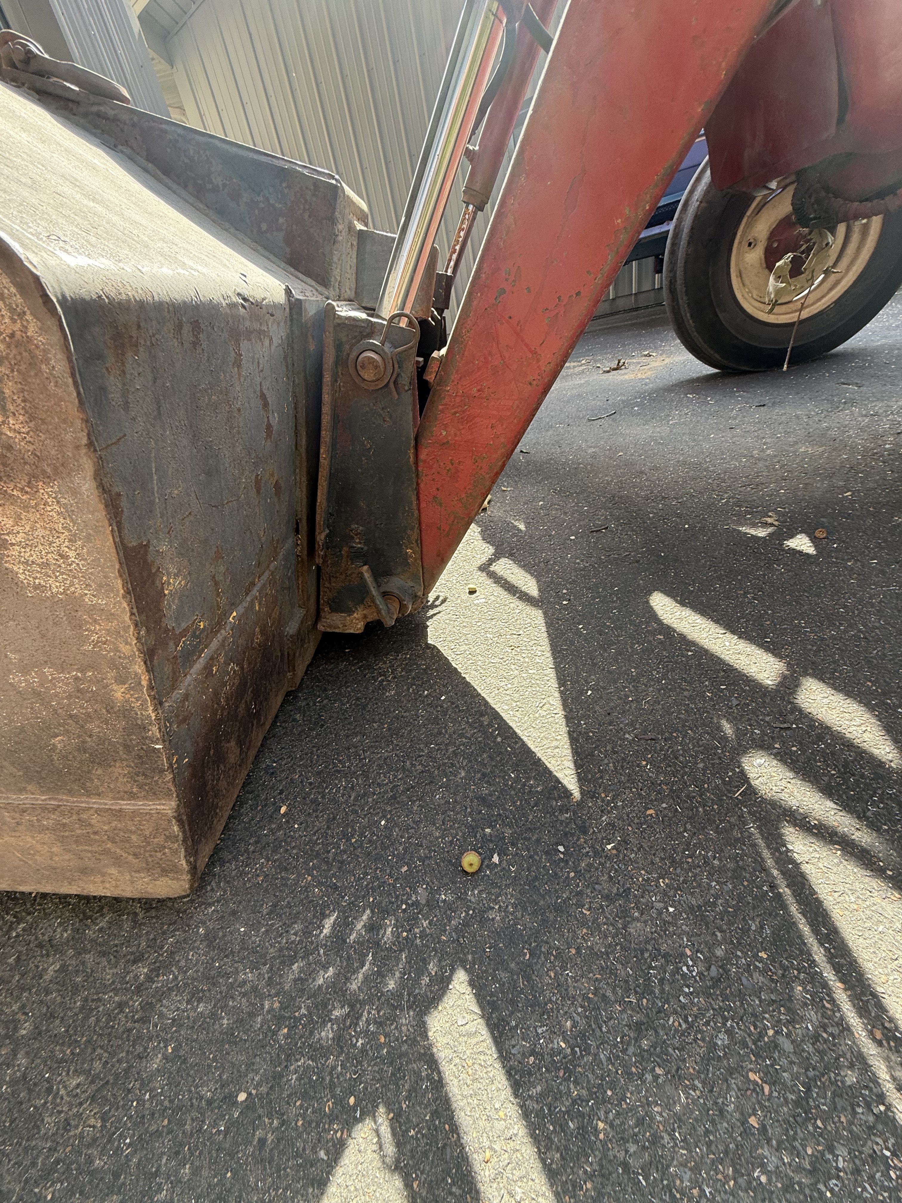

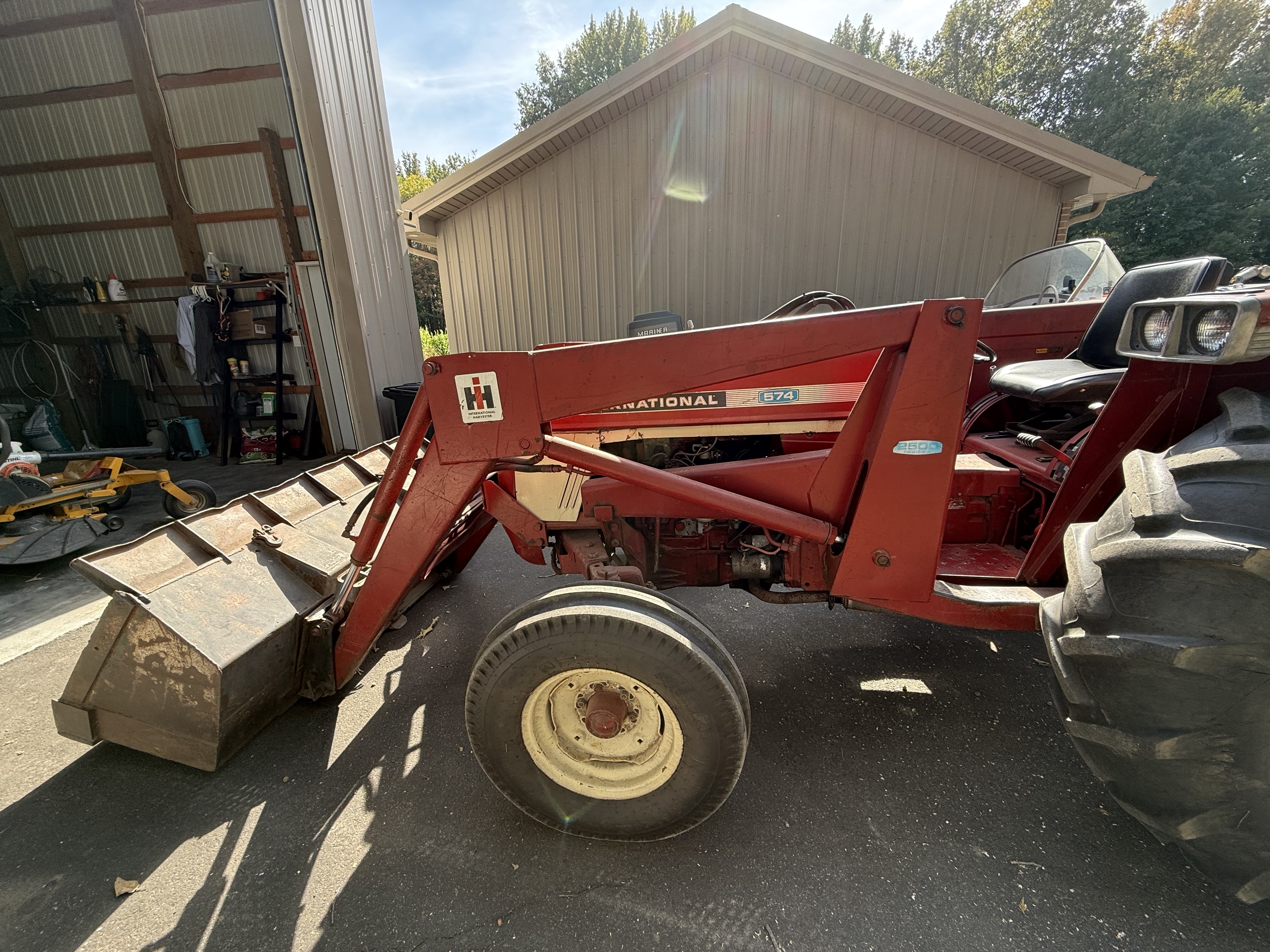

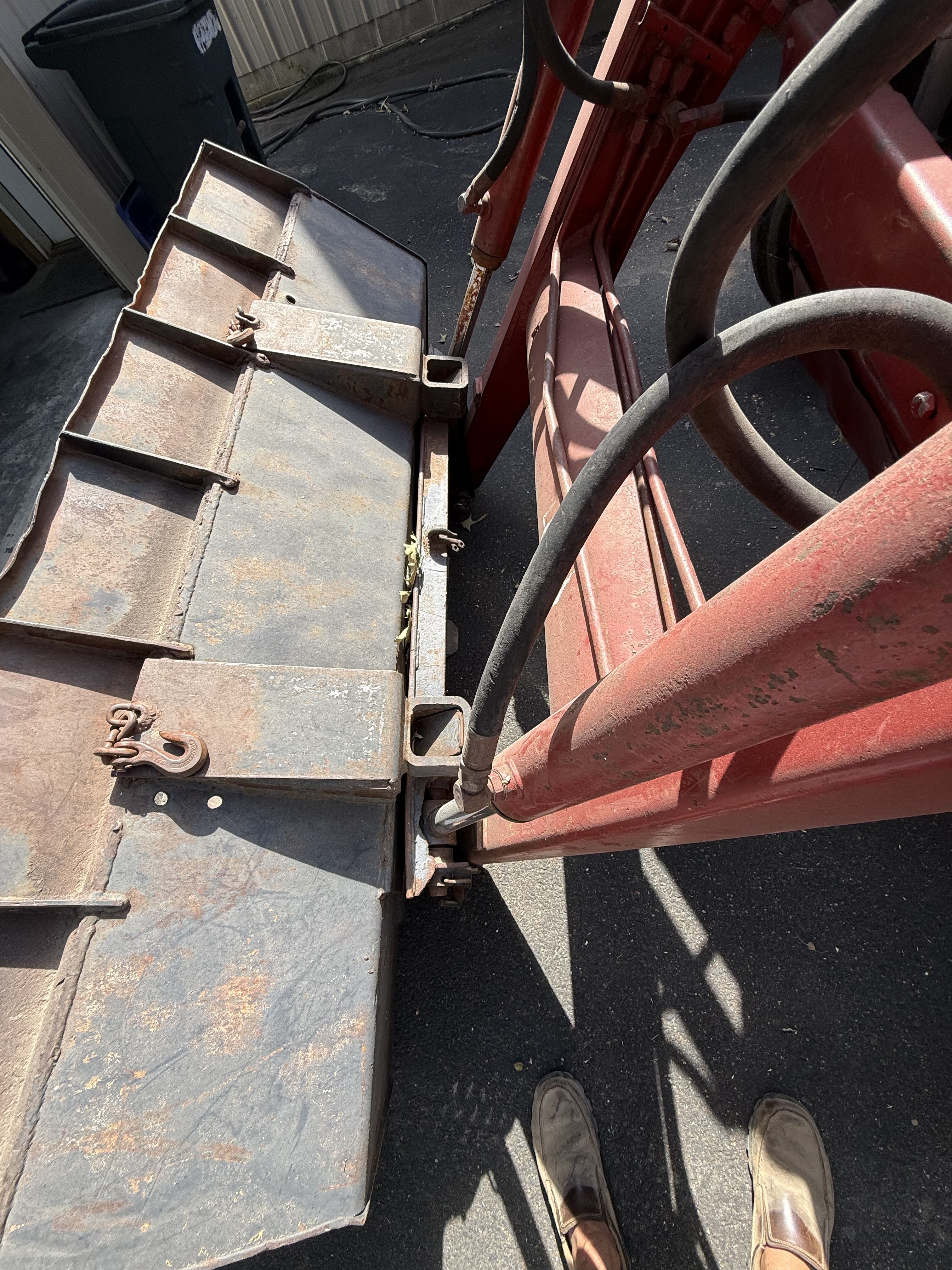

Hi sorry still figuring this out. The issue is the bucket is too large and hvy and there is slop in the cyl rod end pins I was hoping to find a pin on smaller bucket and get rid of this hvy quick attach but that looks like a long shot so wondered about using skid steer components. I am attaching photos to show what i am working with. I dont have a welder but have someone who can.

Looks like you could just buy a blank skid steer adaptor from Titan and have your existing brackets welded to it after a little clean up. Then buy your choice of skid steer buckets. You can weld a skid steer plate to your existing bucket for times when you need the wide bucket.

^^^^this now that we see it. As far as cylinder end slop, you could get bushings put in them and new pins if needed. Bucket is too big
I think the bucket size is deceiving due to the spill plate that has been added to it.
There are loader side adapters on eBay for much less than Titan's. You just need to add what you want to ears for those as well.
Your IH 2500 loader boom and bucket setup appears to be the same as my brother's IH 2250 loader, the only difference is the 2250 has the Mount-O-Matic frame and the optional the Quick Attach bucket attachment, see photos below.
Examining your photos, it would appear that your loader has some version of a bucket Quick Attach attachment.
The Skid Steer Quick Attach option has become more of a standard over time.

You may be right about the bucket , but I say it’s a foot too wide. The front rims have been turned so the tires stick out farther and that makes the bucket look not as wide. If he loads that bucket he will be repairing and replacing axle knees and spindles in the future
THANK YOU FOR THE INPUT !! very helpful and gives me some options. I wondered about the front wheel width. And yes that bucket is way to big for what i need.
