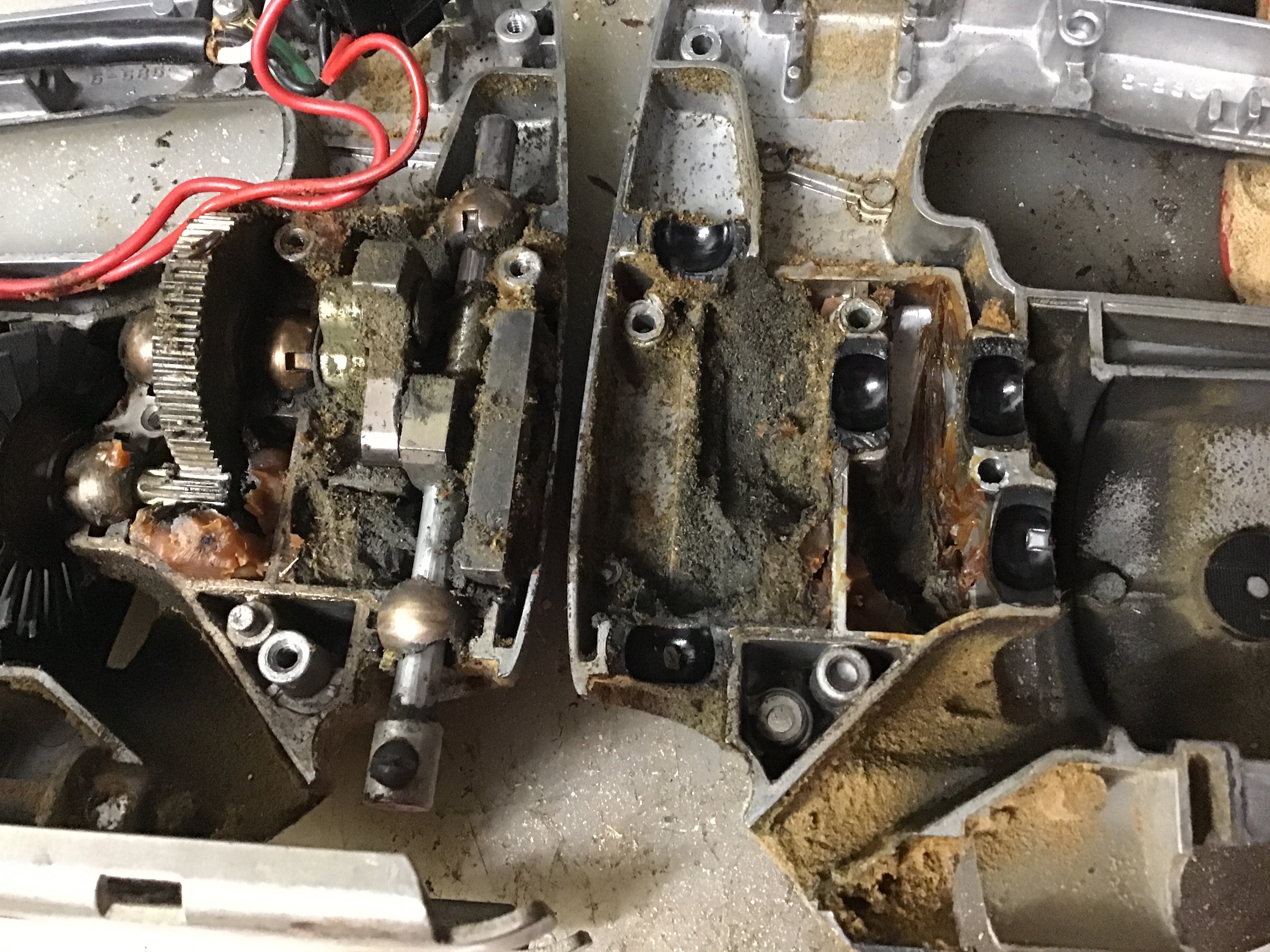

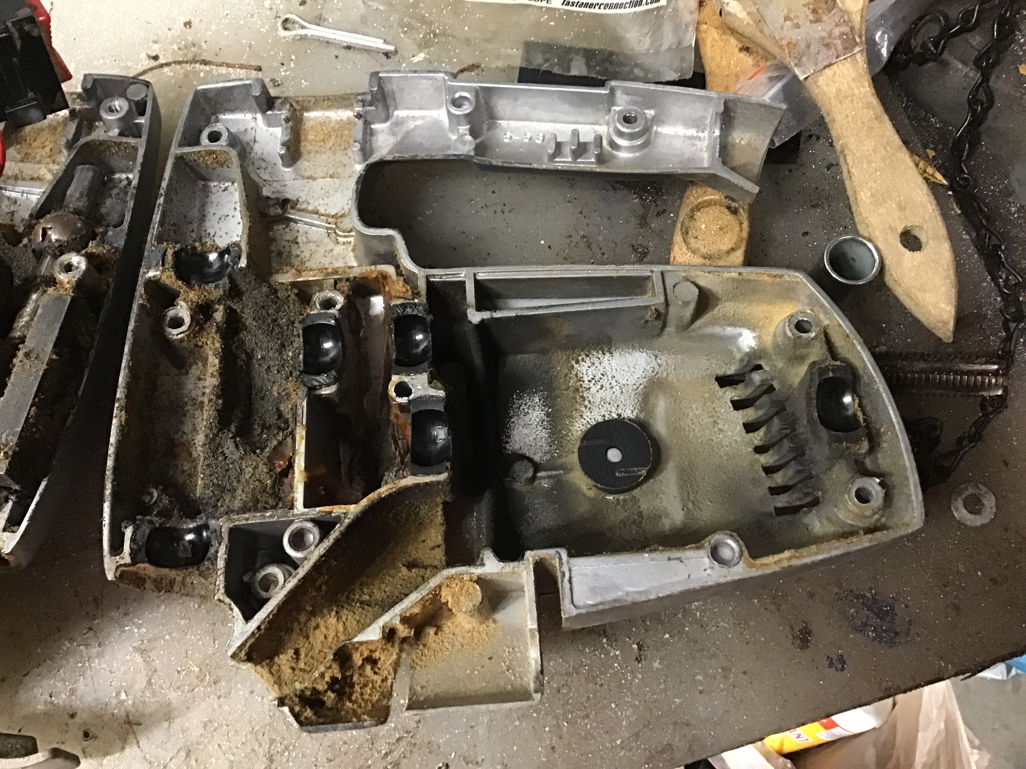

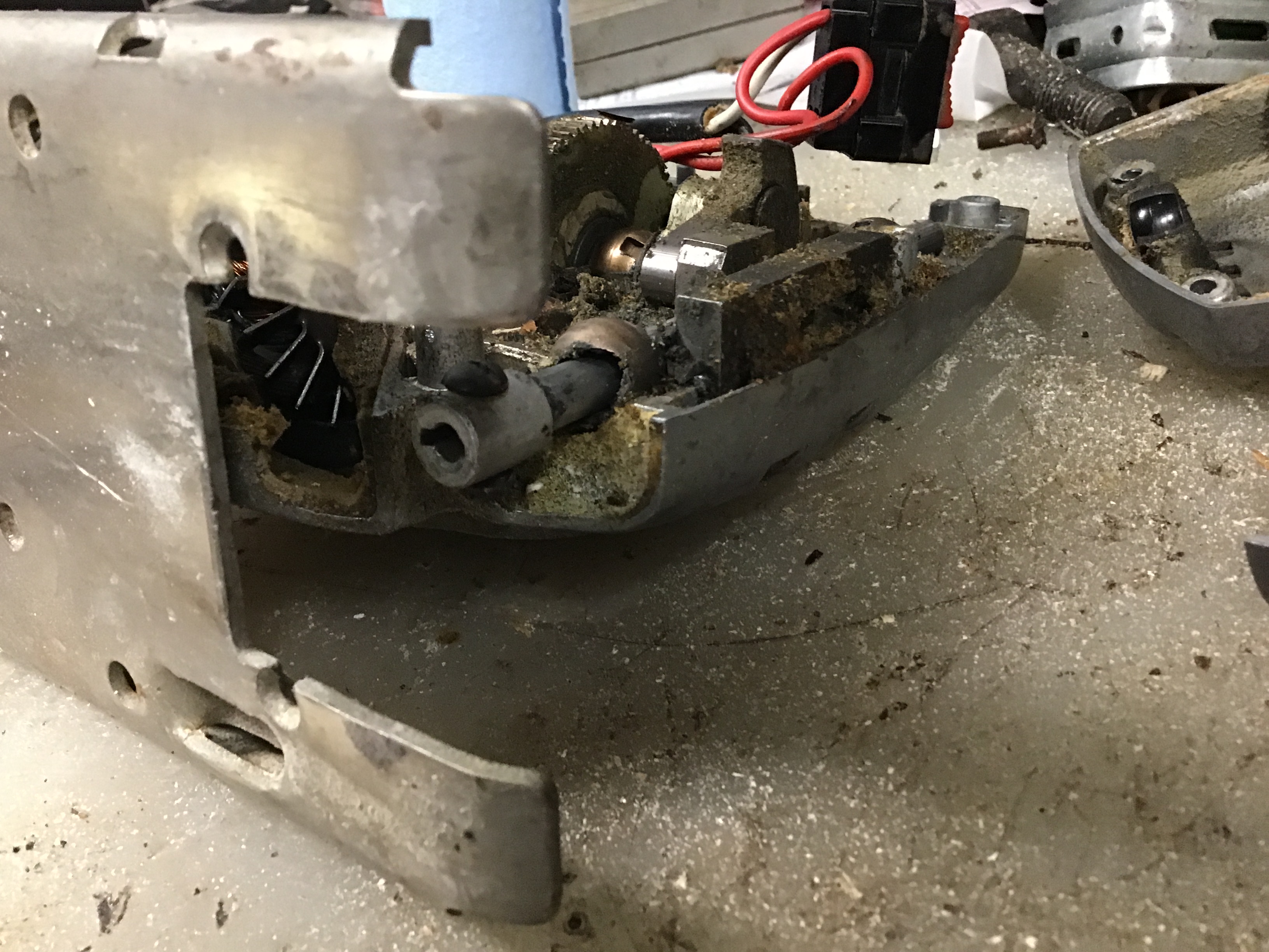

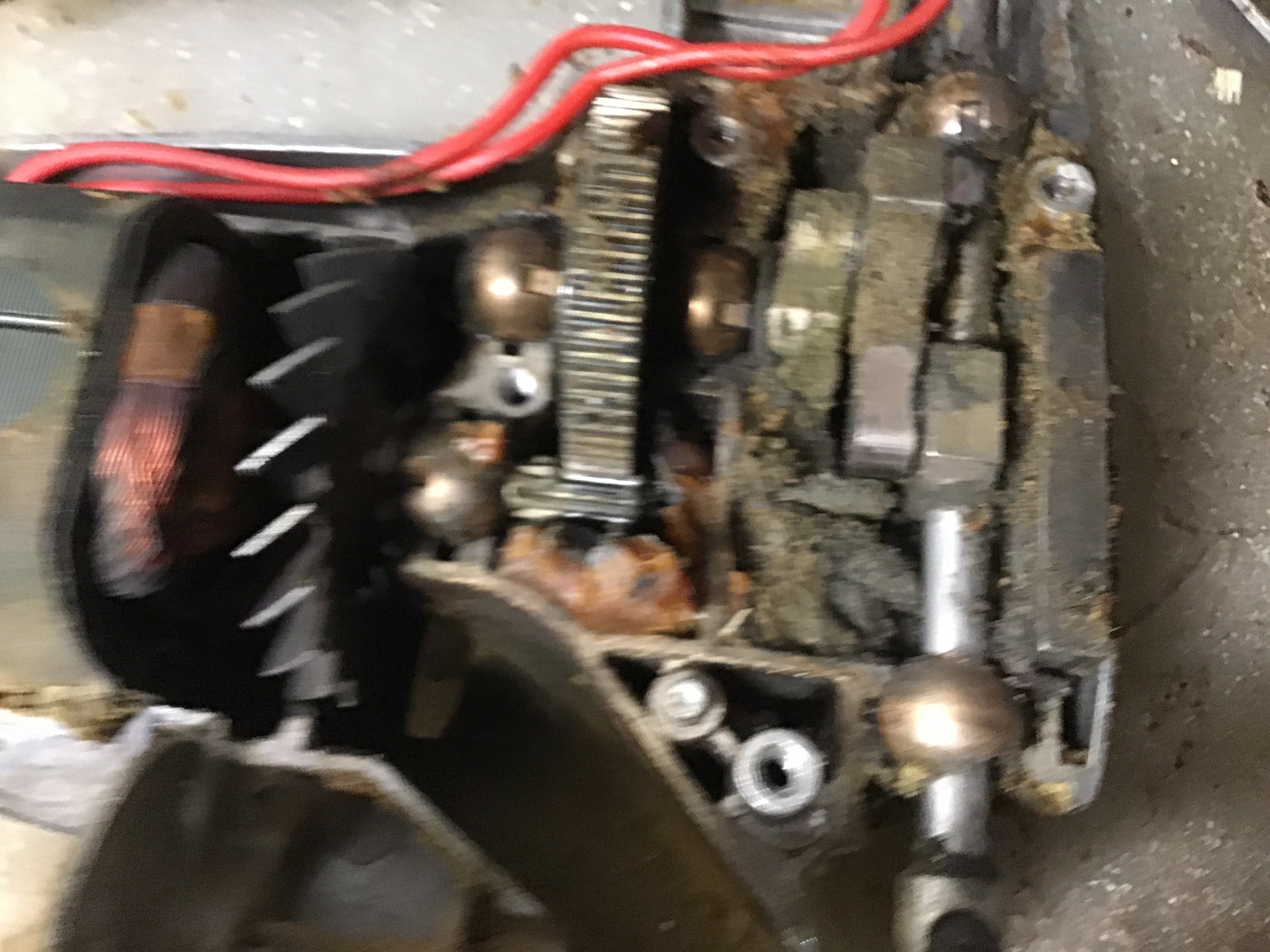

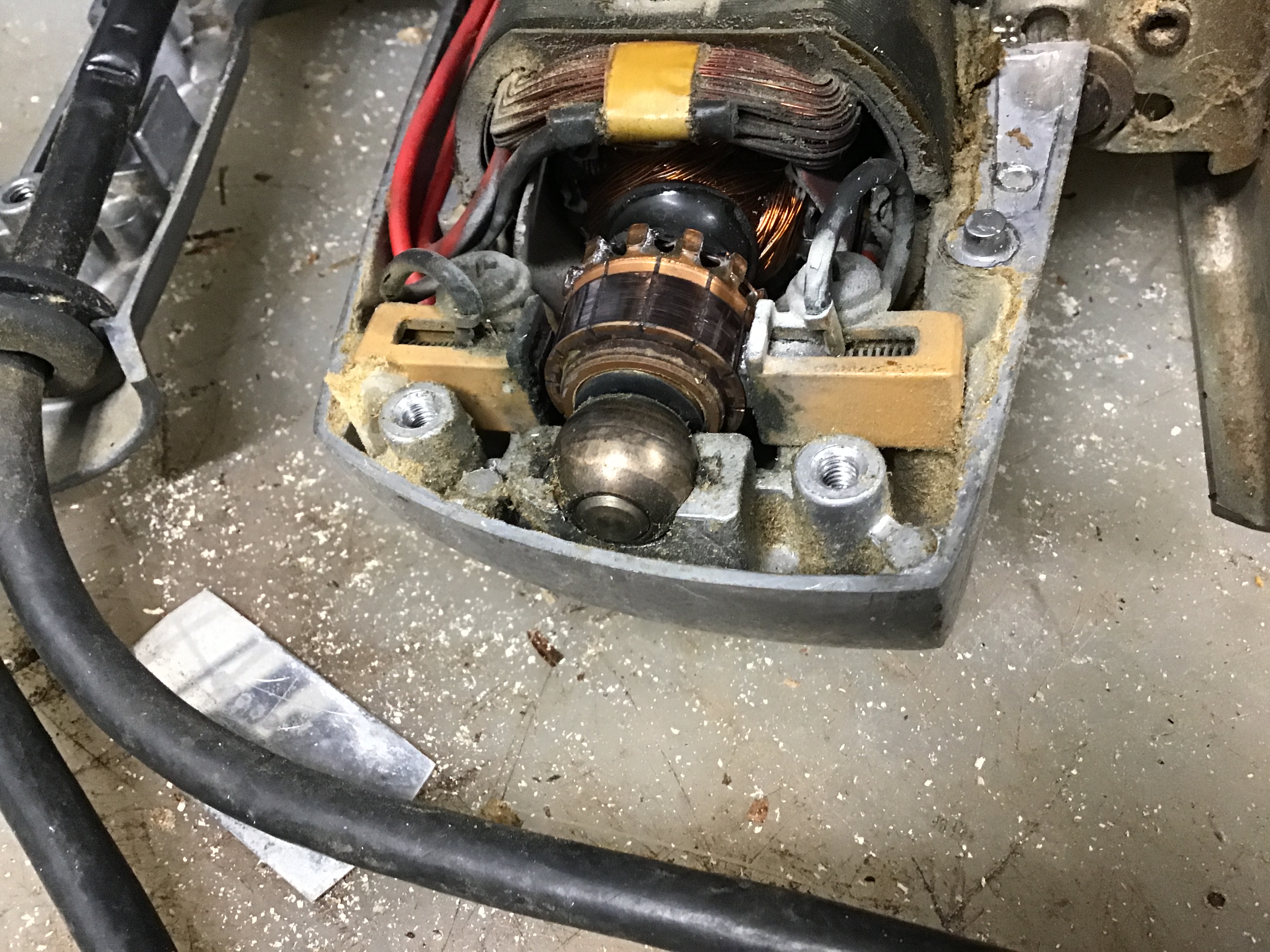

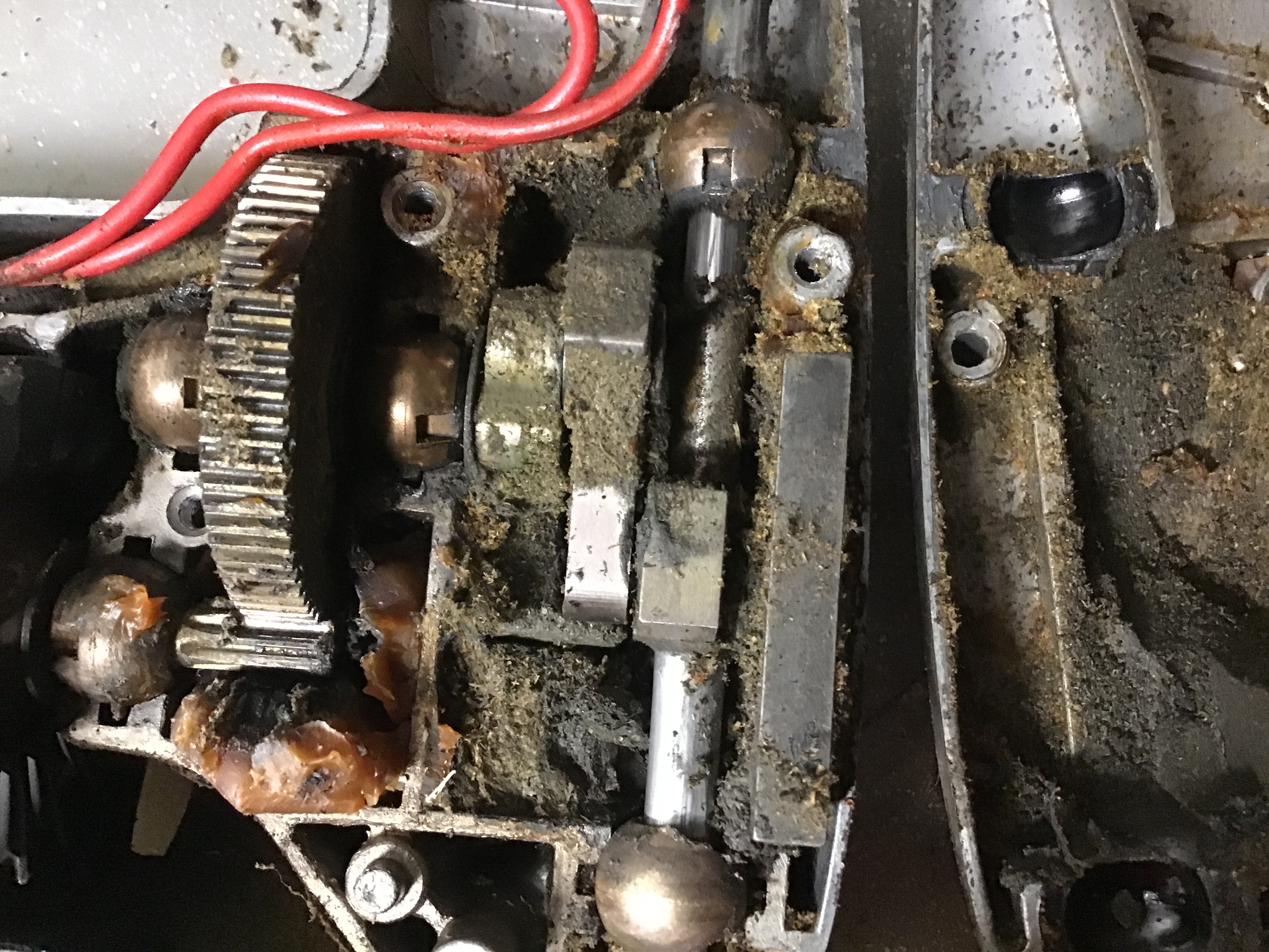

Posted photos to show you bearings design.
I had to open up my Sentry Sabre saw up to get out the on off switch to fix it. Found out more than I wanted to on the bearings. They are a plain bronze with Spherical trust od. Never seen them before. The one on the up down arbor is shot in photo, rotated it , to hold , doubt ful it will last long. I don’t know where to find any it’s so old,. If you know where to get them let me know. Thanks

Dennis, without measurements, I couldn't get very far, but I did find a bunch on eBay and elsewhere, searching for spherical bronze bushing. You might have to buy 1000 of them, but you'd have some spares theno_O steve
