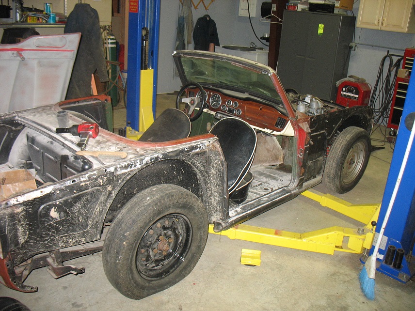

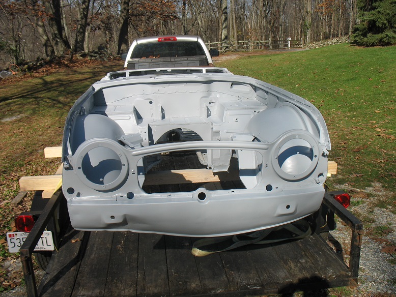

TR4 came to me as a non-running mess - botched frame off "restoration" that was a twisted mess of rusted panels, bondo, and bad welding. However unlike a lot of them it was complete and reasonably priced. It has been completely disassembled and is now in pieces:

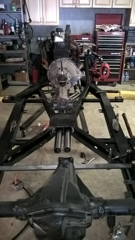

The frame has been blasted, primed, and painted. Currently installing the new front suspension and a front brake upgrade using Toyota dual piston calipers and vented rotors. Also opening up the center for a custom SS dual exhaust upgrade with quad resonators and tips - my version of the "classic" 1970's Abarth exhaust system sold for the TR6. Still debating whether I want to try and engineer a rear disc conversion while I have it all apart and on the lift. Brakes are pretty easy but fitting a suitable dual circuit master cylinder to the OEM pedal box is going to be a geometry challenge.
The tub has been blasted and primed and is waiting for me to get a rolling chassis back together so it can go back to the body doctor that did the blasting and priming. Needs major reconstructive surgery and I have stockpiled a truckload of new inner and outer sheet metal to go with it.
