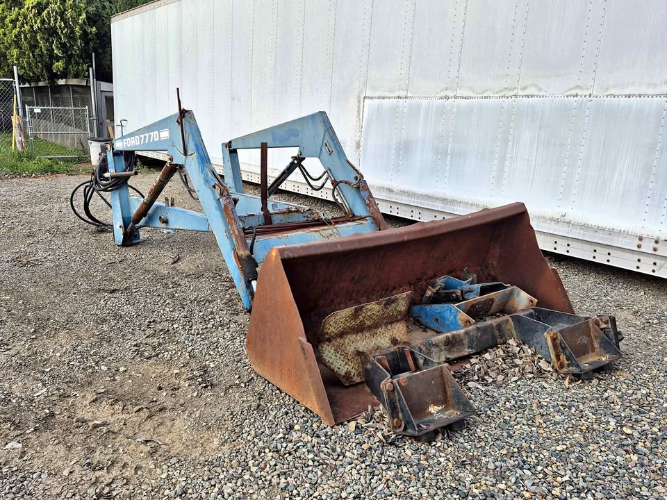

In the meantime, does anyone know if a 777D QT loader will work on my 4110?
Those are not the correct brackets for a 4110, they look to be for a 3cyl 4000, you’ll need the subframe brackets for a 3000/3600 to for your tractor
