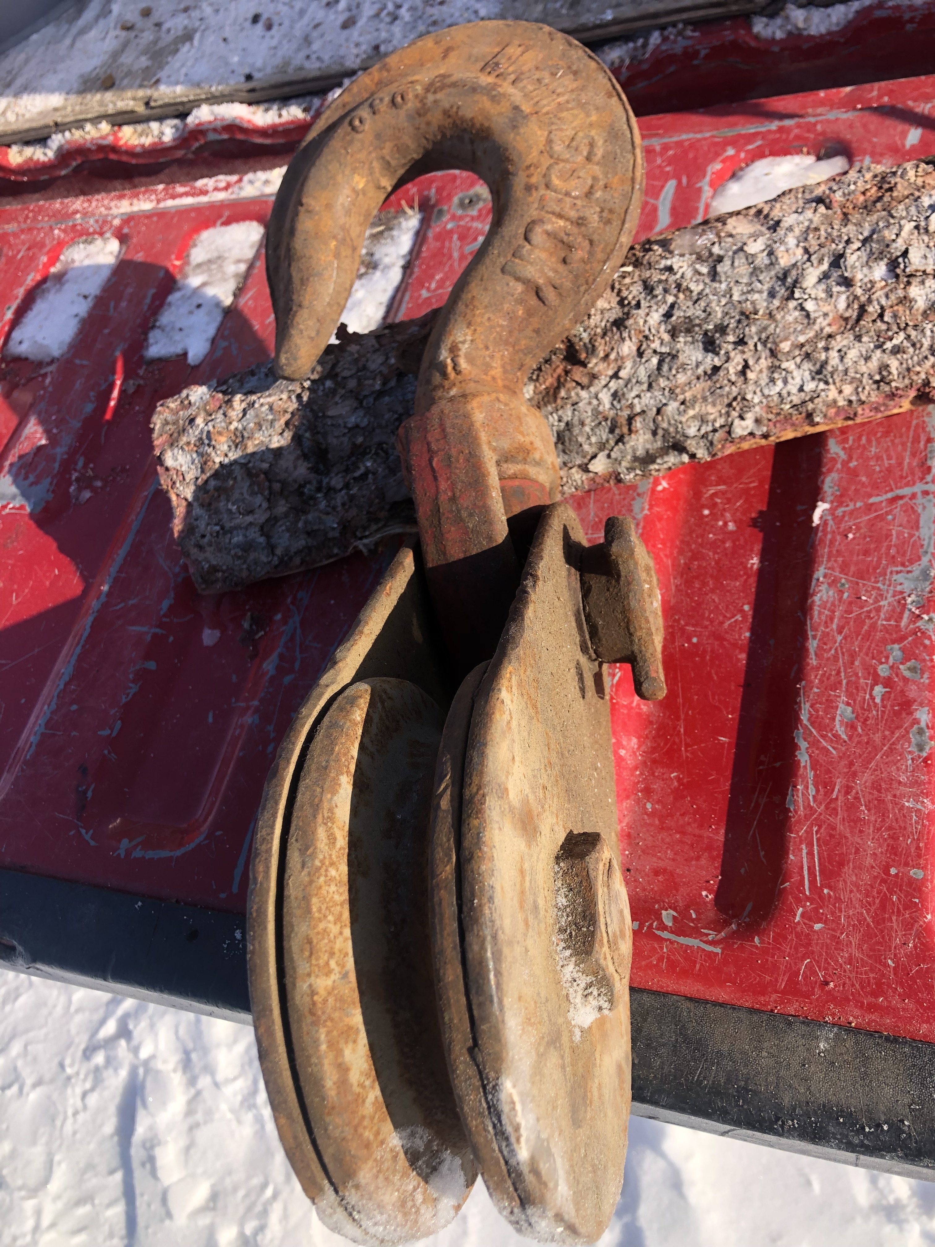

Do they make a snatch block for use with 5/16” or 3/8” logging chain?? I have a chain with me always for loading and pulling stuff and never carry a wire rope like most snatch blocks are used with. Pictured is a wire rope style block

A 5/16 chain will work on a snatch block no problem.

Sherman-reilly makes snatch blocks that our linemen use. This one has a 5000 lb capacity. They have other snatches that may better serve your specific needs.
Chain generally is not used for such as the links can catch on the frame of a sheave (pulley) block, The links will have high point loads where they contact a smooth sheave (I have seen pieces broken from aluminum/alloy sheave that had chain used in them), and chain failures are often an unforeseen break. Cable is smooth and won't catch the frame, load is spread onto the sheave more evenly and while failure can be immediate with severe overload, generally broken wires start appearing first.
That said if you want to use a block the chain needs to pass through it without catching the frame. Blocks, like the ones used on chain falls and com-a-longs, have pulleys designed to fit given lifting grade chains (links of these can vary with the manufacturer), off the shelf chains seldom fit them properly and twisting in a long run of chain can cause the links not to track on the sheave.
Look for "pocketed chain sheave"

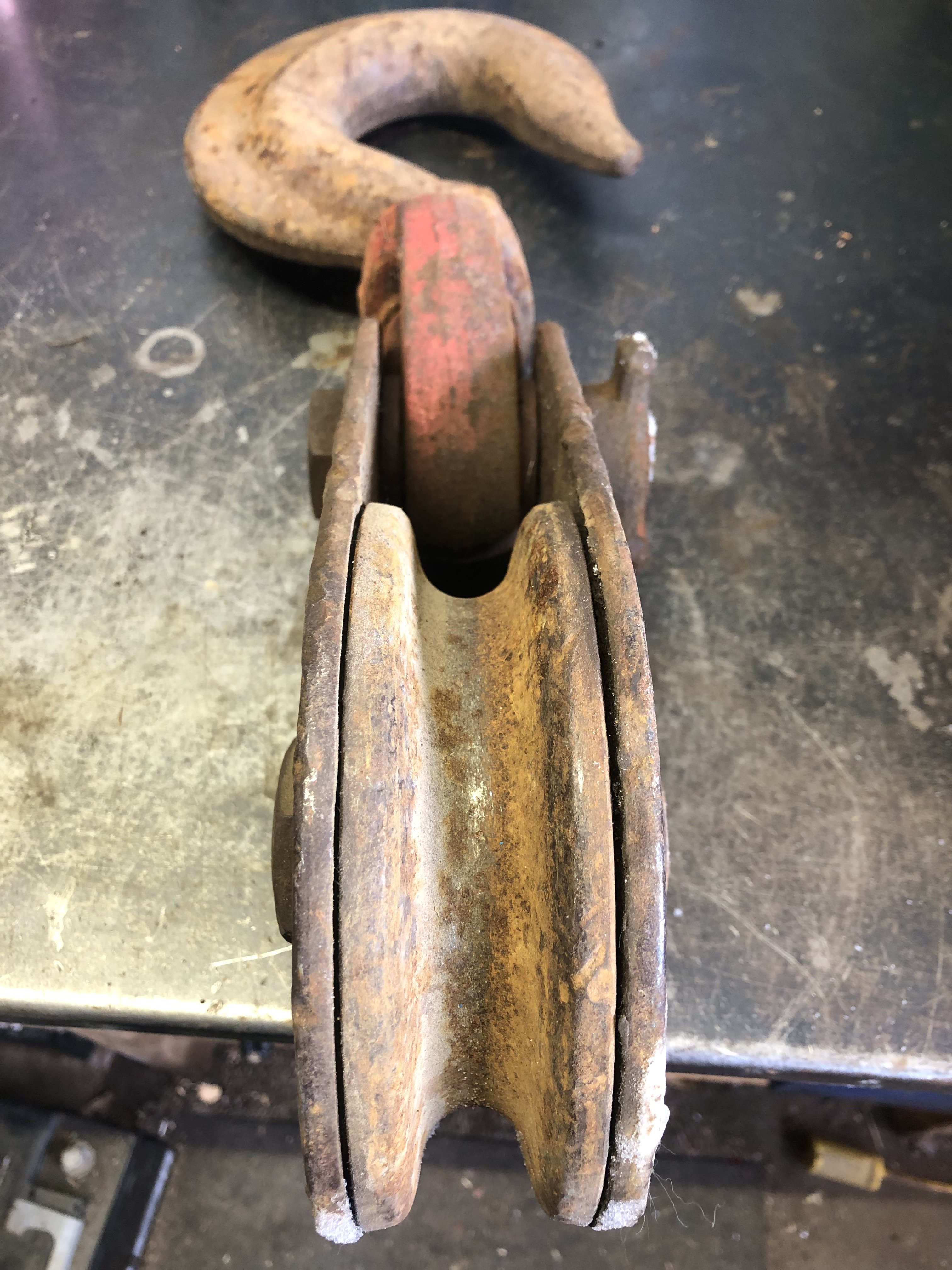

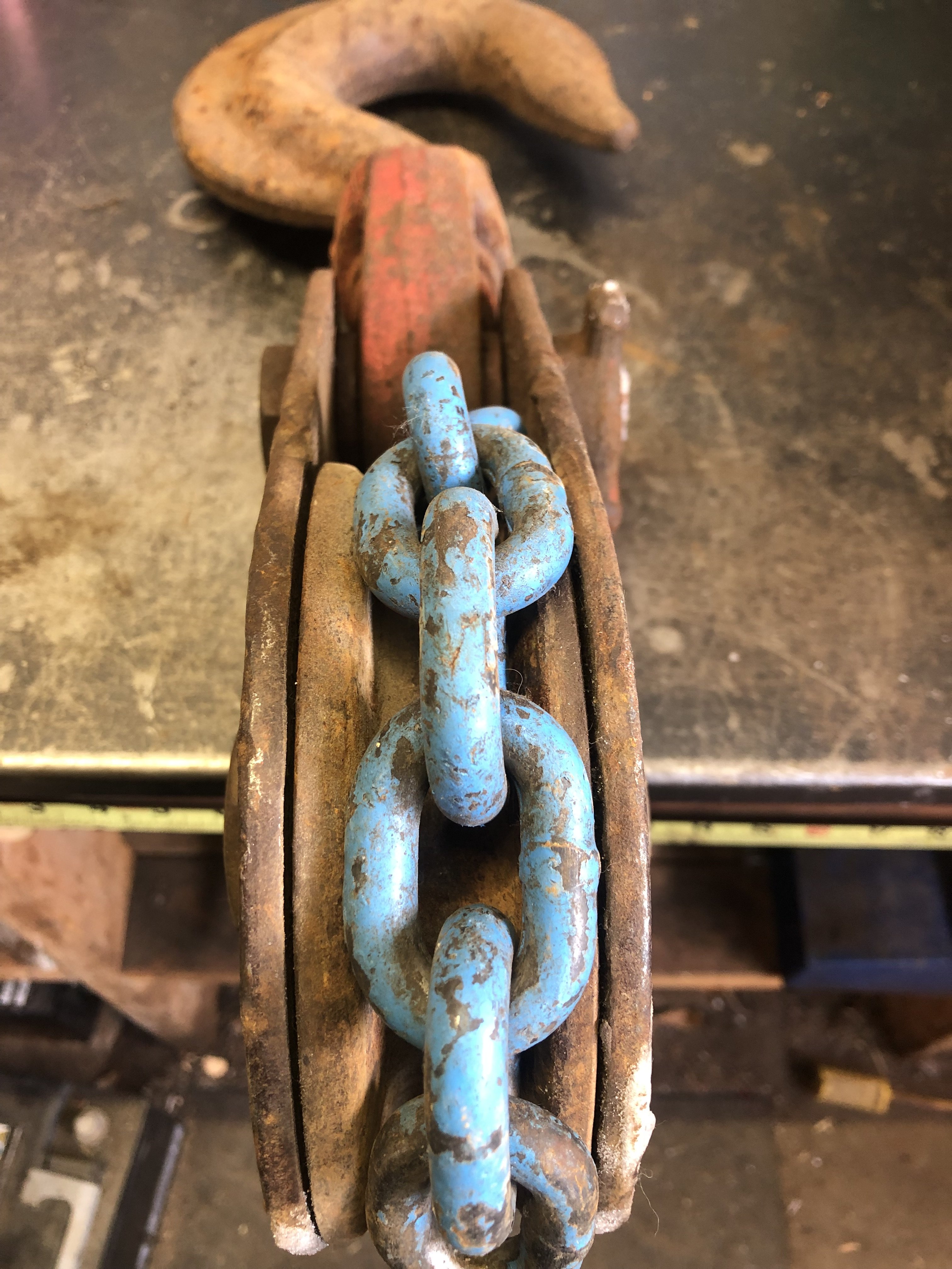

I have this 6 inch 8 ton mckissick snatch block and yes it will accept 3/8 chain. I posted this in another forum my mistake.

That set up is for demonstration purposes to show you can use a chain on these snatch blocks. It’s a piece of high grade chain. I use cable , but saying you don’t need anything special when ur in a bind. You can always make up yourself a length of cable to use when u need it.
What grade chain do you match to the pulley?
Pretty hard to match any grade of chain to a wire rope sheave. Just a case of using what you have, even if it isn't right.
A couple shorter chains with the right size cable running in the snatch block would be much better
