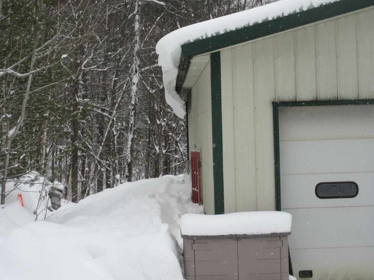

Yeah, if I had a metal roof on my house like I do on my Morton Building, I wouldn't have much need to rake it.
Sometimes the snow goes off like a landslide and sometimes it just takes it's time.
I often wondered why some roofs do what that is doing. I have seen pictures worse than that but have never seen that personally. It looks like wind can not get at it and the roof does not look very steep.
It's just a glacier.Just slowly creeps along,held back a little by the screw heads.The south side of my metal roof pretty much unloads with a roar,and the north slowly makes it's way off slowly.The snow on my north side is just starting to creep off,it stayed there for a whole week in the intense cold.I have to scooch down to look out my front windows right now,the upper halves have a snow curtain hanging down in front of them.
