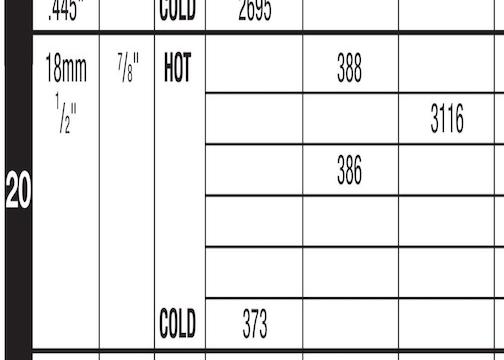

My cousin took out all 4 plugs. This is what they look like. He also sent along a heat range chart for Autolite plugs. I took out 3116, should I replace with 388 s? Stay with the same plug. change brands or just put these back in? I relly don't understand about heat ranges.

I'm with Duner: Plugs look good to me. I'd keep running them - save your money for fluid changes and other maintenance/tune-up/repair.
Regarding heat-ranges: The 'heat range' refers to how fast a plug dissipates heat. A hotter heat-range plug dissipates/conducts heat to the head slower, so the plug itself will be hotter and burn off oil/carbon/fuel easier. But you don't want to run hotter than necessary and cook/crack the electrode/ceramic. Those plugs don't look too new, but still look quite good. So if they look that good after (presumably) being in there for at least a few years, I'd think the plug spec and heat-range is good.

The Autolite 3116 is the only plug I recommend for your tractor. It is a Non-Resistor, Extended Tip. The 388 is a resistor plug, regular tip for use where there are radios, ect. The less resistance the better. Check your wires to be sure they are Copper Core and not "Resistor" wires. If they say "Carbon Core", or "Resistor", replace them. As nice as those plugs are burning, my guess is that you have Copper Core wires already.

Good idea to do a compression test also. Number 3 looks more fouled. The others look pretty good. Heat ranges ,… the harder the tractor gets worked the colder the plug u use. The lighter stop and starts you need a hotter plug. That’s one of my favorite cases , the 400. Post a pic of it.
