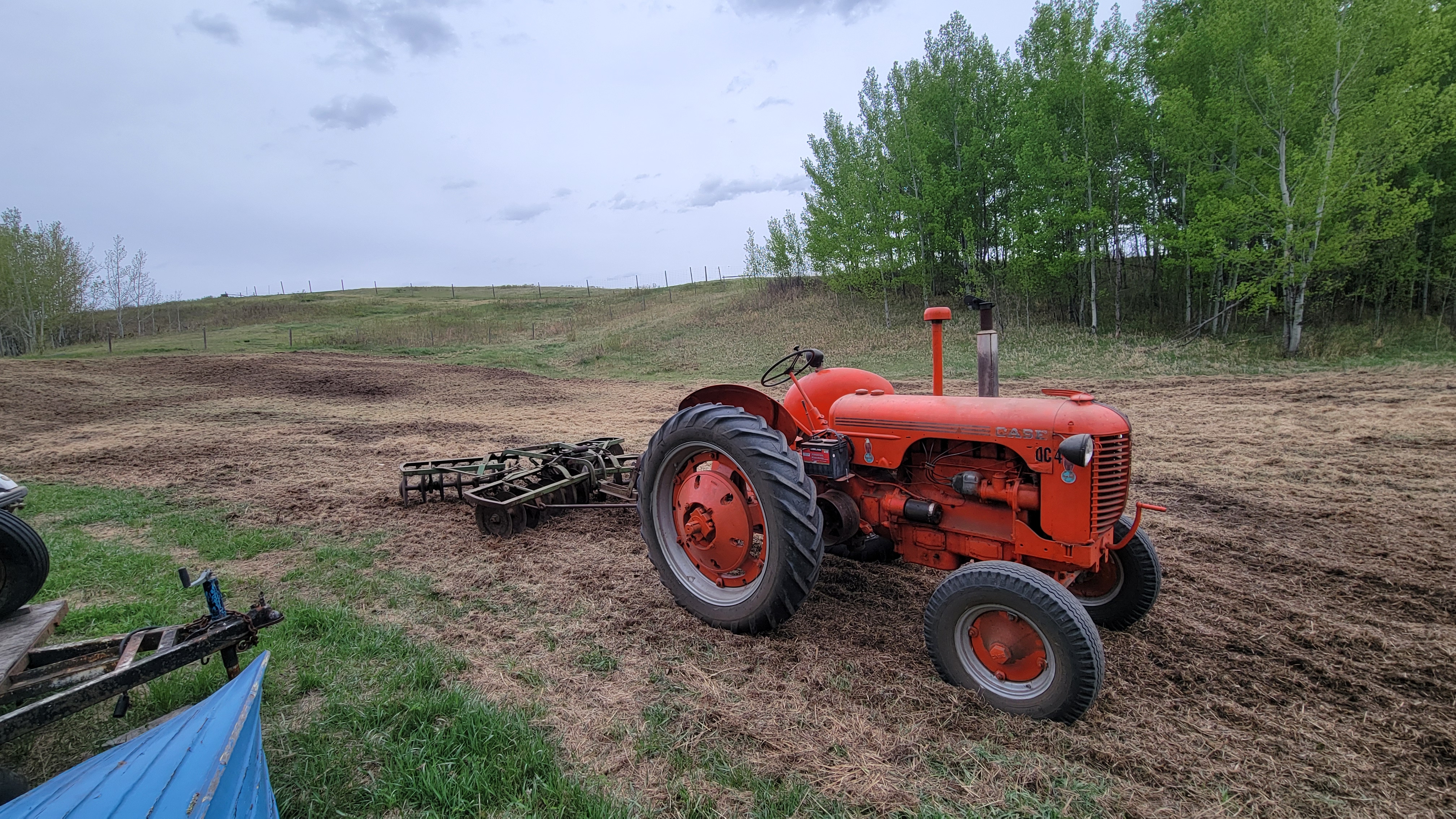

I just moved and the manual for my Case tractor is packed away in a box somewhere. Does anyone know what the spark plug number is for this old case? I need to put resistor plugs in this tractor as the wife said that as long as that tractor engine was running, the OTA TV signal in the house was really bad lolol. I was almost 300 feet away from the house too! I'm likely affecting the neighbors, although they are quite far away.
We bought a bigger acreage and I actually have a bit of space to put the old case to work. Previous owner of the property left about a 10 foot wide JD double row (if that's what it's called) disc harrow and I used it for about 2 hours on the weekend. I was really impressed as to how easily the tractor pulled it, in second gear no problem. Even tested it up a steep hill, the governor just gave it some throttle and it never stalled out. My late Grandfather gave me this DC4 before he passed away, I'm very honored to be able to put it to good use. Need to change the oil, it still has his oil in it haha.

NEVER use a Resistor plug on a Magneto ignition. Will shorten the life of a Magneto. Autolite 3116 is the only plug we recommend for all CASE tractors except the SC which requires a 437. Besides, if the interference is coming from the tractor, which I question, it is coming from the wires and magneto.
Agreed John, we all ran mags years ago and when fairly close there could be interference but never while we were in the field, I am wondering if there may be some bad wires contributing to the noise.

The spark plug wires are new solid core wires I installed a few years back, with only a few hours of use, and it's parked inside all the time. The spark plugs were replaced at that time and are working fine as is. More testing will have to be done, maybe something else was messing up the TV that afternoon.

We've had the SC running a PTO Generator just outside the house when the power was out, not over 30' from the TV and no interference. I forgot to mention that solid metal wires, as opposed to silicone or resistor wires are a must also.

all them old tractors used champion D 16 plugs as a standard plug when new. select a heat range accordingly. that was one simple thing. massey, ihc case, m.m. and solid core wires are a must.

I recommend something other than champion plugs, case tractors don't like champions for some reason. Even my dad said way back the the dc didn't run right on champion plugs. My dc will have intermittent misses with them.
Jon, I was going to refrain from this discussion because I have made my case years ago and am not depending on second or third hand rumors. In the 60s I was a firm believer in Champ plugs and used either D16s or D15Ys exclusively in my Case tune ups at the dealership I worked for my 50+ year career. When the Government started the emission reduction stuff, suddenly I found myself having to run service calls to replace recently installed Champ plugs because of fouling, this was bad enough that we as dealership were forced to make a change. We went to Autolite and never looked back. I am not saying Champ is a poorly designed plug or inferior in any way, I have noticed in comments on here every once in a while by people who are using Champs that a lot of times they are using D21s which is a lot hotter plug than the D16 and should alleviate fouling issues. Ethanol blended fuels run cooler and I believe tended to keep the plugs insulators from staying dry and passing current instead of the spark jumping the gap. This is my experience, I can see that others may not have the same result as I but we are further North and our climates temperatures may be a contributing factor. I am not saying that Autolites are the only plug, I have used NGK successfully, I think heat range for the temp and fuel used is the real issue. People Like John Saeli that serve the public as he does cannot put out a product that fails and I know he is in my corner on this issue as I have seen his posts as well.

Many years ago we used a DC4 for blowing silage and it continually fouled the Champion d 16 plugs, even under such a hard load, that we kept a supply of new spares in the toolbox. An old mechanic friend suggested switching to Autolite and we never looked back. Don
You can’t be blaming spark plugs with an engine that uses oil or is worn out. Any plug will foul. I don’t believe for one minute to blame champion plugs as they are in my D and DC tractors and easy to start and no missing. Your busted . Seams the same old story keeps getting repeated and passed down. Maybe make sure the timing and point gap and carb is set correctly which will tell the story in its self.
