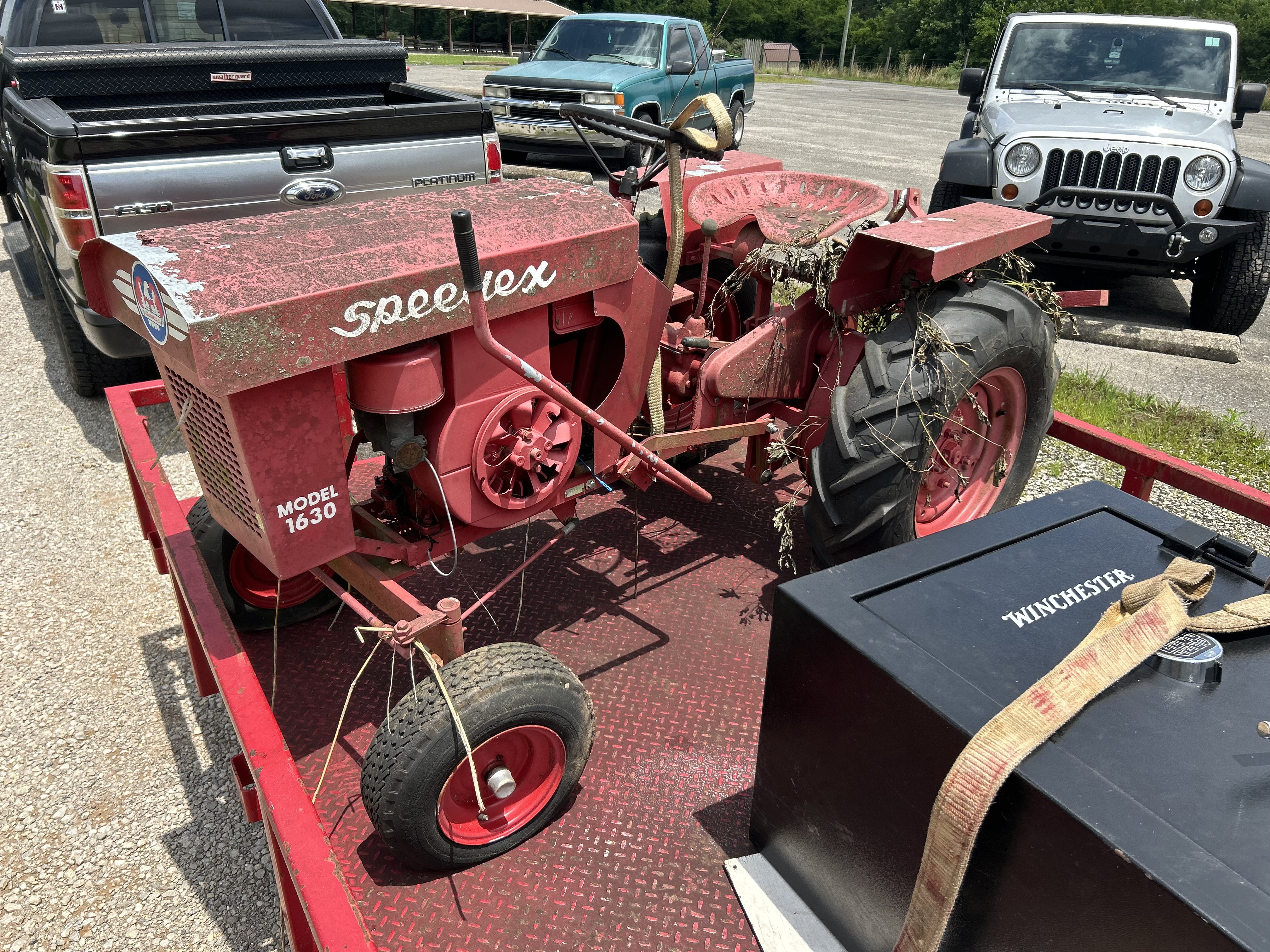

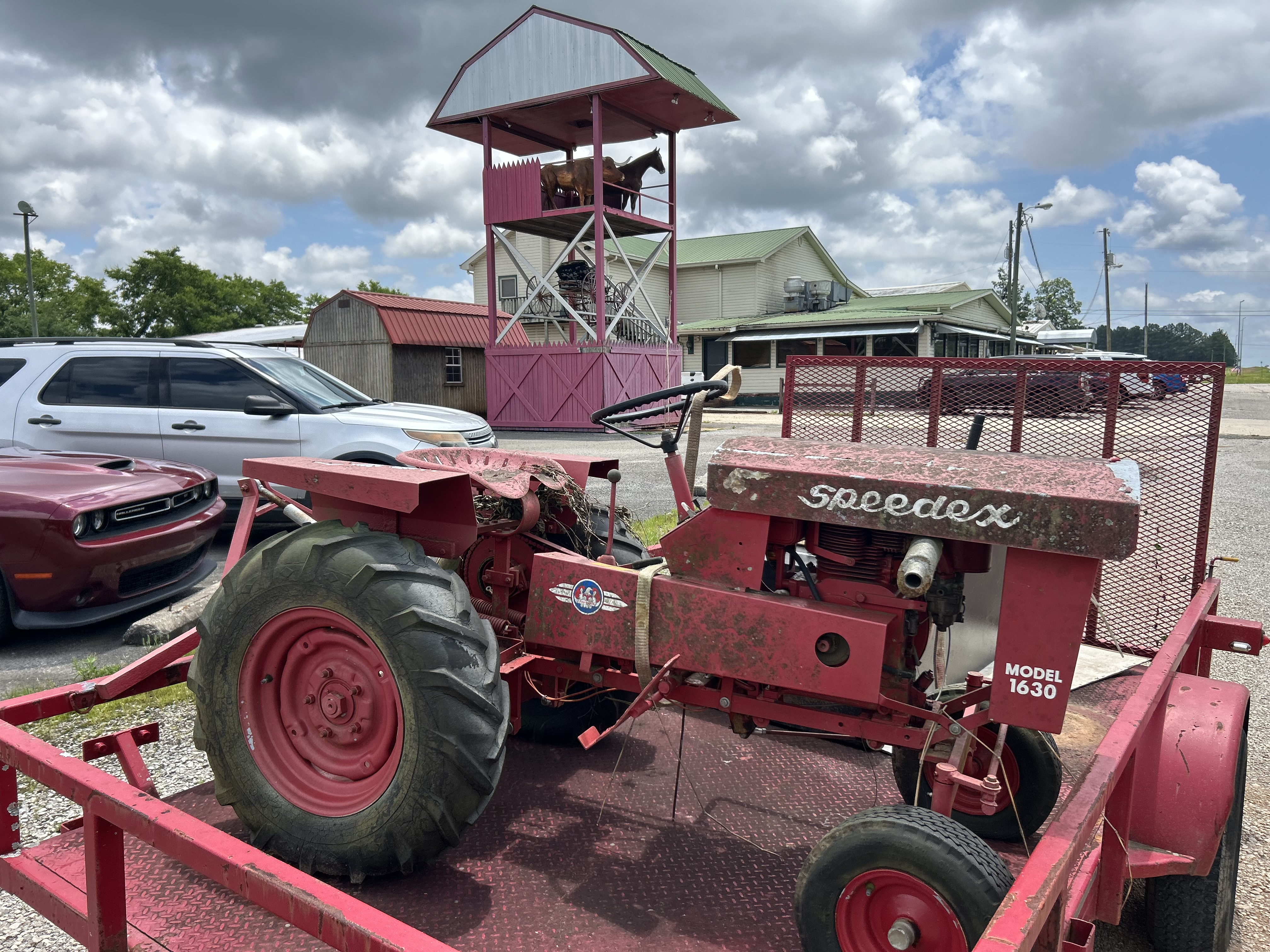

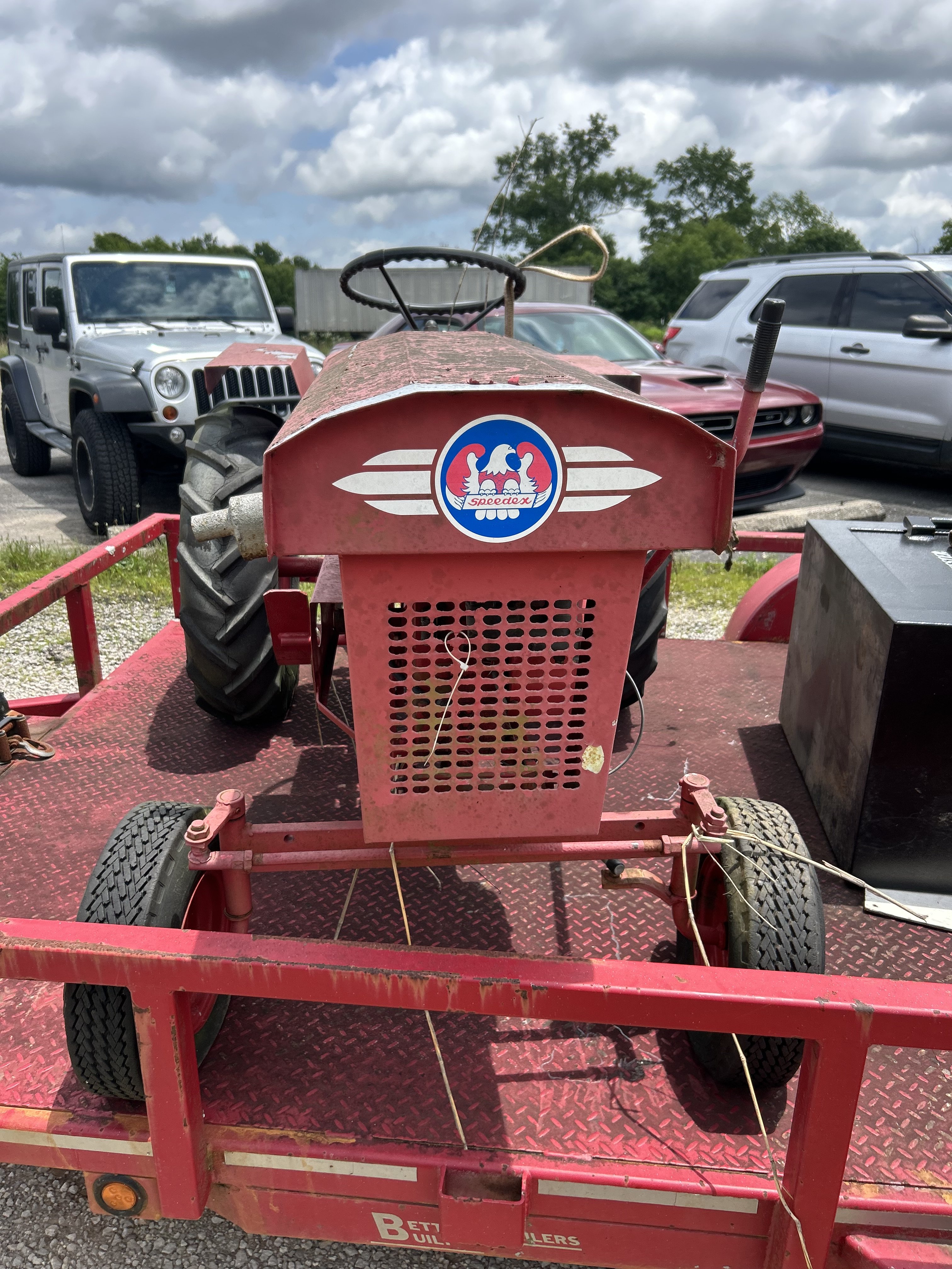

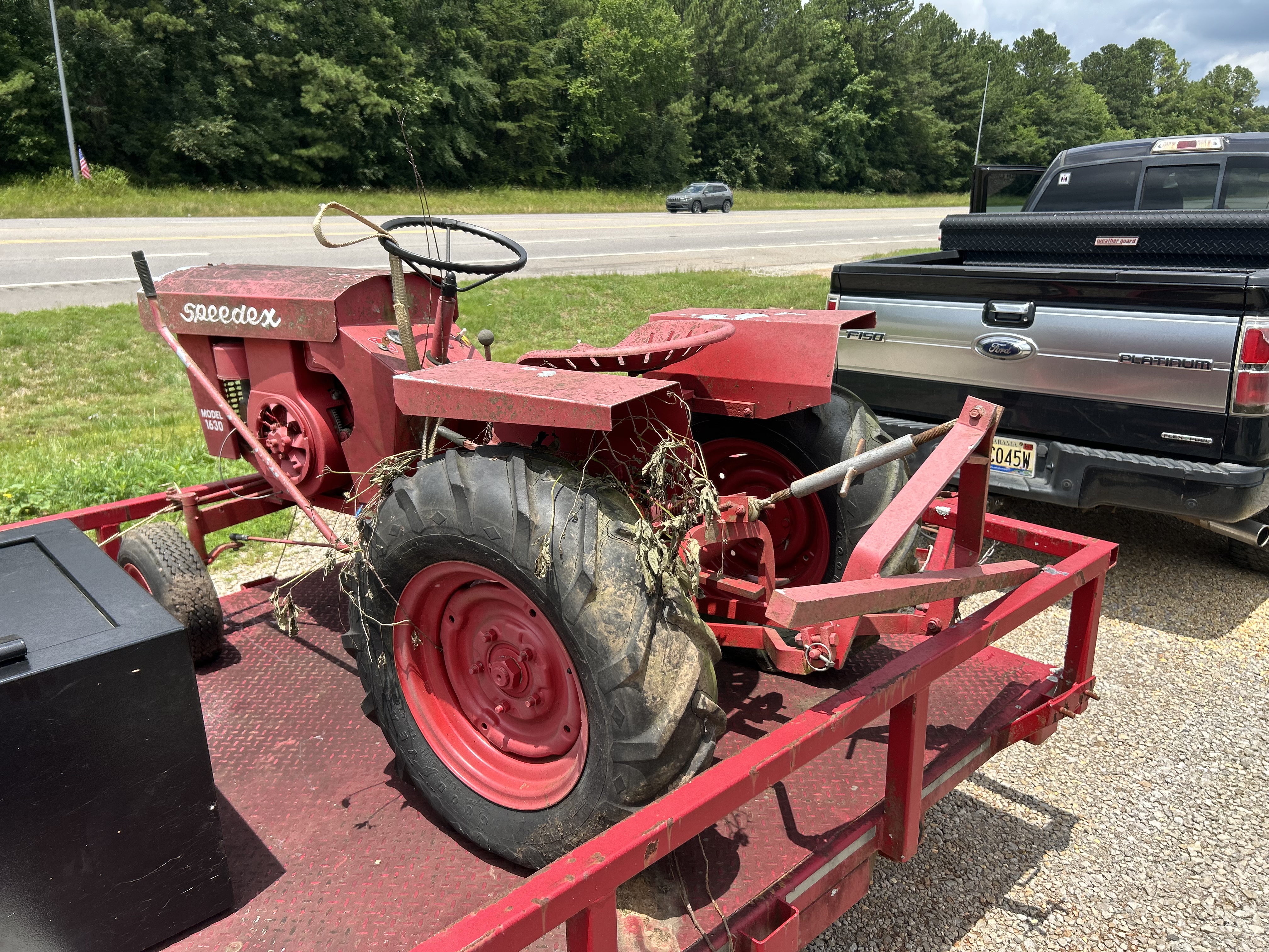

I ended up buying this (or one of them - there were 2), and plan on doing a light restoration/refurbish. Will post soon (next month or two) about this and I'm sure I'll have some questions.
It has sat where it was unloaded 6 years ago (outside) and figured I should give it the justice it deserves for leaving it out. It had a decent amature restoration when I got it. Just now getting around to getting it running and looking it over good.
