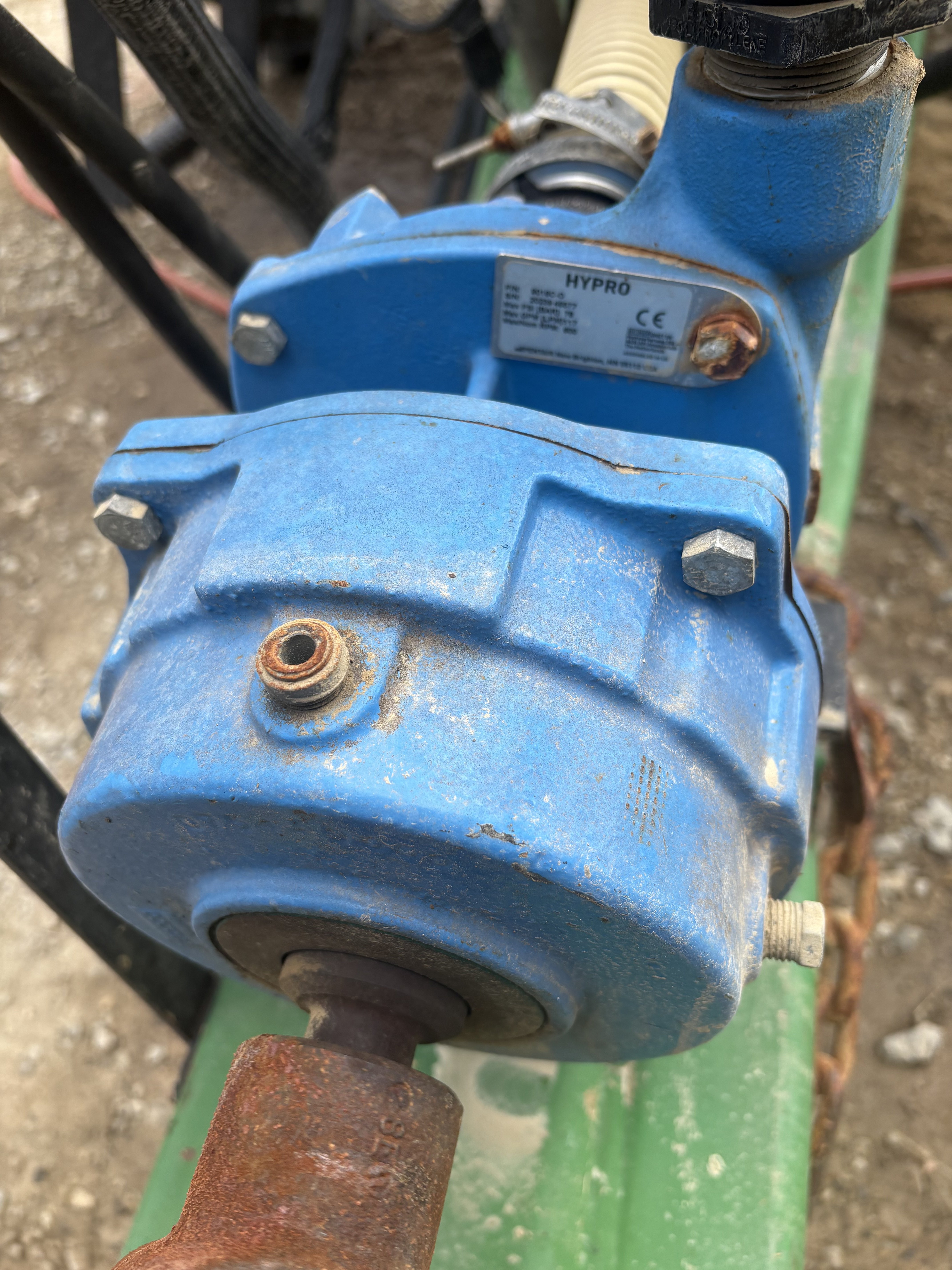

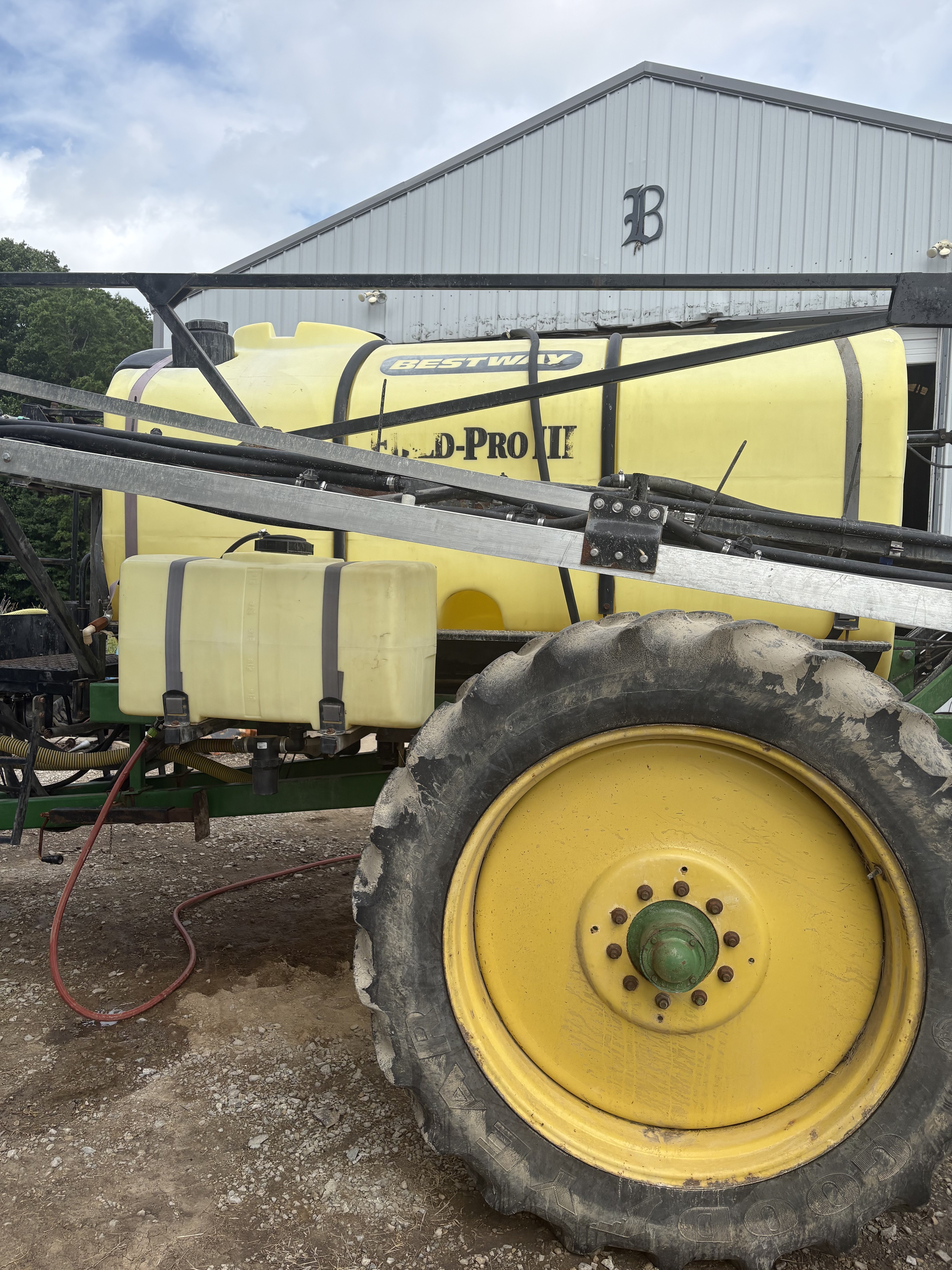

This is the pump I put on my 80 foot field sprayer, 540 pto, gear drive centrifuge pump. I am spraying at 15 gal ac at 5 mph. You might be able to get 40 foot with a 12 roller pump but you need to spec it out.
