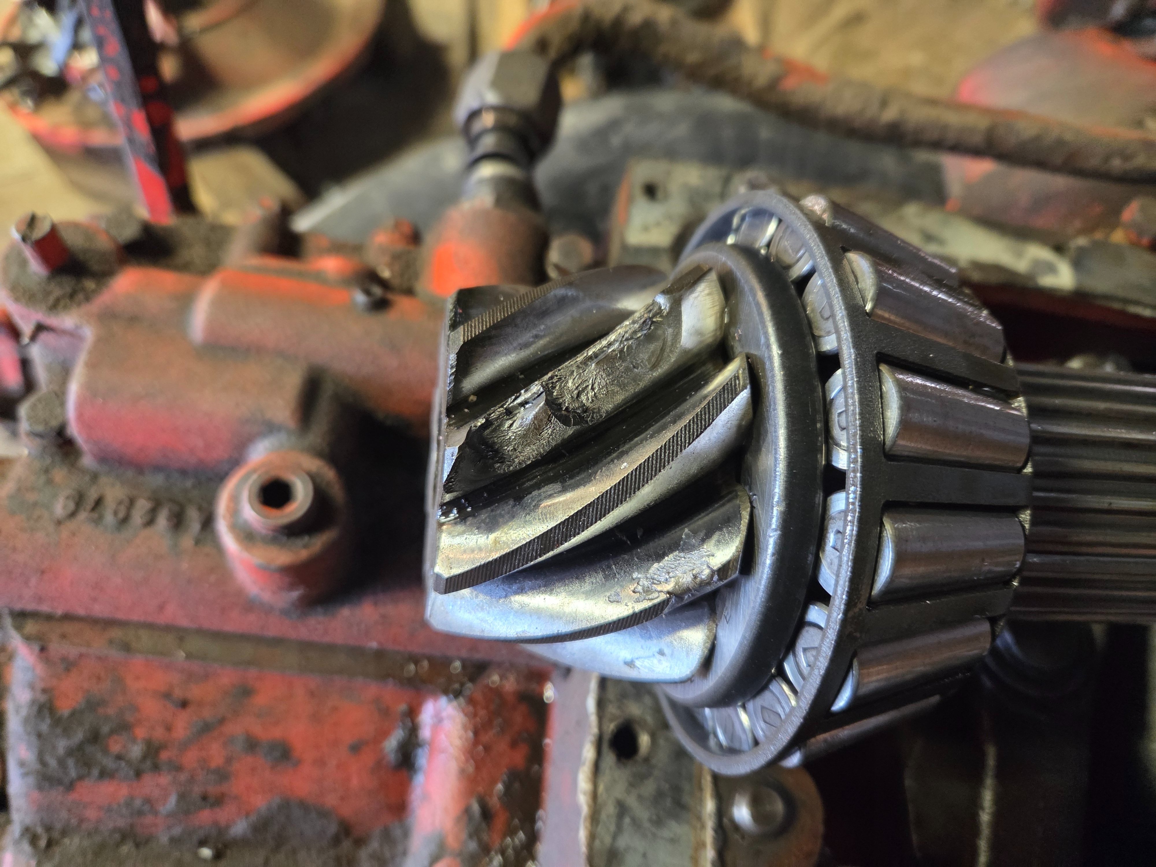

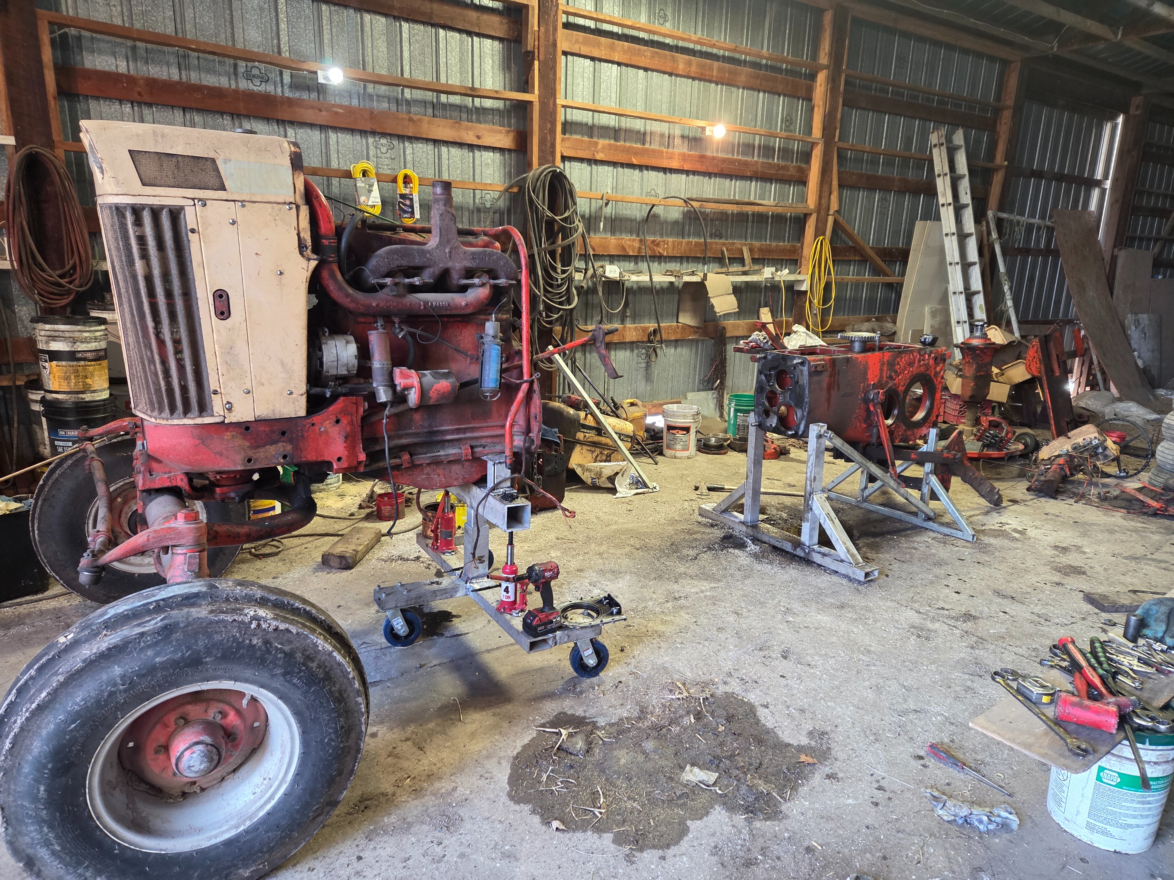

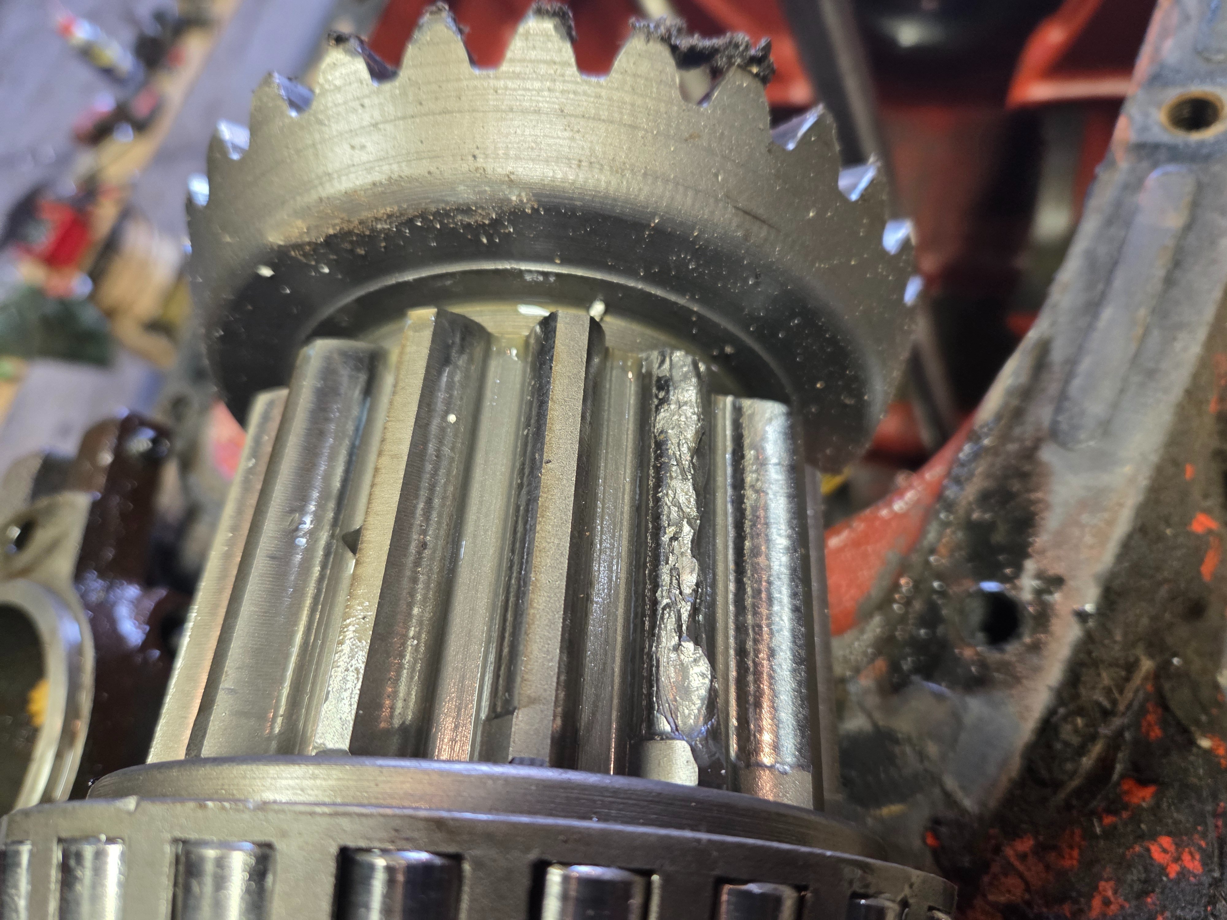

The tractor project is my 830, last year I overhauled the engine and case-o-matic. Then last spring and axle bearing went out and the parts got in the rear end gears and destroyed them. So yesterday with the help of my friend doug we took it apart. I built some stands to make things easier.
The main pinion and spur gears were all destroyed.
View attachment 143973View attachment 143974
The spider gears weren't damaged but show wear and the oil slinger gear in the high/low part is toast too, but that is not uncommon as they are just plastic. Also found that the pinion was bad anyway because the nut that holds everything had stripped and it was loose. When the axle bearing went out it broke the axle housing as well which I guess is common. Not sure i would fix it, but since I did the engine and com last year I will. Guess the retirement fund is going to take a hit. Lol
