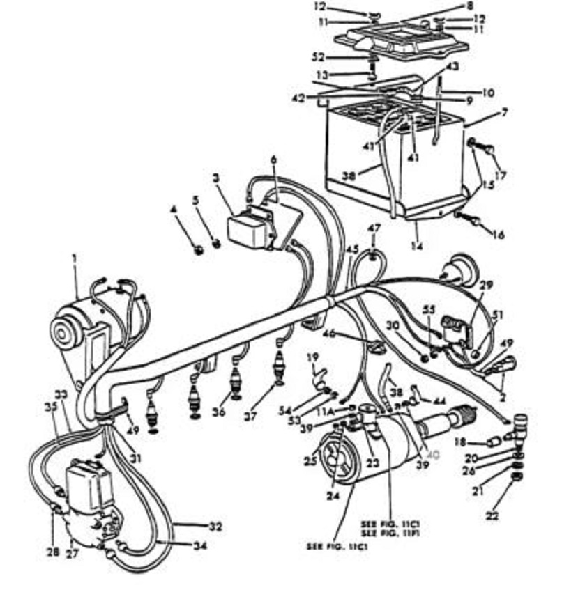

Yes Jimbo-
This is why he needs to tell us exactly what his entire wiring setup is. Knowing what and how the components are would be a good start for us to help and pictures always speak volumes. Even if he has an 8N Starter Motor with the RELAY/SOLENOID doesn't matter, wiring slightly different. On the Starter Solenoid back terminal is the wire to the switch. The POS BAT cable connects to the right side terminal on the solenoid as shown. This is the reconfigured method for using a 3-Wire Starter Motor & Relay for 12V with the 9N/2N. The ALT gets connected to the BALLAST RESISTOR as shown and is another reason why I stress the Ballast Resistor in all front mounts. If he can't post pix he can email them to me and will do it. The spitballing has got to stop.

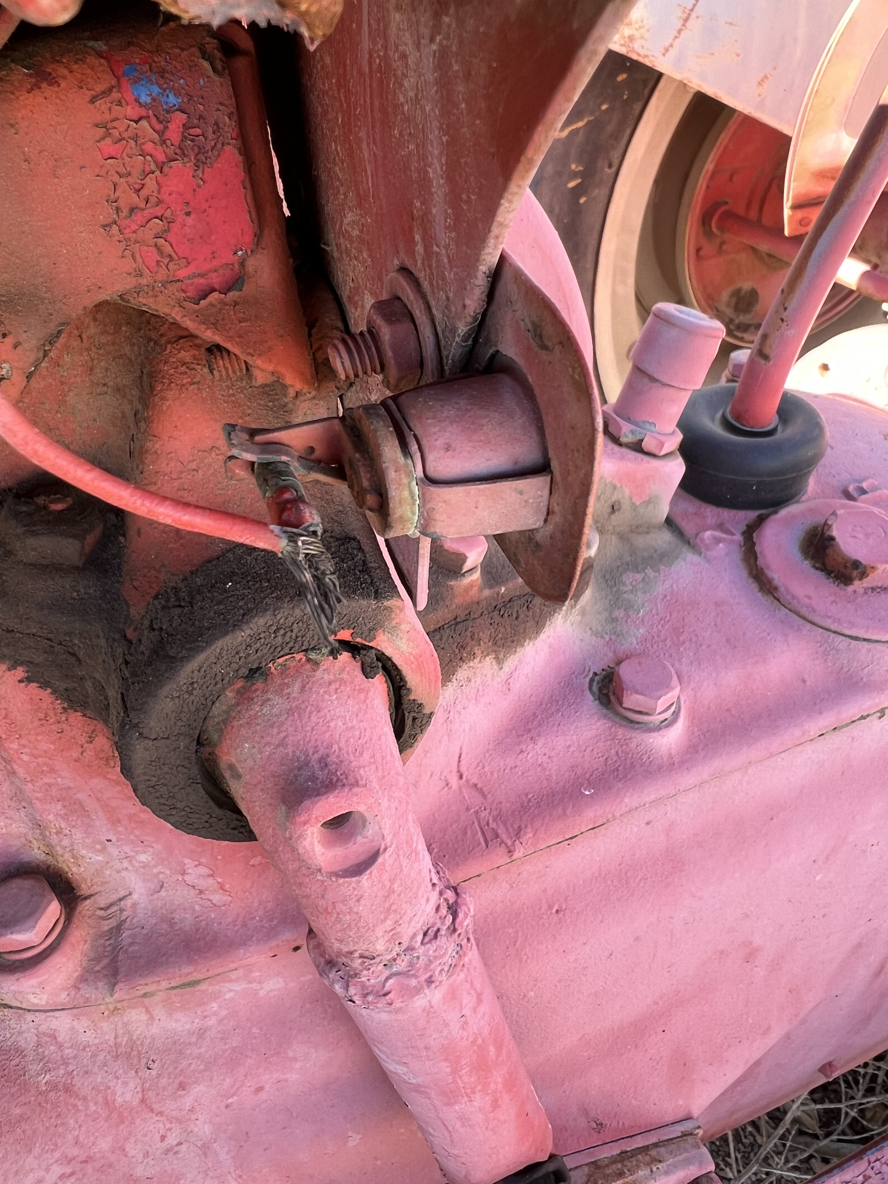

If you read the original post, he has a single wire push button switch on the dash to start the tractor. The only way I know of that to work is if it is a grounding wire to activate a solenoid. Because we can't see what he has we have no way of knowing any more than what little information is given. One thing I'm sure of is it is not set up as original.

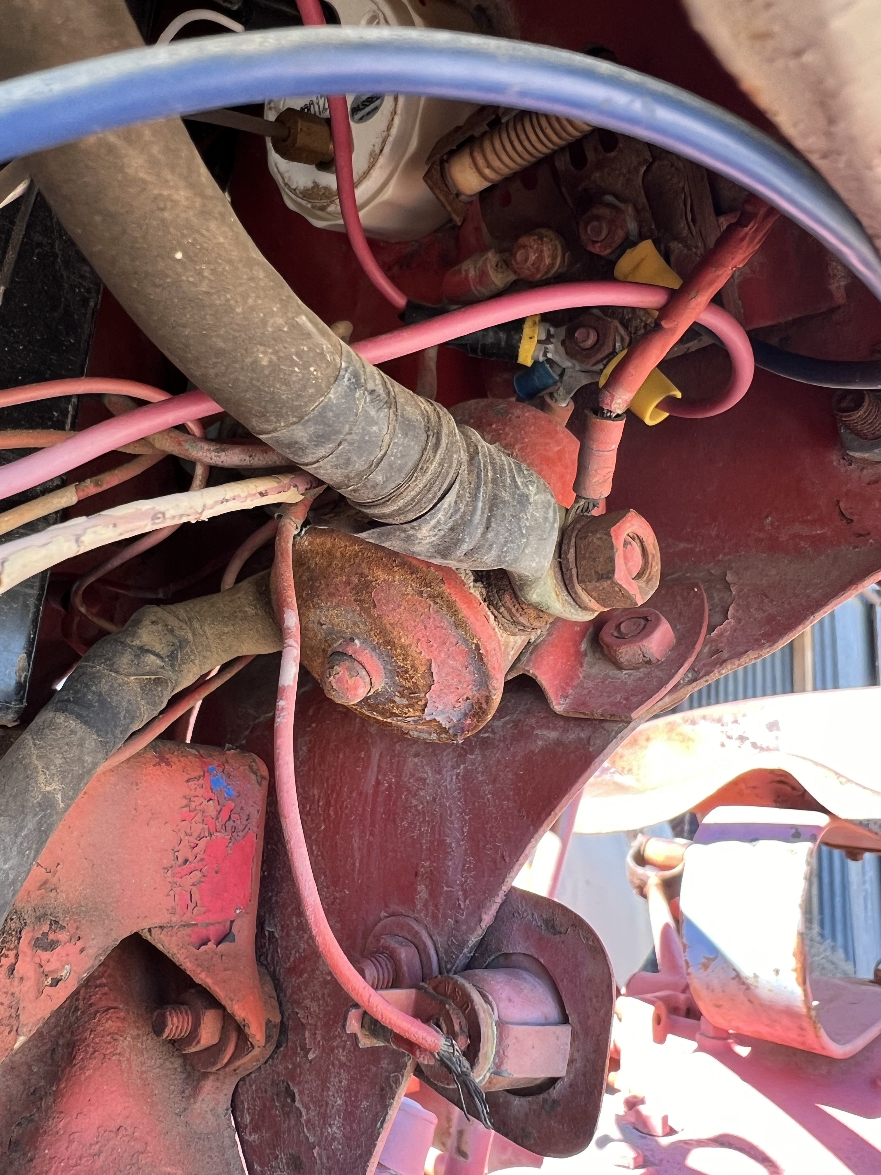

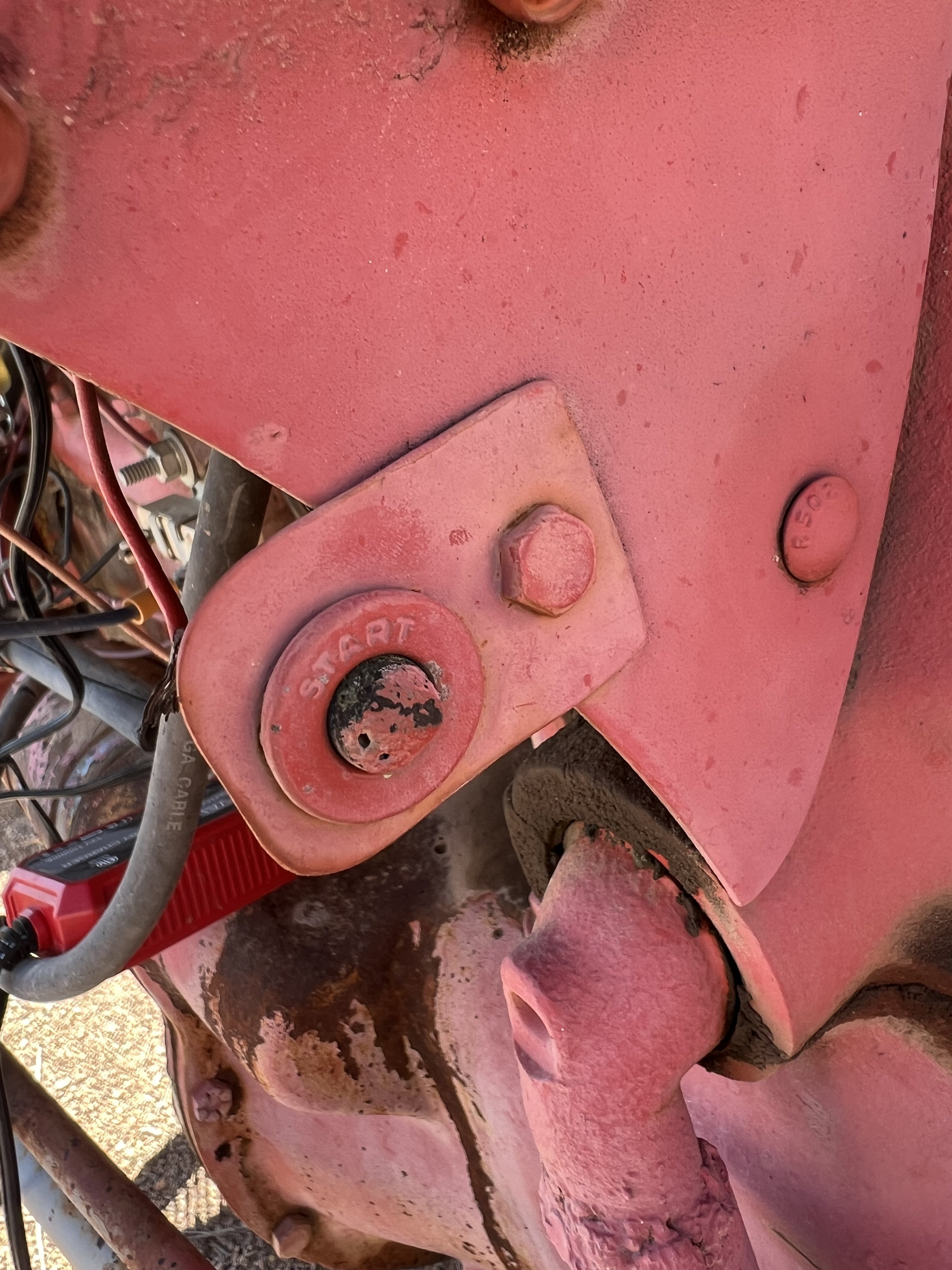

This is the start button, with the one wire, and where it goes.

Be sure the transmission is in neutral. Do what Mark suggested and try grounding the wire from the starter button. With the exposed wire where it connects you don't even have to unhook it, just use a jumper wire to ground it to the chassis. A test light or voltmeter on the bare wire to chassis ground should show power, as well. Both are indicators of an insulated base solenoid.

Looks like your SSB-3 switch is OK but the wire to it is damaged.
Easy enough to run a new wire from the starter solenoid with a "bullet connector" on the pushbutton switch end.
DISCLAIMER, your tractor has a modified starting system and the transmission-top safety neutral start has been "abandoned in place".
It is up to you how you repair this, but be aware of what's been done and proceed at your own risk.

As I said, GOOGLE "Standard SSB-3", ALL sorts of places selling them, and MANY local autoparts stores would be able to have one overnite that will pop right into the existing bracket and accept the style of connector that is already there, so WHY rewire anything?
On the other hand. as I just wrote, is there something wrong with the actual switch, or just the wire going to it?
Connector on back of pushbutton switch.
Matching wire terminal.

If you use a two-terminal switch, it will not be internally grounded like your current switch. On a two-terminal switch, one terminal gets the existing wire from the solenoid, the other terminal needs a new wire run to ground.
EBAY, search push button starter switch, $7.95 plus tax delivered. Search 1940 Ford starter button. Ford Cars used a grounding starter button for many years, that is what you have y the looks of things.
So, I can't find a one wire start button or horn button. Everything is two wire which is ok. I can install just like this one. I'm assuming I can use either terminal for hot. I can even run a ground wire and I should.
It doesn't matter which terminal you connect the wires to. Just one to the solenoid and one to ground. It would be better to rewire it to use the safety switch so it only starts with the transmission in neutral but it's your tractor.
