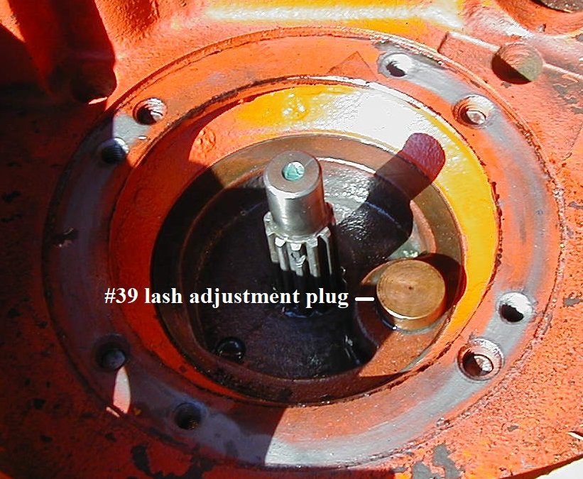

The early 530 should have a similar adjustment screw on the bottom of the bolster to set the lash between the steering lever studs and the cam (worm) gear. Before you lift the cover to check the studs, back off the adjustment screw, this is important because when you replace/turn the studs the lash decreases and bolting the cover back down may break the steering lever the studs are press in. The steering lever slides on the lash adjustment plug. Be sure and lift the cover and do as CNT & Tg wrote as worn/cratered studs can break the steering lever also if lash is adjusted too tight w/o checking studs. When done with replace/turning the studs and cover is back on adjust the steering wheel slop per this instruction page. Factory lube was SAE 140 gear oil, corn head grease per CNT is my choice also.
