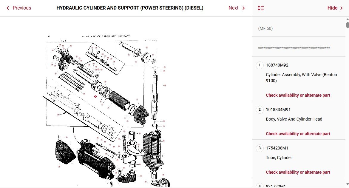

That type does not show in the online MF 50 parts book, only the type I posted the picture of. The Massey Harris 50 shows the one cylinder in the area between the radiator and grill. It is hard to search for a cylinder until the right one is determined to get a part number.
There are 3 different cylinders and valves of that type shown in the MH 50 parts book. Two for gas engines and one for diesels.
I understand things were intermingled some during the Ferguson, Massey-Harris, and Massey Ferguson in the years around the early MF 50s. Is your tractor by chance a MH 50, or at least a MF 50 that uses the MH 50 parts book?
Below is a clip from the MH 50 parts book of the power steering cylinder and valve for the diesel. There is a (MF 50) noted at the top of the right column. Looking at your past posts it looks like this might be diesel. Does this look like your steering cylinder and valve?
That sure looks like the one on my 1967 MF 150 gas.
