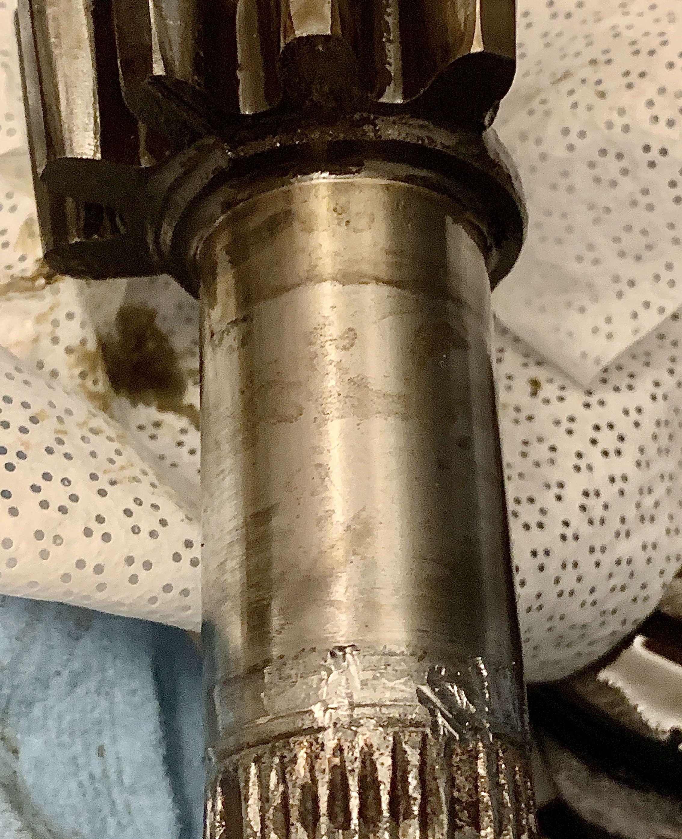

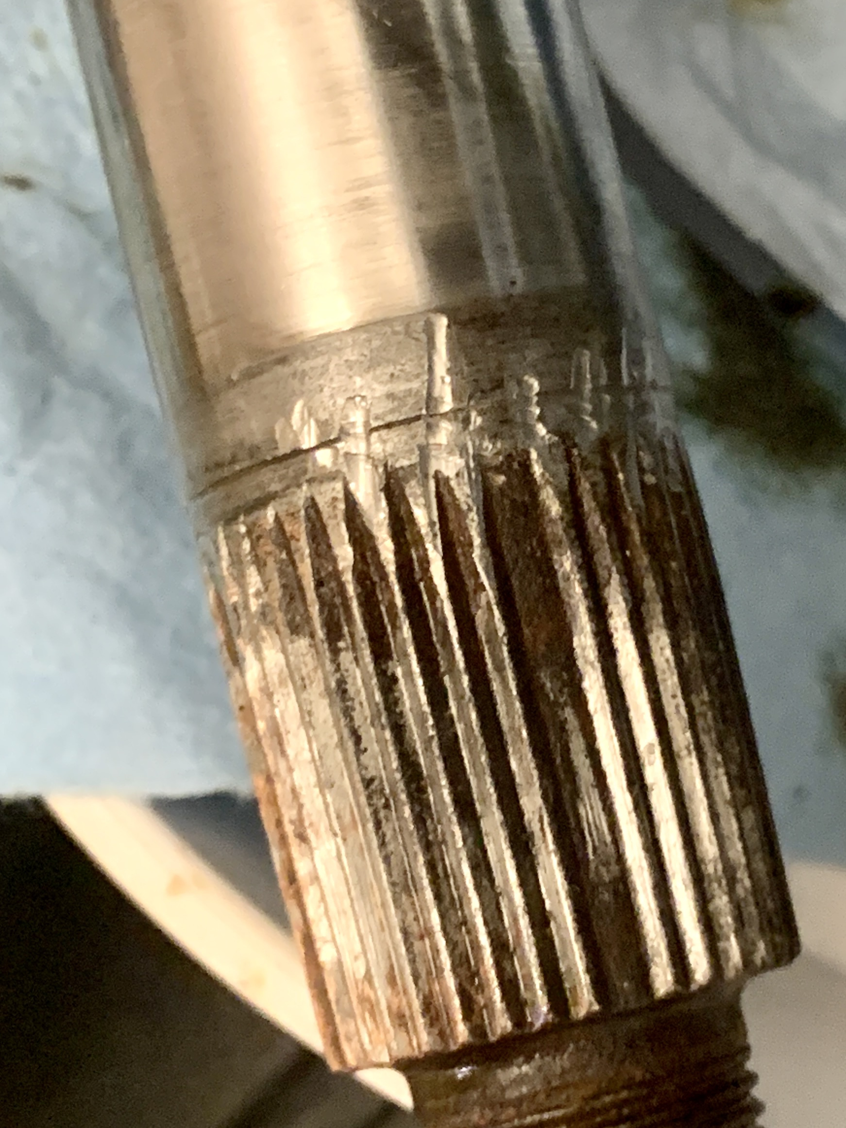

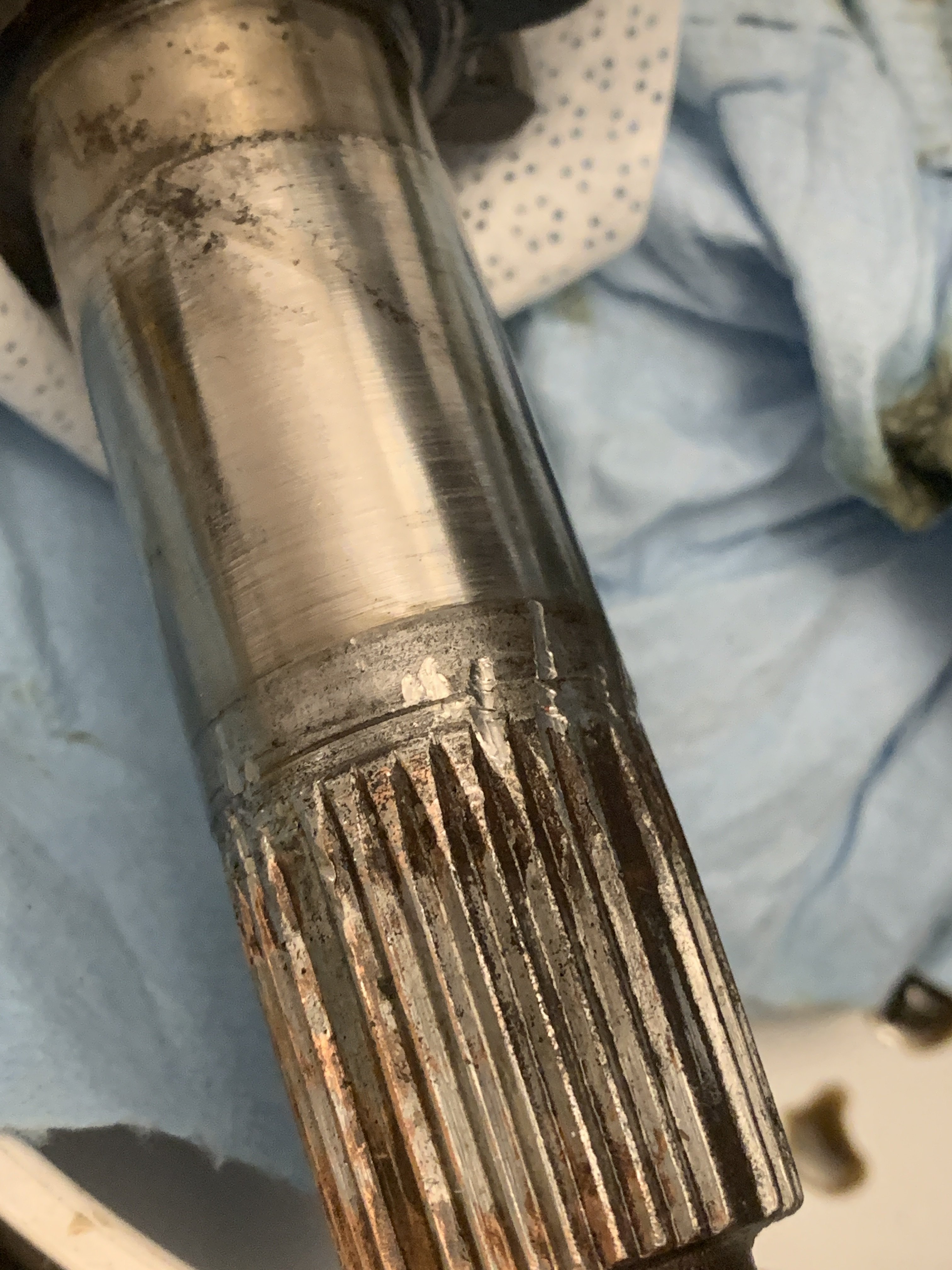

what say yous-- is this ford steering sector shaft a lost cause ??? based on those gouges
i thought about jb-welding it then i came to my senses... i could probably never get the 'cylinderical shape' to happen like it was... what grits would i need-- surprisingly not so common part ive come to found out---i thought theyd be a dime a dozen on the interwebs- people just giving them away -- i believe the part number is 8N3526B (the shaft closest to the seat)

Well since the gouges don't appear to be on the wear surface where a seal or bushing runs I would not worry about them or see if you could shim the shaft up or down a bit. Other wise a new or used shaft or filling is in order.
Did you search by part number, left or right? I assume power steering? See link, X out of the request to pick a dealer.

WHAT the heck happened to it? D the gouges actually extend into the area where the seal lip resides?
yea i want to say they do.... thats why im rather. remiss.... with the entire situation..... i believe the seal would usually sit here-abouts... but-- perhaps some "attempt" at "fixing" at this point before buying another one for $200+ dollars is the way to go -- as I would have to wait a week or two for the new one to arrive at any point...

2X if the gouges do not run under a seal they might not hurt anything. Are the gouges from trying to remove the pitman arm?
Speedi-Sleeves are a fast way to repair worn seal contact surfaces on shafts. They are not cheap, but they do save a lot of labor. They are available in a wide variety of metric and English sizes.

i believe they are from trying to remove the seal... apparently some form of drill bits were used with titanium Milwaukee brand most likely. one of these seals- atleast the new "bushing" went in correctly. so that is good-

I agree with trying to fix it. Just be sure it's really clean of oil and such, slather on your choice of goo. Sand just a little with some coarser paper to break the shine off the goo after it hardens. The use a strip of wet or dry around 4-600 grit like a shoe shine rag to get it really close. Then shift to the old shoe string and wet or dry in 6-800 with WD40 for a lube till it just fills the gouge, and no more. Bet it works as well a a new one.
heheh true dat.... i had filled it up with lucas hub oil - but i read that 00 grease is the way to go apparently, since it wont leak out from the seals/bushings as much- i just want to be done with the steering for a good while after this... since the rest of the steering setup is doing better nowadays---

If you have the means machine the box so the seal will set deeper into the box are spot well and turn down.

Use it as is & use corn head grease for lube & it won't leak out. HTH,

Any local machine shop can fix in 30 , min or less. Or you weld it and file and sandpaper it down.
