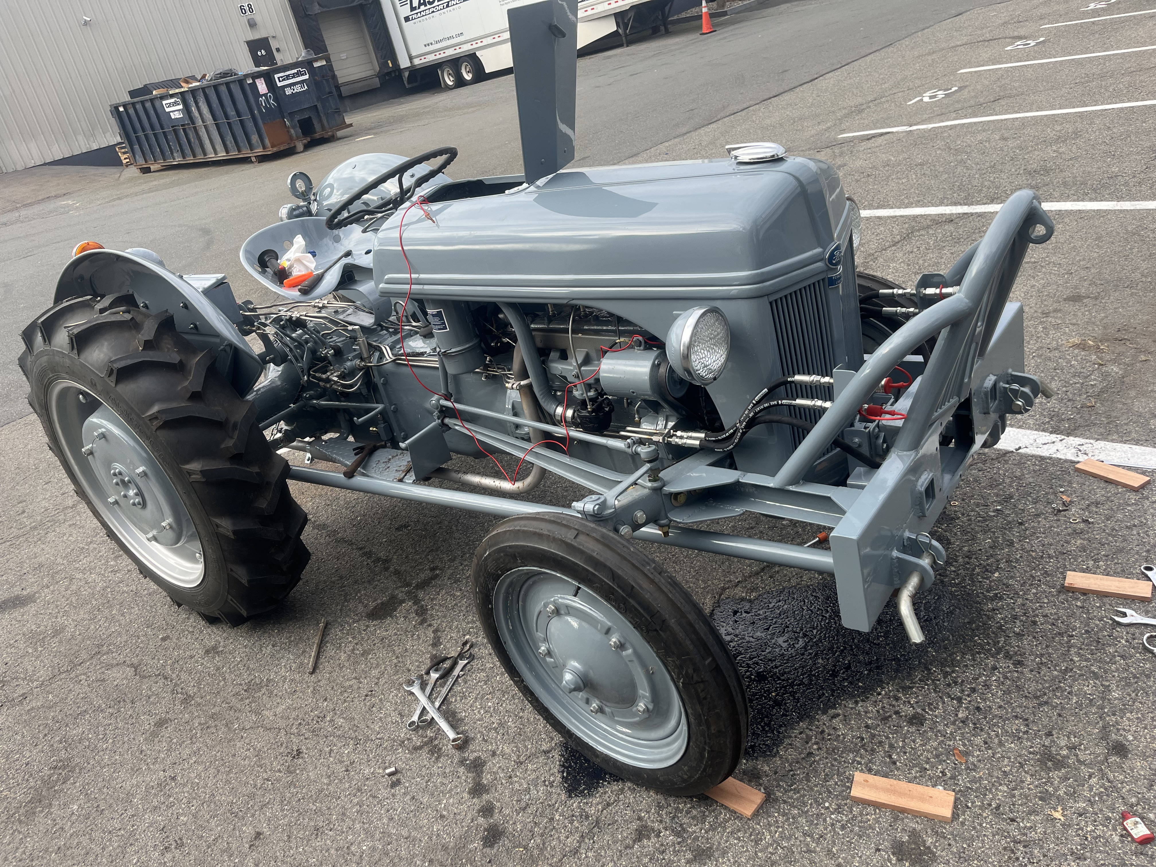

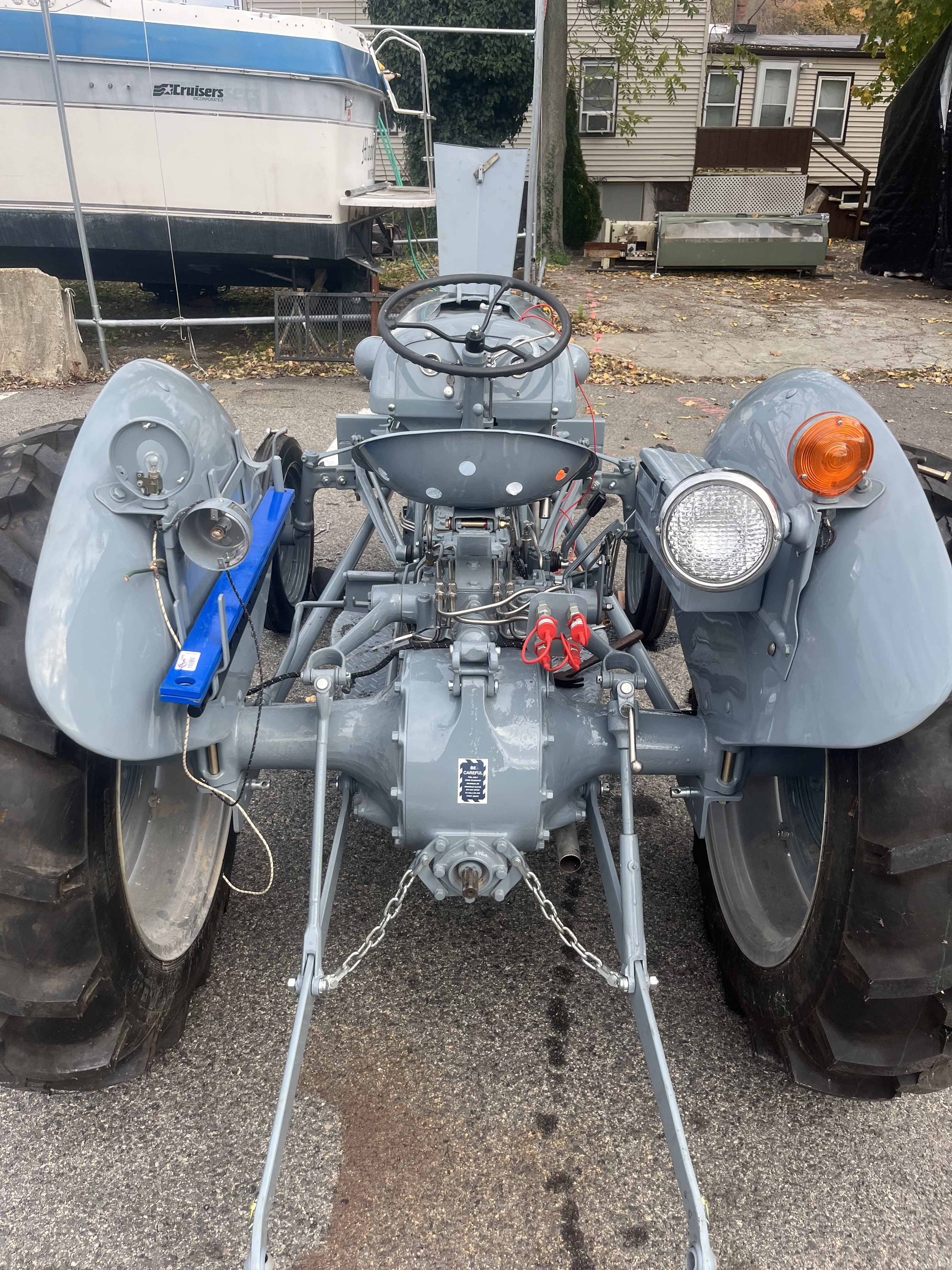

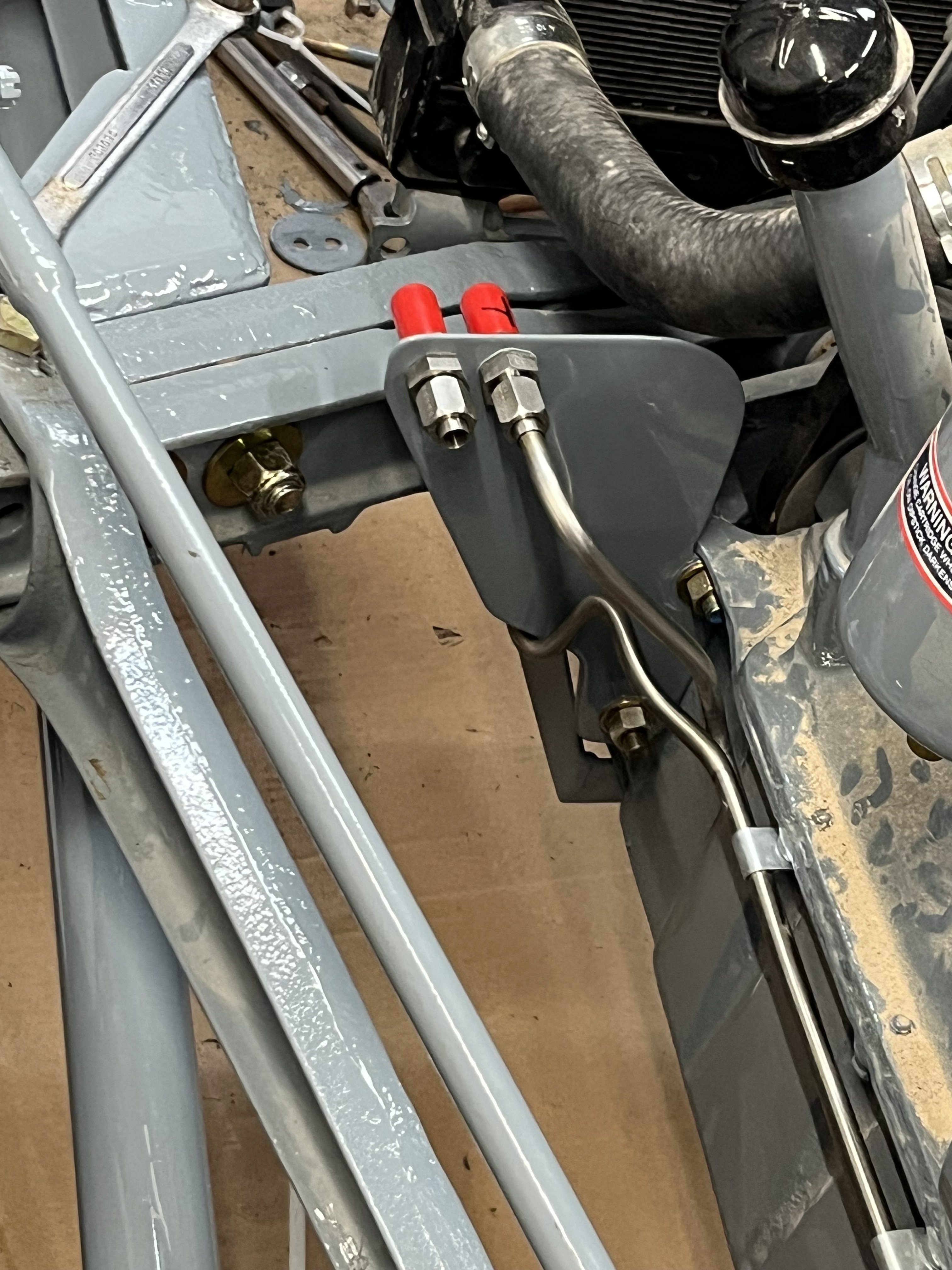

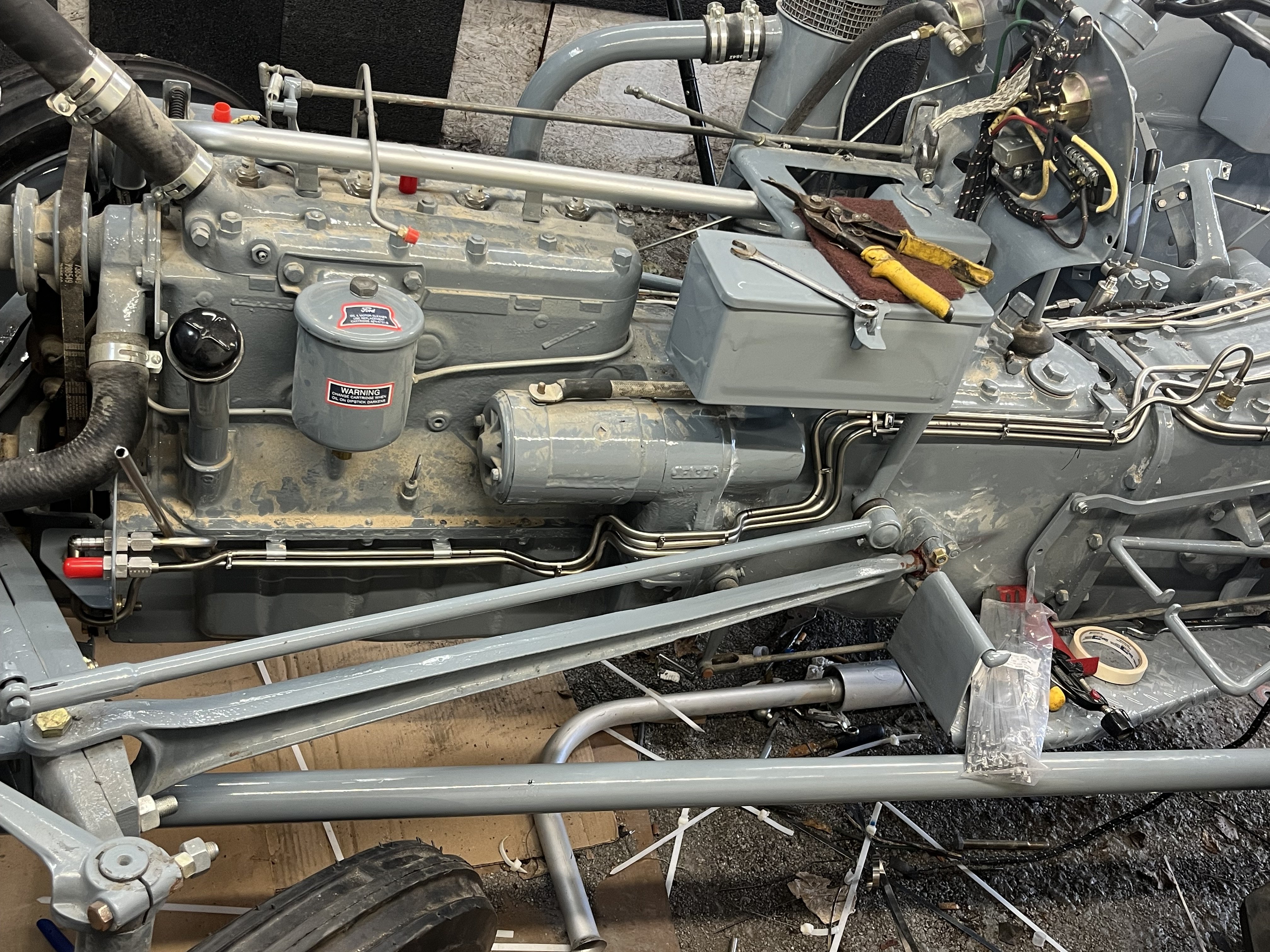

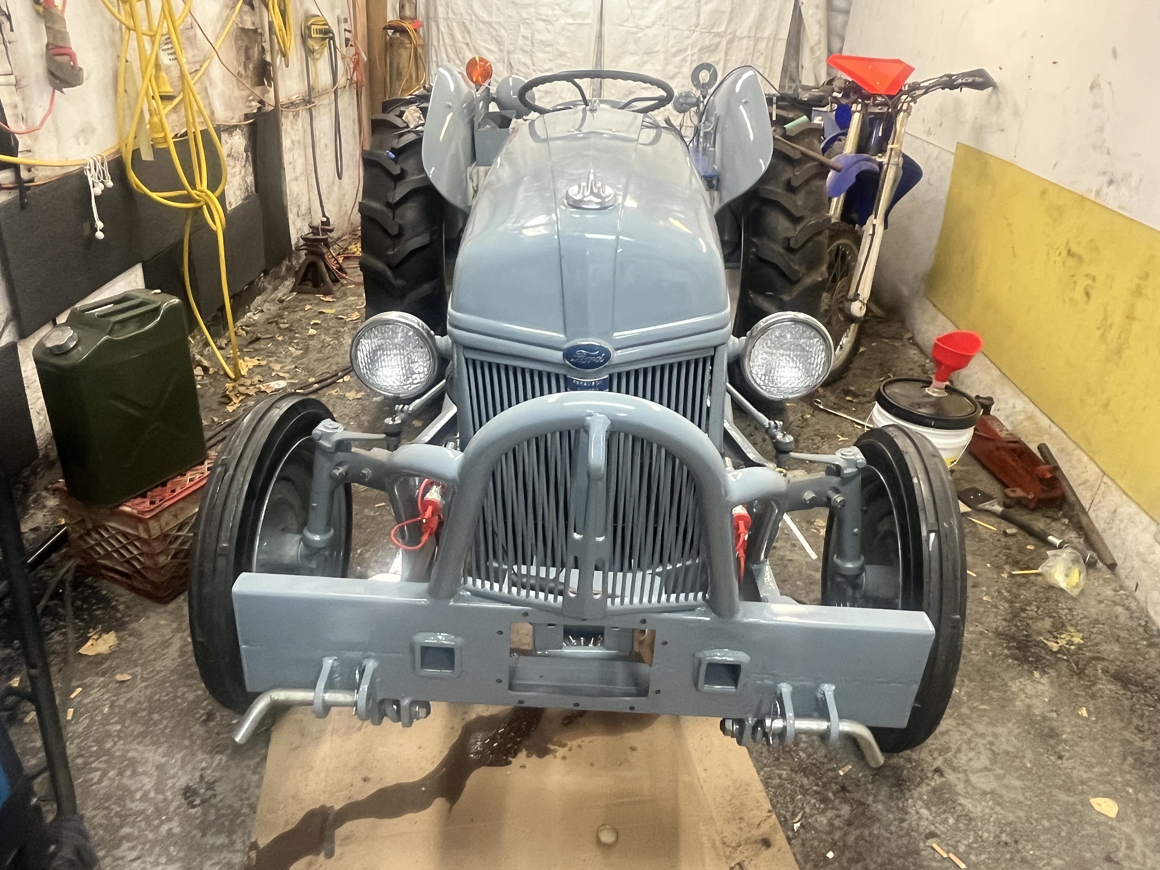

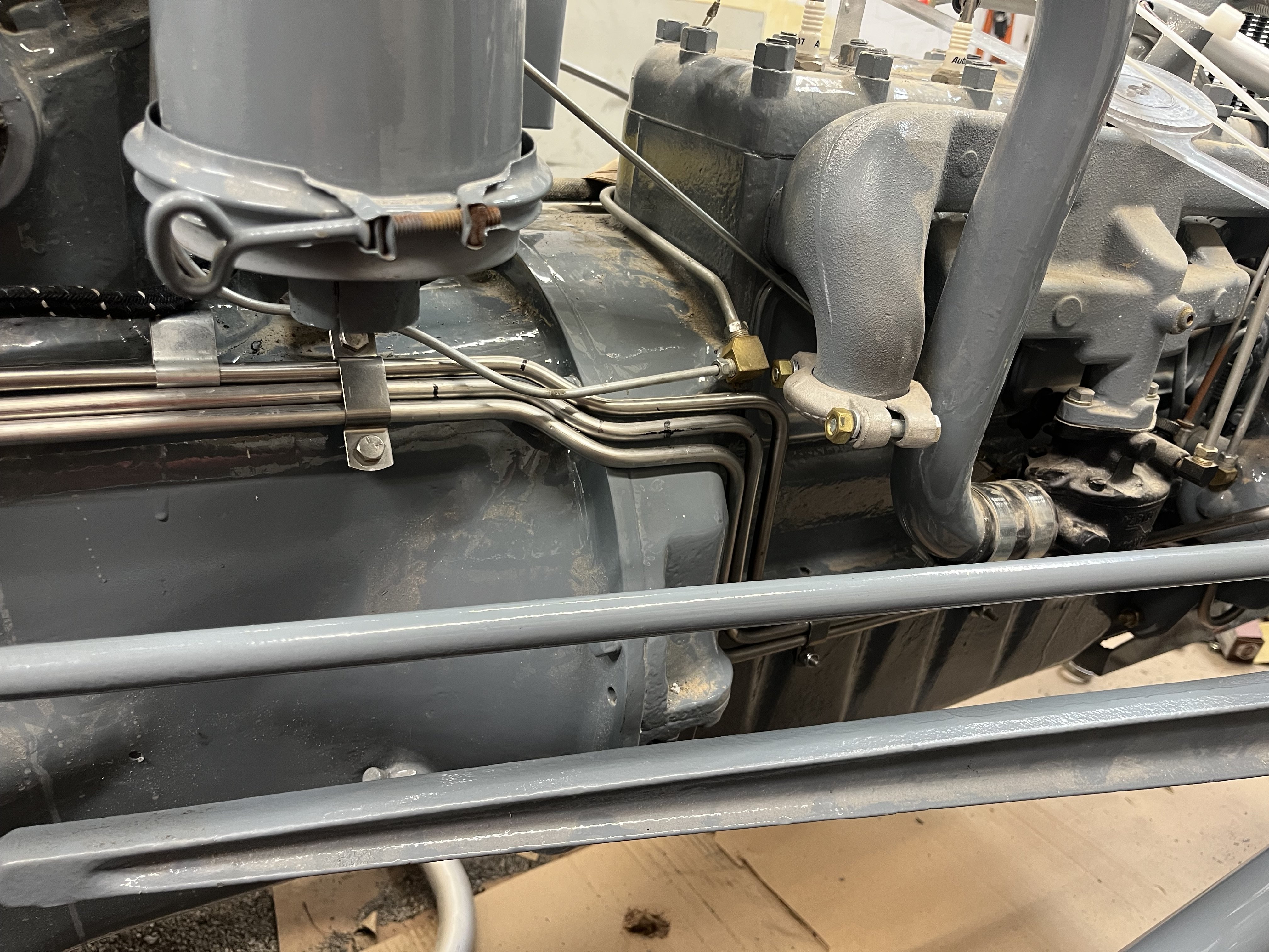

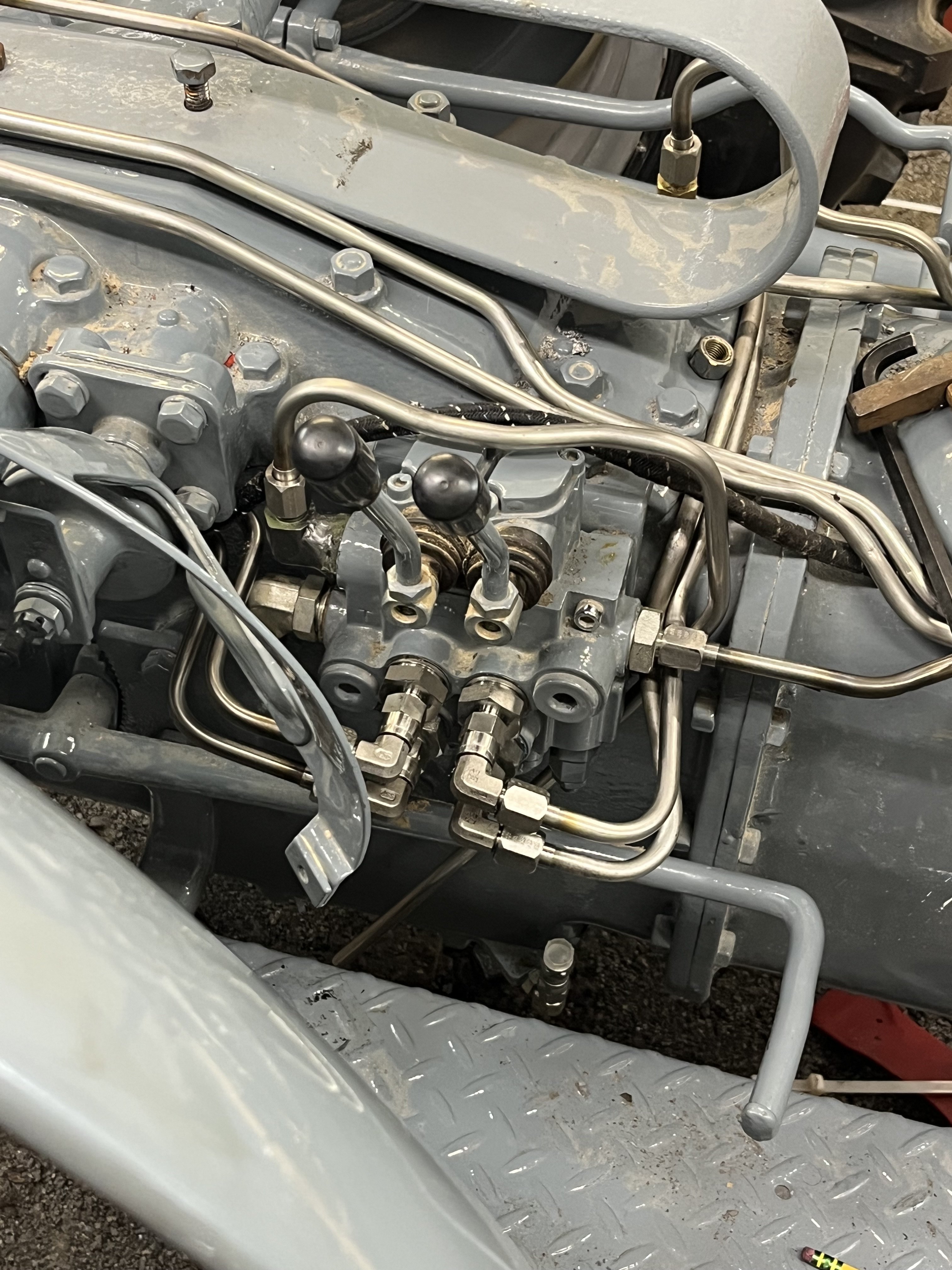

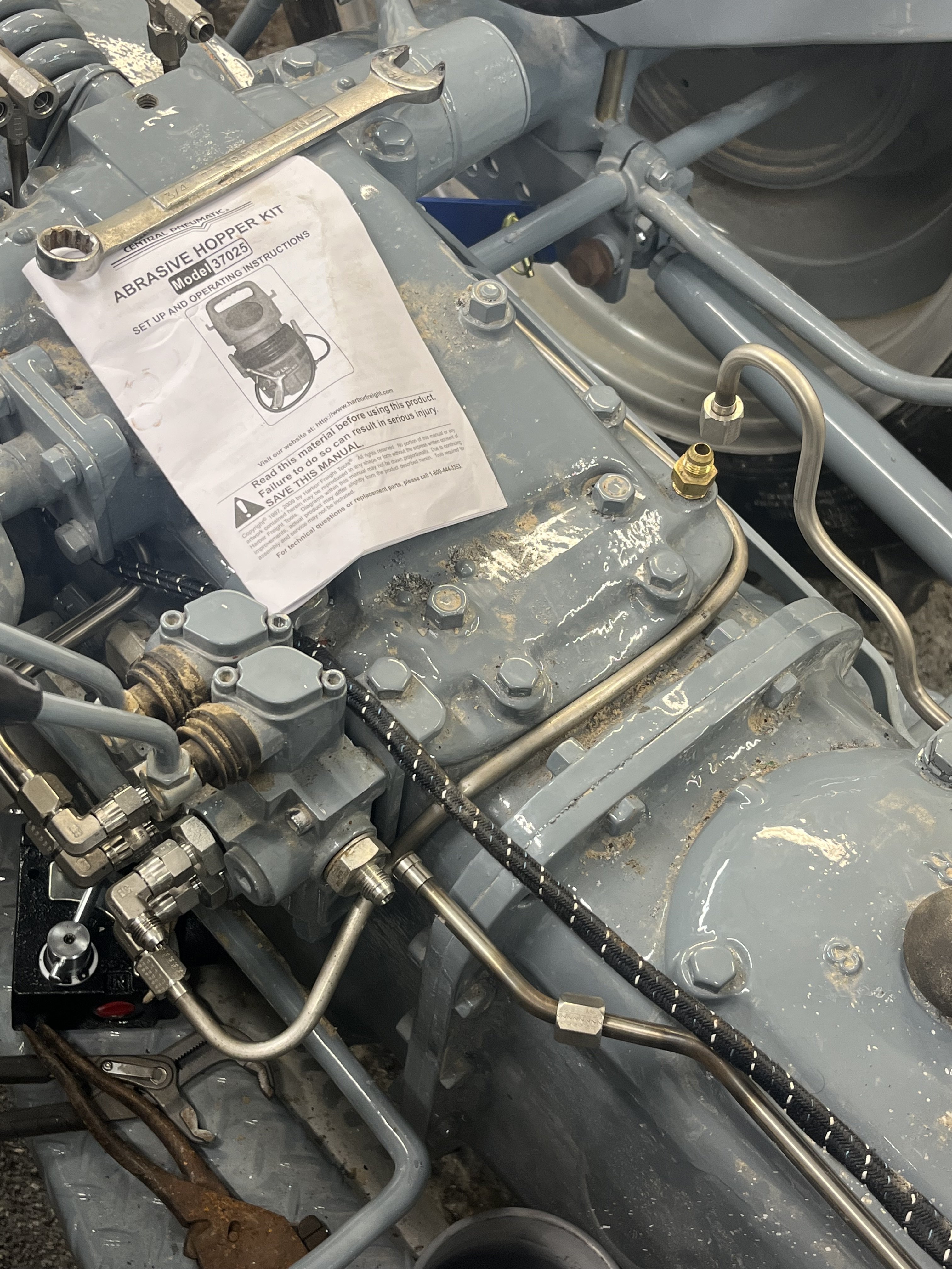

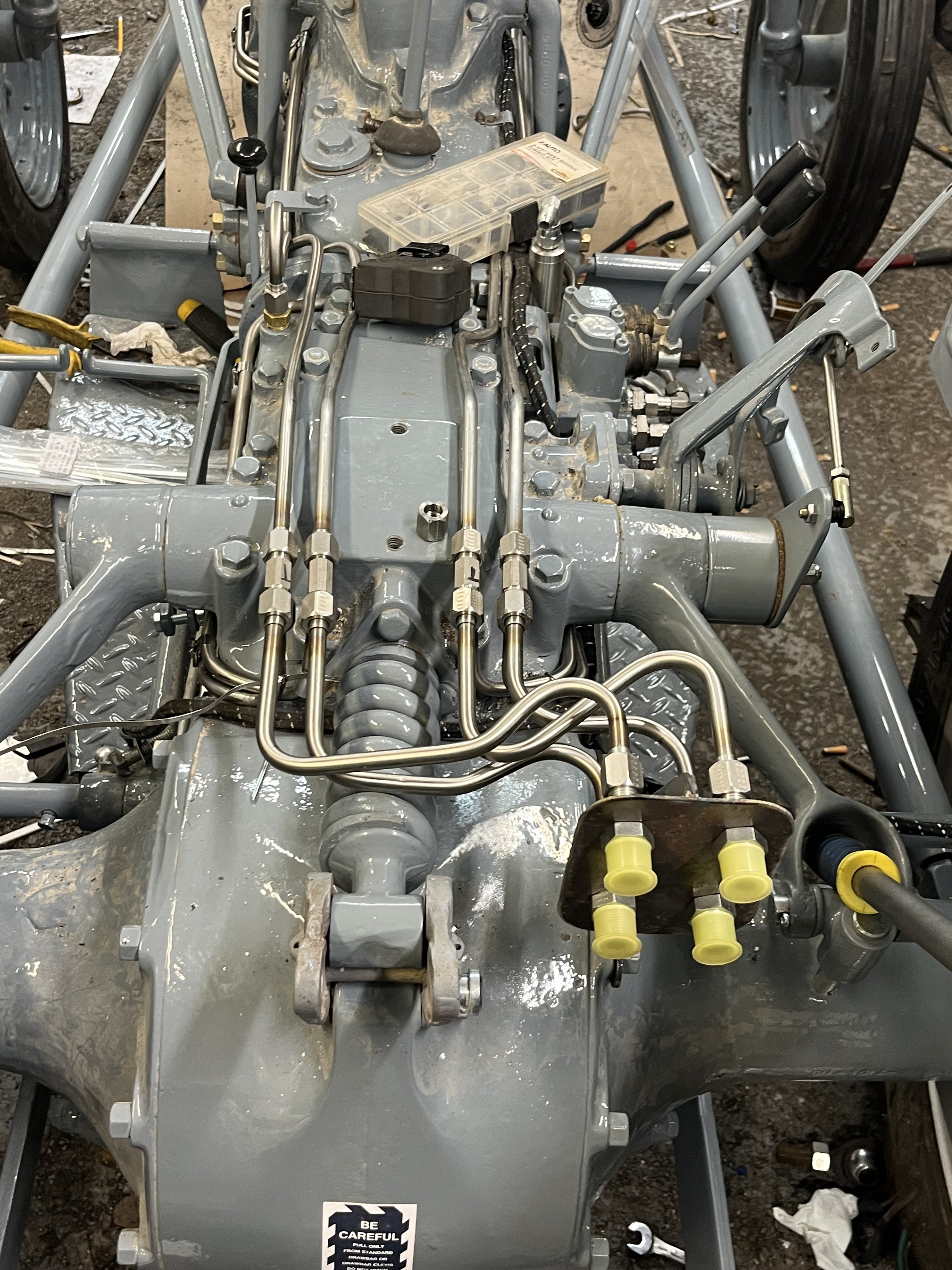

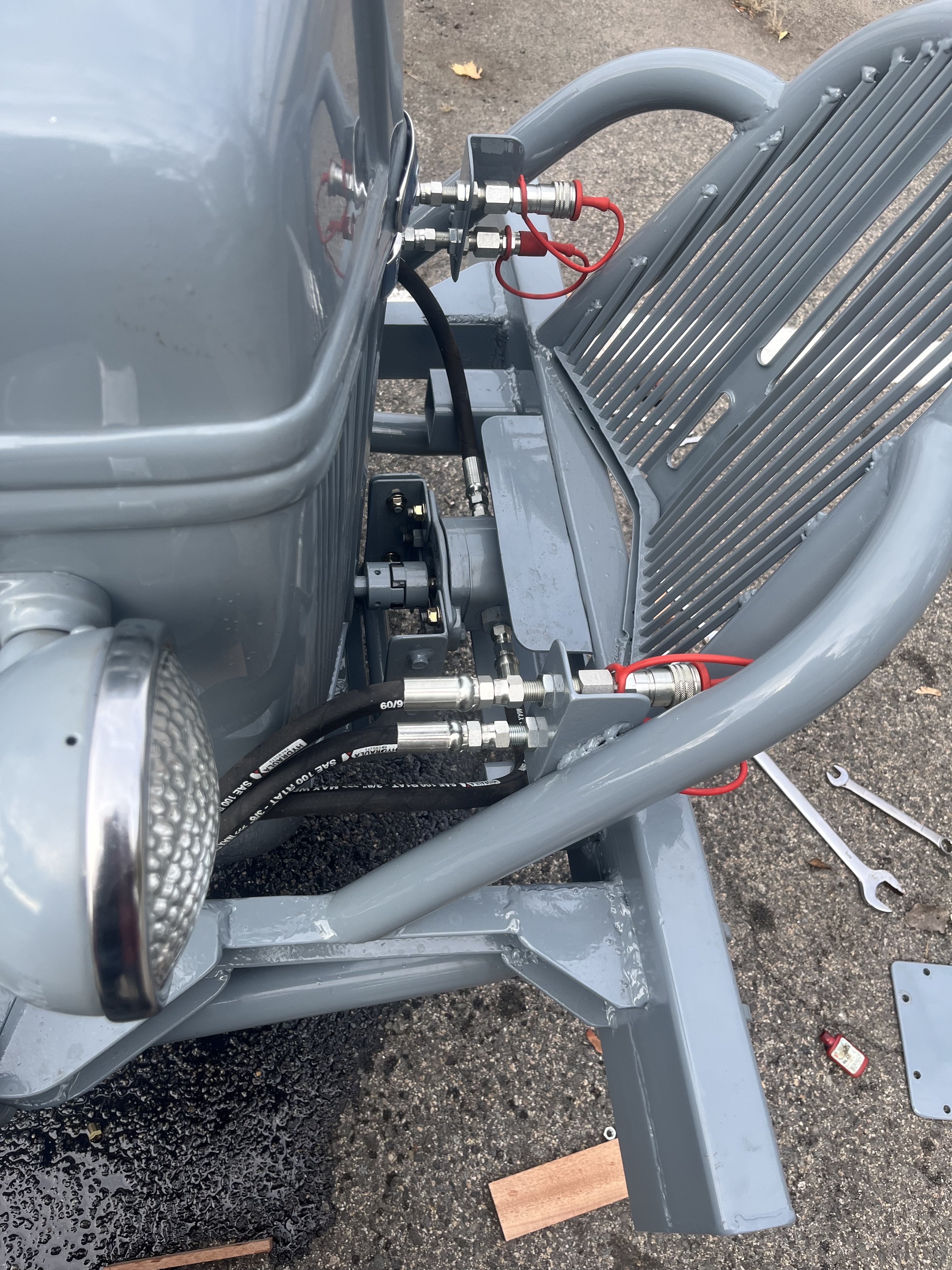

So i restored my 1941 9n now when i did this i converted it over to a live hydrulic system with secondary controls and front and rear aux lines all bent in stainless and i use a bipass flow control madule set to set flow into origonal pump generaly i keep the pto off and run all hydrulics with the front mounted aux lines
First day tested out all the hydrulics and everything worked flawlessly (with no weight on it) lift went up and down front plow worked, back hydrulic too link worked. I was thrilled.
Now literaly on the ride home drom my shop to my house my budy called and asked if i could give him a hand moving a gass miller welder around 650 lbsi said SURE! Get to play with my finished 2 year labor of love! And that weight a good text. I didnt know if it would lift it off the very end of boom pole.
Well hooked up the welder and started lifting just wanted to go up a few inches. Well it just kept going all the way up well for 20 min we just stood their trying to figure out how to to get it to come down then we started tractor and were messing around and i acidently hit my plow lever it release the presure and it dropped.
So got it back home and next day played around with it worked flawlesly with no to weight using anything more than 200lbs on dar bar it would just go stright up.
First i thought it needed adjustment.
Then i thought i did somthing wrong with my live hydrulic system.
So i tryed just disconecting it and running stock pump live hyrulics diconected.
Same damb thing happened. When its under presure its like the control vave gets stuck and even when i move the quadrent i can feel the springs strech but the control valve not move. (With no weight no problem)
What do you guys think? Control valve problem? Exaust valve? Somthing else?
Heres some picks of the old girl below

I worked for a major machine tool manufacturing co. I ran a lot of pneumatic and hydraulic piping from 1/4" to 3/4" so I can admire a job well done. That would pass inspection anywhere.
Thanks, i appreciate it guys. the tractor kinda fell into my lap it was bad (sat in a field that flooded every spring and was fully submerged every year for 2 weeks or so after being crashed into a tree after breaks failed) . Probably as bad as you can get but i decided to bring her back total nut and bolt restore took about 2 years probably would have been quicker but i had a baby in the middle of it! was able to save all the original sheet metal too.

I'm curious about the "plow lever" that was involved earlier. What's that? Next question. You're doing these follow up tests using weight applied where? Just on the lift arms or on the three point as a whole? I'm wondering if the top link draft sensing mechanism could be involved here?
I assume you know that the 9N only has draft control. Lever on the right side of the seat will raise the rear arms all the way up or lower it all the way down. No position control on a 9N. I can't figure out if all the fancy plumbing will overcome that.
It looks like you are feeding the tractor hydraulic pump from the return line of the valve and using a flow restrictor to reduce the flow to the pump which could be causing back pressure in the system. Have you tried disconnecting the front pump and operate the three point lift from the tractor hydraulic pump? If it works properly that way I would recommend a flow divider on the inlet side of the valve to feed the hydraulic pump.
To answer the questions yes i know
1st. Yes i know it only has draft control and no position thats why i have a position control adapter from red rock mfg on the three point to the lever to the handle to give me position control.
2nd the “fancy plumbing” only controls the the two front and two rear aux ports. These are controlled by the secondary spool valve
The way the system works is the front pump sucks from the sump it is pumped up to a bypass flow control valve this limits the flow to 2 1/2 gmp the excess flow is returned back into the tank while the high supply leads up the the spool vlave (witch has its own pressure regulator and return line witch also returns to sump.
in the neutal position the flow passes threw the spool vlave threw a power down streem port to threw a check vlave to the teest prot on the stock pump and out the exaust vlave back to sump. Just like in any live hydrulics mod suck and zang or oldguy mod.
When the spool vlave is activated it devets presure that would normaly be going thew the pump to the selected auz ports.
3rd the weight is being lifted by a boom pole off of the three points using stock lift quadrent and control vlave and eaxaust port and high pressure releaf valve.
I hope that answers the questions
