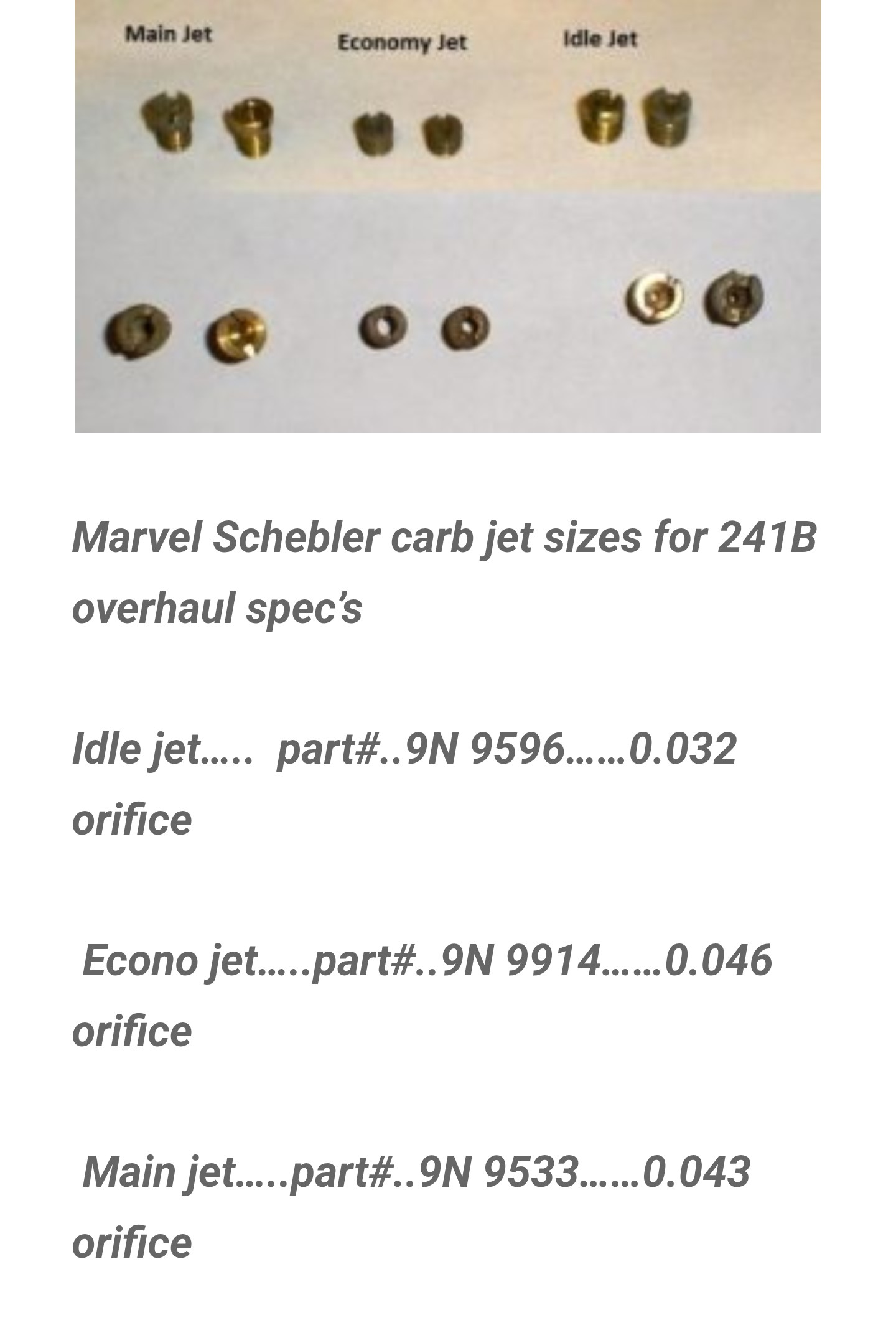

The one I am trying to repair looks almost exactly like this one, aside from the name on it. Mine has no identifying marks at all that I can find.
I had one like that too but it was brass coloured, it was weird some days, Anyways. I would say you could try rebuilding the genuine carb using the Chinese carb parts or the rebuild kit you were going to use for the one you had to tap the threads in. if you already have a genuine carb I would fix that official marvel one.
