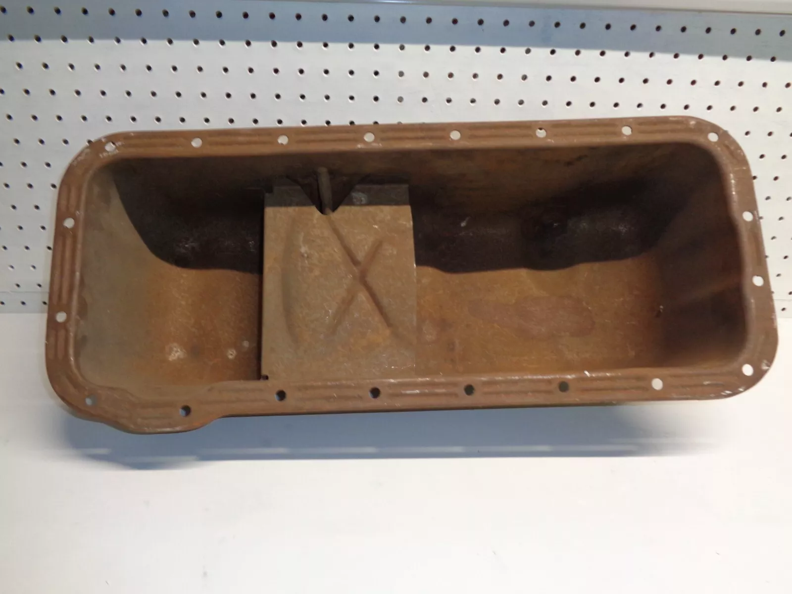

I have an old F700 Ford that had the 391 engine replaced with a 330 V8. I changed the oil in it the day we bought it and I recall the oil plug had an issue but have since forgotten it - was changing the oil last night and suddenly remembered. There are barely any threads left in the pan for the plug and you have to be very careful to tighten it just enough to seal -without stripping out the few reaming threads. Jumped on Ebay and found a used oil pan with the full length sump for $65 (includes shipping). Only problem is this oil pan has been off for years and has a fair amount of rust. Clean it with steel wool and rinse with diesel fuel or should I even touch it and just leave well enough alone?

I'd go over it with a wirebrush on a drill to remove as much loose particles of rust as possible, then rinse the loose particles off and install it.
Or uses Scotch brite pads to assure yourself there is nothing loose on the surface to contaminate your oil. Steel wool tends to leave steel shavings in hard to reach areas such as your baffles. Scotchbrite, air and multiple rub downs with engine oil until your towels come back clean. steve
Or maybe thread a reducer bushing with loctite or jb weld into the bottom of the pan. Sounds like you haven't bot the ebay pan yet.

give it to old and he will fill it with vinegar! actually now he said vinegar dont work in his 88. just use scotch brite pads and yes spray it with wd while using the scotch brite pad. the rust will come off. and also a person could buy oversize rethread plugs back them . think they came in 3 sizes. A, AA. AAA, something to this effect from what i remember.
Auto parts stores and amazing sells them. SAE and metric.

fill with 5-10% phosphoric acid in about 12 hours it will be clean, rinse apx 2 times and dry. then coat with oil and like new. i do the same with motor blocks in a tank and some times take a few days to clean, then the blocks i dip in a RP for a day.
