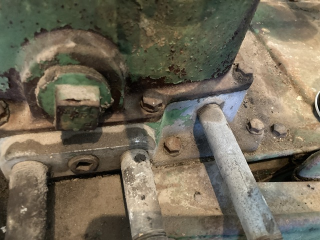

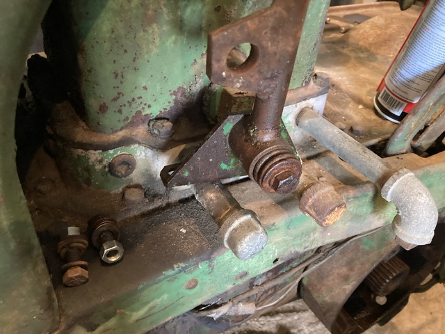

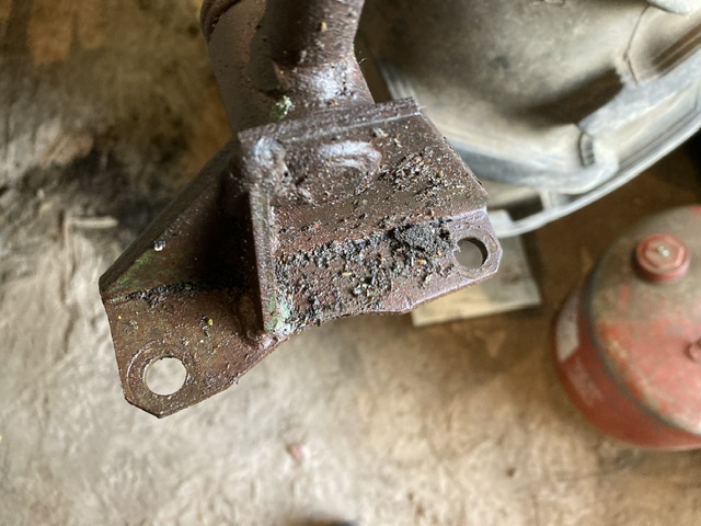

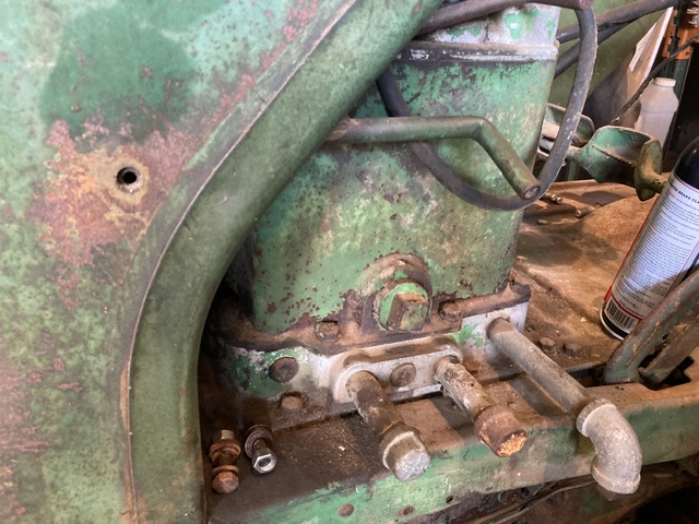

My new to me super 88 diesel has a foot operated lever to engage the starter, I’ve seen some with a hand lever to engage the starter. I have the power booster lever from a 770 that I parted out years ago that I want to use for the starter. I thought it bolted to the holes for hydraulic unit but the holes don’t line up. What am I missing here??
I think the drain pipe is in the way. That can be removed and put in the front-most position where the square drive plug is. Put that plug where the pipe is now.
This is where it is on my 880 parts tractor
