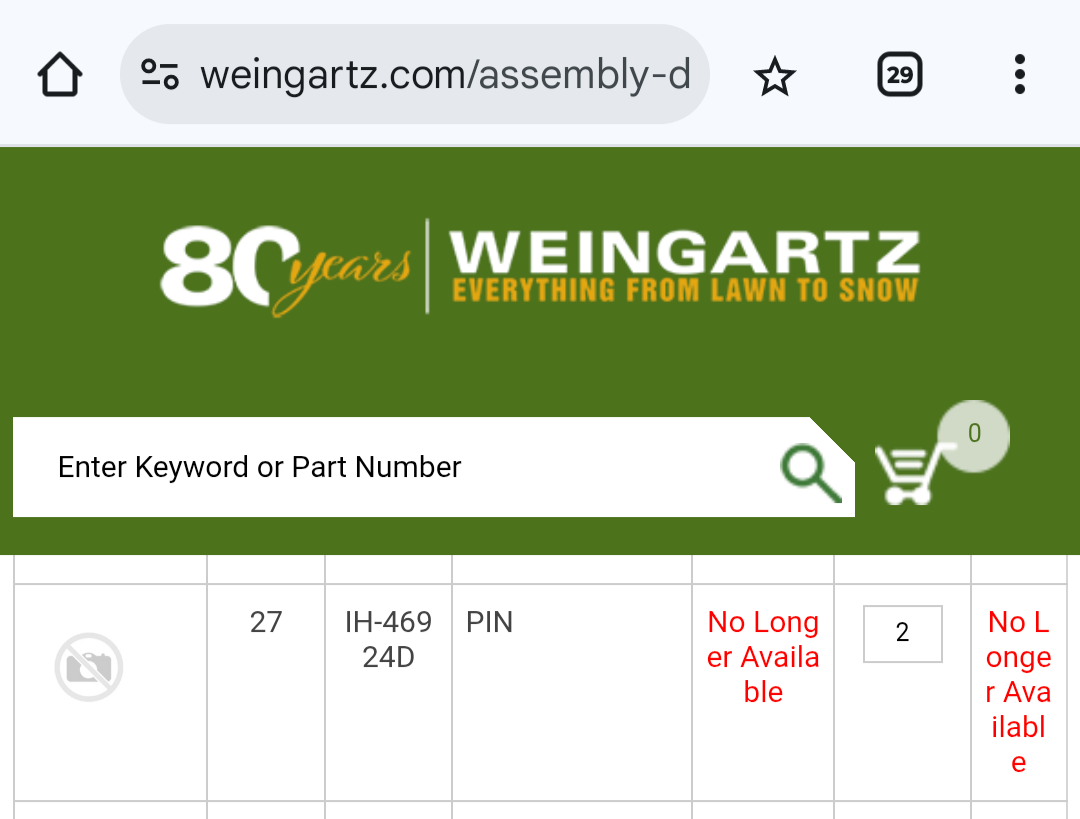

I'm trying to rebuild a governor on my Super A. The issue I've ran into is, one of the weights had gotten stuck to the pin, causing the hole for the cotter pin to become egged out. Replacement pins are around $45. Does anybody have any ideas on how to make a replacement? I'm thinking possibly getting some drill stock from McMaster-Carr and heat treating it but want to get some input first.

GOOGLE "IH 46924D".

01 drill stock is a poor material choice for the pin . It will break under load from the weight. I suggest you select something else . The 45 buck s is cheap compared to what will happen with your selection .

McMaster-Carr has multiple types of drill stock from different types of steel.
Looks like the reason the price is so high is due to it being discontinued.
Thank you. I found it earlier today. I'm a little hesitant since they are aftermarket and a seller I'm not familiar with. But I'll give them a shot.
