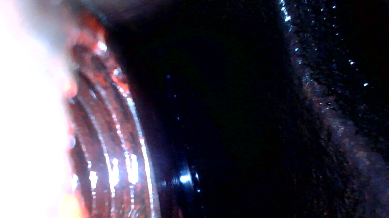

I sent a link to this forum to my brother late last night, he put a camera inside the engine this morning and confirmed there is NOT a gallery plug. I am still going to follow up with the causation, photos, and the end fix.

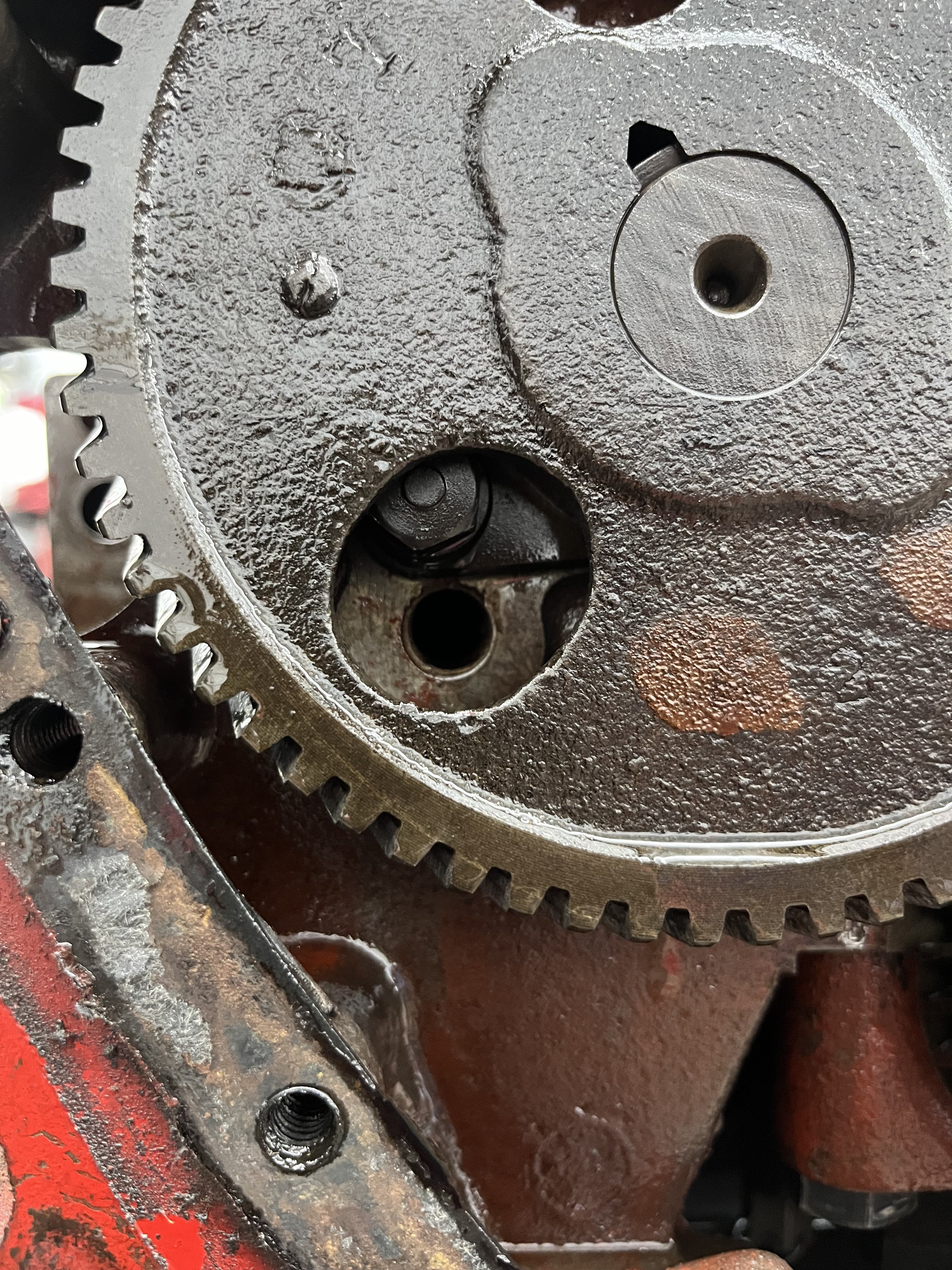

Here is a photo of the gallery hole. Is there a way to put the plug in without removing the camshaft?
There is a plug at the rear of the block also, or suppose to be. The plug hole on the rear is sandwiched between the block and clutch housing. If that plug is also missing you could end up with an oil seep out between the block and clutch housing. If one is missing, they both could be. From your description it sounds like an engine repair was abandon because of no oil pressure.

Only if the access holes in the gear for the cam retainer plate bolts happen to line up with the gallery plug hole.

Just out of curiosity trying the block for sale link again. Hmm seems to have worked. Second to last photo is the front of the block. Looks to me like the center line of the plug is about 3/4” more distance from the center line of the cam retaining bolts. Heavily guesstimating due to the angle of the photo.

That means you can install the plug without removing the camshaft or gear. See the bolt in the upper left of the hole in the gear? That is bolting down the plate that holds the camshaft in the proper location front to back. The purpose of the hole(s) in the gear is to remove and install the bolts to allow the cam to be removed and installed. So it just so happens the bolt access hole is also positioned so you can access the plug. Otherwise the gear could be solid or the bolt access holes much smaller and closer to the center of the cam. Then you would have had to get the gear out of the way to install the plug. The cam retainer plate is number 27 in the linked diagram.
