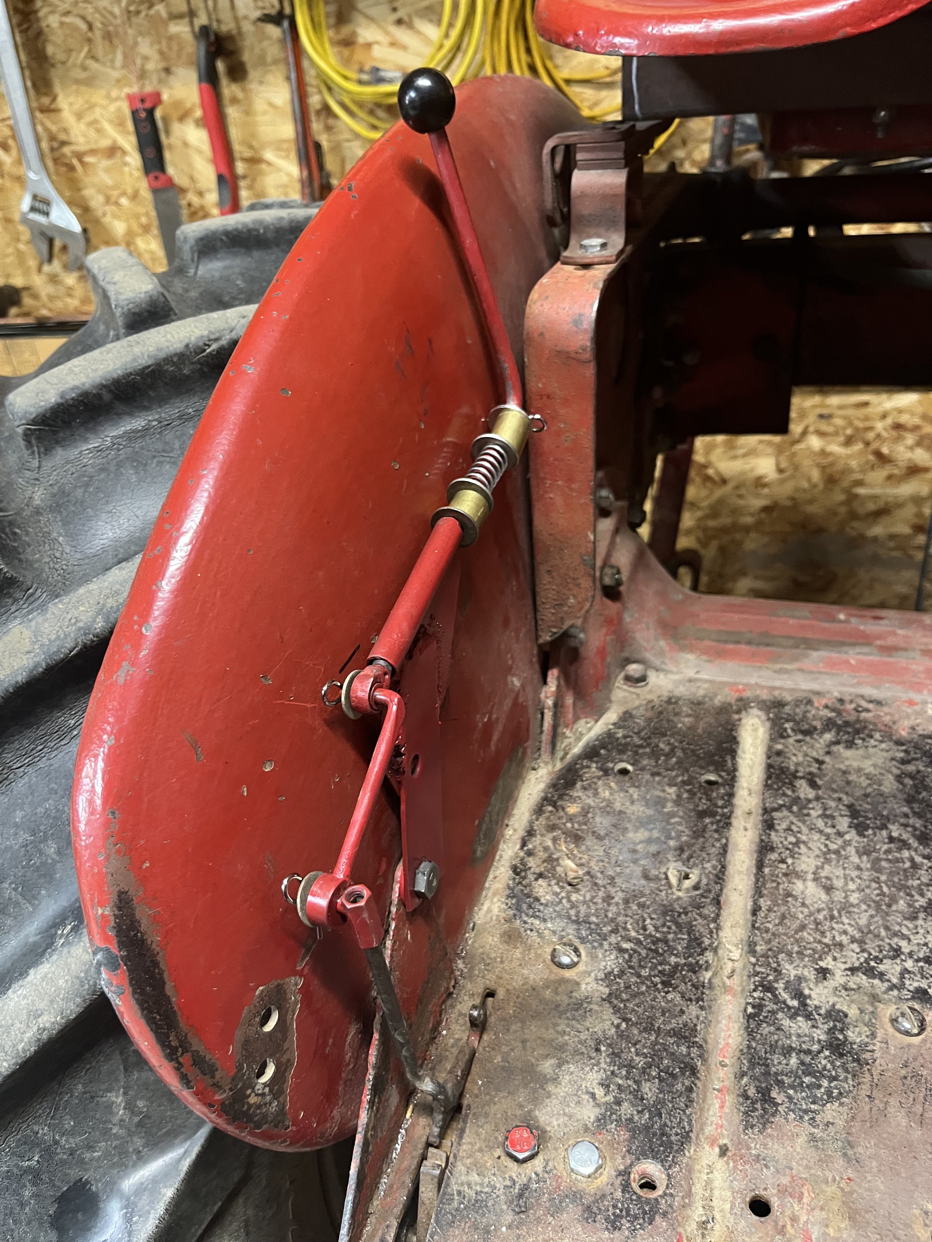

Super A Parking Brake
Pete7
Member
I got tired of bending down to activate the parking brake. So I made up some linkages to make it work without bending. Push the black knob while pressing the brake pedal and it activates. Hit the pedal and it snaps off. Should have done this years ago.
