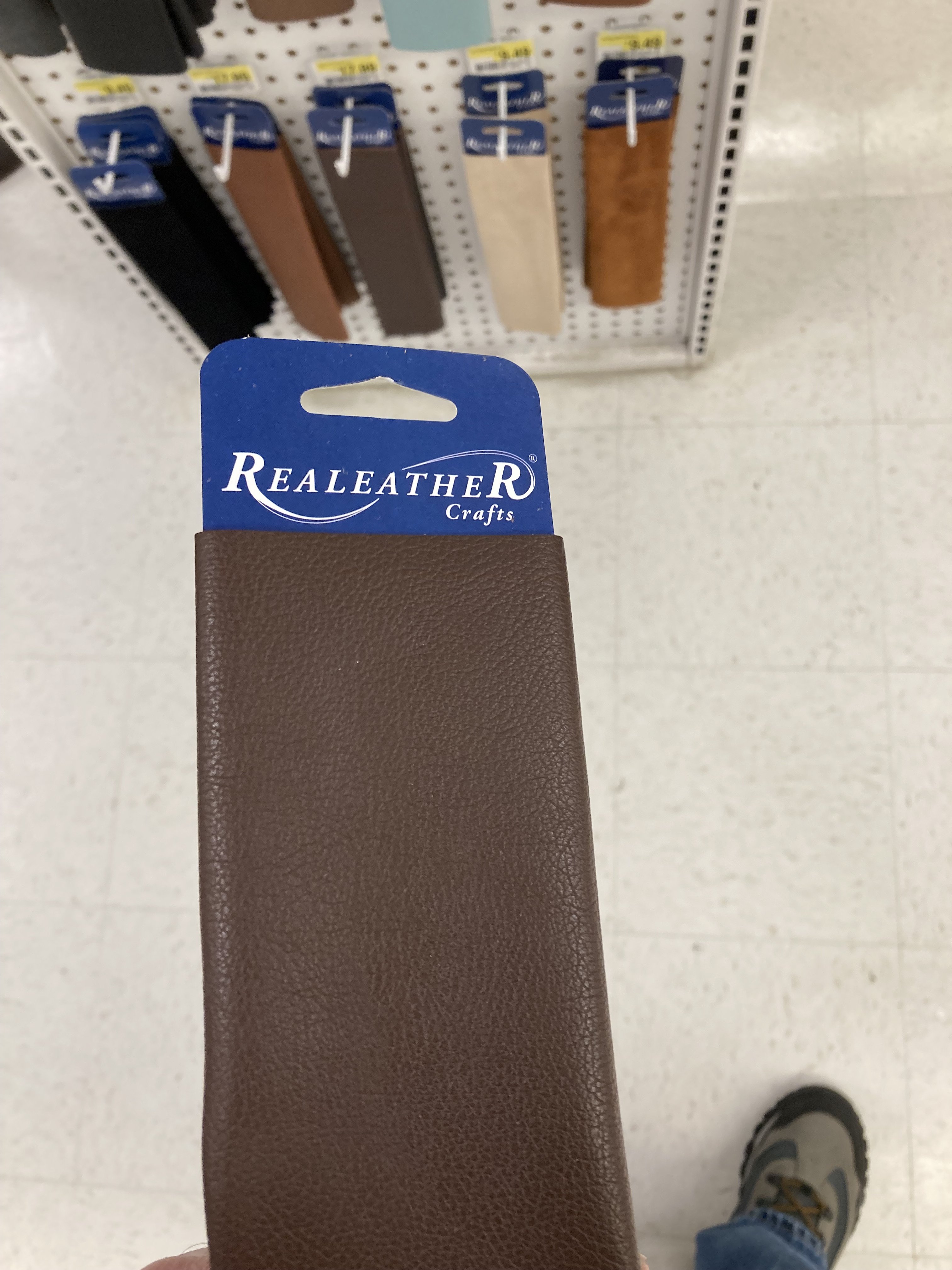

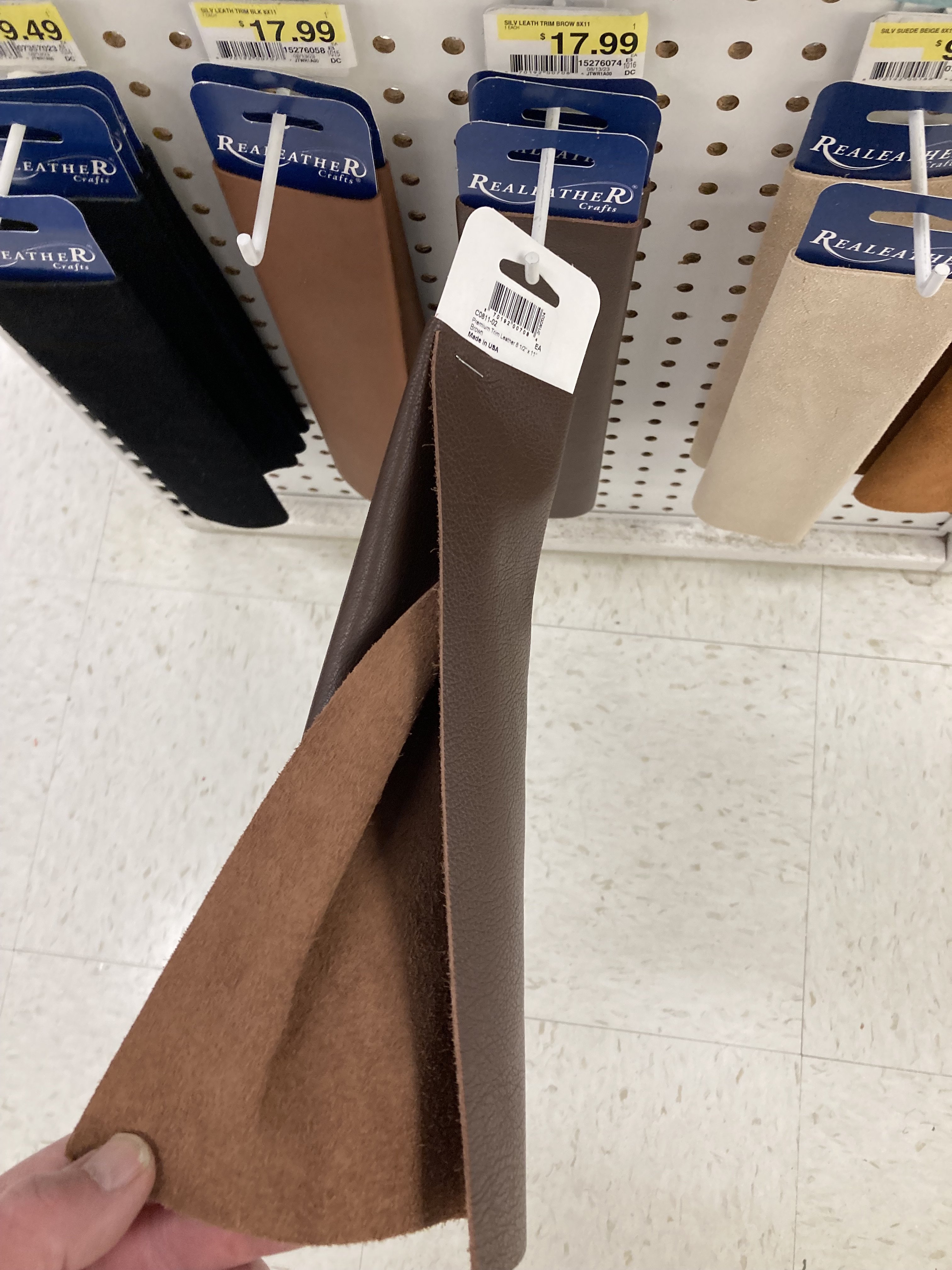

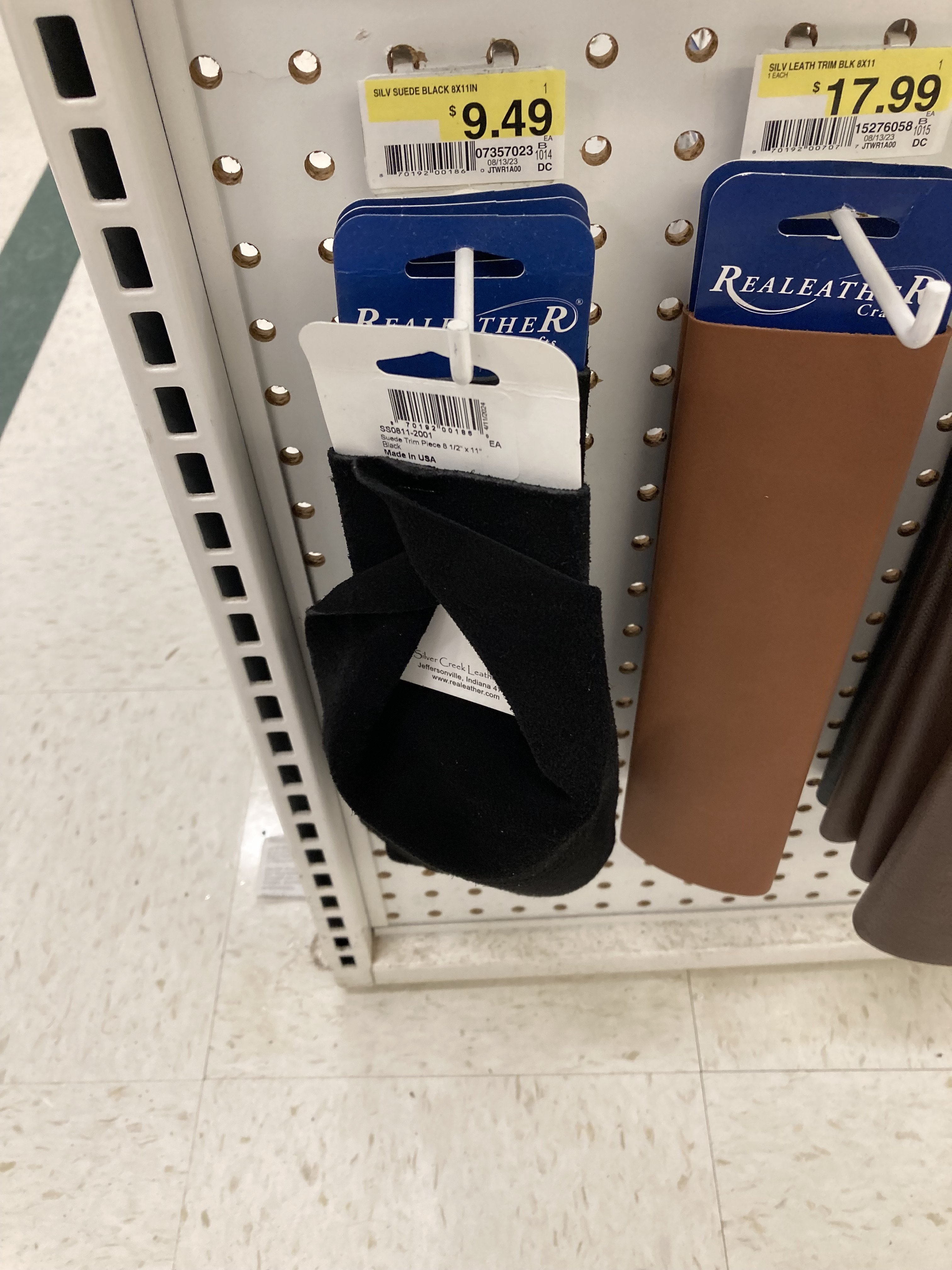

If you got someone to sew leather ,Joan fabric has these leathers

Hate to say it, but the fact that you can't get the boots to stretch enough to fit now is an indication that if you do ever manage to get them installed, they will split in fairly short order.
Most leatherworkers don't work for free. I can't imagine them charging less than $80 to dissect your old boot and replicate it unless they owe you a serious favor. That said, this is pretty basic leatherworking. Cut the old boot apart at the seams to make yourself a pattern. Get yourself some thin leather, and the appropriate needles and thread from the local craft shop. Watch a couple of Jimmy Diresta videos on youtube. Now you're an expert. It's a dust boot in a concealed location, not a pair of dress boots. Doesn't have to be pretty.
You might also look into CV boots for ATVs.
