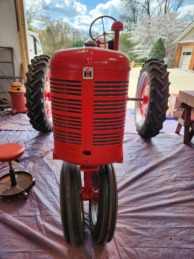

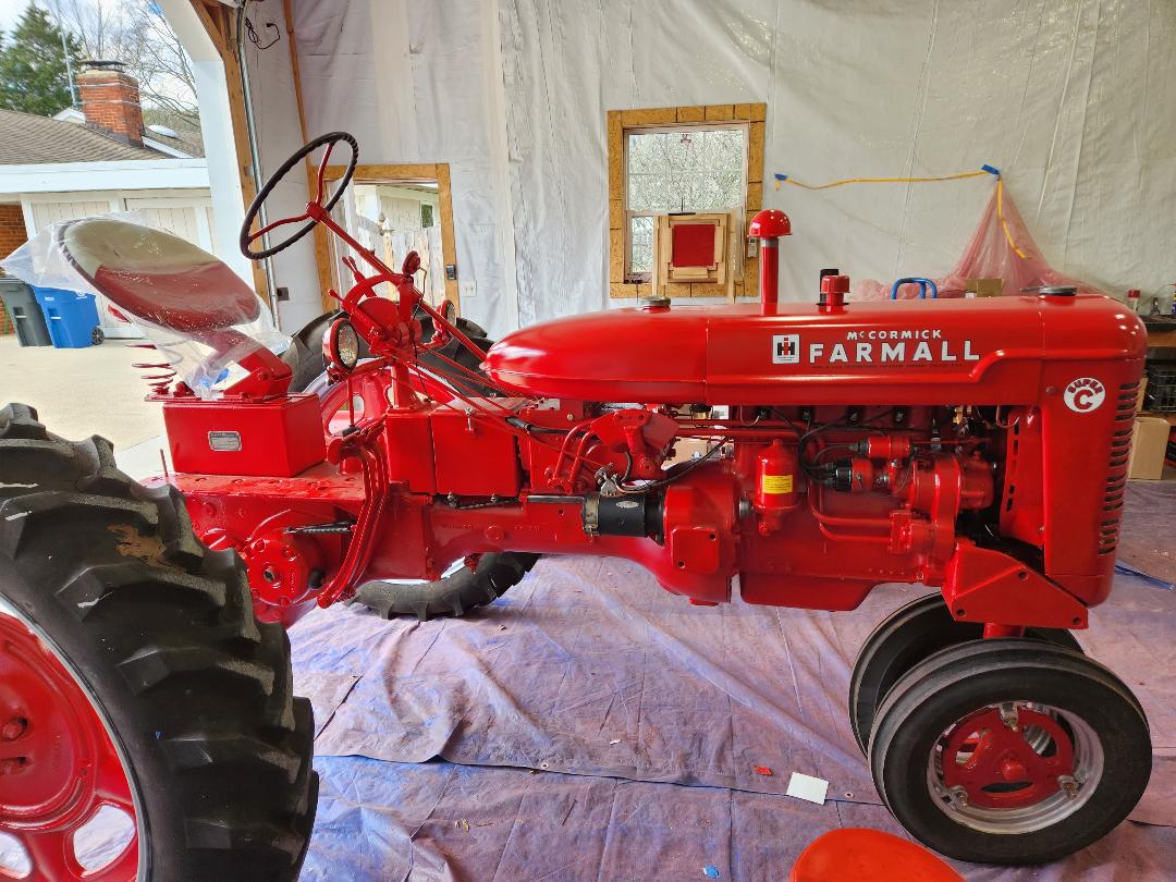

here is the Super C... minus muffler...and prior to fixing the decals...
