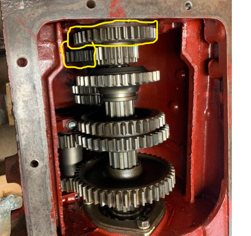

Good morning gentlemen, I am working on a farmall super m for a gentleman that had it apart and put it back together, to put it politely things did not go well on reassembly and it has been long enough that he does not remember all of the details.
The problem I have is the front upper and front lower gears are pushing against each other and binding the transmission up tight. I was told by the owner he had the top shaft out to replace a worn 5th gear, I am not sure of he had the entire pinion shaft out or if he just slid a new 5th gear on
From what I can see the only adjustment is the shims on the pinion, nothing else moves. I believe I either need the top shaft to move towards the front of the tractor or the bottom shaft to move towards the rear of the tractor. Has anyone ran into anything like this before?
Everything is checking out according to the service manual the only thing I haven’t checked is the mating of the ring and pinion gear. I could see shims getting lost and I feel if the gears aren’t set up properly that would be one way to tell.
I have attached a picture of the two gears that are rubbing against each other

The top gear circled is attached through a cover on the front side of the trans housing.

Those 2 gears dont come into contact with each other, so if they are theres your problem. That lower gear rides on the gear with the cut teeth.

Jim, I think your reply is very valid. When I first read his post I had the idea that the gear teeth were bottoming out as they mesh and were tight in that way. I think the real problem is they are rubbing against each other front to back. It would be nice if the OP would clarify if this is the problem. I am not sure if it will help or not but a slightly closer photo with light to see the actual areas that are contacting would be helpful. Also hopefully if the owner knows if he had actually had the counter shaft out would be helpful.
Whichever way the interference is appearing, I think a wrong diameter gear could still be the problem, maybe along with some mis-assembly. It would also be helpful if the old parts that were removed were still on-hand to make comparisons. Unfortunately, one of the first steps most beginners make is to throw all the old parts away. I agree a picture that actually shows the point of interference would be a big help. If the two gears marked in yellow are really the ones he says, the upper gear must not be fully back to its normal position.

That is correct, the gears are not meshing too deep and binding the gears are binding front of tractor to back of tractor. The gears that are contacting each other do not mesh

The "top" pulley only runs the belt pulley assembly, it should not contact anything on the lower shaft. The other circled pulley contacts the input shaft on the geared area where it looks like the teeth have been shaved, which is for 5th gear. The entire bottom shaft should spin from the input shaft. Jim would be correct that the gear is the wrong gear

After reading some old threads with more info yes it is the belt pulley drive gear. I was just calling it what he called it. It appears the correct terminology would be the belt pulley drive gear is rubbing the countershaft drive gear

Unless you cleaned stuff up looks like all parts maybe were removed. Looking at picture it doesn't look like the two gears circled are that close. Mybe just picture angle. Can't make out any shims at main shaft bearing housing but could be there. May not matter at least if the two gears circled are touching on facing sides. Input shaft distance inside housing is placed by a spacer between the two bearings with the front bearing having a retaining ring on the OD. Ring is clamped between the bearing and seal retainer. Rear bearing on input shaft just ends up in a smooth bore. Shaft retention also depends on front yoke contacting the inner race of front bearing and being tight. Counter shaft is placed by the front bearing retainer and hydraulic unit drive nut or nut if it came with engine driven hydraulic pump. Again, bearing has a ring on OD. Gasket thickness on input housing can affect a little the front to rear shaft positions. Two thick on seal retainers can let bearings move a little more. Constant mesh gear has spacer between hub of it and front bearing. Constant mesh hub is close to same on both sides. Most times number or front can be seen toward front. If gears were removed from bottom shaft they were pressed on. Maybe this will give you a idea where to check, unless parts are mixed. Other check for the two gears binding is front bearing on main shaft and correct retaining part and bolt used. On some a regular bolt head can be to thick. From picture it looks like the transmission drive gear and constant mess gear teeth engagement are normal.
Thanks to all for the ideas and suggestions I have it working properly again. It wound up being the front bearing on the front section of the upper transmission shaft was installed backwards. This put the snap ring on the wrong side and pushed the upper shaft back too far and caused the gears to contact each other. I pulled and flipped the bearing and everything is good to go now
