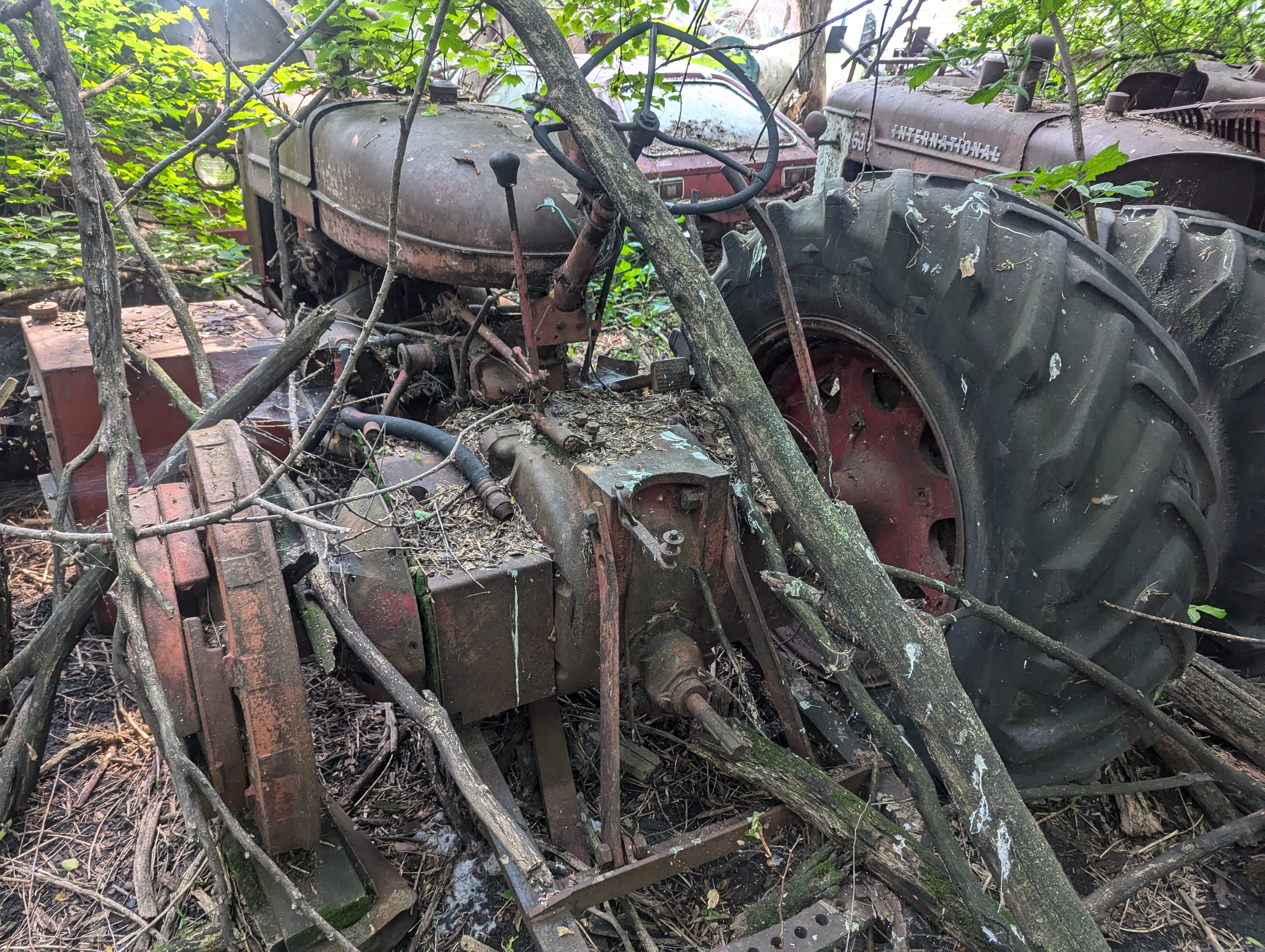

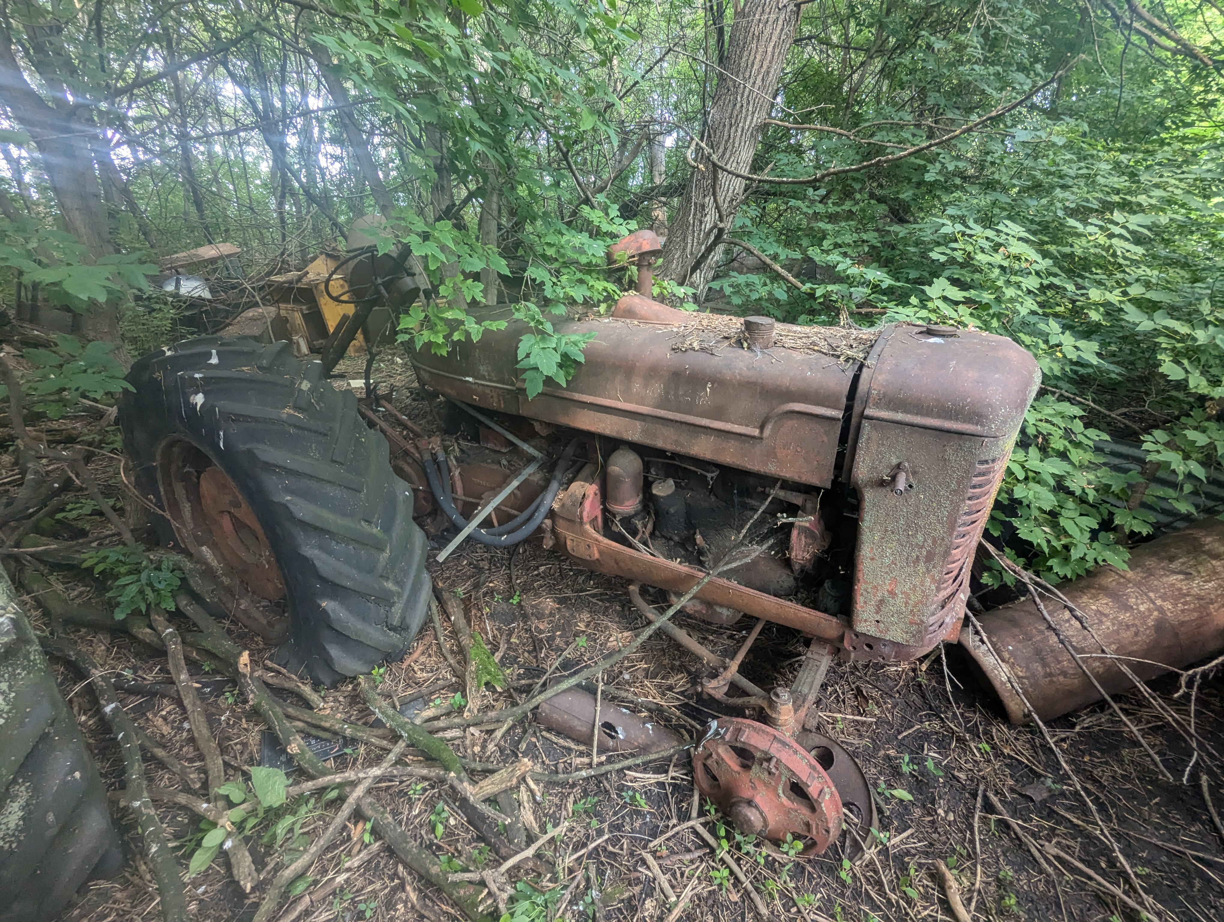

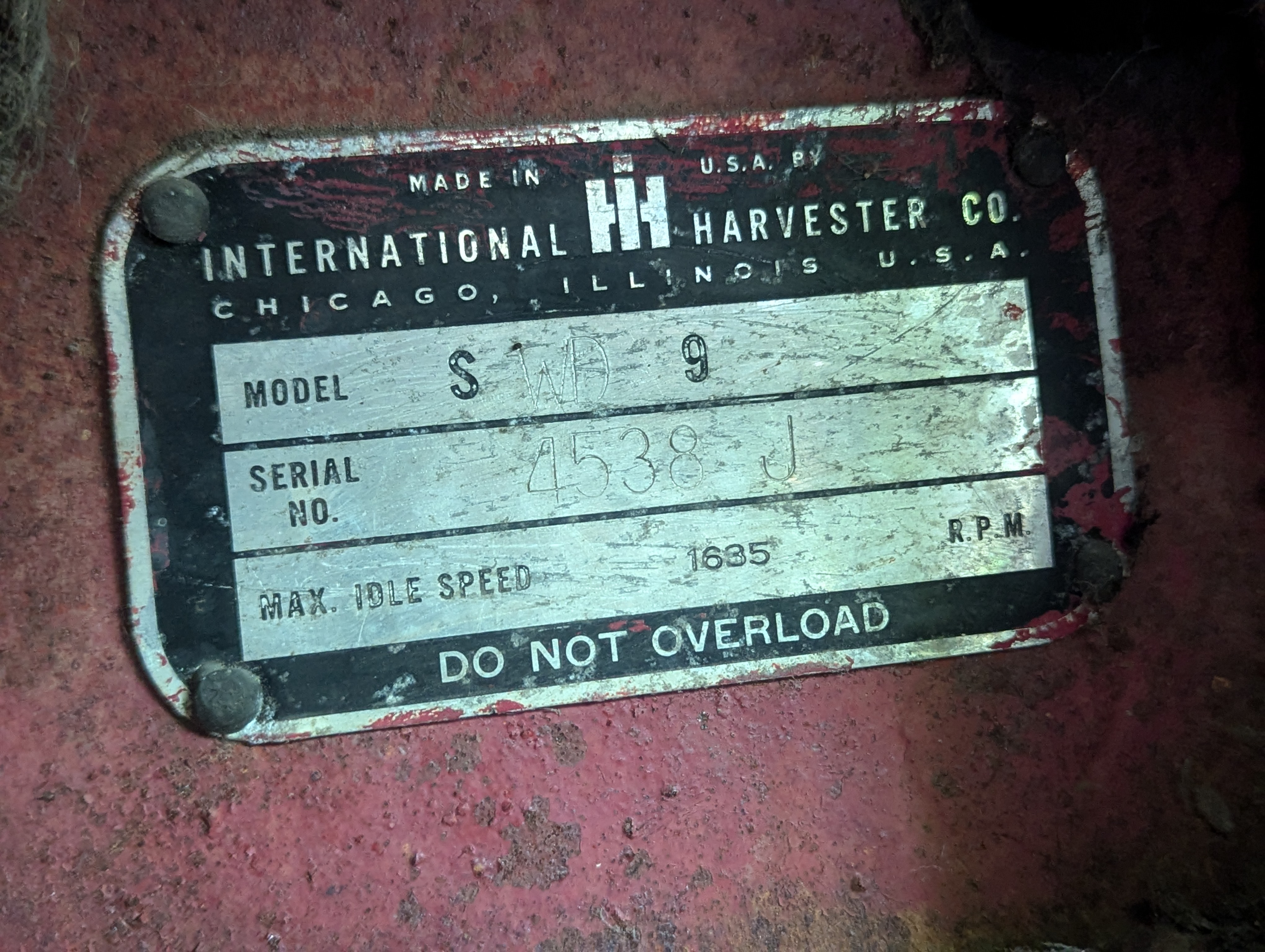

On the serial number tags super is indicated by an S so you have a SuperAt my farm we have a tractor back in the trees, on the hood it says Super WDR-9 but the serial tag just says S WD 9, say nothing about being a WDR-9. I would assume it has the wrong hood but it has a hand clutch. If someone has had any idea it would be appreciated.
It’s quite possible to have the wrong decal on the hood. Most important is what the serial number says. Yes either models can have a hand clutch do that don’t say much as to what it is. Does it have a decelerator ? Rice models have them. Mine is serial number 7100 with only I think 20 some tractors built after it. Even if you post a pic of it. Wonder if it has the 26” hubs of the 34 “? Plus it has i higher platform so that is another give away too. Post the rear also.At my farm we have a tractor back in the trees, on the hood it says Super WDR-9 but the serial tag just says S WD 9, say nothing about being a WDR-9. I would assume it has the wrong hood but it has a hand clutch. If someone has had any idea it would be appreciated.
He knows that it is a super , he is asking if it’s a rice model.On the serial number tags super is indicated by an S so you have a Super
