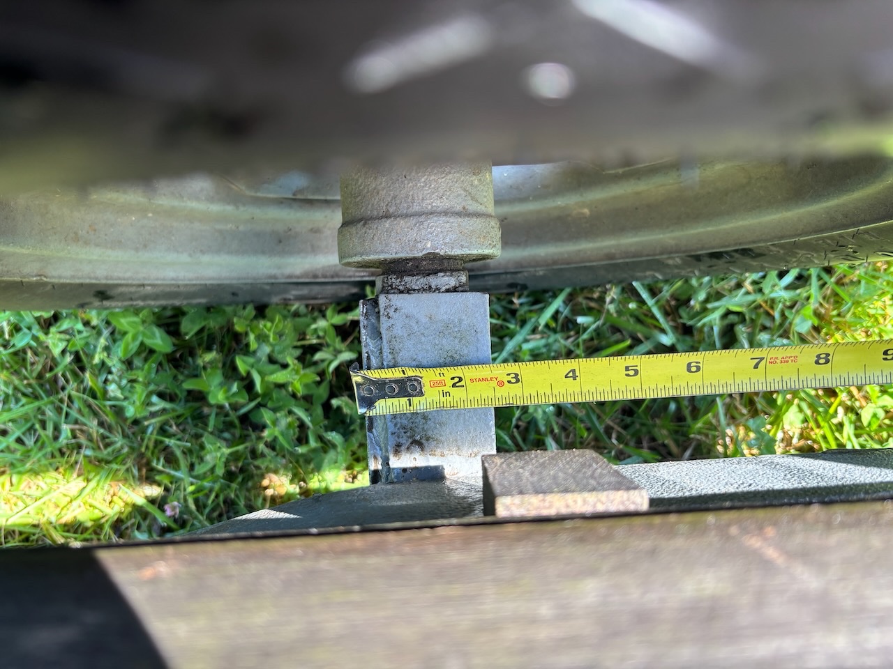

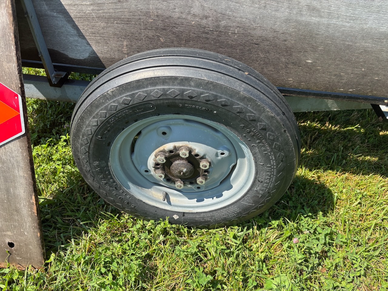

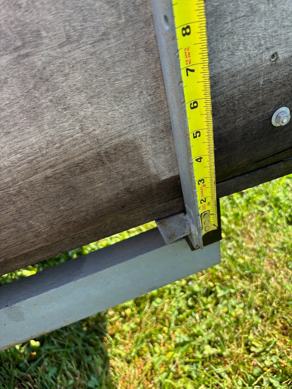

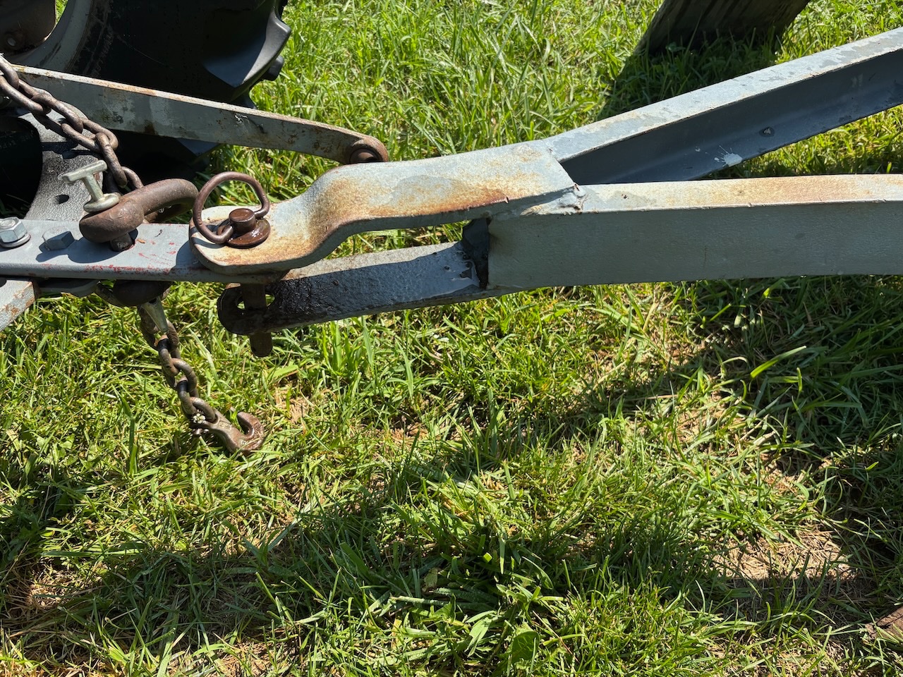

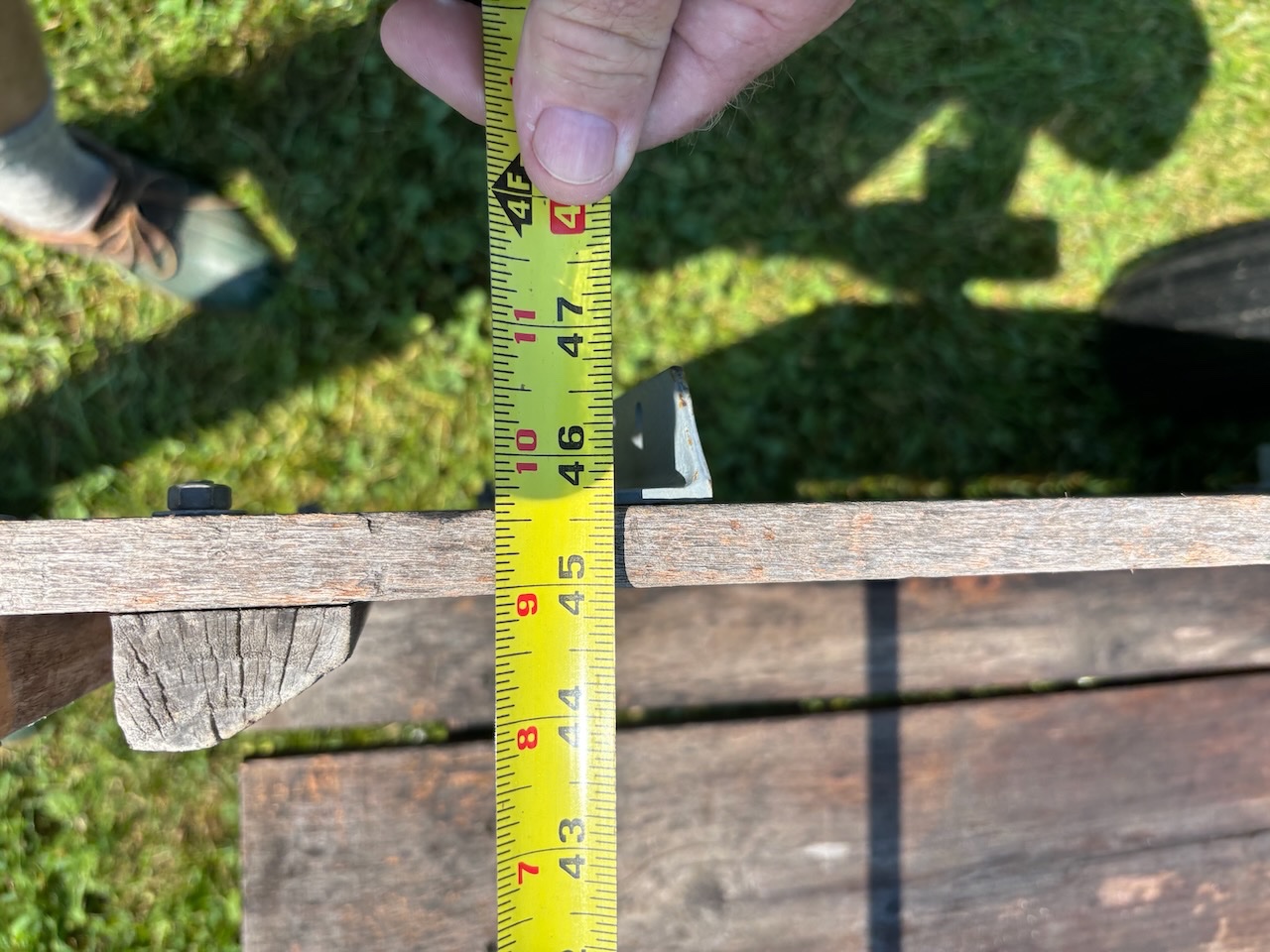

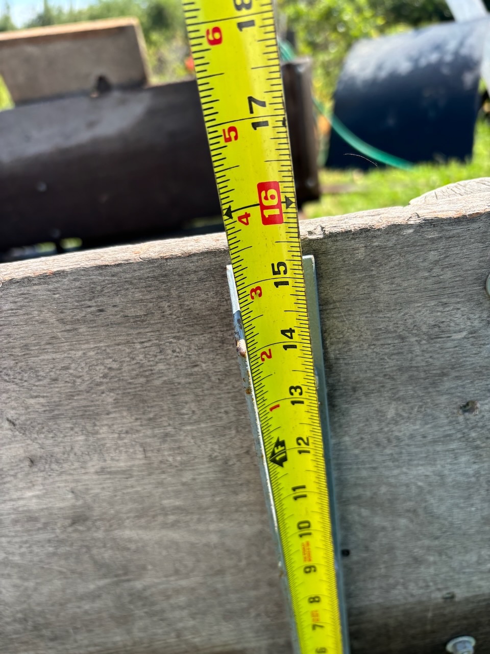

Finally after starting on this project four years ago it is finished. The original frame is was completely stripped and painted, original wheels have a new set of tubed tires. The wooden bed and sides were missing along with the bales, or uprights for the sides so New were fabricated from repurposed angle iron from bed rails. The wood support rails are 2x4 pressure treated wood and the bed and sides are 3/4? pressure treated plywood rather than joined planks. I tried to match the dimensions of everything from the SW-2W manual that I found on a Ford forum. Hopefully I now have a wagon that may last a long time, and another Ferguson implement

I just rebuilt it along the lines of what was left - I had the frame and stakes and wheels sandblasted and I then painted them - it's had one ba-stard wheel with the other being a Ford/Ferguson 16" front tractor unit - I purchased another tractor front to match it - I just got notification today that the implement tire had arrived and the tire shop is ready to mount it - I like the looks of your wheels which I am guessing are original -

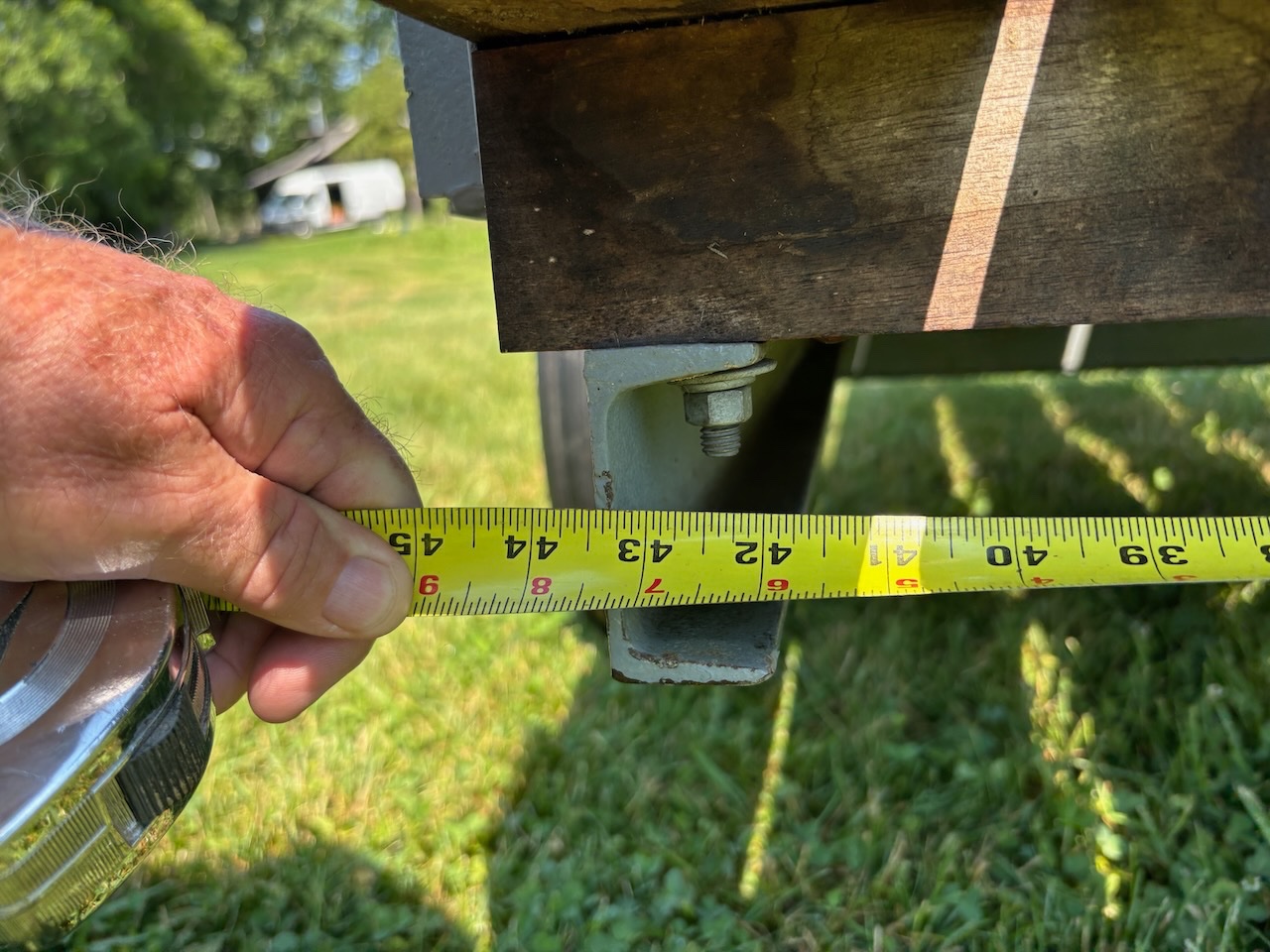

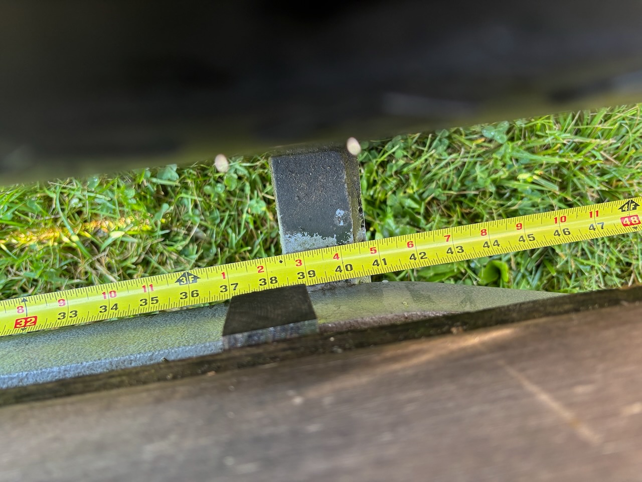

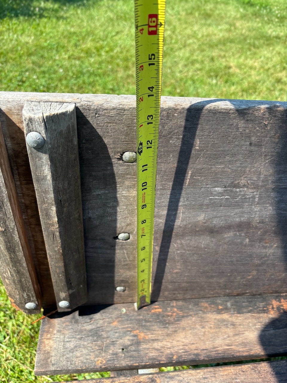

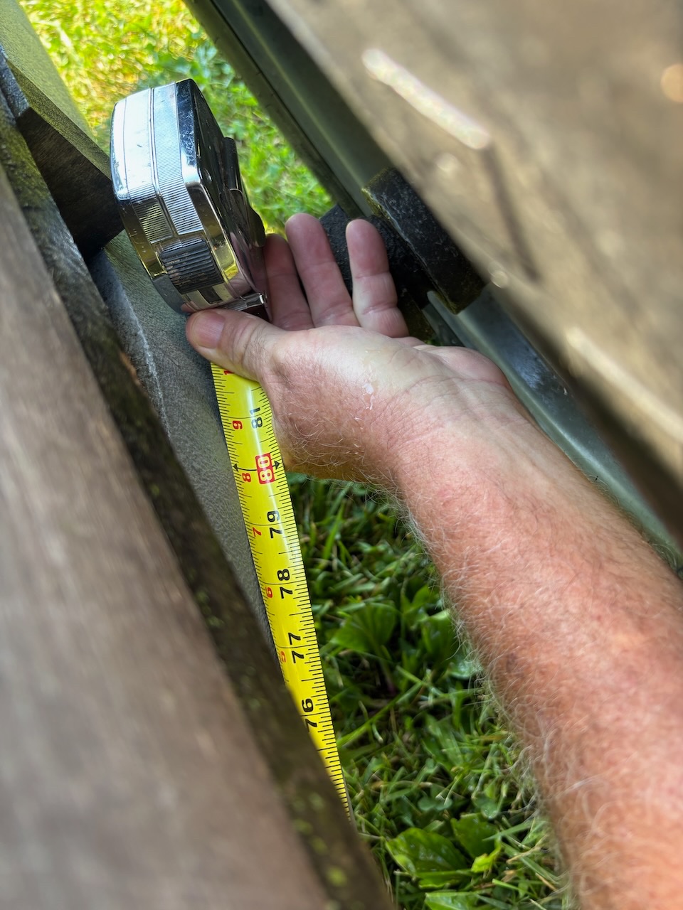

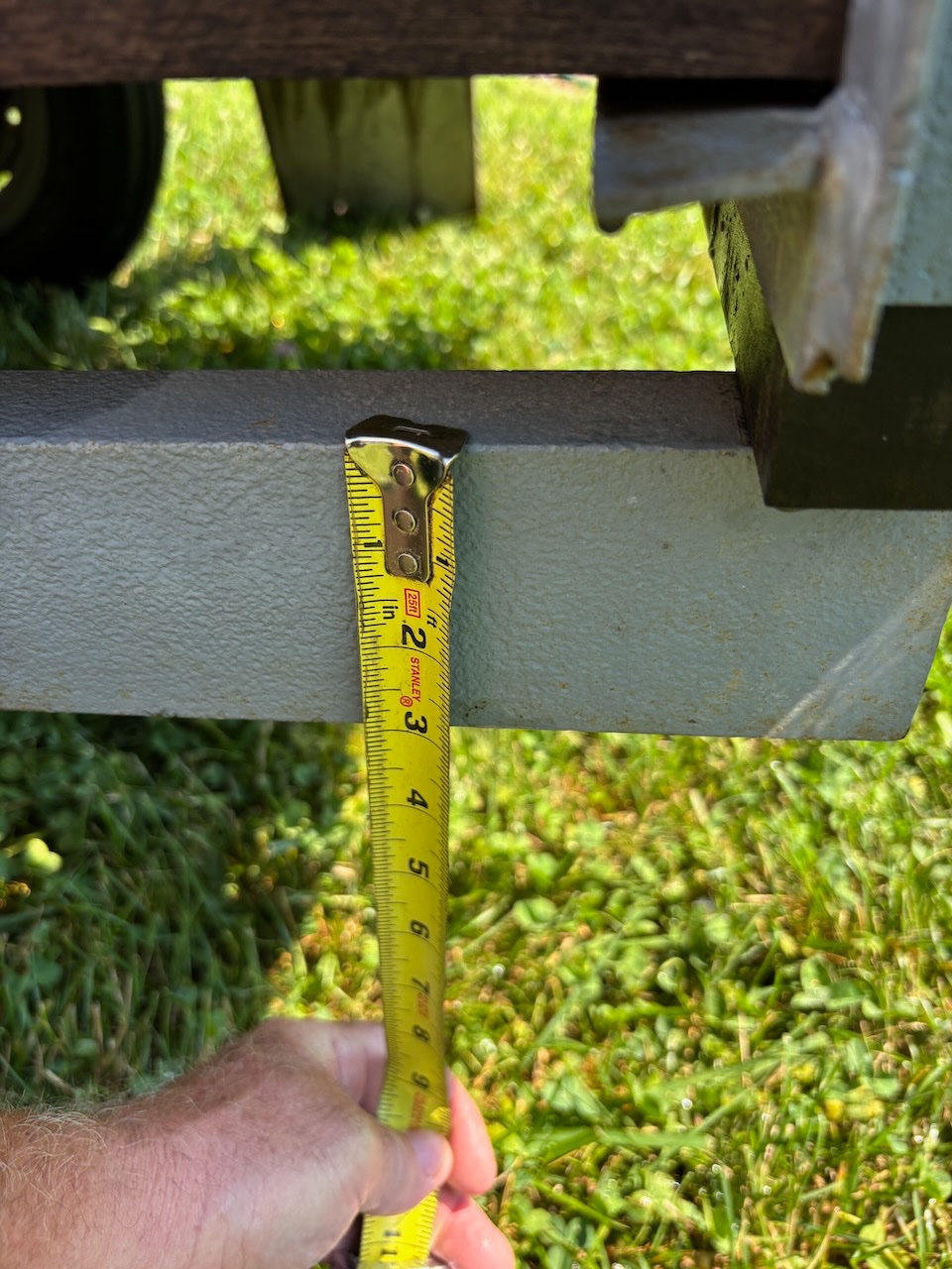

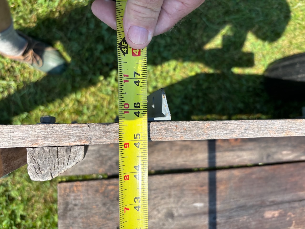

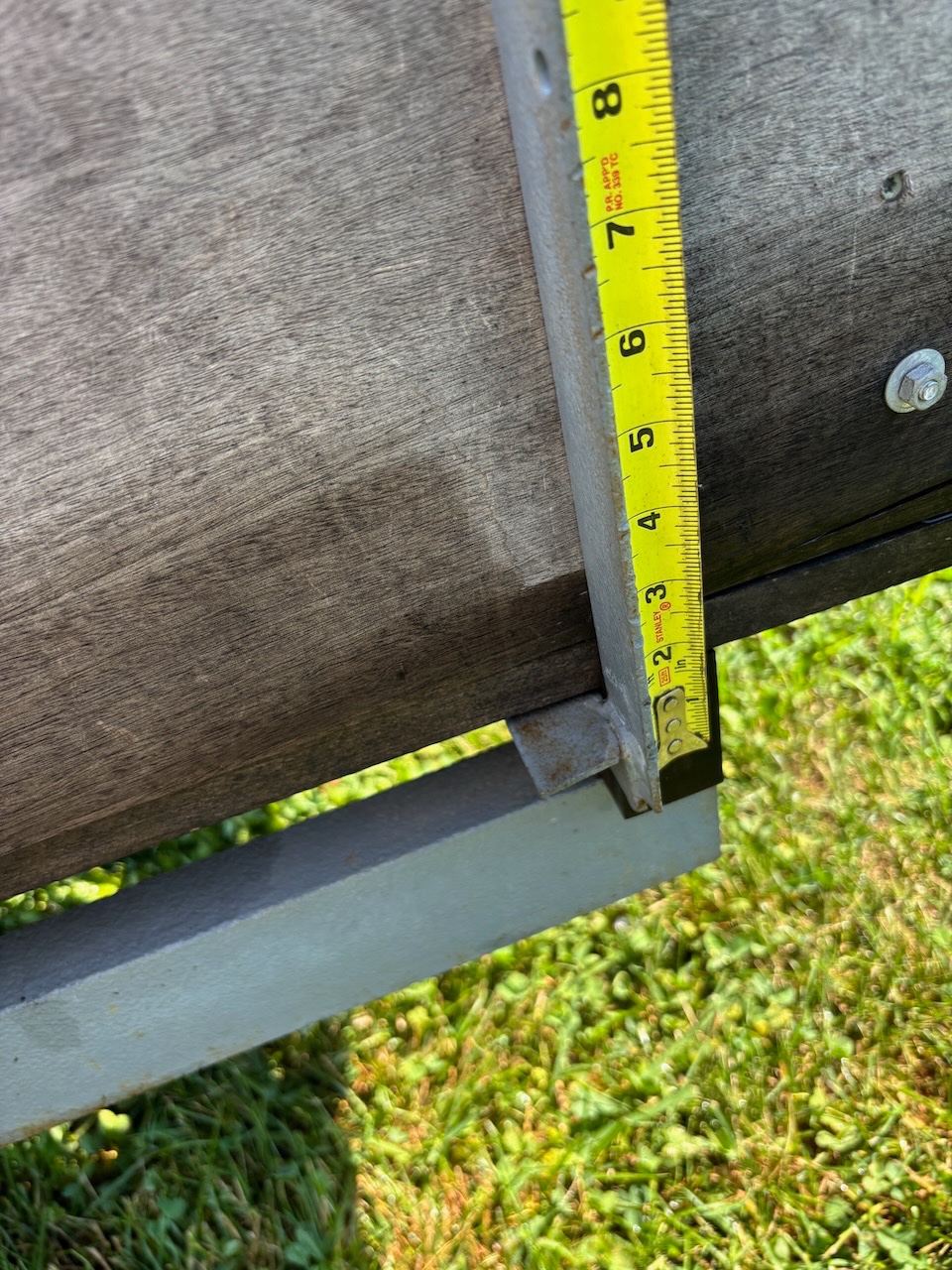

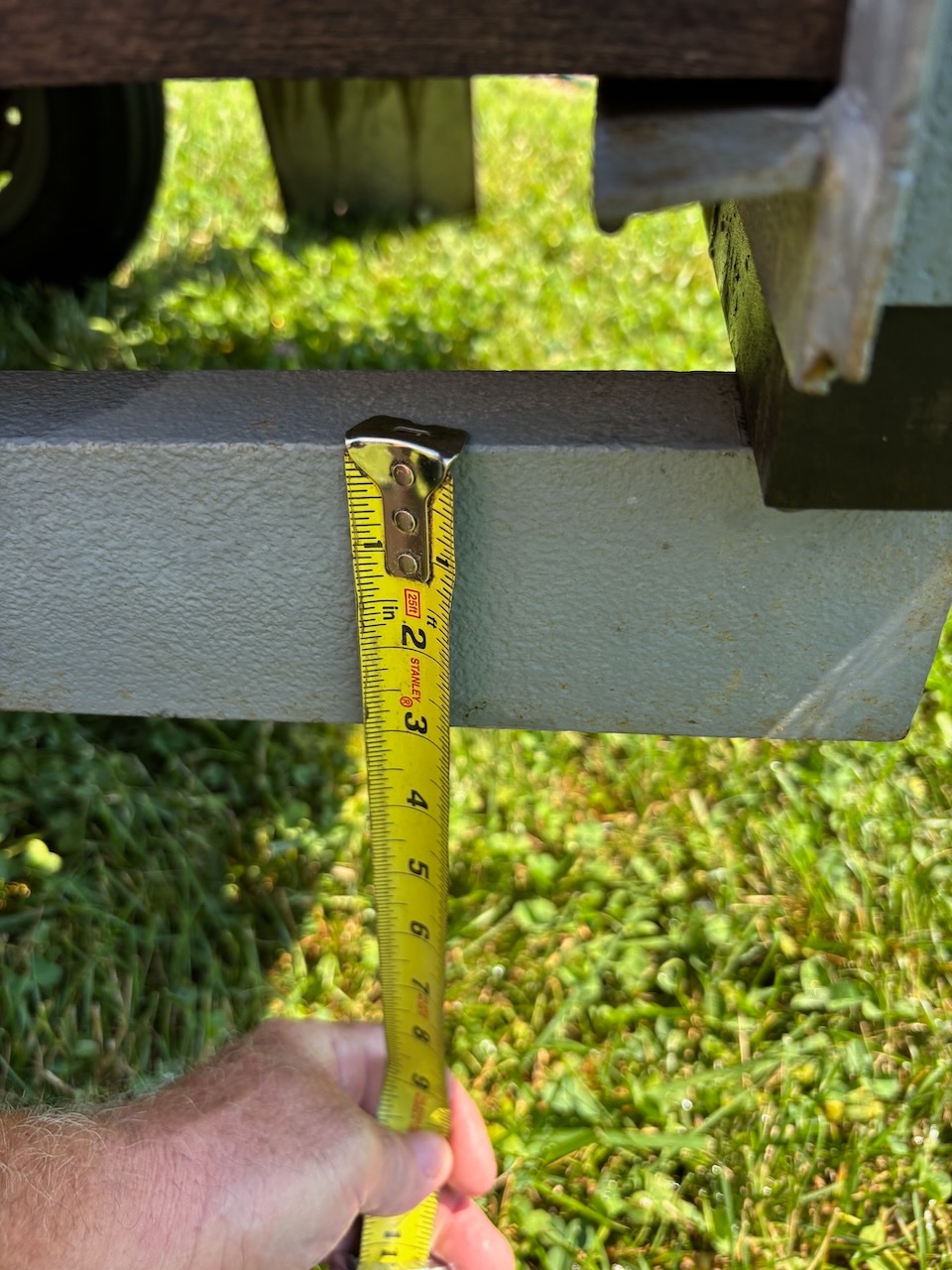

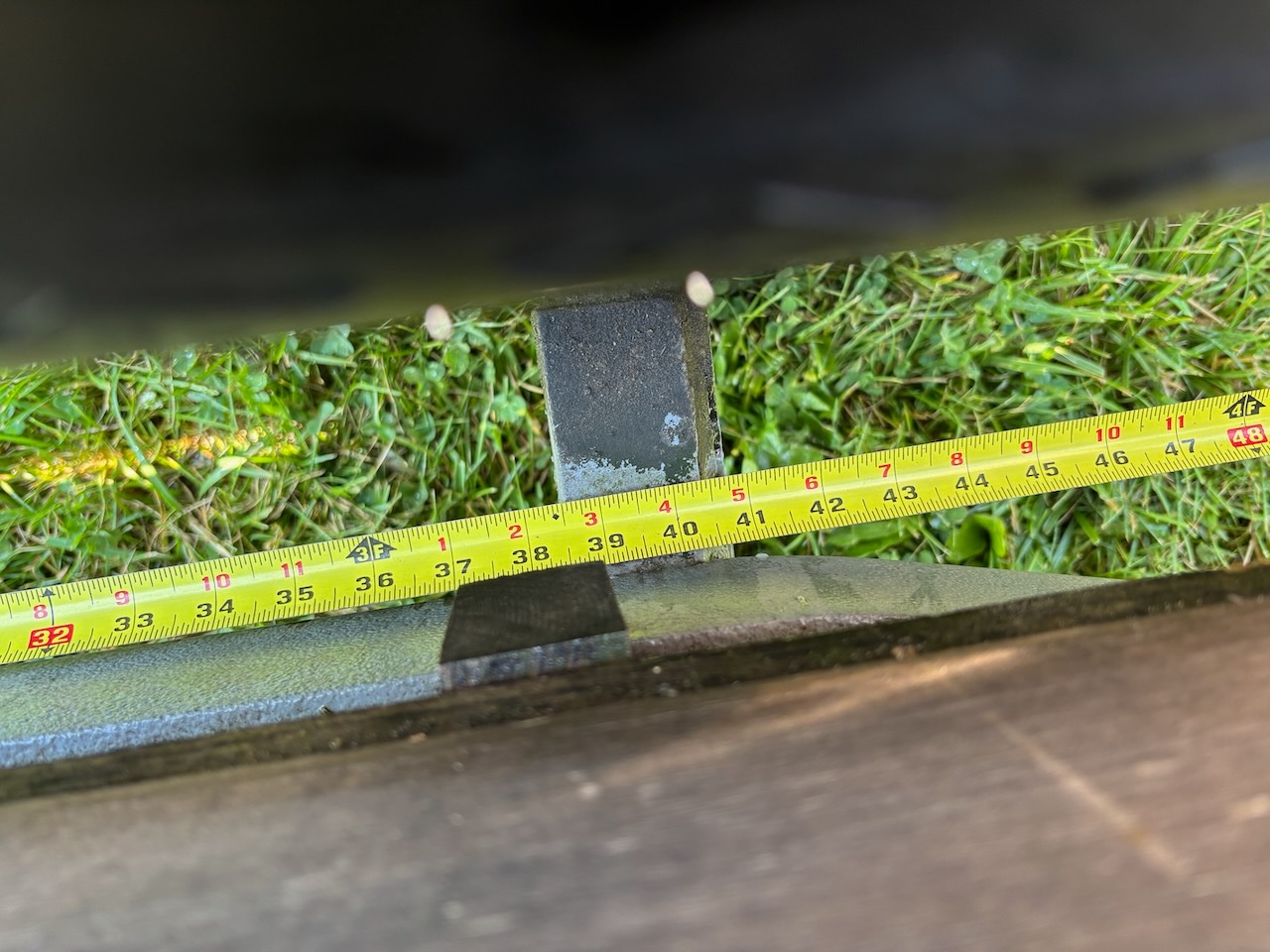

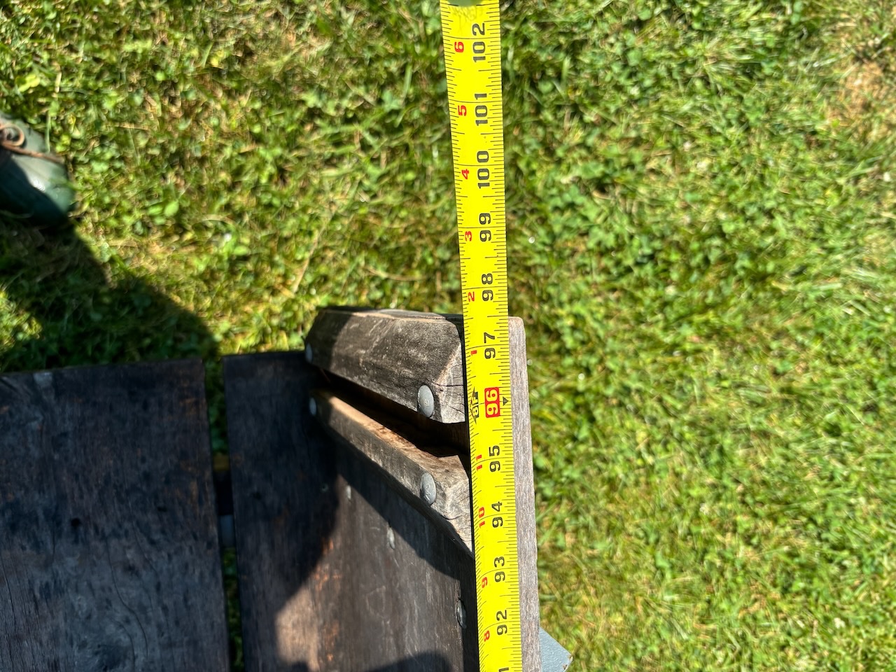

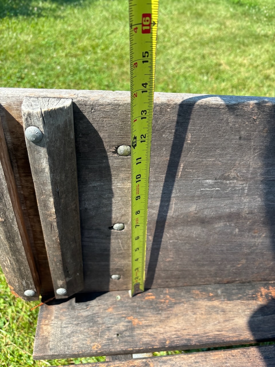

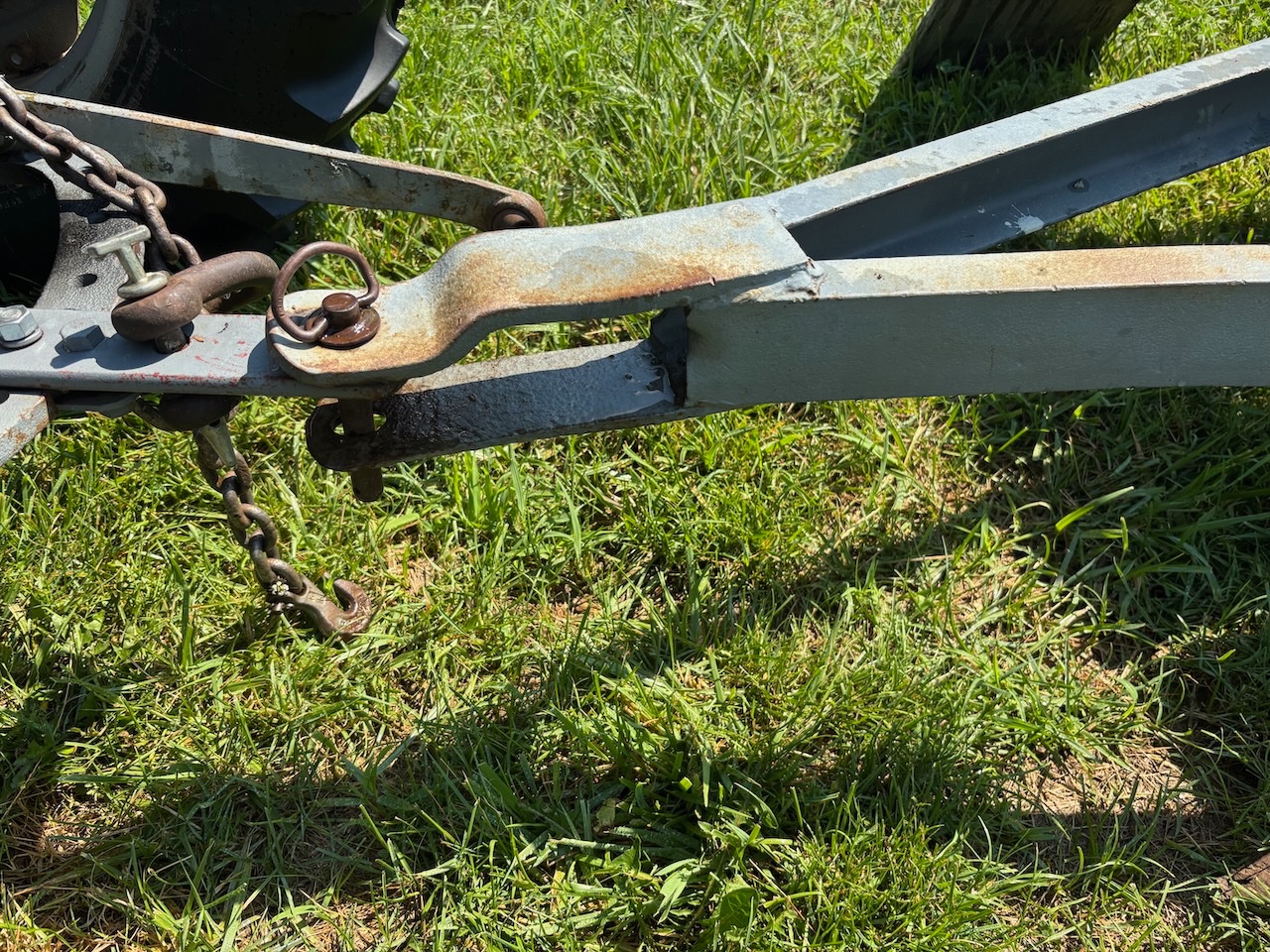

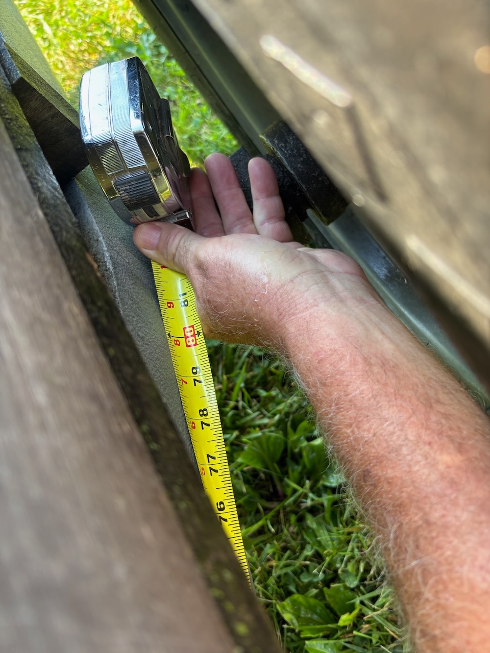

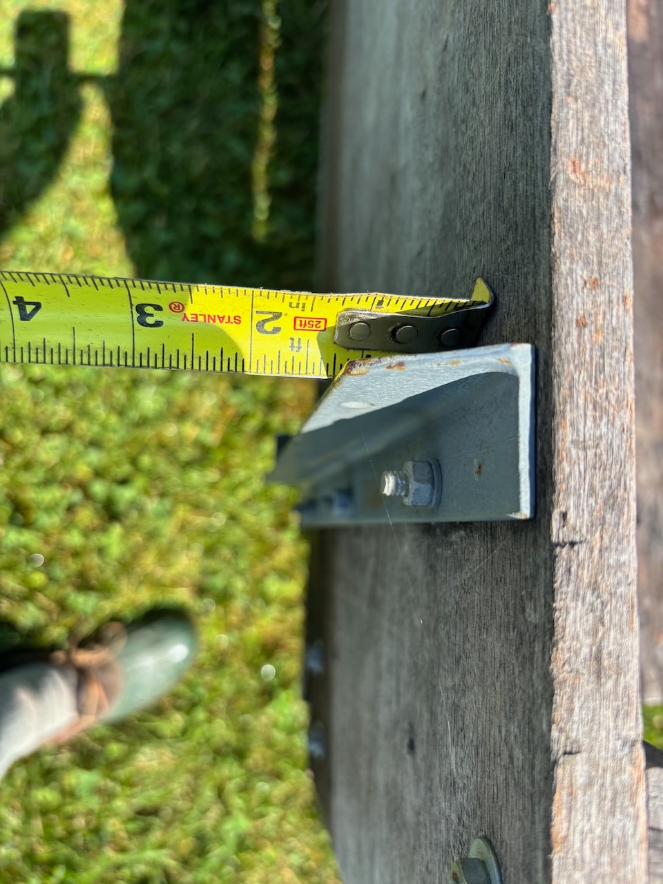

So - in the interest of archiving knowledge here at YT, I'll post a few picts of what I believe are original details -
gate rod details - mine had one rod and I think it is original -
I see stakes in your picture holding the ends in place - the sides on my unit had cleats to support the ends and any evidence of stakes was long gone. These cleats were riveted in place which makes me suspect they were original.
Here's where there was a small tag attached to the side - this I really regret losing - I was aware of it, but when I got ready to do this renovation it had at some point loosened and was lost. I hadn't anticipated that or I would have removed it for safe keeping (and probably misplaced it amongst all the other pieces).

Thank you and very nice job on your wagon. Finding the manual was a huge help with the project,but, didn?t offer much information on how the
factory pieces were made. I have assume all the decking was joined planks as well as the sides. Also if your end rod is original it would explain
these ease of removal of the end gates. Trying to use the drawings in the really didn?t show how they worked other than to secure the sides
together. I may change mine to look like yours.
Seeing the rivets holding the gate stiffeners makes sense. I had glued and screwed mine together
So now with your information I?m tempted to maybe do a true restoration. Maybe.

beautiful restoration. you all wouldn't be willing to share measured diagrams so someone could build a replica since finding them is proving to be very challenging for me.
