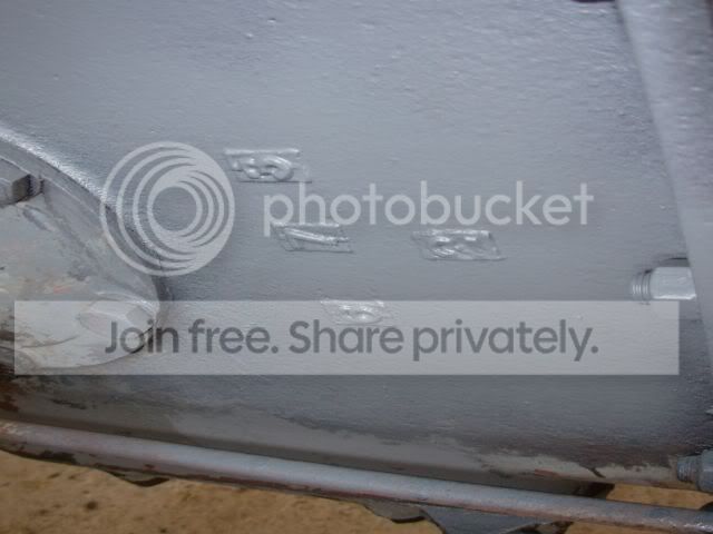

[b:d3fae17f0e]Tony[/b:d3fae17f0e]. If your dash panel data plate is gone you are in trouble for a serial number!
However, approximate date of manufacture is easy. Look on the right side, between the gearbox/transmission to diff mounting flange and the round "port hole" inspection plate, and you will find numbers cast vertically into the diff housing:
The sequence is Day - Month - Year. My tractor has "6 - 7 - 3" being a casting date of 6 July 1953.

Bob, thanks for the picture. Mine is "9 11 8" however the casting numbers are nowhere near as big as the ones in your photo. Also has a big "3" to the front of the numbers. What's that?
[b:1694cac615]Tony[/b:1694cac615]. Your diff housing casting date is 9 November 1948 so date of manufacture will probably be in the second half of November 1948. No idea what the "3" means; my tractor has a "2" - which may mean 2nd or 3rd work shift?? who knows, but it is not relevent.
The TE20 Serial Numbers for 1948 were 20895 to 77772, so your tractor is probably around serial number 73000.
