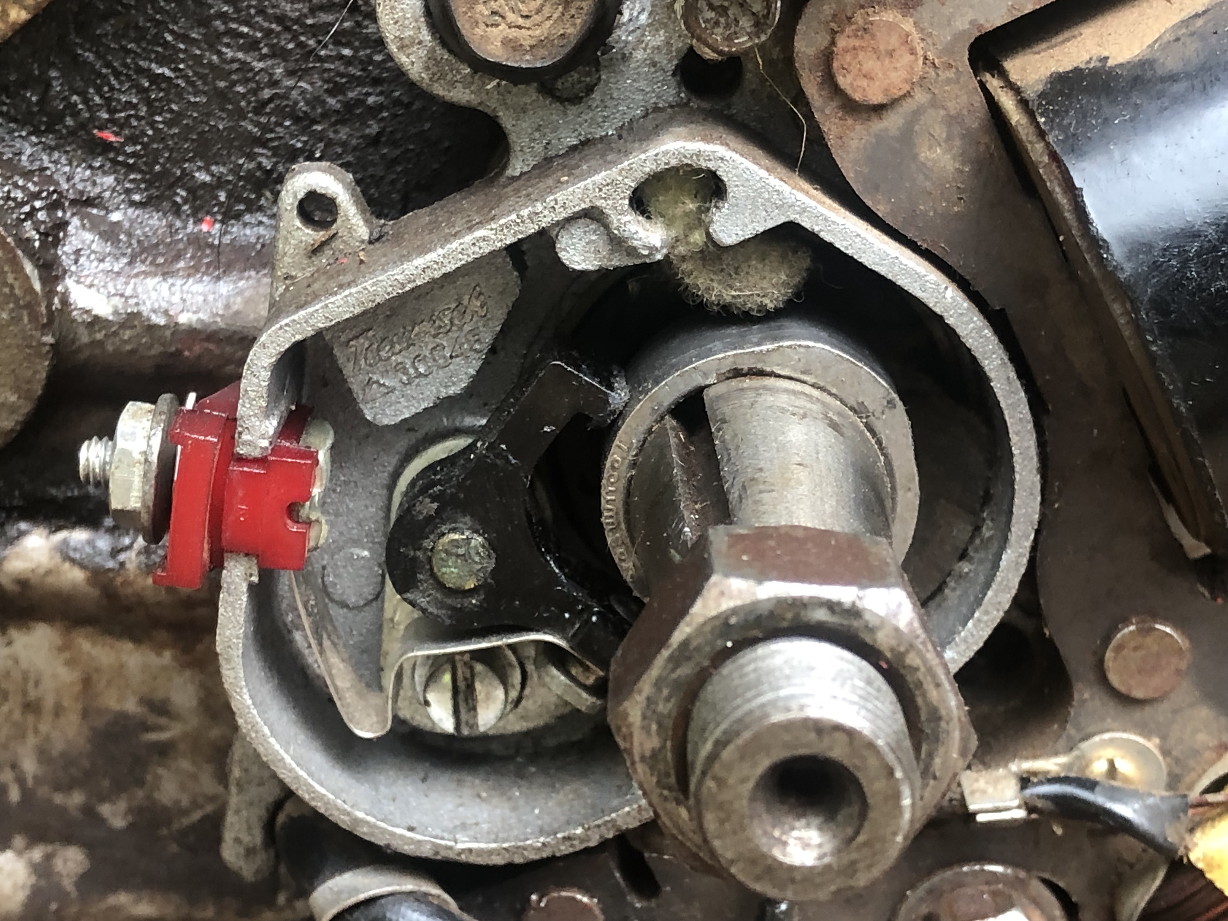

My TroyBilt tiller over-revved, broke conn.rod, on 6hp engine, which I replaced. Reinstalled cam with mark aligned with beveled tooth - the only mark on the crank shaft gear., with piston at TDC. Then tried to set points,
I turned the crank until the intake valve opened and closed and stopped turning with piston at .080“ BTDC - the point at which ignition should occur. But, at this point, the points cam lobe - which is machined into the crankshaft - is ~40• past the opener on the points, and I can’t turn the mounting plate far enough clockwise to get to the lobe.
I would expect the points to be just opening, but the lobe is way past that point.
Does anyone have a clue as to what I might’ve done wrong with my reassembly?

I forgot to mention that the points are gapped at .020“ and both valve clearances are within spec, at .008“- .012“.

If the points cam lobe is removable, is it upside down?
I wish it were, but it’s part of the crankshaft., which turns clockwise. I aligned the marks on the inside, crank and camshaft. In the picture, the piston is at .080“ BTDC on the compression stroke, right where it should be, I think, but maybe I don’t understand single piston four stroke functioning properly. Thanks!

I was thinking that you needed the head off and have the piston set a measured depth(using a depth micrometer) to set the points. But it has been awhile.
No, that’s true, and that’s what I did. In the picture, the piston’s at .080“ BTDC on the compression stroke, right where - I believe - the points should be opening and the plug should be firing. The points mounting plate only allows slight movement, but you can see in the foto, the camlobe has already rotated past the points. What did I do wrong? And it’s already mid-May and the crops are not in the ground yet. Oh well!

The cam lobe comes off from the crankshaft. It is on upside down. When off, inspect the keyway in the crank, and also the tang on the cam lobe.

Yes, that was it! Thank you! I had read that it was machined into the crankshaft. I think it must have moved when I replaced the rod. I will soon m, hopefully, get my garden tilled.
