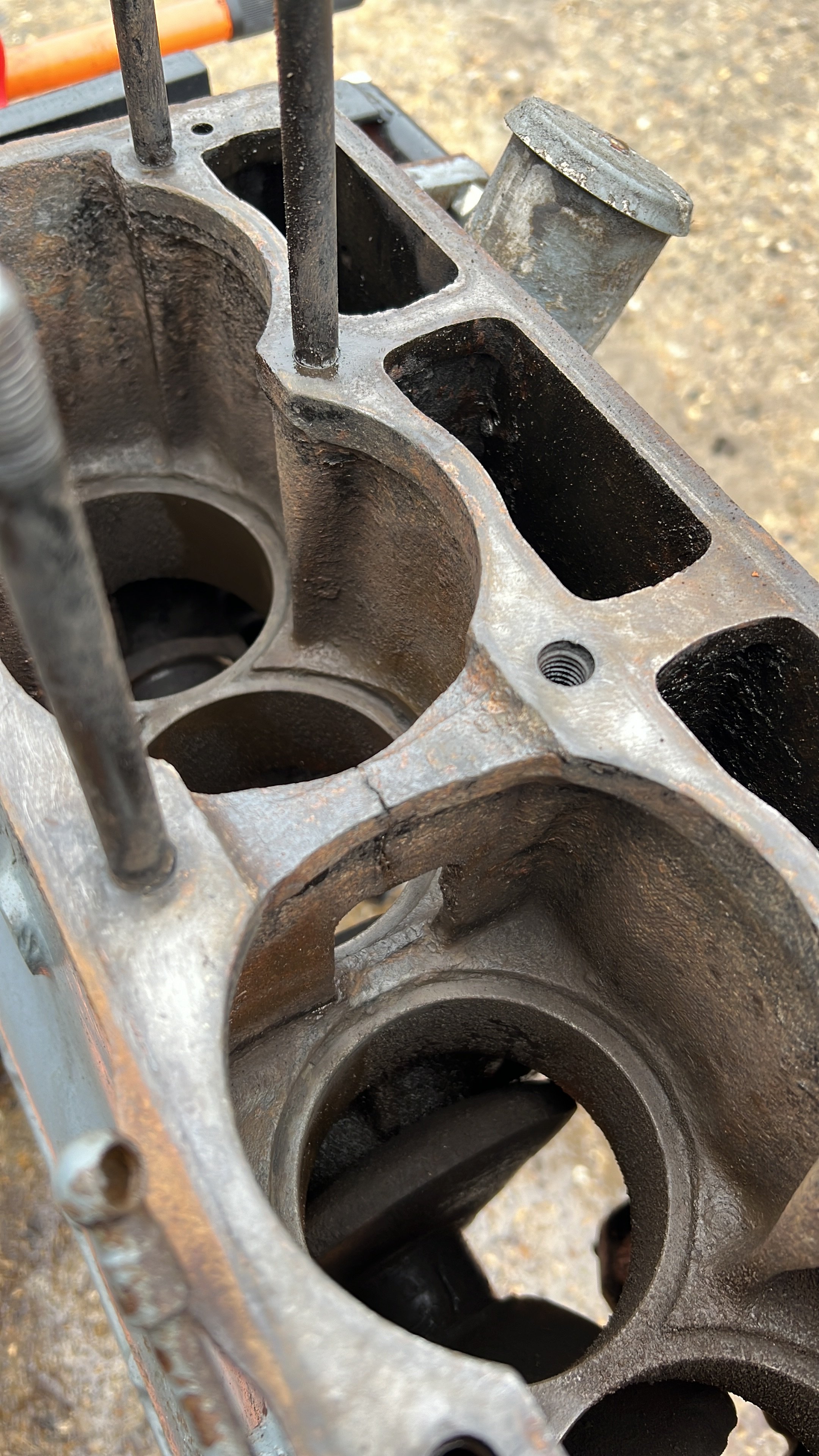

Hi all just after some advice on the rebuild I’m doing
I rescued the tractor from a hedge where it had stood for 20 years or more, managed to free up the engine and start it but soon discovered water in the oil. Decided to go ahead with a full rebuild as suspected the liner seals.
ive now got the engine out and on a stand to do the rebuild but discovered a crack in the water jacket between cylinders 2 and 3. I’m hoping this shouldn’t matter as it’s not A critical sealing face but would appreciate some advice!
On another note what is the best way to clean up the block face? I’m reluctant to use sandpaper ! I’ve now got the studs out and having the head itself skimmed by a local machine shop so just wanted to clean up the block face a bit better before putting back together
many thanks photos below 🙂

This is a comm problem with the TO30 blocks. If you can, you can drill and then tap for a bolt under the crack. Look up pinning block on this site. I have had a local machine shop do blocks for me.
Nylon brushes with a 1/4" shank are great for cleaning up metal surfaces without damage. Comes in a few different grits. I use them to clean the inside of aluminum rims when applying stick on wheel weights. I buy them in bulk at harbor freight along with 4" flapper disc for an angle grinder. Flapper disc are good for cleaning metal also. They are more aggressive and will remove metal. I use them for cleaning the bead seats on rusted corroded aluminum and steel wheels.
Tom, I thought that the cracks that the TO series engines got were on the bottom end near the main bearing journals. TP1997's photo of his TED20 is on the upper end just under the head. I don't know, but it looks like that might not be a big deal.
The cracks can happen at top and bottom webs. I had a Massey Ferguson dealer about 45 minutes from me and the shop guy was very good at drilling, tapping and bolting across the cracks. Haven’t had a block worked on for over ten years now. Hope one of the younger guys got trained and keep these old girls going.
Tom
Thanks all , not worth getting too worried about it by the sounds of things!
