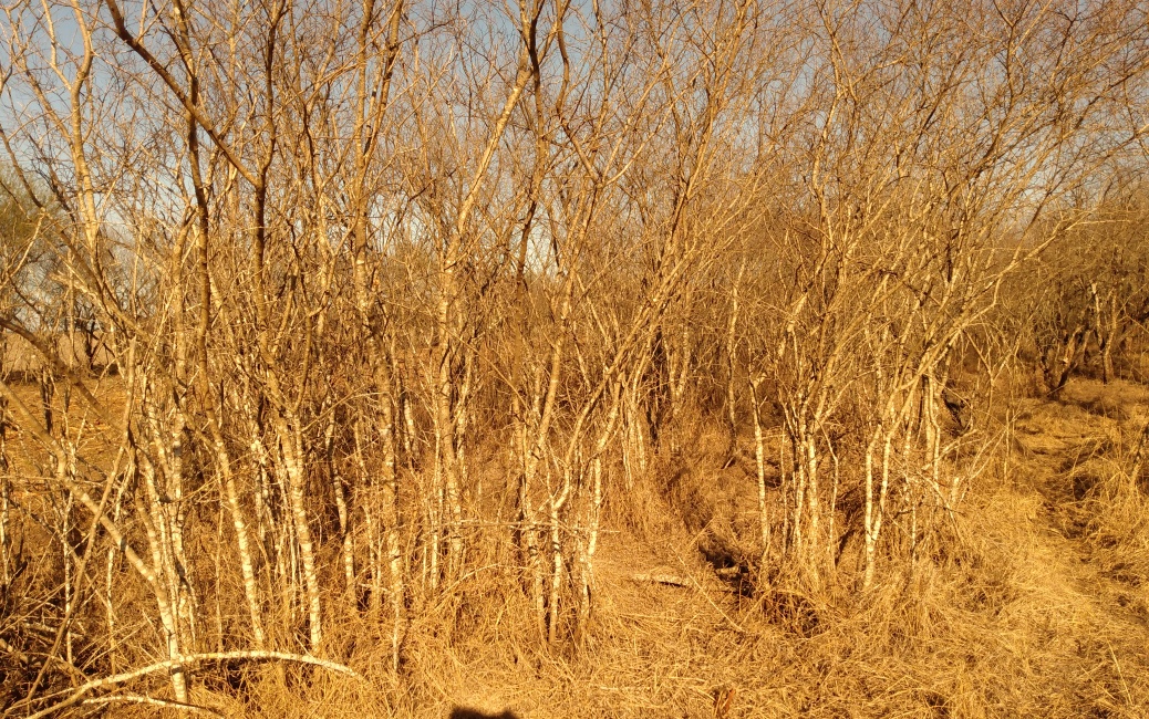

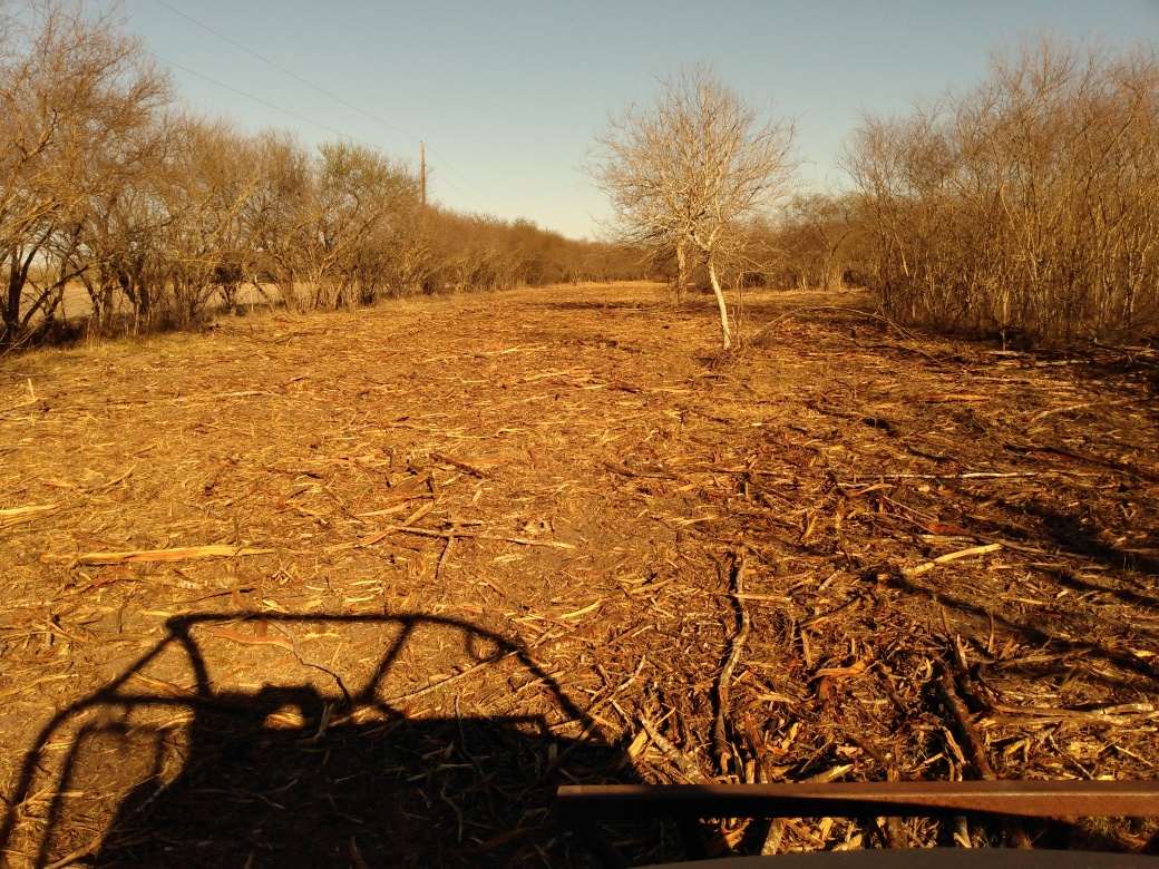

On this bat wing they are actually long gone as is the deck, I just strap some old car hoods to it as it is my "beater" cutter and a mean beater
I pull it with an 1950 Oliver making around 115HP at the PTO.
I have a couple nice bat wings I use after clearing the brush using an 1850 Oliver.
I bought a real heavy duty 7' cutter but the bat wing seems to work much better because the massive amount of rotating mass does not "shock" the PTO on the tractor as much.
