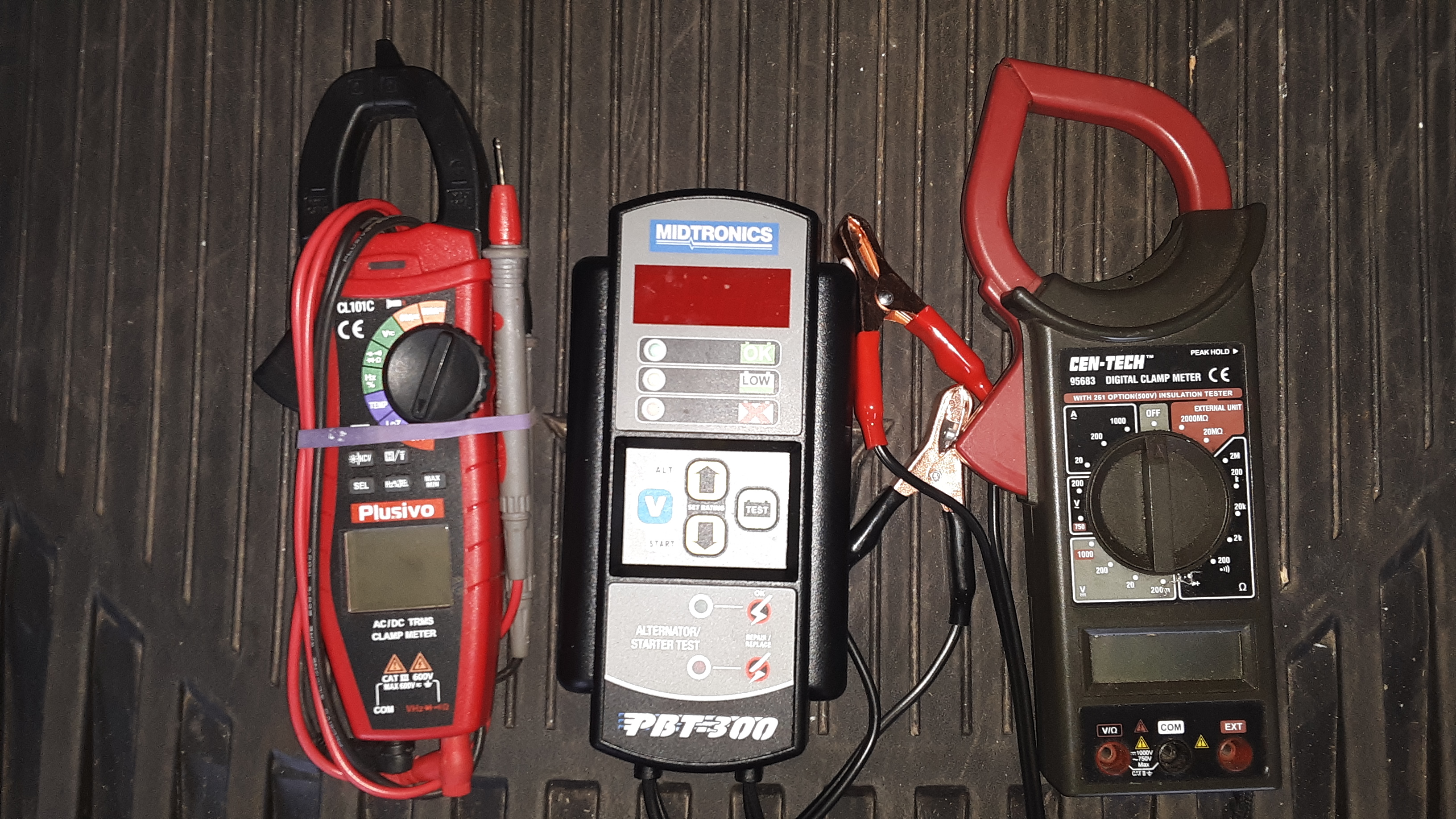

You know I'm cheap, This meter is under $40.
No way I'll spend big bucks on a 4 wire ohmmeter.
The average guy on YT may use an ohmmeter to measure a ballast resistor.
Think about this, is the accuracy of the meter that critical when shopping for a ballast resistor?
I say NO, because all you need to know is the ballast resistor has the same resistance as the coil?
Lets say your meter is off my one ohm. Your meter says your coil resistance is 5 ohms when it's 4 ohms.
Does it matter? NO. As long as your new ballast shows 5 ohms the same as your coil.
Bottom line, How important is the accuracy of any ohmmeter when working on a 75 year old tractor?

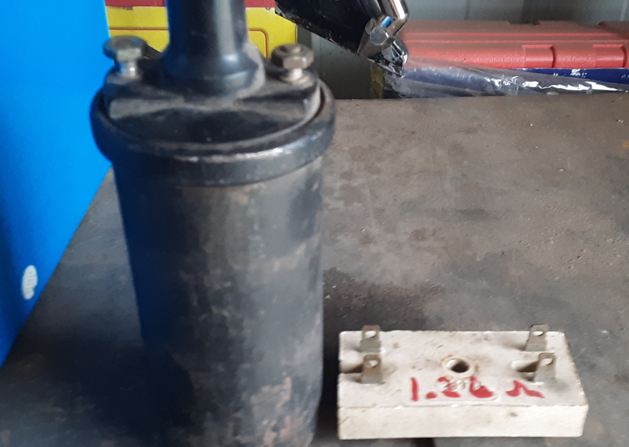

I do measure the current, I shoot for 4 amps.
More important is the voltage used by the ballast needs to be equal to the voltage used by the coil, 6 volts.
I wanted to have a spare 6v coil and ballast for my boy. He wants my old Jubilee.
I couldn't buy a ballast to match the old coil.
I found an old ballast I used on my 78 aspen station wagon. 1.26 ohms was perfect.
I found an old ballast I used on my 78 aspen station wagon. 1.26 ohms was perfect.View attachment 5427
"More important is the voltage used by the ballast needs to be equal to the voltage used by the coil, 6 volts." I can absolutely guarantee you that the Ford 8N ballast & coil voltages are not equal...... One size does not fit all.
