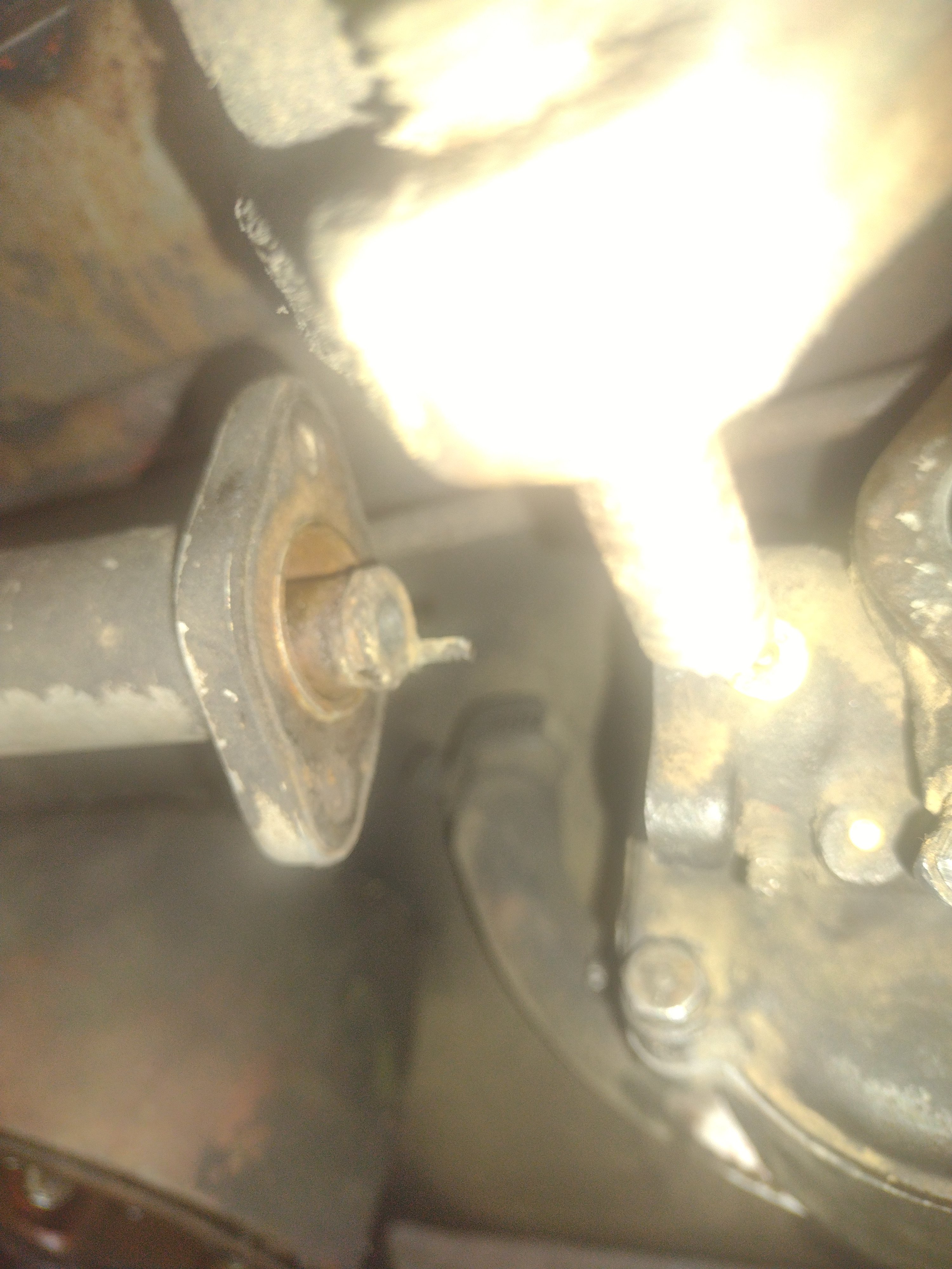

But the governor don't work . It a rocket governor why is the tab going in the carb so small ?
Pull the governor cover off and have a look in there. Sometimes throttle that shaft break where it enters the housing. That bit of west will still make the governor work.
It's a good sized horse shoe . The people were going to move it and it must have been a chunk of ice stuck on the bull gear and it popped . Been working on other things now . Throttle lever was all loose and the water pump schive is bad . behlen steering is loose and leaking bad .
