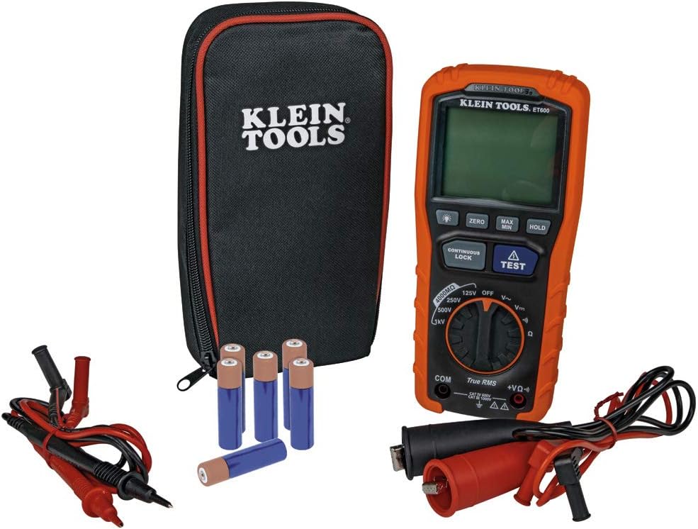

A megger is used to test whether there's an insulation breakdown between adjacent wires. It puts out huge current, compared to a regular ohm meter, often found in your multimeter. It's an ohm meter on steroids.

I trotted out, and bought a megger off of FleaBay.....................never knew they existed. I'd been bouncing around the internet, and discovered them.
You can test until the cows come home with a multimeter................and it will usually give you a "good" reading. They simply don't have enough power to isolate a fault.

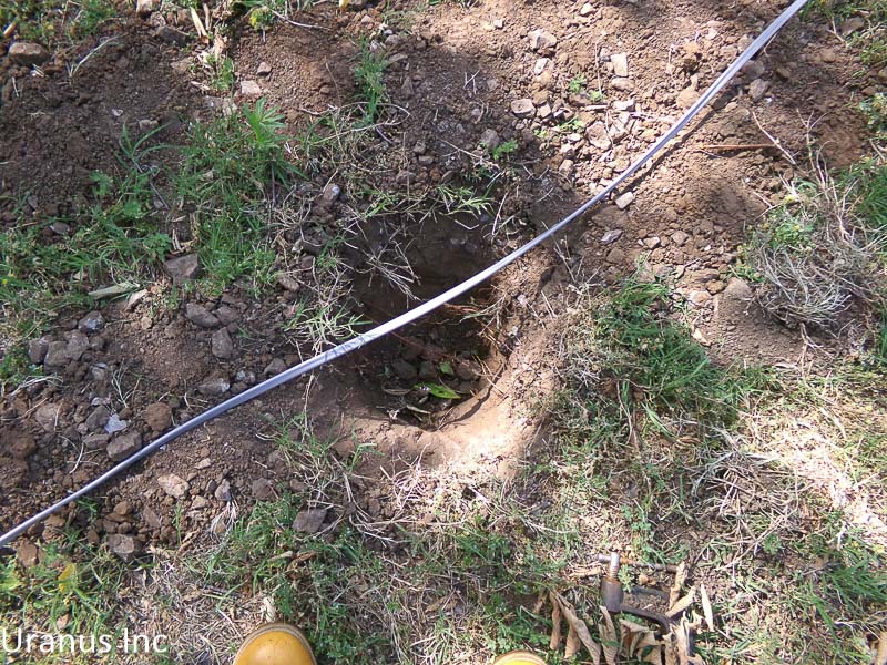

The wire was traced along its entire length................................................AND THE LINE WAS SPLIT INTO SECTIONS. Digging it up, and testing short runs. Small precise holes to reach the wire to cut it, and test it.
I found a section of UF that was bad. Not the precise location, but within a given section of the wire. That's all I need to know. I now know what section of wire has to be replaced.

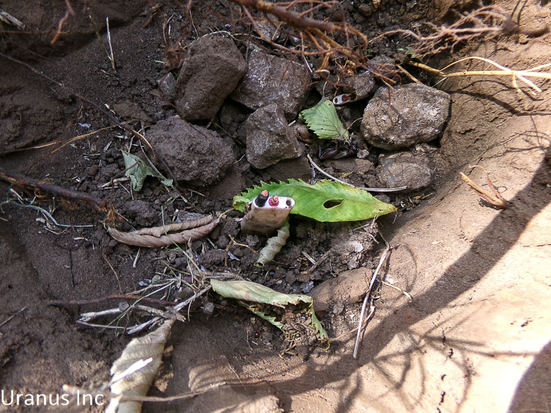

I selected these kind of splices, made for underground work.
I've since shrink sleeved them. They were only left without waterproofing for final testing. I hope they hold up well.
The splice locations are marked with steel plate anchored with a longish piece of round stock pushed into the ground. Sorta like a survey marker that shows boundaries. The flat plate allows me to mow over the markers without fear of messing the mower up. If things go wrong again, I can easily locate the splices for testing purposes.
