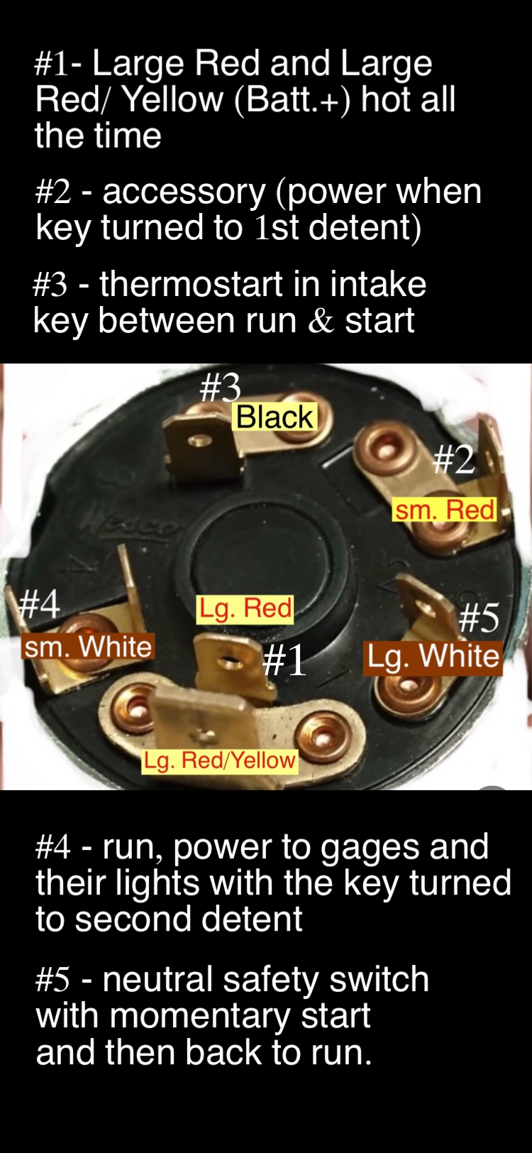

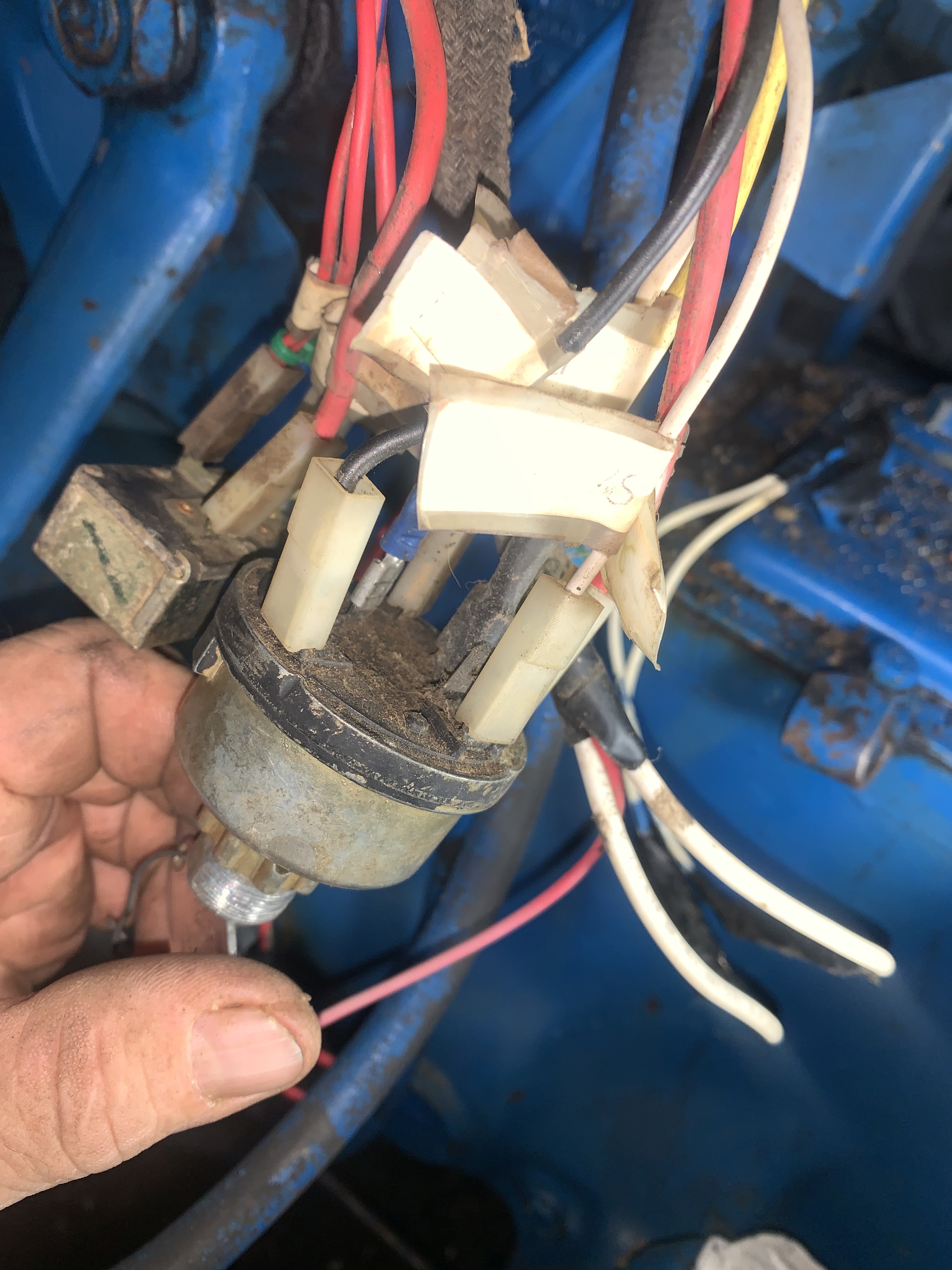

I spent the afternoon taking out the ignition switch, headlight switch, testing wires, and comparing my notes with my DVM to the web.
I used my photo app to modify a picture and now I need to verify the key position between run & start with a test light on
Terminal #3. (There is no counter clockwise from Stop) Once I’ve verified I plan to run a small LED indicator lamp next to the gauge panel so that I have a visual of when it’s activated.

Thanks for the expanded view with the safety switch and starter solenoid👍

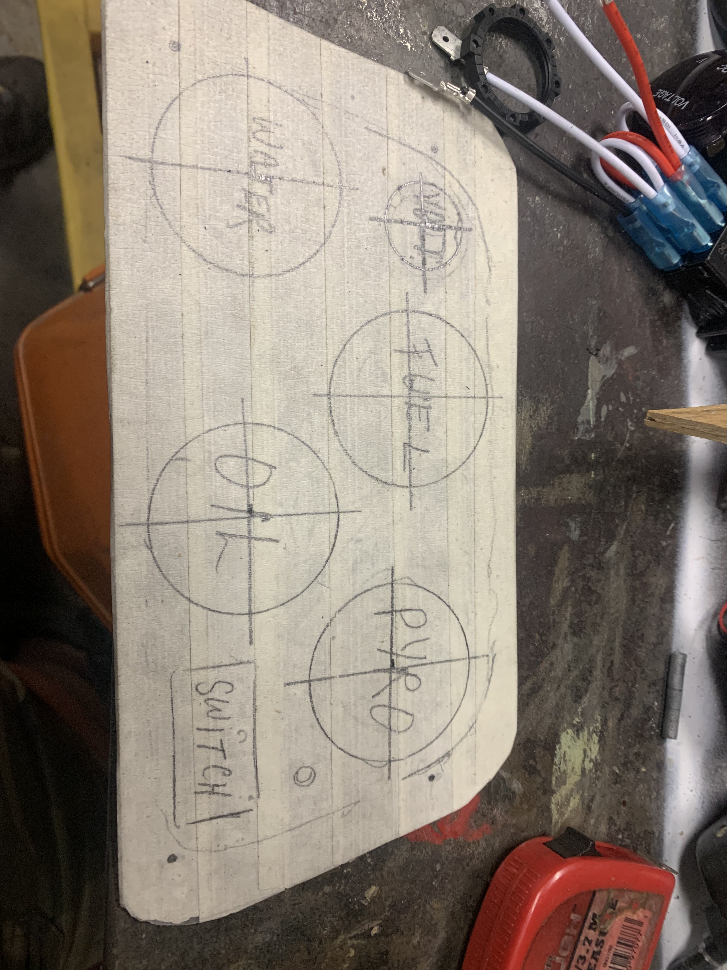

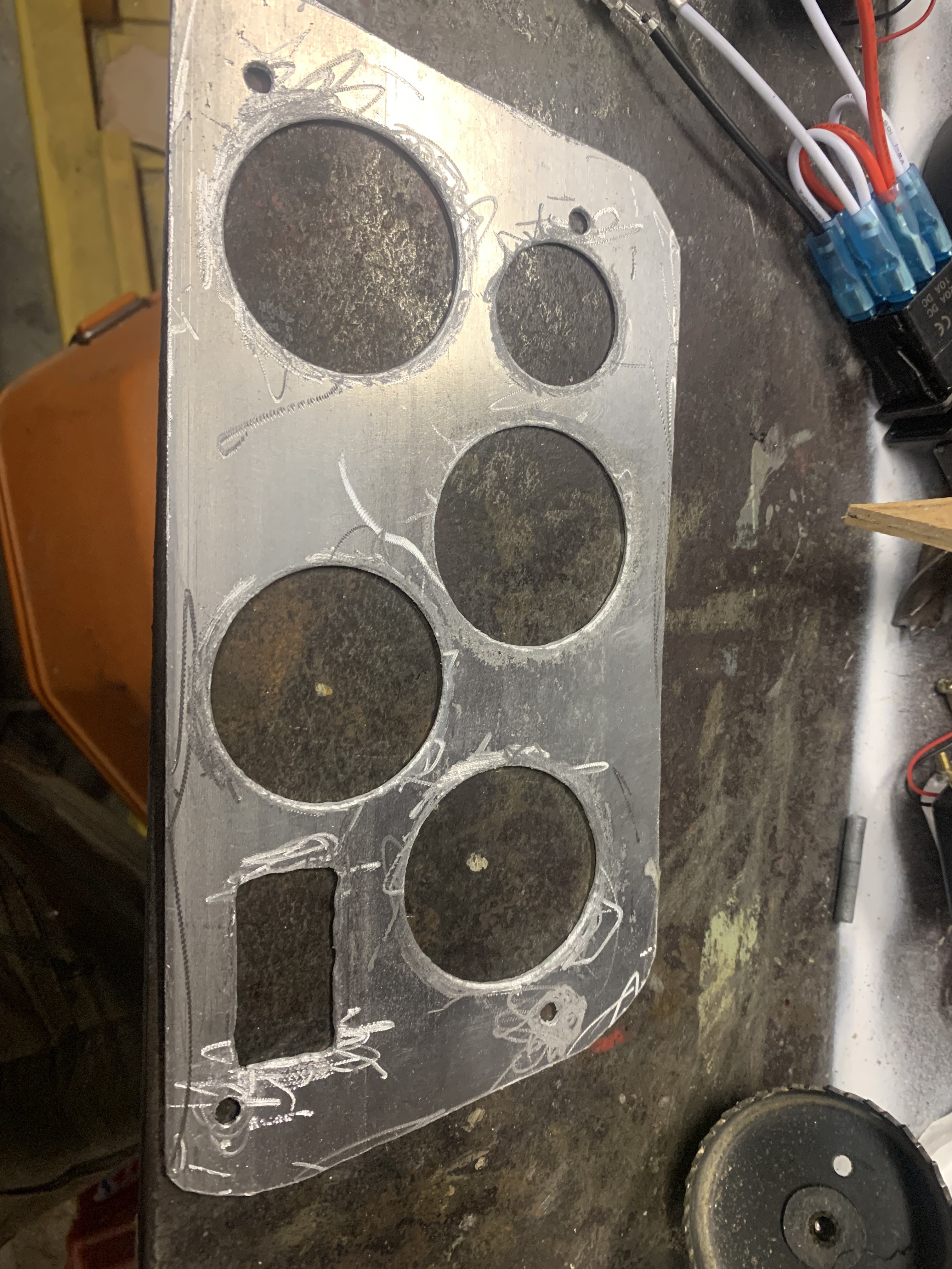

I’m replacing the original cluster with individual analog gauges (already replaced the generator with an alternator)
I know the cluster looks original but I dislike the (idiot) warning lights. I’d rather see feedback of real time.

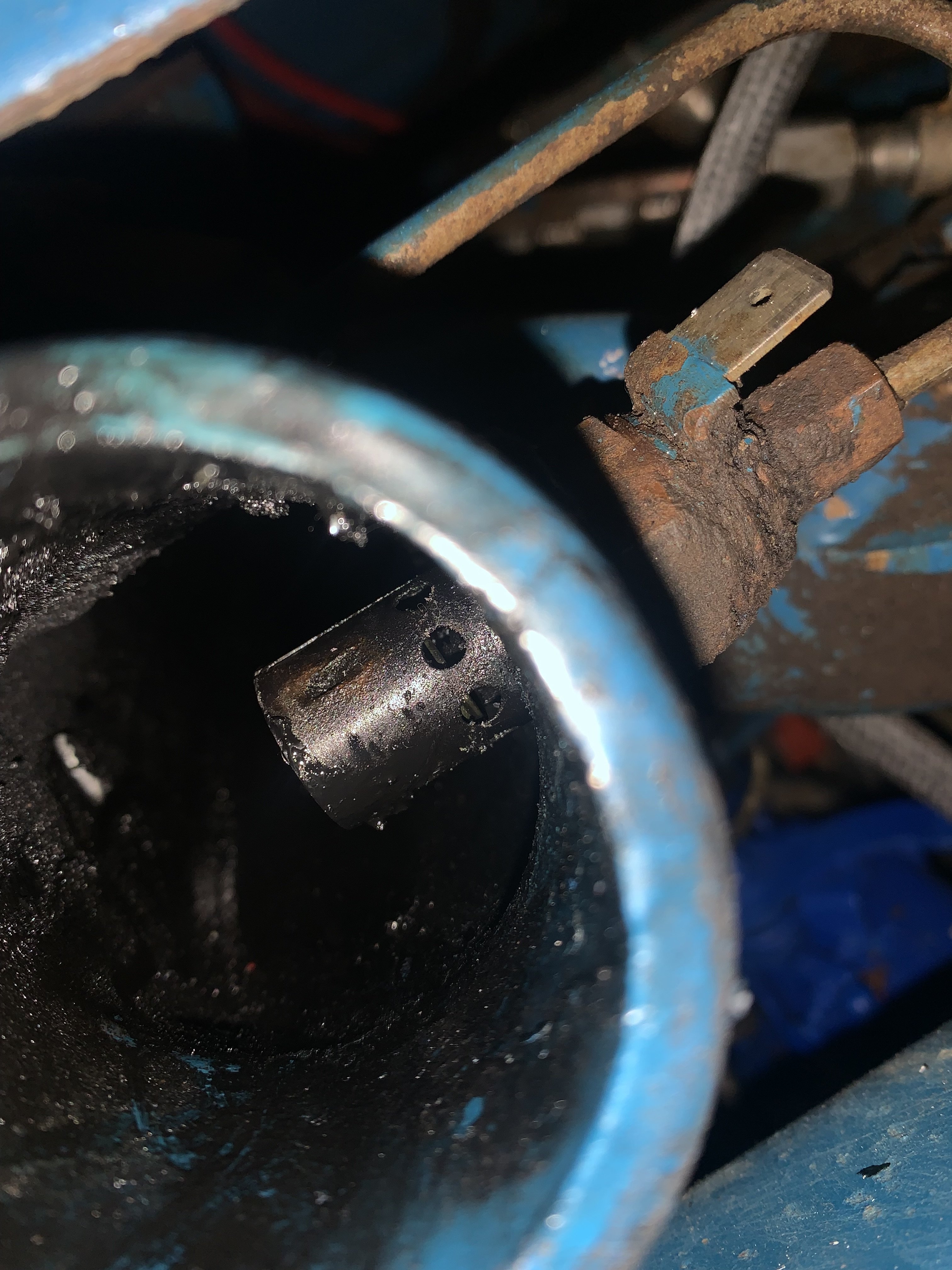

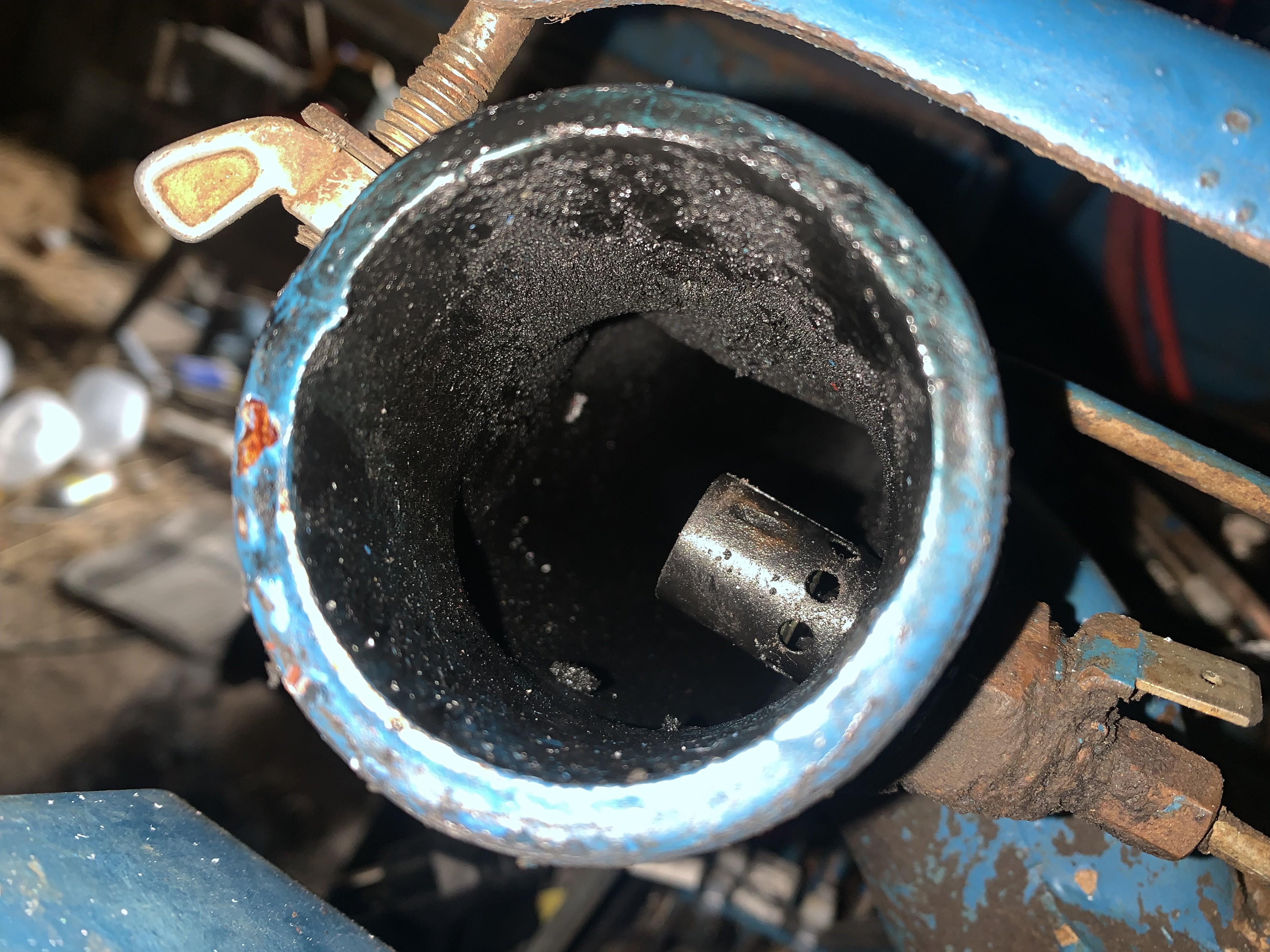

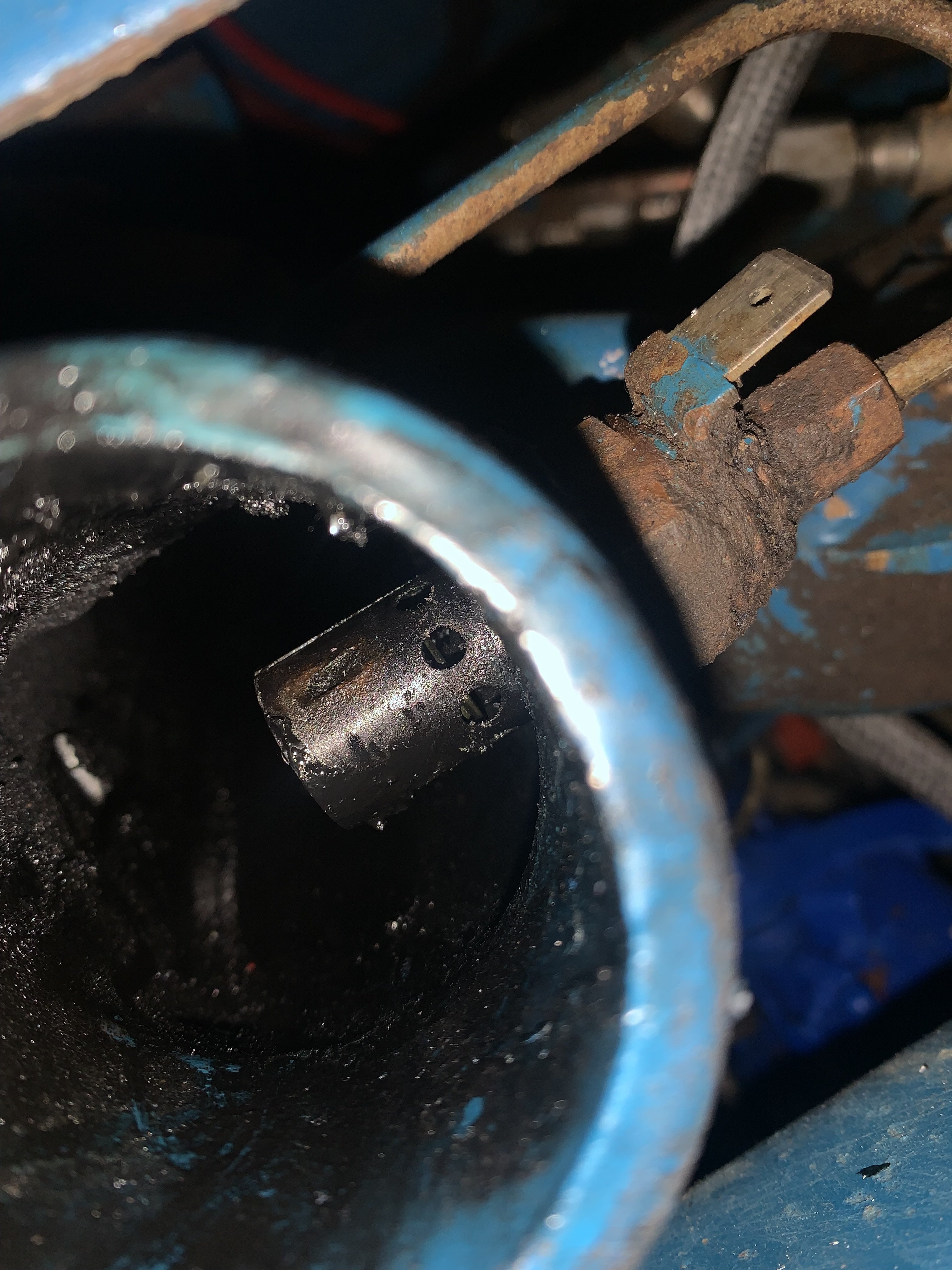

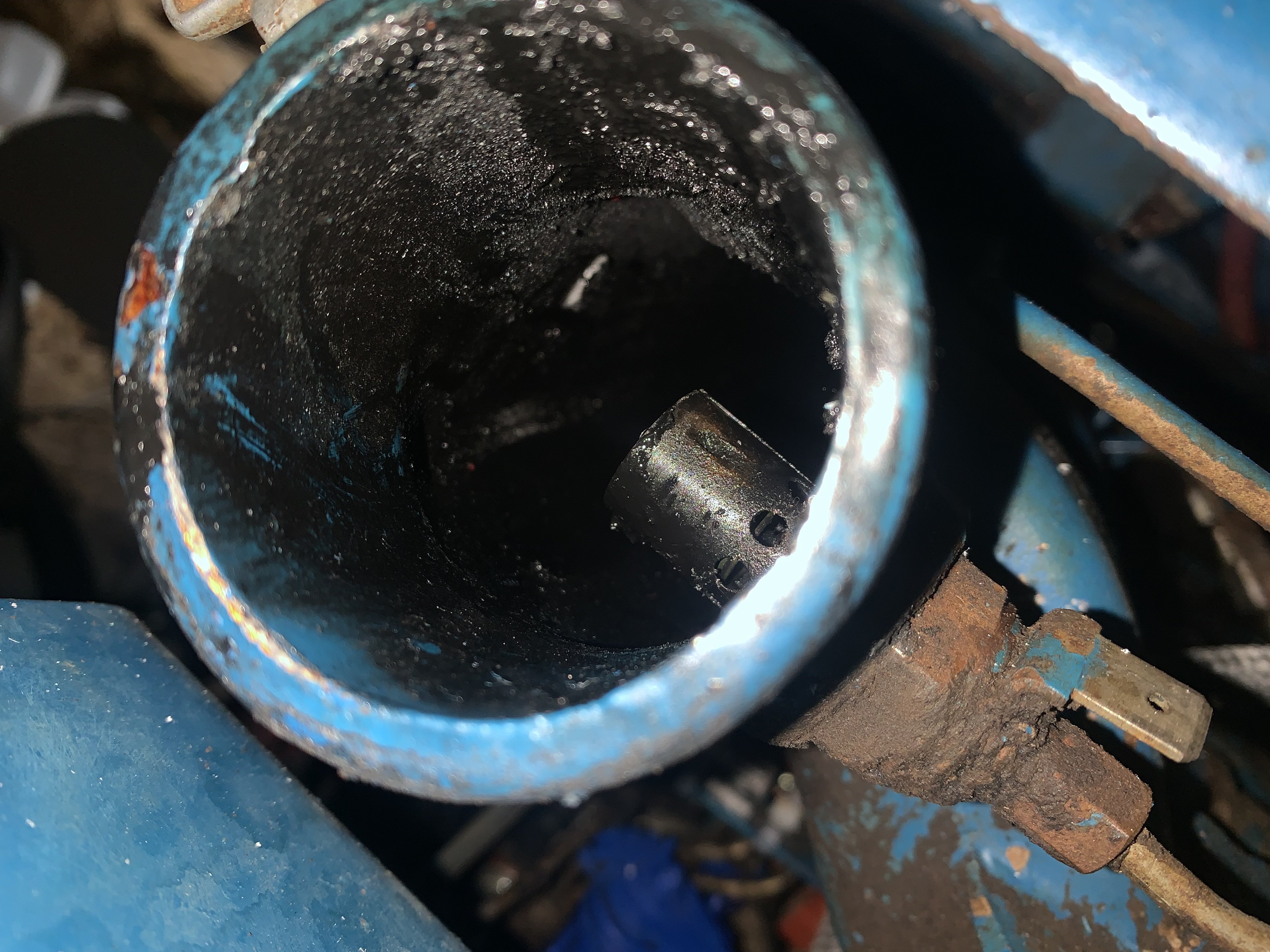

I looked into the throat of the intake and there’s a thick, dark, oily residue inside on the walls of the runner.
I wouldn’t want to get a fire started inside the intake from the fire thats generated by the thermostarts’ heat coil and diesel fuel operation.
The tractor doesn’t smoke at all after running a bit (other than a cold start) and has good power.
I know I need to clean the oil bath / filter ….. I have no idea when it was done last. I would definitely appreciate your thoughts about any danger of the putting the thermostart back in use after all these years.

In verifying my TS systems are working, I temporarily remove the intake manifold air inlet hose and look at the TS operation. When the coil gets hot enough and opens the fuel plug, the fuel that drops onto the orange (hot) coil ignite and drop down into the air inlet.....since the engine is rolling over, those "Great Balls of Fire" (Jerry Lee Lewis) are sucked into the combustion chamber and light off the diesel spray mist. Great sport.
Thanks for the reply. From what I’ve read it’s been recommended to hold the TS engaged for 30 seconds before cranking.

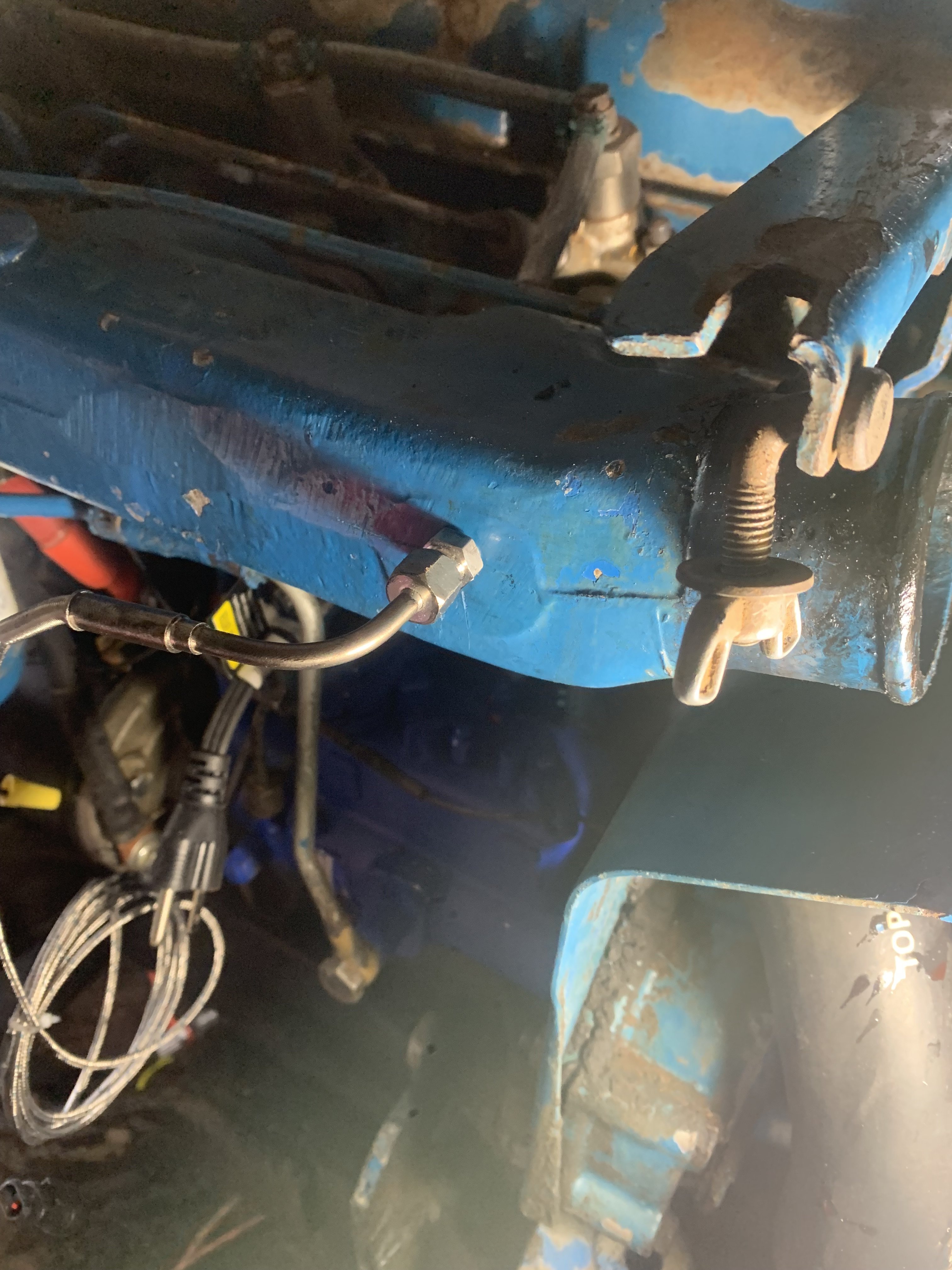

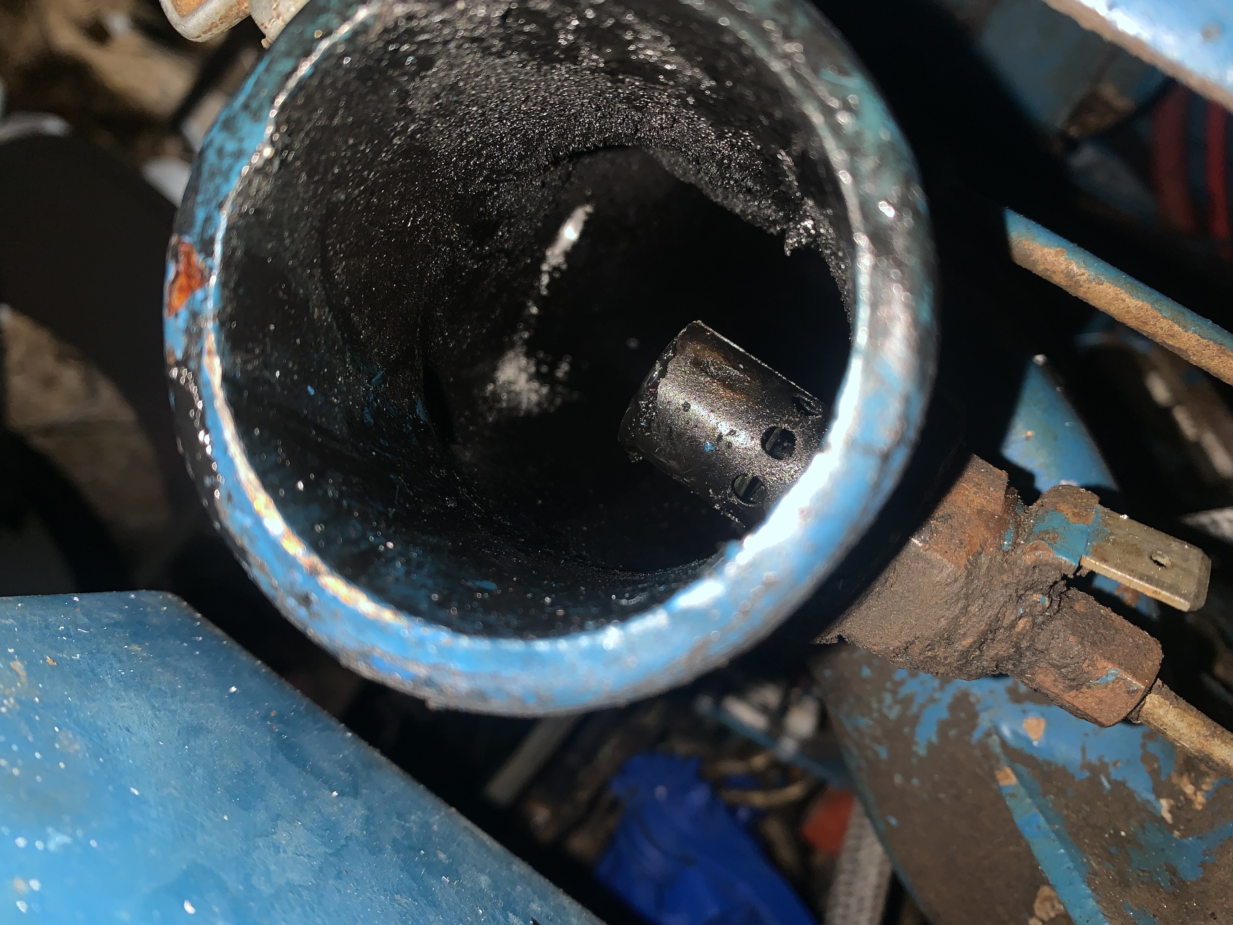

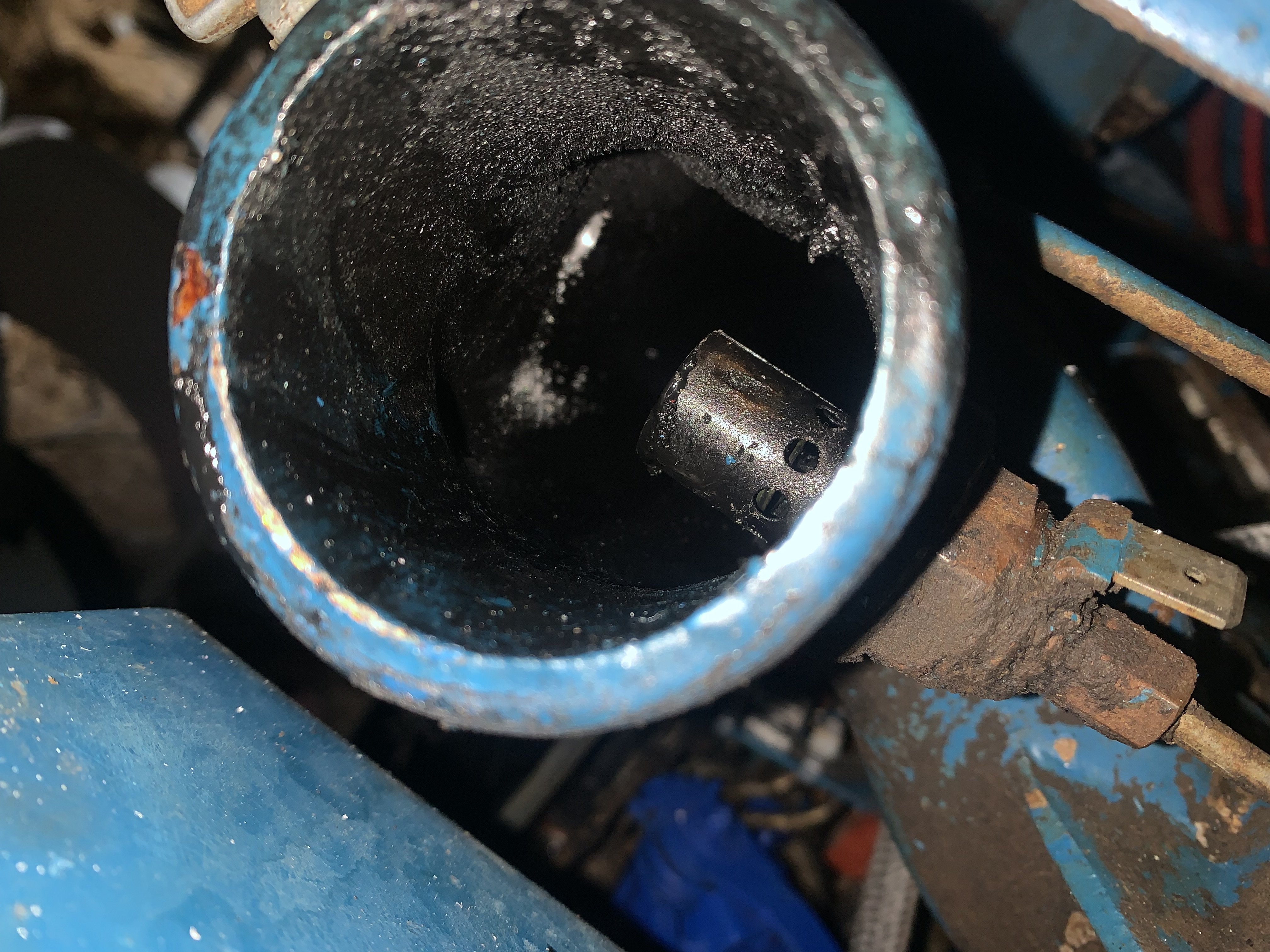

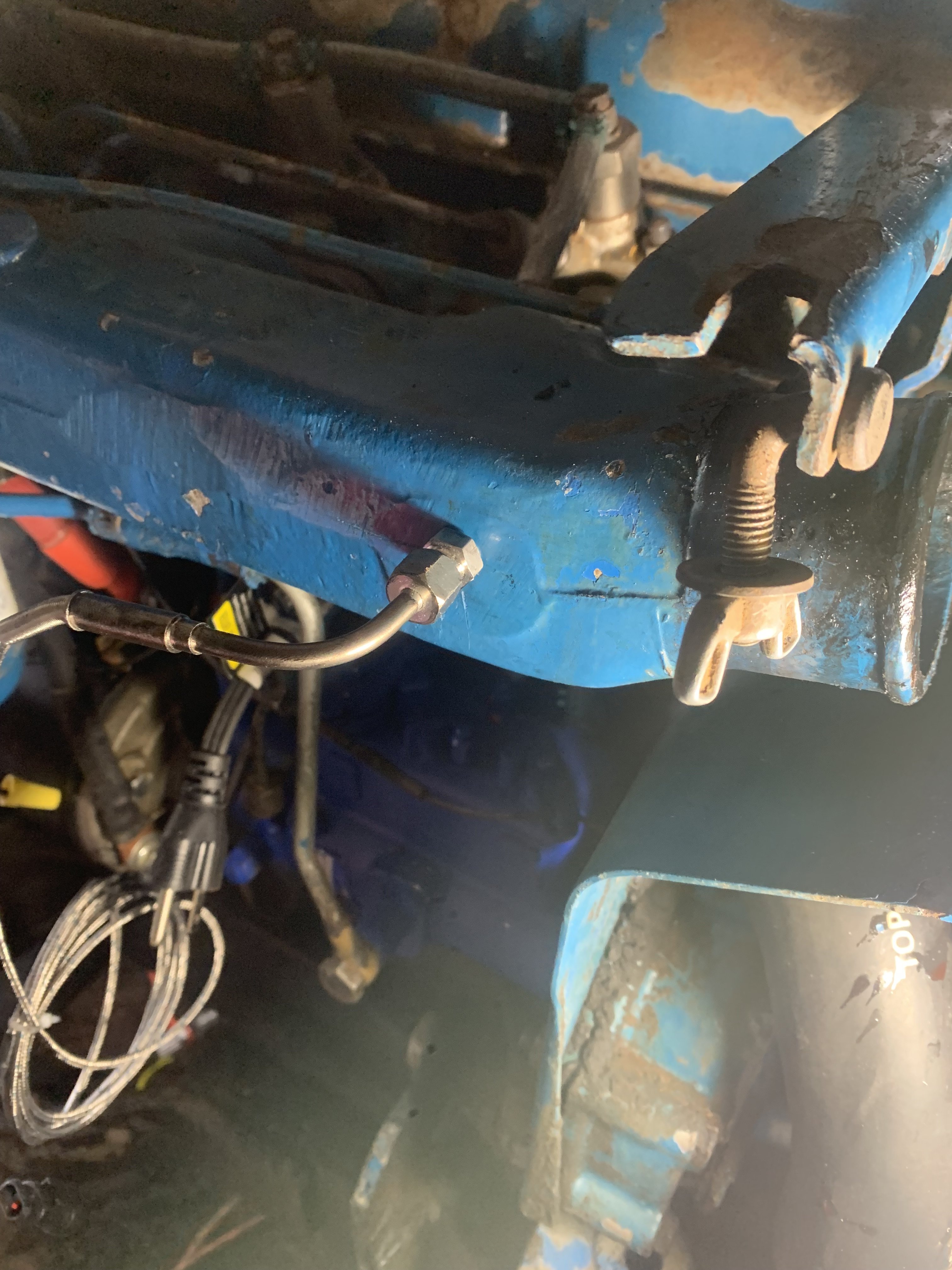

During that time (30seconds) is my concern. I drilled and tapped a 1/8” npt to install a temperature probe, in cleaning out the shavings with a small vacuum hose is when I discovered how oily (greasy) thr intake is. Here’s a picture that might better explain my concern.
After Dilling
After vacuuming shavings…..light shining through hole from troublelight.
If I decide the risk for fire is too great I will simply remove EGT probe and install a 1/8” npt plug.
I noticed the greasy mess when sliding the vacuum tubing in and removing. During a search I found several threads where an OP reported similar buildup and the consensus was for an older diesel with lots of hours, Thats it wasn’t uncommon.
Just not sure about starting a fire inside🫤
After Dilling
If you are concerned about it you could wash/brush/clean all the gunk out of it.
Pretty simple job to pull the manifold on a diesel and have at it. I think you could leave the filter and all the fuel lines just hang there.
Not like a 3 cylinder gasser anyway where you'd have to drain the radiator down and mess with carb, throttle linkages and fuel lines.
You might even gain half a horsepower by eliminating the crud and making it a smoother airflow into the engine.
My ears are no good…… thr past 35 years working in a casting foundry. I want to be able to see temps rising on the gauge when TS is activated. I also plan to activate it through a momentary switch and relay. I checked the ignition switch with a DVM and find that the halfway position is very clumsy.
With the momentary switch the TS can never accidentally be left on. While the probe will not be exposed to no where near the heat of an exhaust manifold (like I have on my 7.3 PSD) it shouldn’t have a problem showing temp increase on the intake, and it will be interesting to see the varied temps of different time interval durations and first time starts at different ambient temps.
At least thats the plan…….and Im working on the new gauge display (no warning lights) , all live gauges, and managed to make it all fit:
