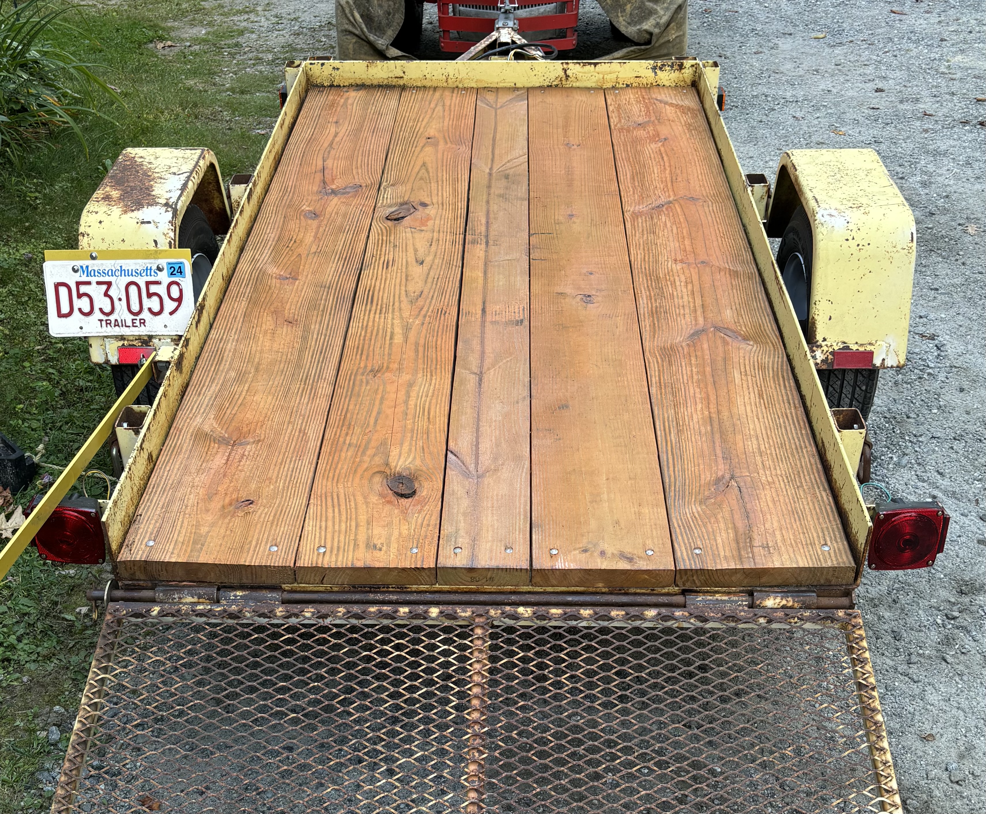

I used a roller to apply it in on our small utility trailer when I rebuilt the deck this past summer after the pressure treated wood dried out.
