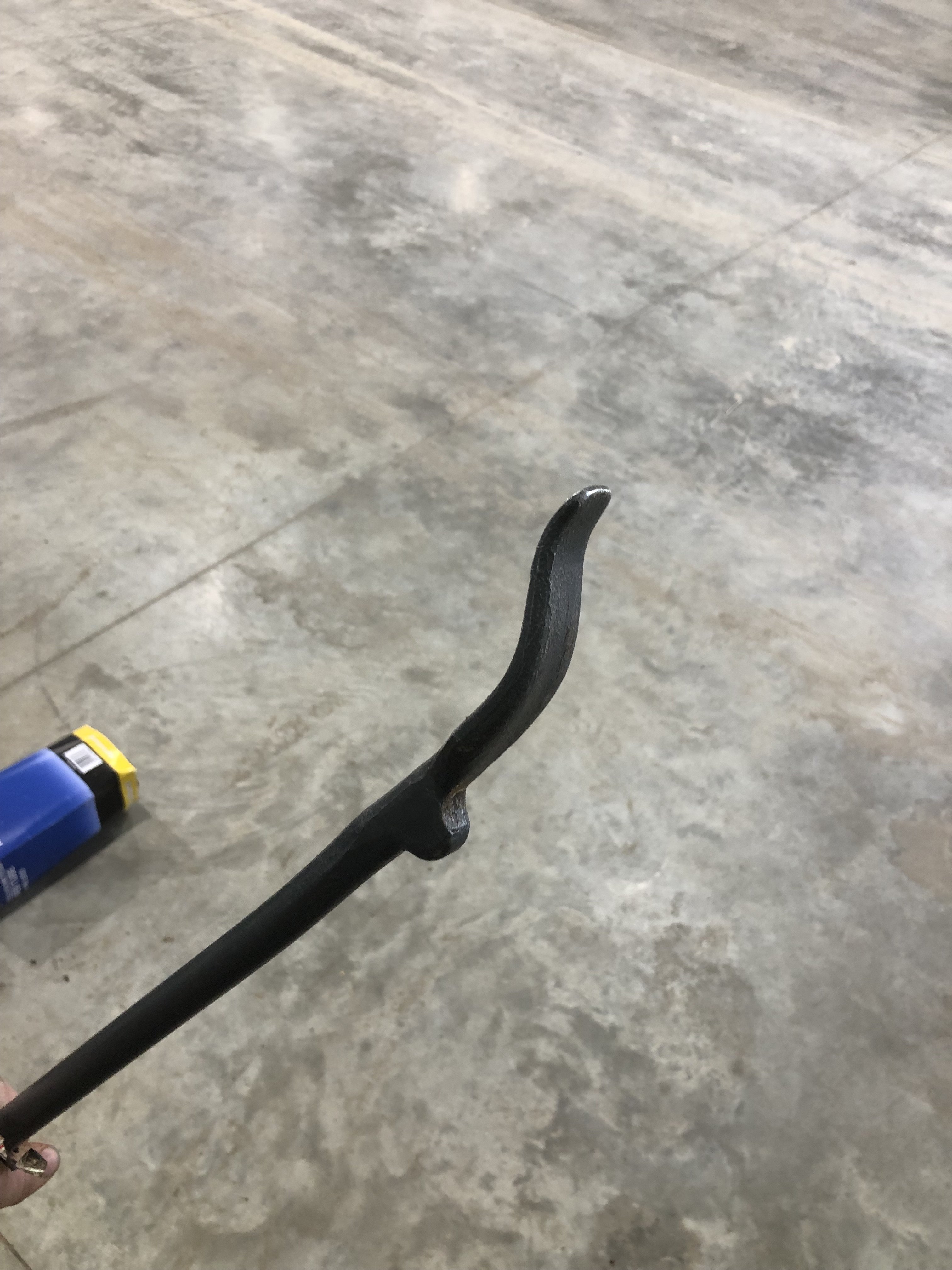

Same here I never lay one of the big ones flat stick them in and let the bump on the backside hold them about like the rim clamp does when putting them on. It takes a bit of juggling before you start but once you get the first over it will hold itself most times then just go around flipping the rest down. It does look like dad did spring for KEN tools (I was a bit quick to judge the tool quality based on previous occurrences) which would explain why we have good luck i haven’t ever wanted to put a bar on one.

Fixing look up 33239 ken tool part they don't have that nub on the backside like you show. My other bar like that does but not the spoons.
34645 I believe is the big one with the nub they are 65 a piece on amazon
they aren't a spoon at least I wouldn't call them that I honestly use them much more than the shorter spoons for big tires. it seems like if I need one of those the two little ones on the tire machine suffice to sneak in somewhere.
