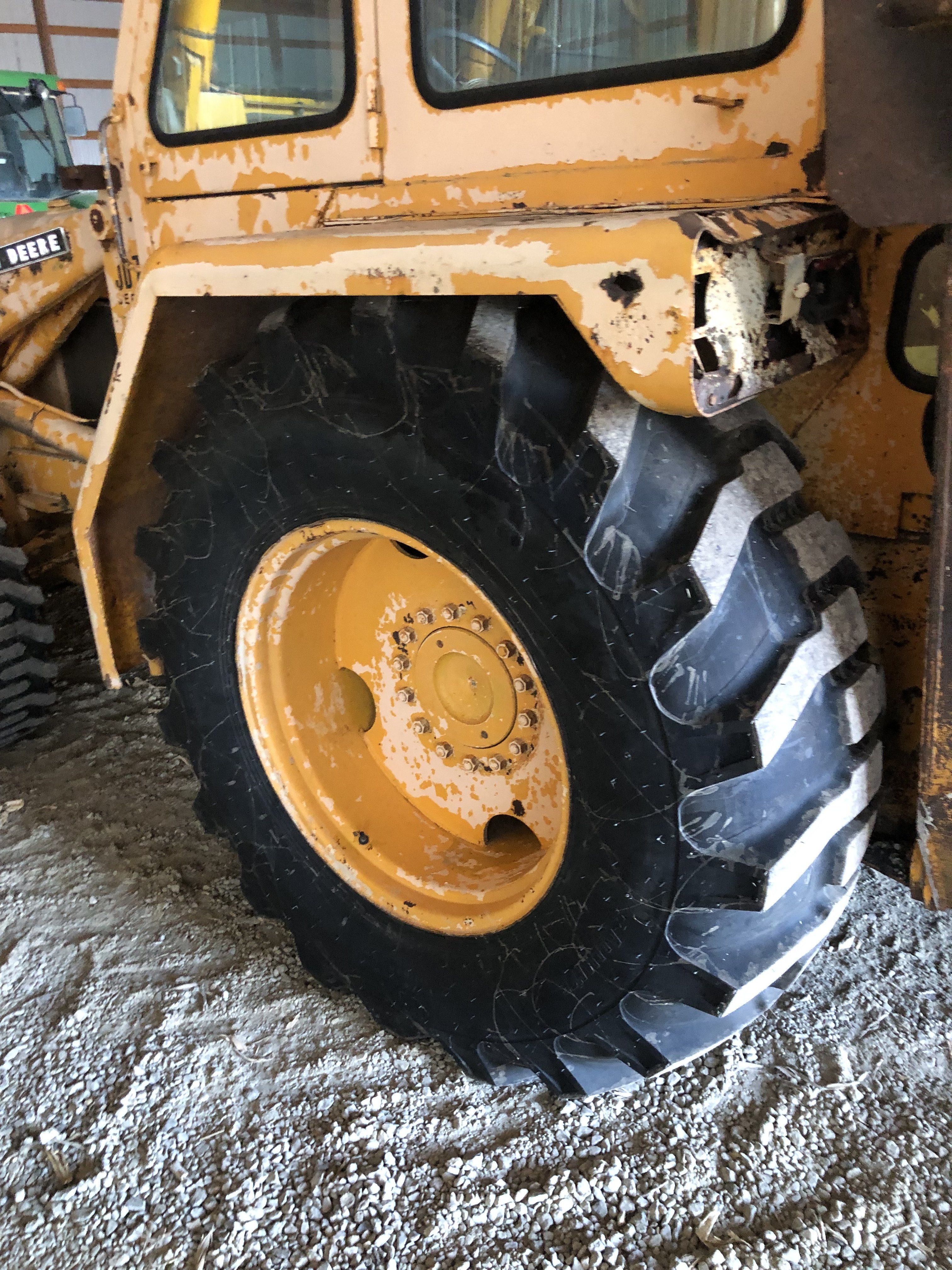

A tire distributor says i can't have R-1s on backhoe rears because of the weight. I currently have Chinese wing-wongs on the rear of my 655A which are breaking up the casing around the bars and cords are coming out, so it would seem the tire guy was accurate. However, in '86 it came from Ford with R-1 Armstrongs , and we ran those down to the inner tubes without incident.
Not crazy about R-4s, would like R-1s again and am willing to pay full price if I can get away without damage. Need more plies or what? Thanks Fritz
Your tire distributor doesn't know what he's talking about. You can run 8 ply-s if you want but you'll be a lot happier with 10-s. I'd go for a R1 pattern with more lug in the center (BKT & Firestone). Mimics the R4, gives you a R1, and won't wear out as fast as the traditional R1 (Titan).

One of the positive points of my 655A is the ability to put "farm" tires on it. Good year R-1 with kind of a European style heavy center lug have been on it for years. I think they're 8 ply. I keep them well inflated. That's a lot of the key to keep sidewalls from giving out. They're starting to show their age. I seldom wear tires out on anything, they die of old age! So many TLB's have a special size tire which precludes using a farm tire. My TLB is a farm machine, it needs farm tires.
Not sure what you are looking for as far as size goes, but look at going with forestry tires, I don't think you can get as much weight on your backhoe as they would see on a skidder
R1 and R4 is the tread pattern and has nothing to do with how heavy the tire is. The ply rating is what dictates how heavy the tire is.
Although I have seen the treads rip on something like R2 when they are loaded heavy and get a big bite.
Backhoe in use puts the weight on the stabilizer legs. I understand there is a bit of wear and tear but mostly the rear tires are sitting around doing nothing on a backhoe.
Extra weight is from transporting while the backhoe is hanging off the back as dead weight. Which is like any loader tractor in the world with a rear weight to counterbalance the loader - all on regular ag tires.
So if ag tires fit on your rim, I can’t see why there is any issue. You want the right ply and quality to fit the workload.
