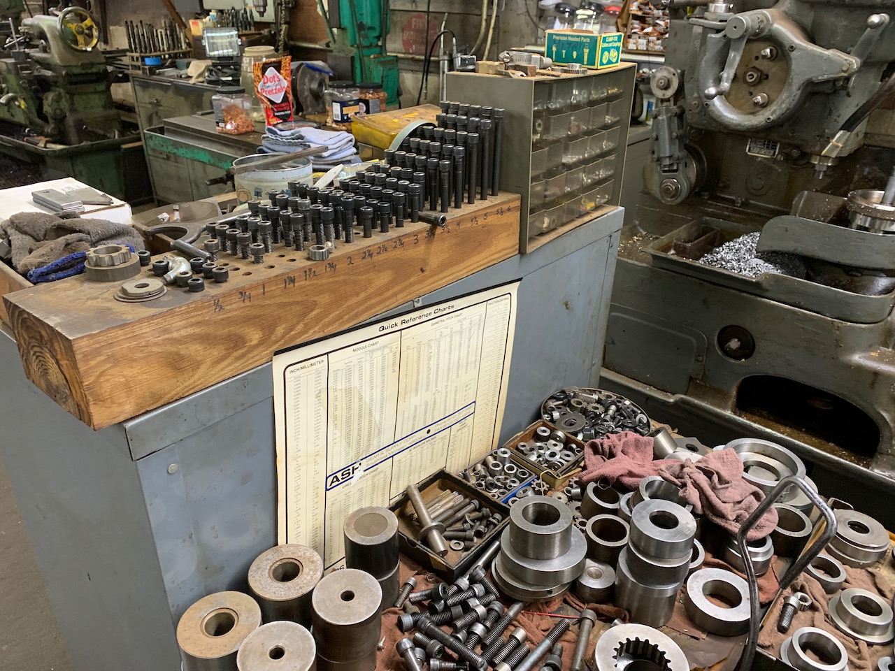

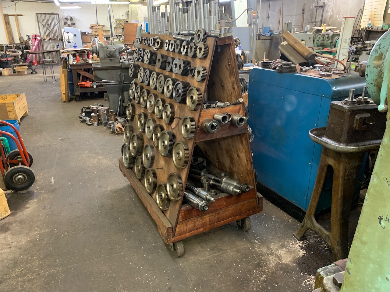

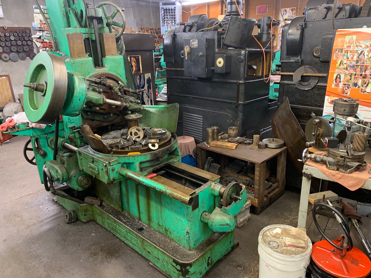

They are not available. Depending on how bad you need one, I have a source which will custom manufacture over/undersized gears. I spent a few months overhauling a Z134, basically the same engine, and the block was stamped for .002 oversized. I searched and found no old stock gears anywhere. I got ahold of the original microfiche engineering drawings for the gears and found a firm in northern Indiana which will make gears to order. In the end, after boring the block and installing cam bushings, tolerances were close enough with standard gears that I didn't spend the money on a custom machined unit.
You will want to be careful with your line bored block, there are stories here and in the Ferguson Furrows magazine of tight gears and broken camshafts.
