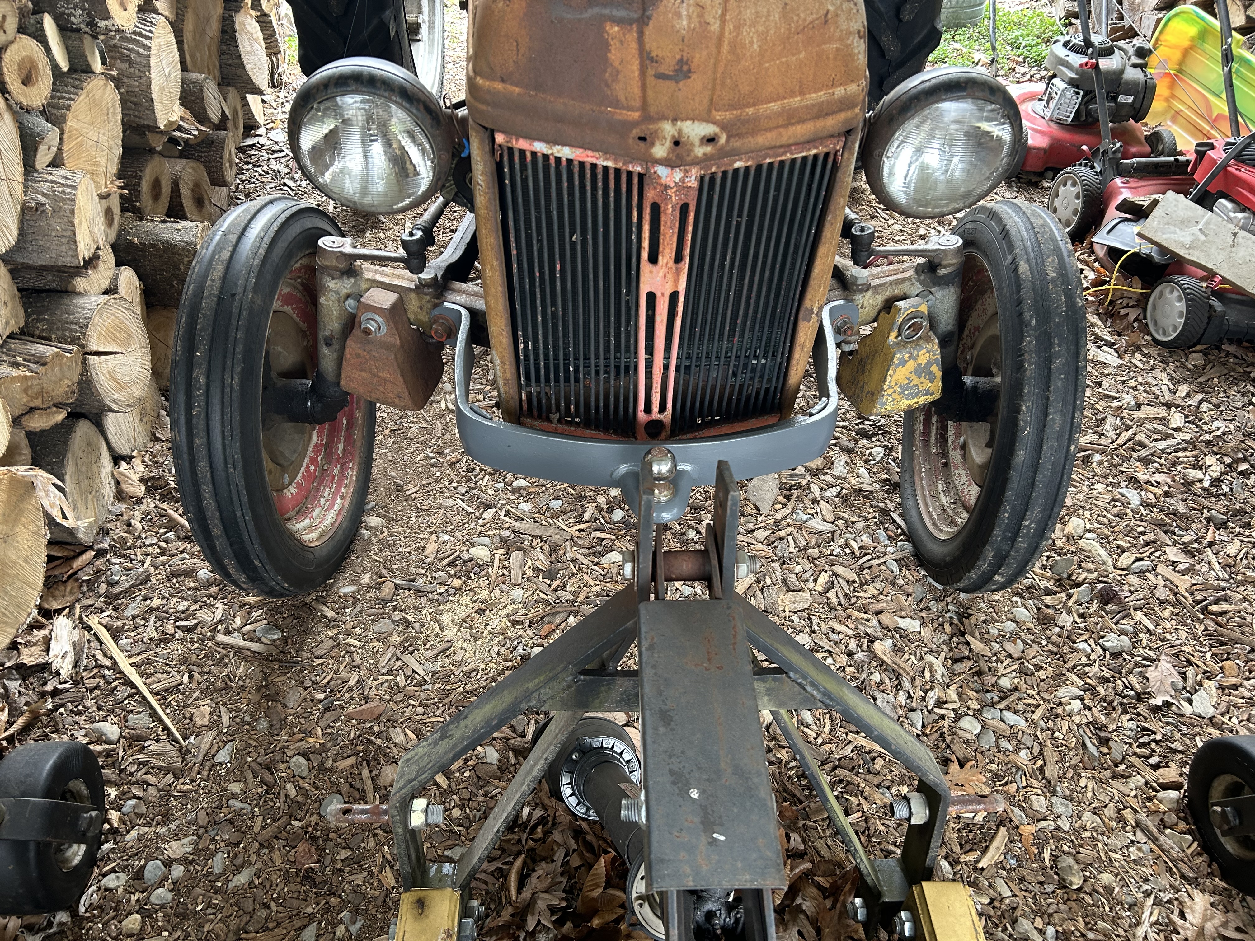

Guys ... Do I have "aftermarket" front wheels on my TO30. I need a set of wheel weights, and clearly the 4 bolt option will not work here. Is there an alternative ?

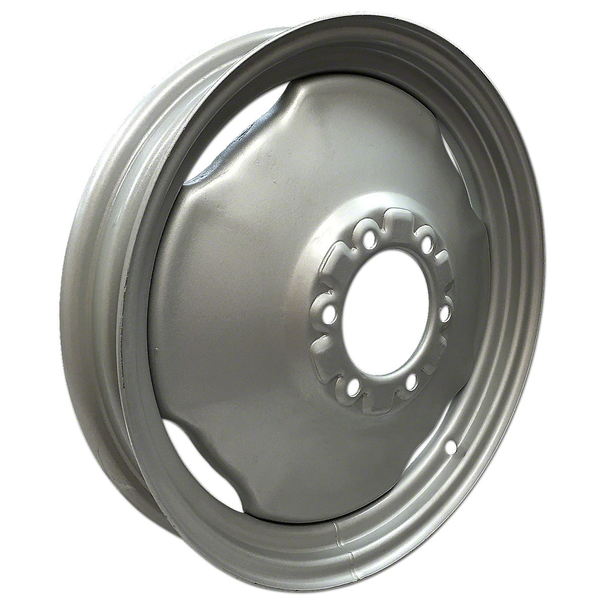

UPDATE: Just found that wheel on Steiner's site. Specifically says "not for wheel weights". So other than replacing both wheels & tires, any suggestions ?

What type/kind of wheel weights are looking to install? Mine are held on by 2 bolts, appears to have been drilled into the rim. Not sure if the holes in the rim are pre-drilled, came that way with the rim or someone just drilled the rim.
Another option is to find a couple of pie weight segments and bolt or pin to front axle. This would add about 90 lbs or so
Thing is that puts more stress on axle, spindles and bearings. Most likely that's not a problem. Wheel weights only add stress to the tires.
