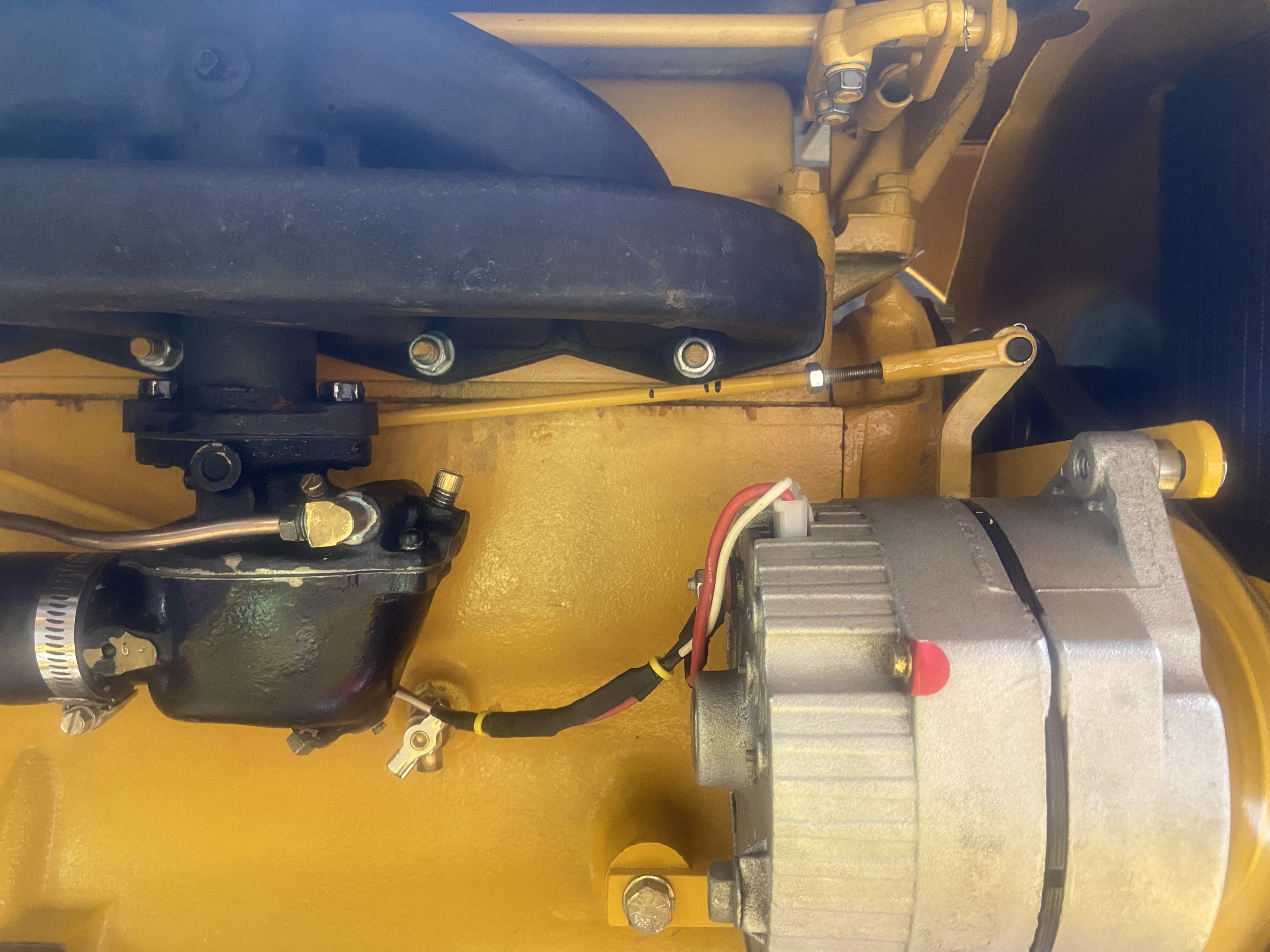

this is where i have to adjust to with my linkage carb to governor to get any governor action otherwise it revs to the moon like i mentioned i’ve been messing with the linkage, carb etc… but have the governor adjustment and carb back to proper settings, but this was the first time i got the governor to do something with haven’t adjusted it this far out before seems like a random spot to me. that’s why i was thinking internally something got bent or isn’t to “spec” maybe the tabs on the governor linkage? im going to try adjusting this a bit more then hook the throttle back up i did make a coupler to put on if needed but i think i’m gonna be okay without it.
If you have this fully assembled, your are missing some linkage. You need all the vertical linkage and spring.

oh i know i was throttling it manually for initial adjustments, as mentioned that will be hooked up now that i’ve got this where i believe it needs to be to actually govern.
