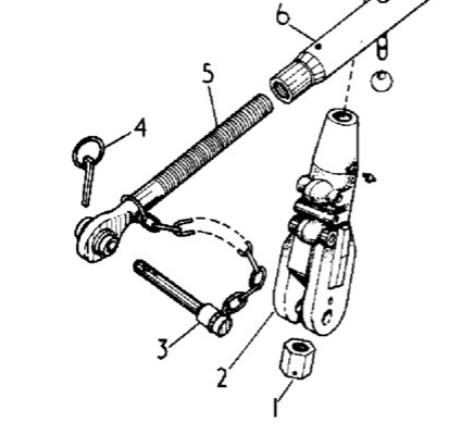

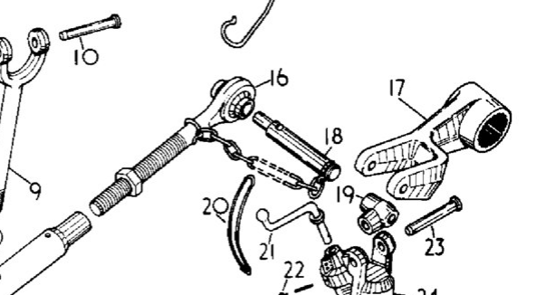

What the heck kind of pin do i need for this stupid thing ??
Cat 1 fits left side but cat 2 is to big for the right side.
Is it an IH specific pin?
Yes, there are actually two pins, one is for Cat 1 ball end and the other for Cat 2 ball end.
Both pins are Cat 1 on one end and Cat 2 on the other, the difference being how long the smaller Cat I diameter section is.
I have both for my 495.
Photos below:
#3 - 528081R1 PIN; PIN ASSY, upper link cat I - If using Cat II implement this pin and end of top link go on top link hole on rear of tractor
#18 - 528084R1 - HITCH PIN; PIN ASSY, upper link cat II - If using Cat I implement this pin and end of top link go on top link hole on rear of tractor.
Google the p/n's for local source
