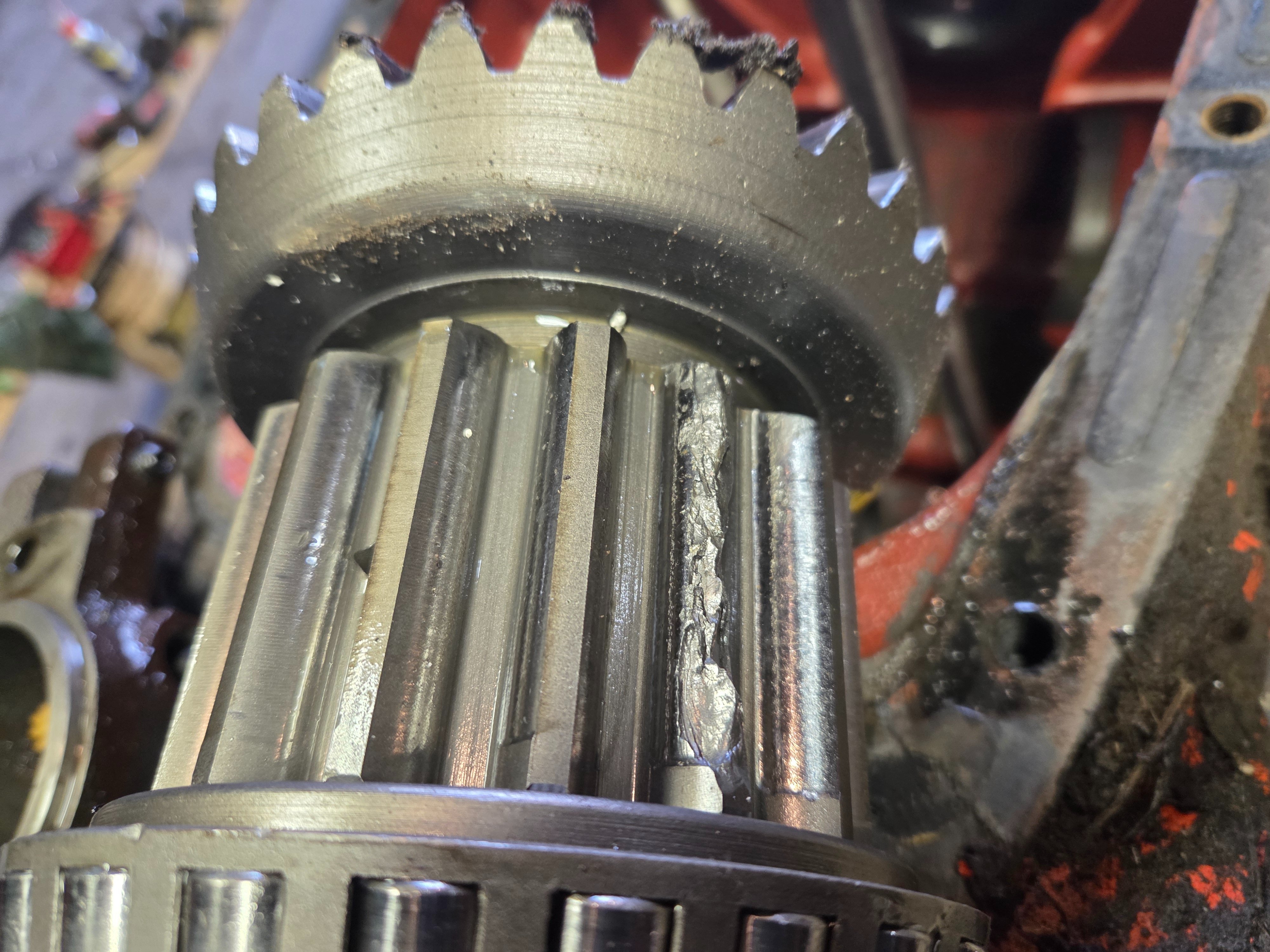

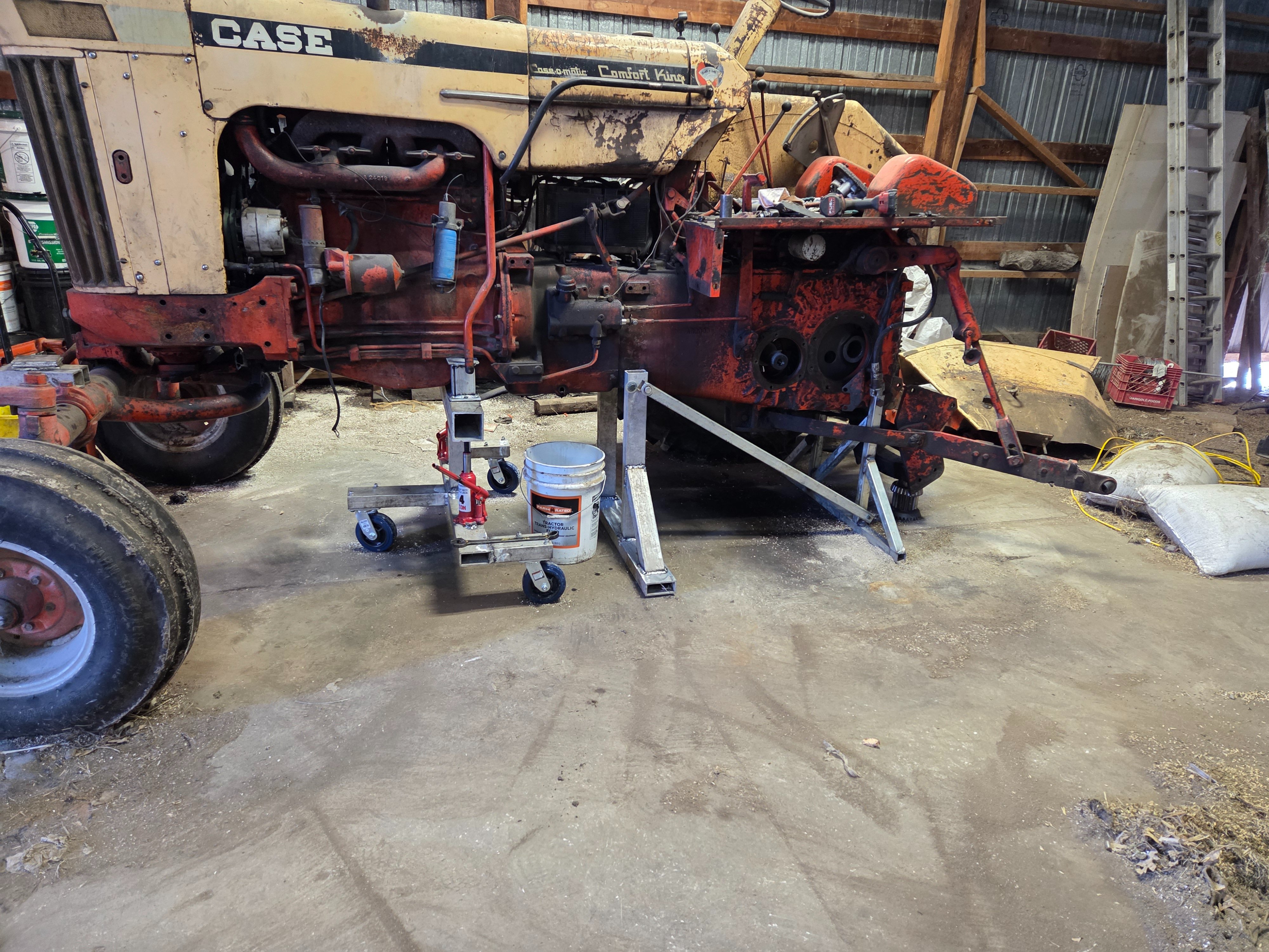

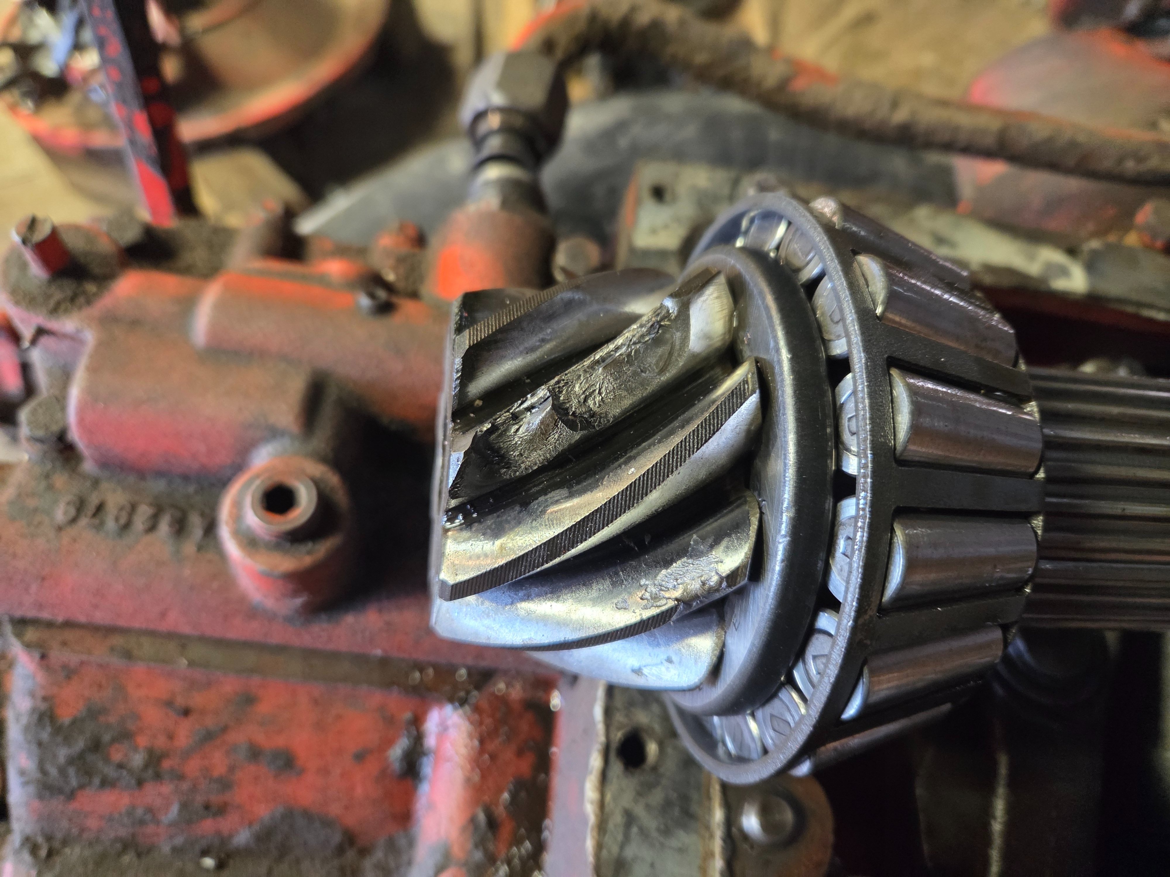

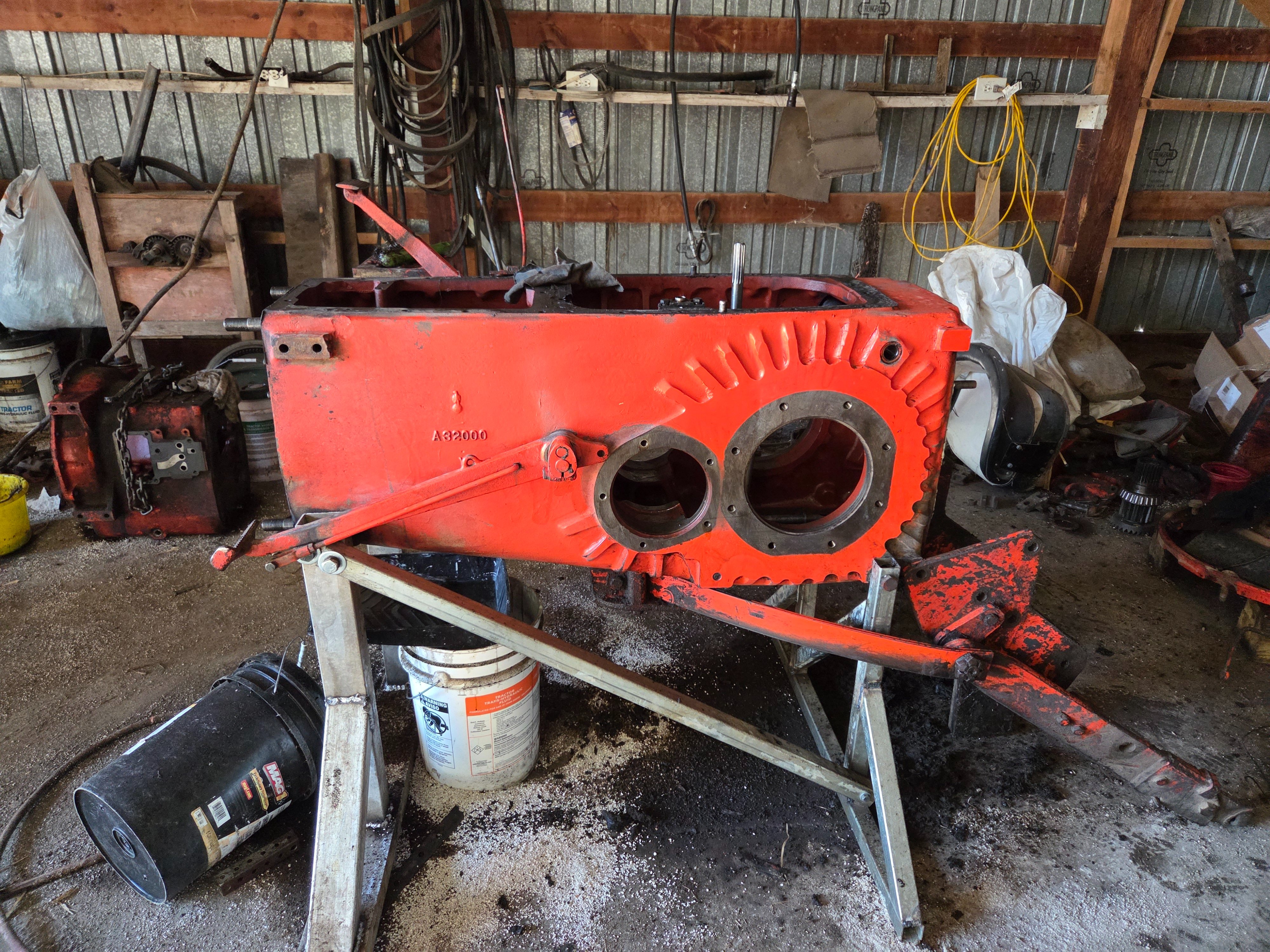

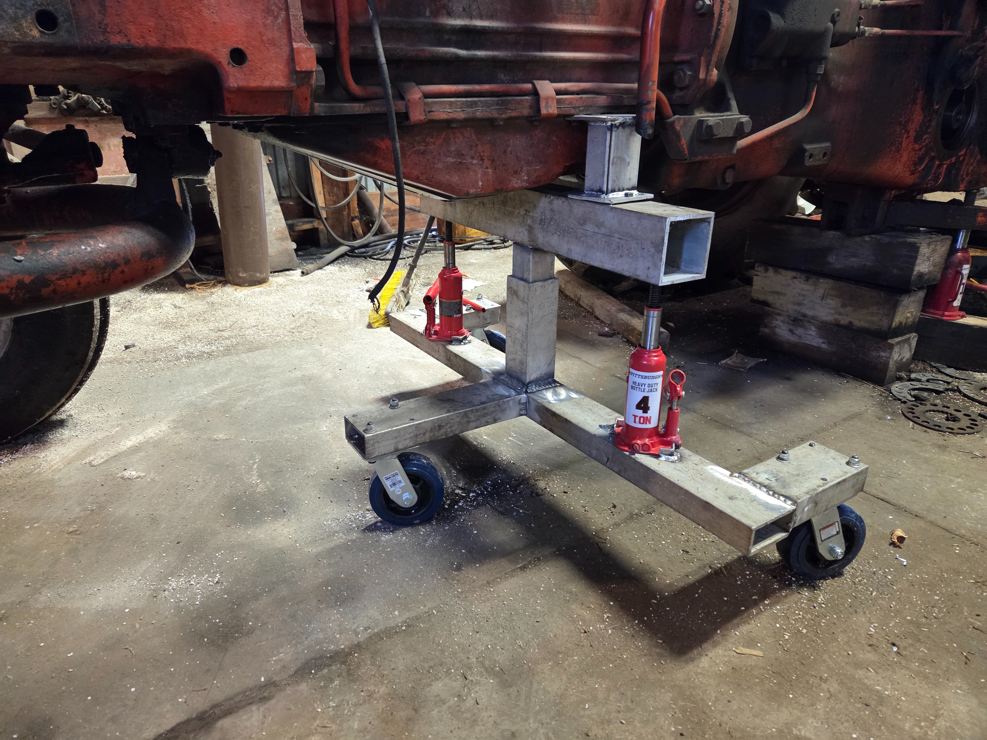

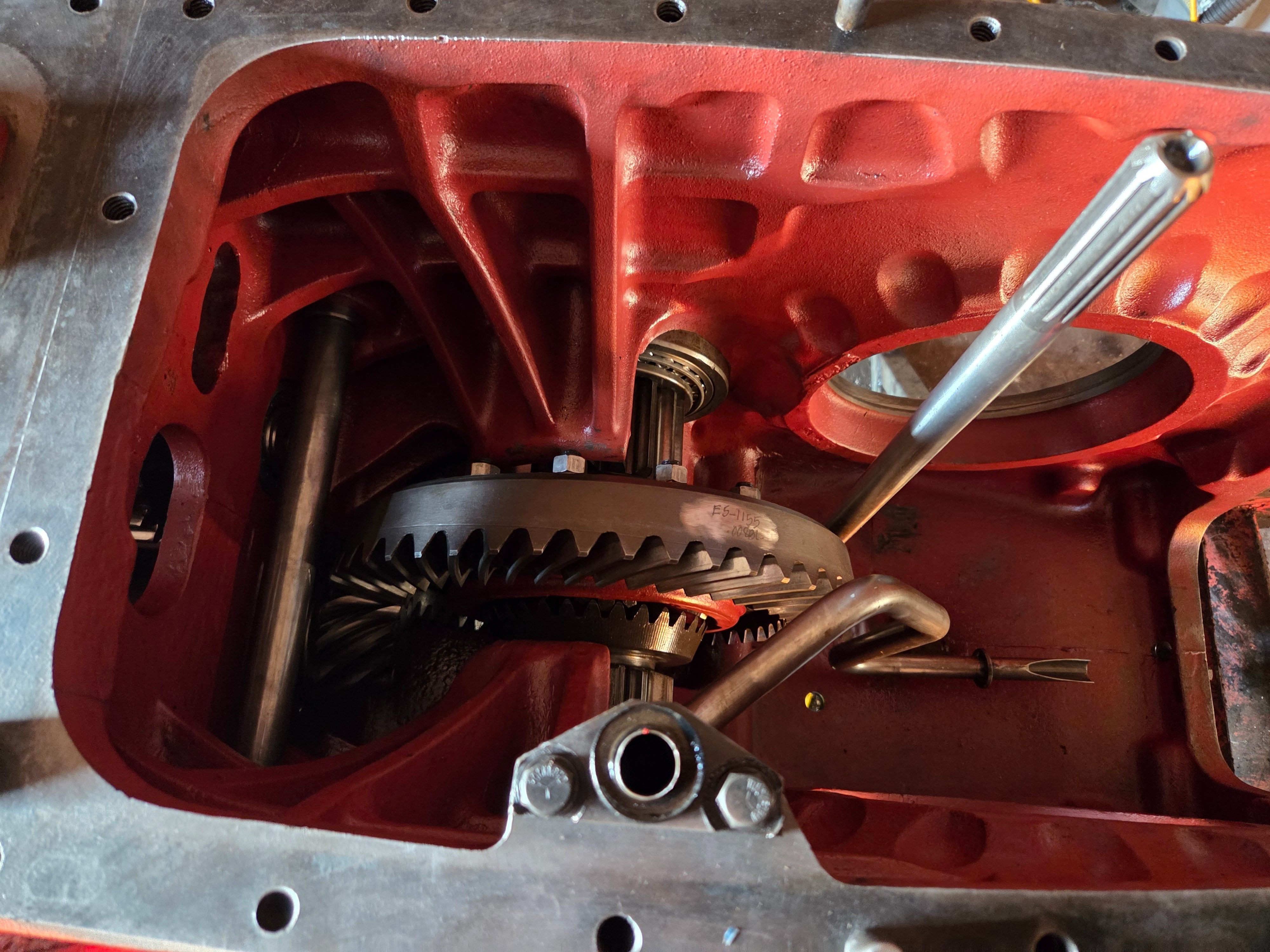

I finished my 830 project this week. A bearing went out on the axle and the parts got in the rear end and destroyed the pinion and some other stuff. So to fix it I had to tear the entire thing down. I started by making some splitting stands.
I had to pull everything out of the entire transmission and rear end.
Since I rebuilt the engine and case-o-matic last year, I have had virtually every bolt and nut out of this tractor and everything rebuilt front to back. Hope it works well for a while now.

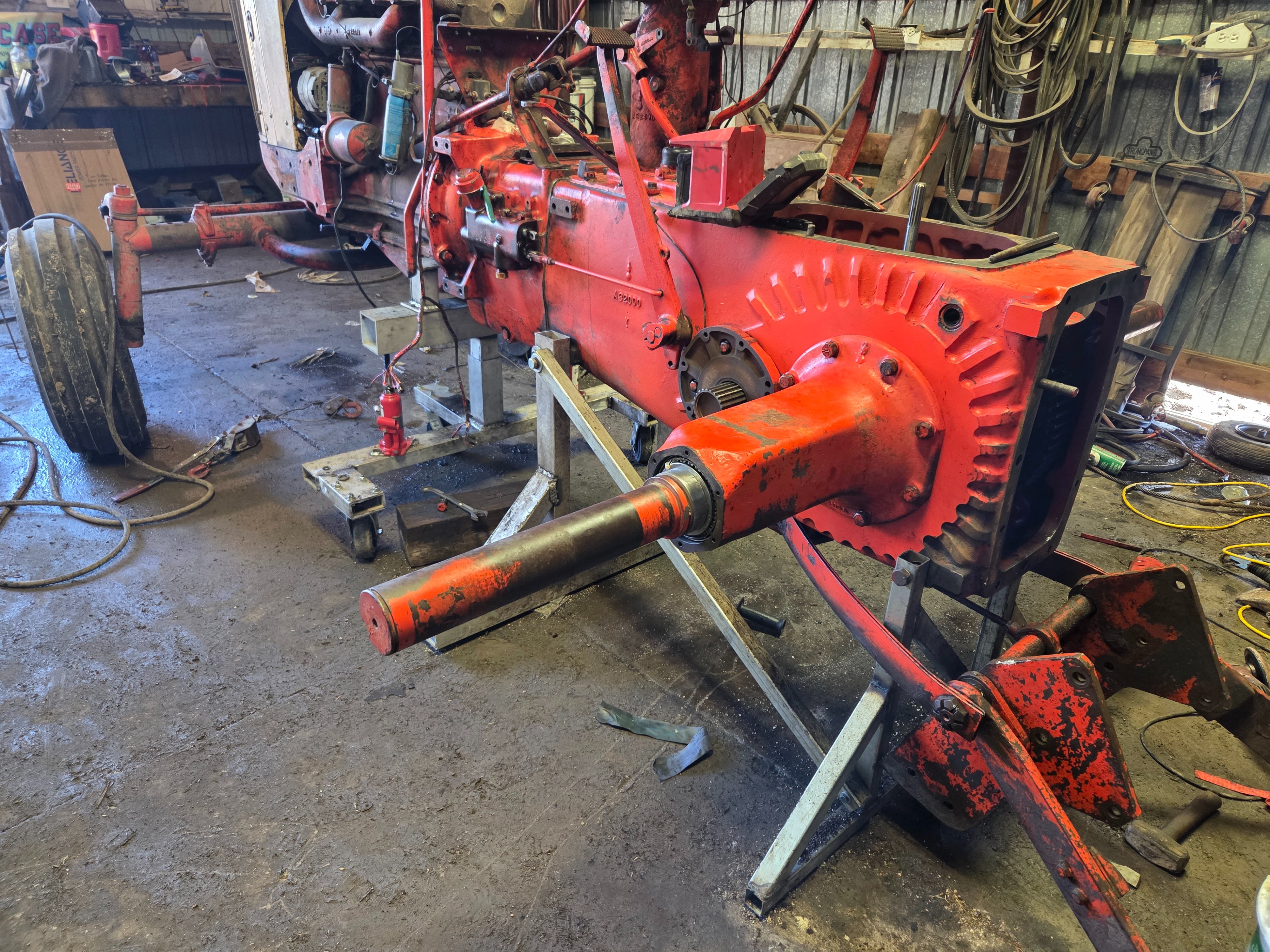

View attachment 149481View attachment 149482

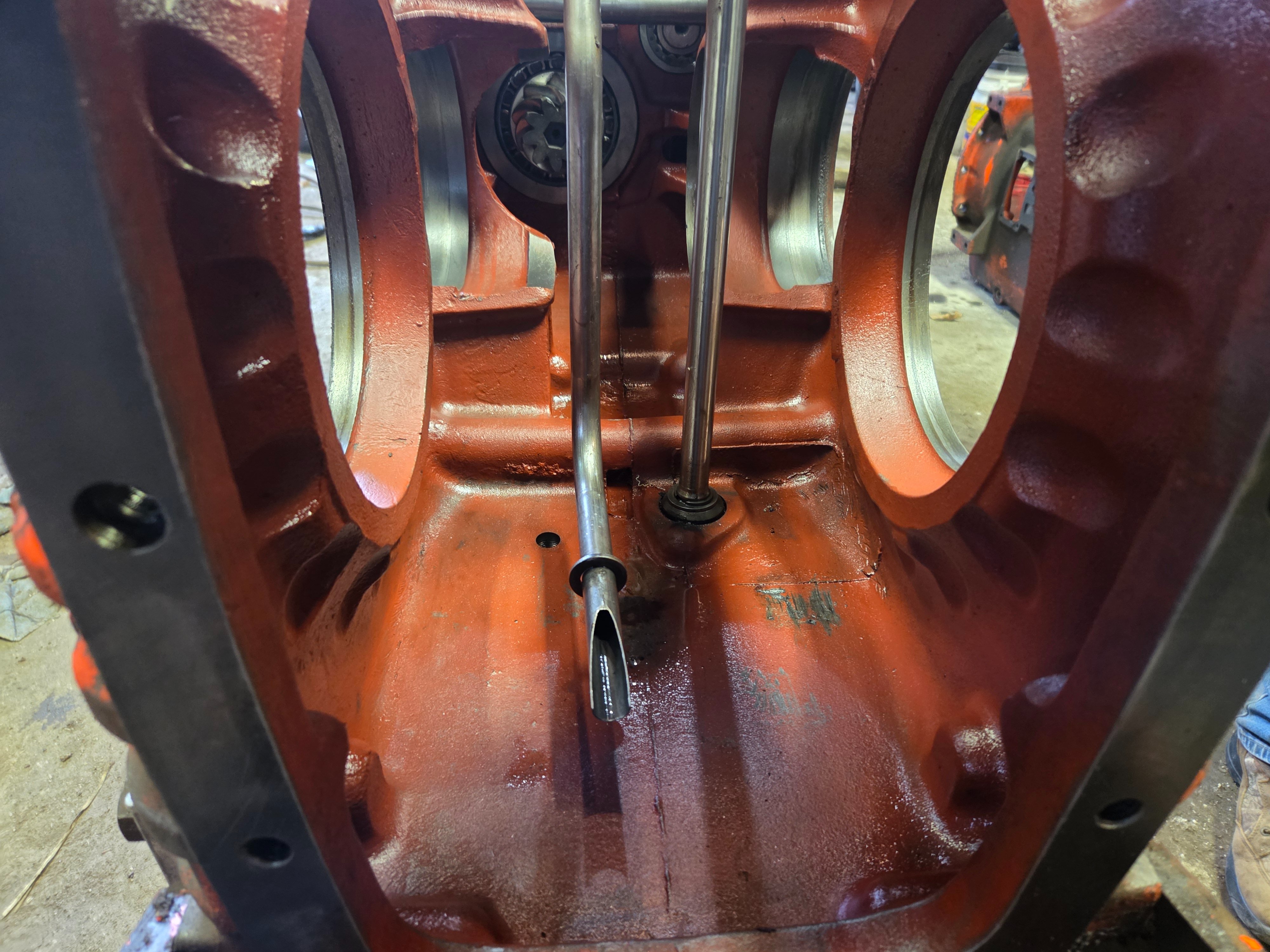

View attachment 149484View attachment 149485View attachment 149487View attachment 149488View attachment 149489View attachment 149490View attachment 149491
