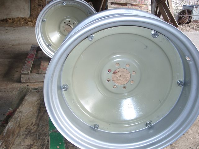

I don't think reinforcement is an issue. I was more concerned with the angle of the stem.
I wonder if that's just a thing on smaller rims? I was sitting at the show today looking at an Allis B and those were in on an angle like that. The ones on the 38s that I just had to work on were in an inch or so from the bead.
These are the ones I put together 20 years ago. The tractor is still setting on jack stands : ( oh well.

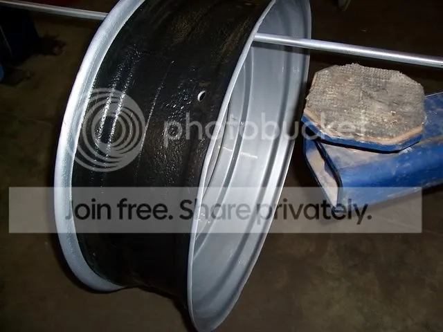

Fawteen, I think you will be fine. I can tell you over the years I have done lots of repairs to tractors and off road equipment rims and tires. Some of it was a little crude! (rust repair)

I have to correct myself. I had several tractors out this morning to put away the ones that I had at the show. All of them are at the bend, it's just that on the wider rims, the bead is wider so they're farther back from the outside while still being in the bend.
I thought the main reason for the flat spot was tubeless tires
So the stem could seal
The nearer to flat and matching the angle the stem is molded into the inner tube the less stress, lowering the risk of tearing the stem from the tube.
The design of the bead area is the main difference in tube or tubeless rims. While some have had luck mounting tires tubeless on tube type rims there is a bigger risk of bead leakage and failure from rolling the bead.
